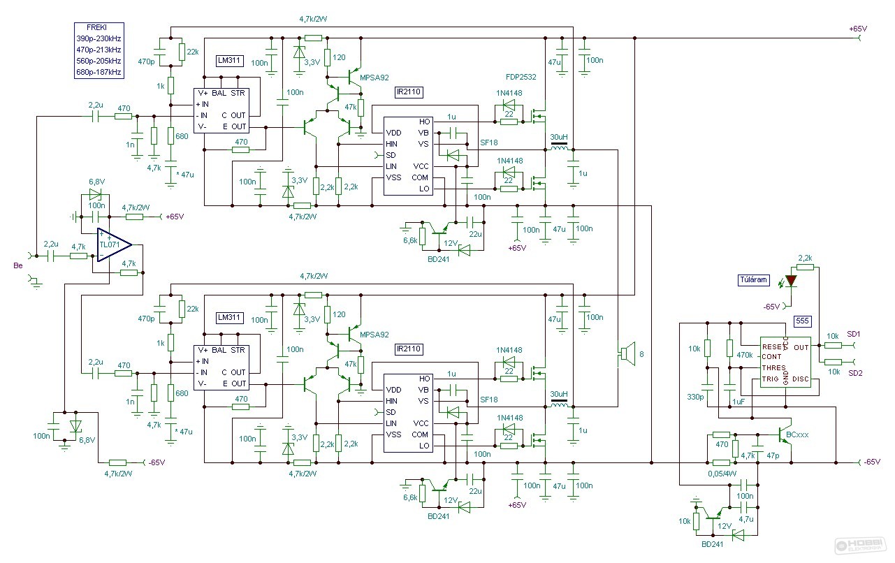

Is a full-bridge, have this power, right?
Hi
no not full bridge
this design is half bridge
wörking very stable, low component cost

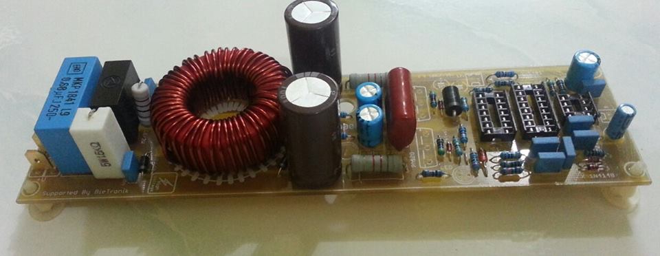

Guys,
Here I give you simple legend D900, but modded for better stabiliy.
It works and stable, robust already.
Layout credit to BieTronik 🙂

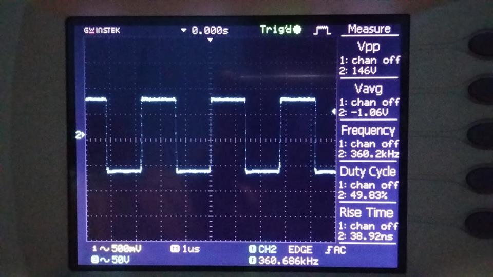

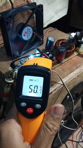

D900 Mod From Mr. Kartino
Result D900 mod by mr. Kartino
Thanx for nice D900 mod
(Pic from Class D group FB)
regards
regards

IRFB4227 will maybe only on music program whitstand 2 ohm load at 85V not even think how you manage to not blow them at 1 ohm load on each half bridge (full bridge 2 ohm total load seen by the amp) 🙂
not fullbridge sir but halfbridge at 2ohms +/-85vlts .Full bridge, +/-85vlts at 2ohms irfb4227? Oh. My. God. You must be veeeerrrry lucky.
i wanted to use +/-120vlts half bridge at 4 ohms using irfb 4229, is it possible???
The schematic posted by you is full bridge.
In half bridge it's not perfectly impossible, but absolutely not safe. See recommendation in datasheet: 300-500 W. Maybe little more, but not 1500 W.
