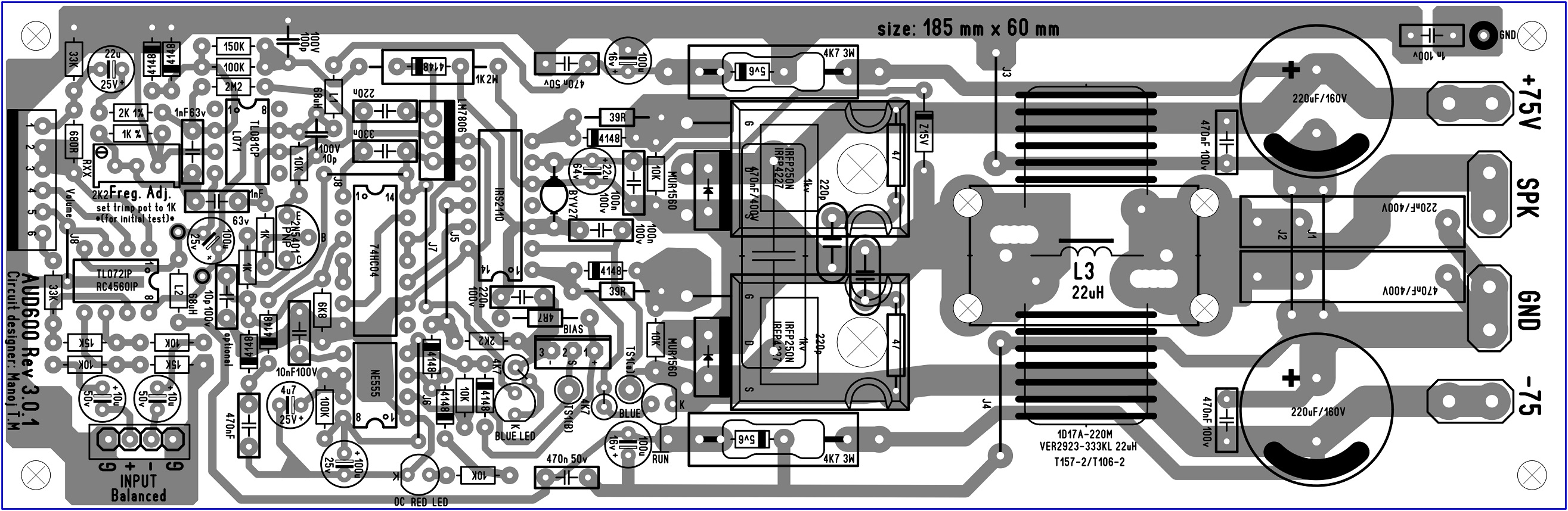

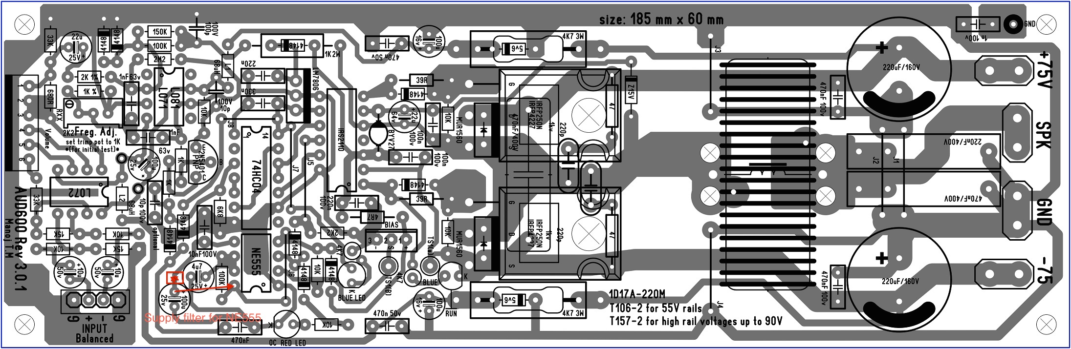

hi manojtm whether there was any wrong or is there something else?😀Hi,
Good PCB,Only single mistake 😉
Regards
MANOJ
Regards
MANOJ
wow ! thank you I'm happy that was just one last minor mistake I will fix and post later sir 🙂 I'm really happy ! thank for helping me if some one want black and white PDF let me know I will post here
ok here we go cap fixed
I'm also re-drawing the AUD600 supply is not completed yet
Best Regards
Juan

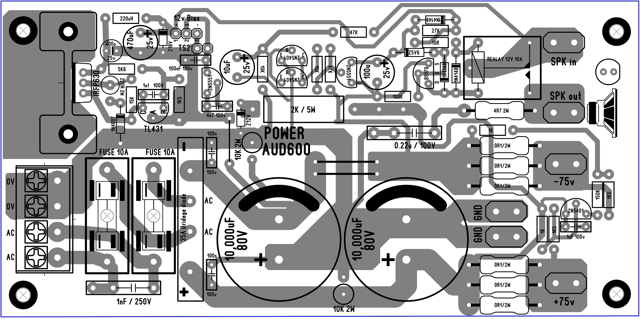

hi sir is not the first time I'm doing this 🙂 but as humans there's always something that escape our eyes 😉
Regards
Juan
http://www.diyaudio.com//www.pinterest.com/pin/create/extension/
Hi Juan,
Power AUD600, Don't need 2K/5W & Z12V.DC protect(relay) work on same Bias Supply, and you are not provided AC fail ckt. see rev.3.0.1 schema, also see Relay contact points(C,NC & NO) on ckt.It is very important for avoid relay contact failure.
Regards
MANOJ
Regards
MANOJ
Hi Juan,
Regards
MANOJ
I just begin the other day sir the PCB is going to be changed some components, that is why I say is not completed 🙂 I will fallow the rev 3.0.1 schema, and yes I notice that 2K/5W is not needed 😉 I will post later in a few day I have to "brainstorm a lot now" 😀

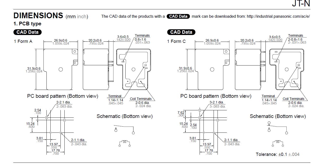

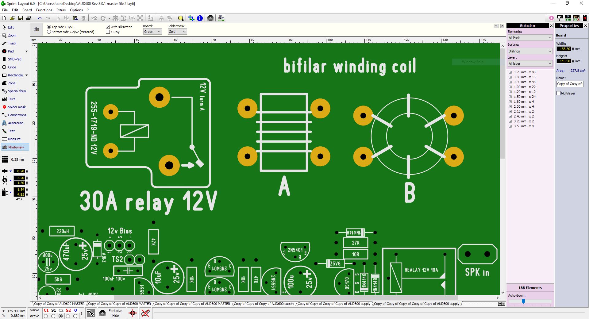

hello manoj can you give a example of a bifilar winding ? I made two macros one to flat surface and one upright mounting also, I read on schematic that relay need to have a 30A contract type is this relay type will be ok to use ?

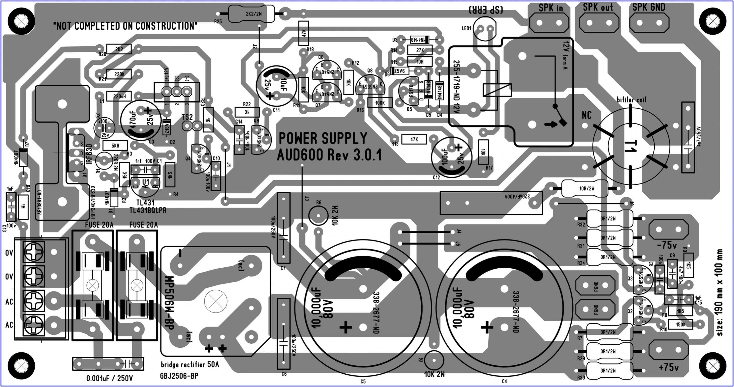

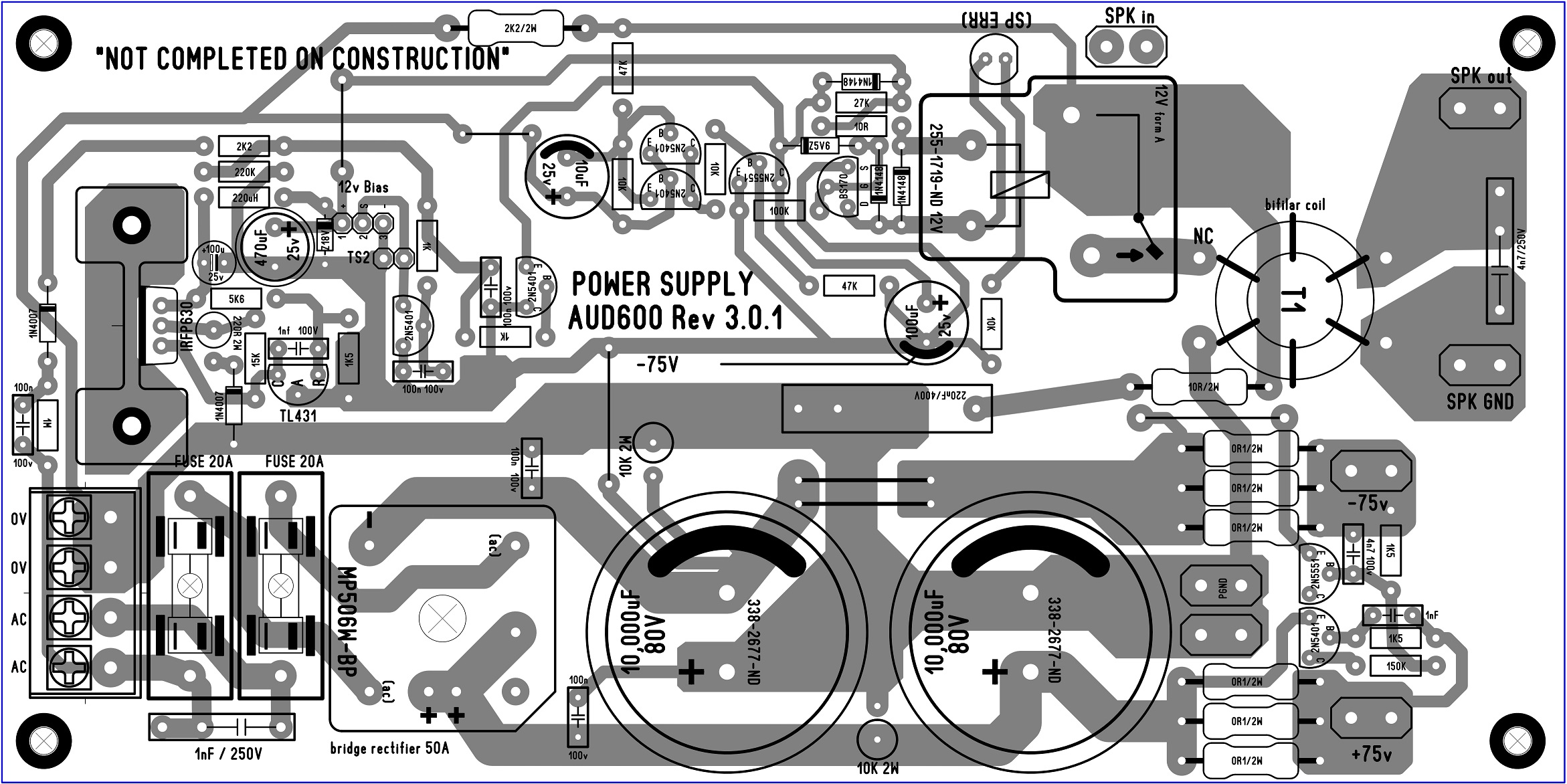

I spend a couple of hours yesterday on the AUD600 power supply board and I made a few changes the capacitor now larger ones can be use up to 35 mm in diameter at the moment of this writing, also I decide to change the bridge rectifier to one that can handle more current up to 600V 50A "actually I'm fallowing mister manoj schematic", part number MP506W-BP I change the relay to a one that can withstand more current on the contacts 30A part number JTN1AS-PA-F-DC12V.
mister manoj let me know if this relay I can used for the circuit
I still working on it this and it still a draft not a completed PCB yet but I will post a couple of time as I go good day guys 🙂
Best Regards
Juanhttp://www.diyaudio.com//www.pinterest.com/pin/create/extension/

This BR diode🙂 I used for AUD1000SD(smd version)
Regards
MANOJ
nice sir, even better ! 🙂 I think I will changed for that one thanks,
this is how it look now but I do not mind changed to that part number 😀

Hi Juan,
Nice work.Your PCB size is little big (190x100 mm).
You can add HOPS and UV/OV ckt on this PCB(Full protection)

Hi Juan,

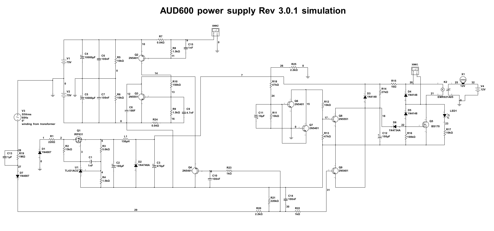

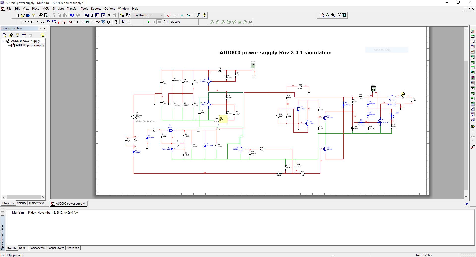

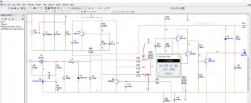

thank you 🙂 and yes it is way too big I will try to reduce if I can🙂 yesterday I was simulated the circuit protection and respond really well to dc detect amp failing and transformer activation "if transformer is off it will shot down" or make relay off but I notice relay activate way too fast or maybe is the software that is doing that ? is there a component value that can be change to slow down the relay delay time delay activation ? maybe 10 seconds perhaps ?

Hi Juan,
Practically its @3sec delay🙂
Regards
MANOJ
hello sir actually works really well on the simulation I forgot to add a S1 to a transformer winding to simulated transformer activity and does activate relay after 3 sec 🙂 also DC detect work good too 😀

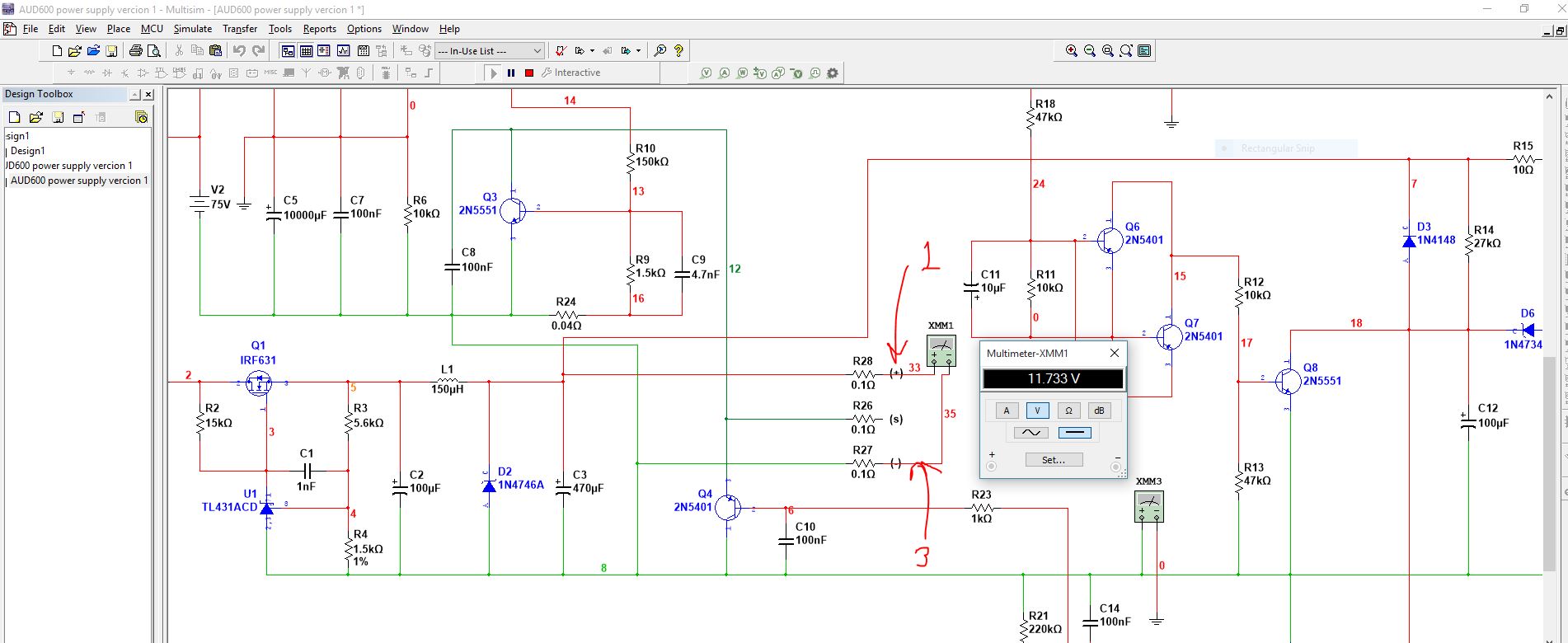

I forgot to ask, what voltage I need to read on pin one bias ?
Regards
Juan
I most have done something wrong, 😕 on pin one bias I have -63V and pin 3 (-) is -75V
I found the info in post #3134
so pin one need to be +12 right ? 🙂 maybe is better if I use a separate 12V regulator and add a small bridged rectifier for the 12V IC regulator to use a separate small transformer or from the same toroid

I most have done something wrong, on pin one bias I have -63V and pin 3 (-) is -75V
Hi Juan,
Yes the voltage what you get is correct if you measured with respect to GND { 75-12=63}
BIAS PIN 1 is +12V with respect to -HV Supply rail (BIAS PIN 3)
Regards
MANOJ

oh wow ! so is good to go nice ... 😀 I do have approximately 11.7V 🙂 nice so I can continue then the PCB layout at least I know DC detect and 3 sec delay is working good too
Best Regards
Juan

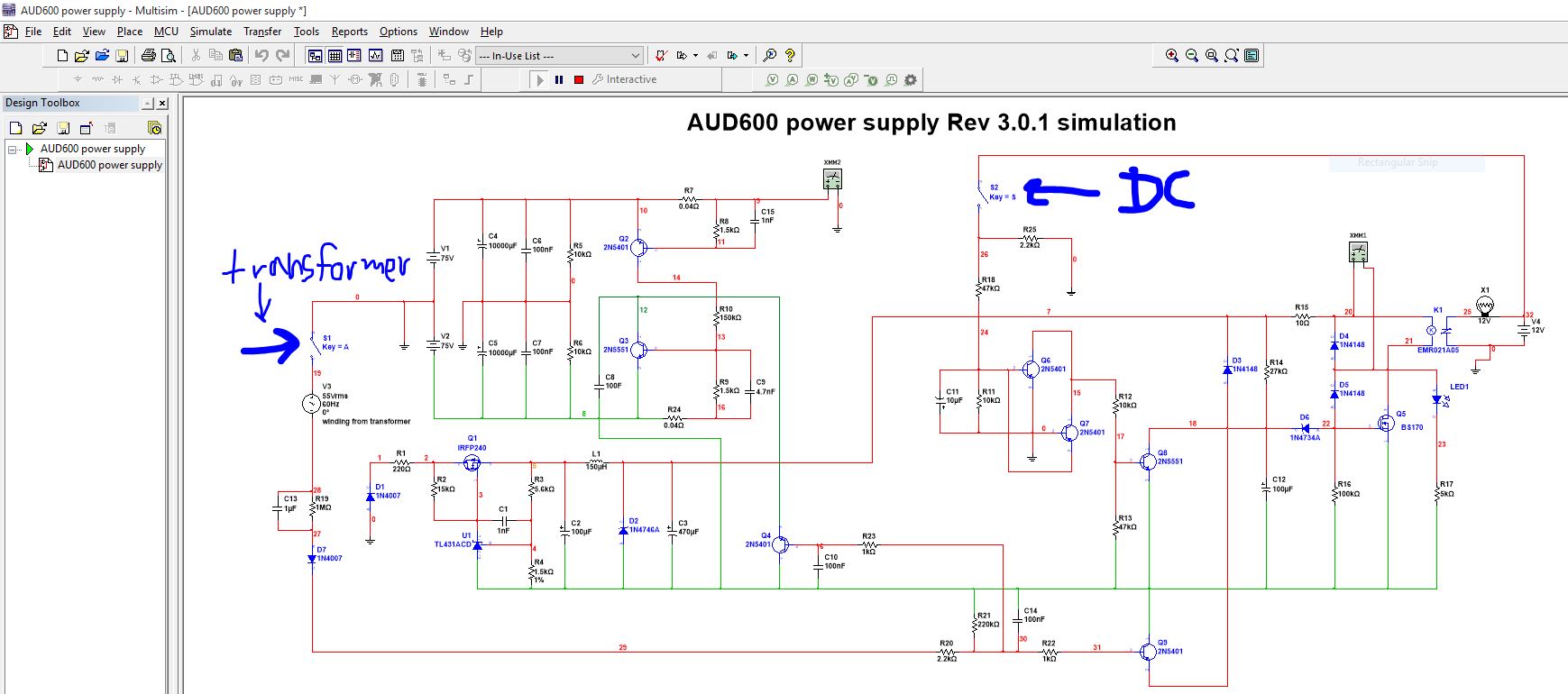

Hello mister manoj I have a little problem, the LED does not light up at any circumstance on the simulation ? what could be the reason ?
all the circuit responds really well I have 12V on pin 1 (+) and DC detect works well if detect 4V it will release the relay NC and also the transformer detection also works too 🙂
but not the LED ? 😕
here how the layout looks now today I know is too big but maybe with time I will reduce size is possible as I go day by day
but not the LED ? 😕
