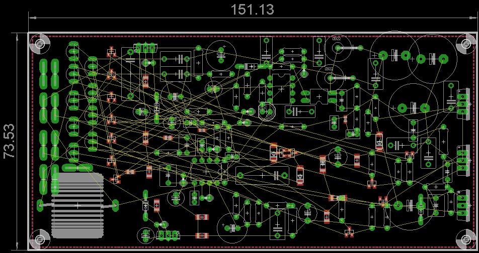

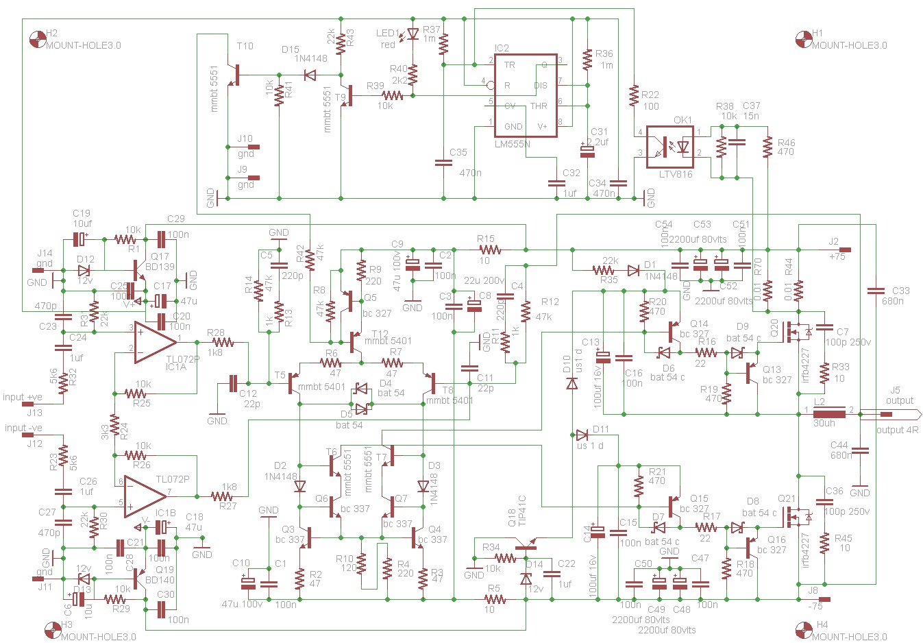

hi all a preview of up coming project . i got hold of some smd components 😀 i will use one pair of irfb 4227 and i want to use +/-72 volts . i wanted to drive the amp up to 1ohm load . any comments or ideas are highly acceptable and welcomed.
  • ucd discreet with prot smd.pdf
