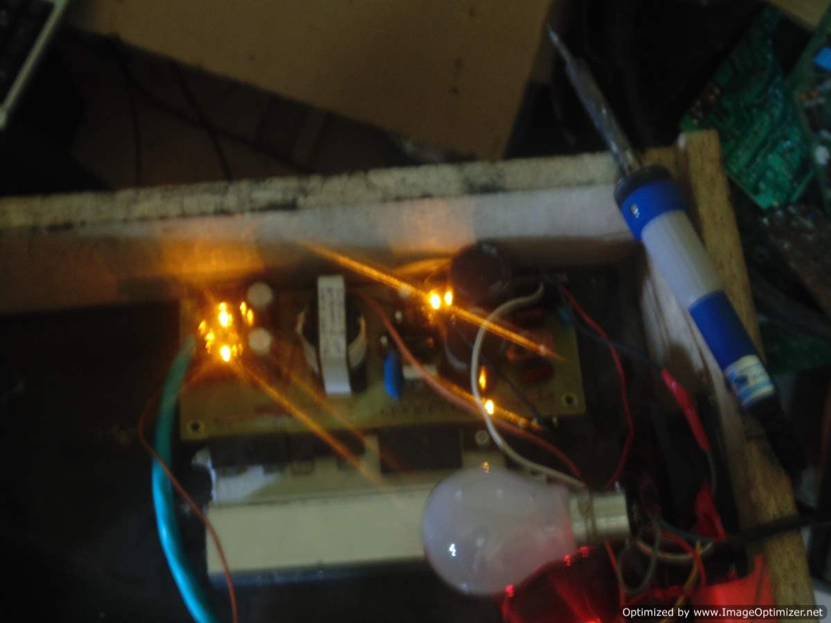

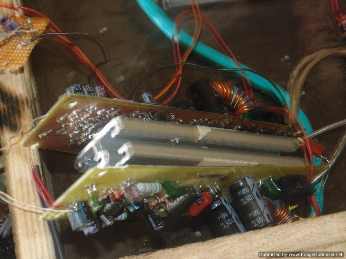

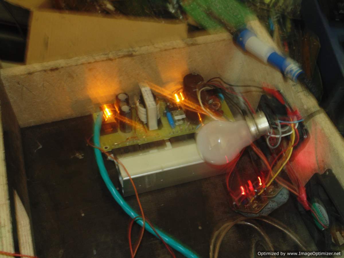

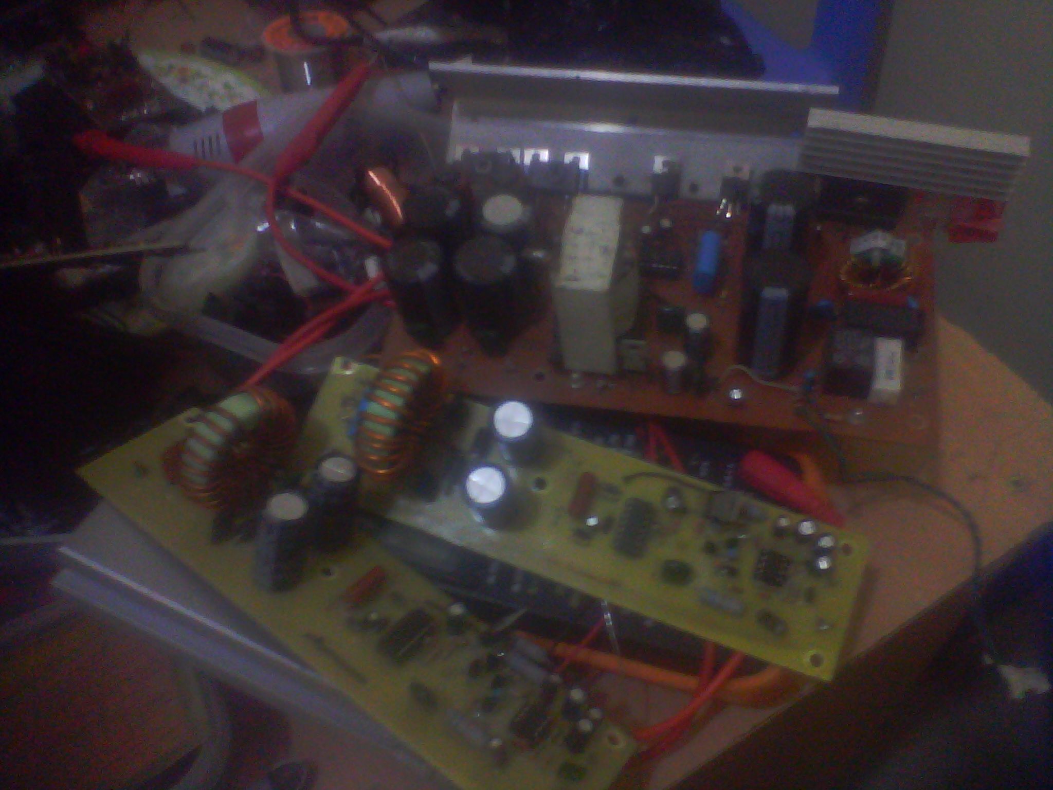

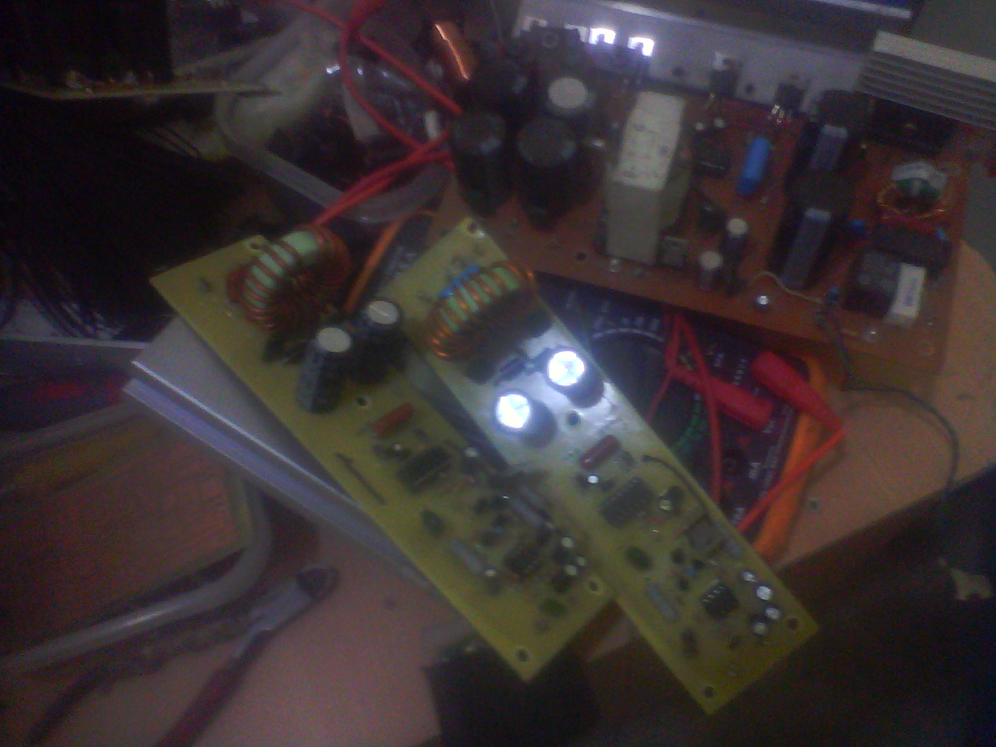

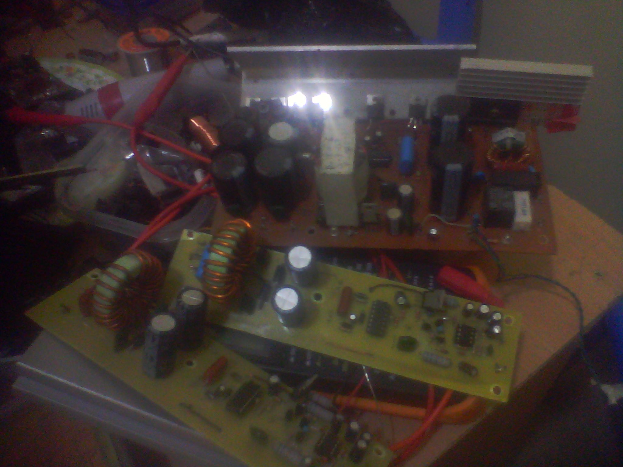

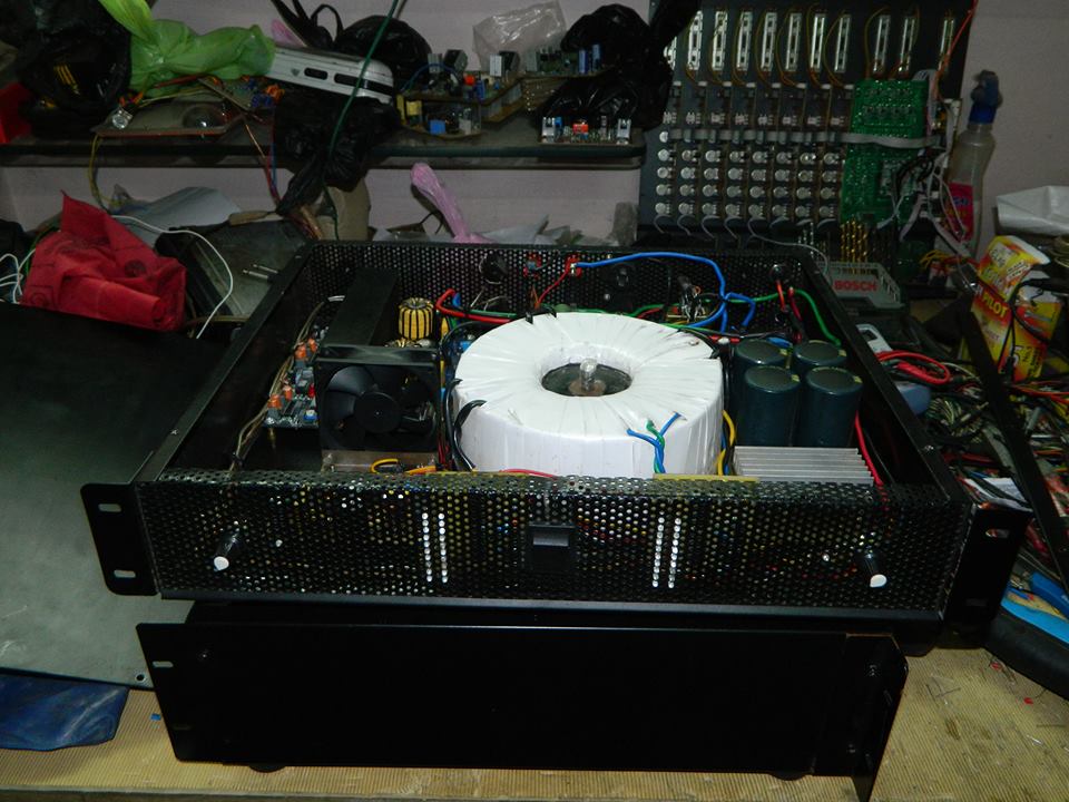

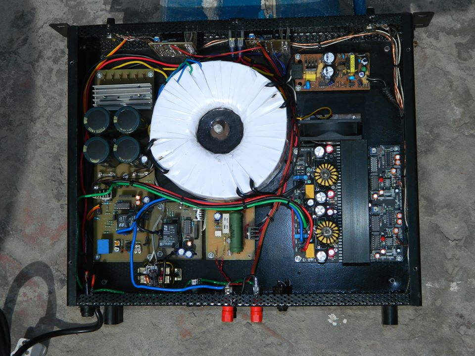

hi all my latest work and respect to the original thread so far i have tested it and is working. i will post more results and details and more clearer photos
gtG ucd 1100 rev 3.1 with protect components clear v2.pdf28.9 KB · Views: 866
gtG ucd 1100 rev 3.1 with protect components protect full clear .pdf224.3 KB · Views: 1,123
Hi mr Stewin
Is your pcb 2 layer or one?
no the ucd using ir ic is single sided 🙂
wich one is beter?
your ucd amp or mr manoj aud600?
thanks

manojs amp is sigma delta and this one is ucd .manojs amp is easier to mount on a casing .this one you have to mount properly to avoid switching noise .
i my self i have not been very lucky with sigma delta .if i make one channel all is o.k but if i make multiple channels in one casing using the same power supply . more than +/-55vlts one channel must fail 😱:confused (but aud 600 with protection board worked perfectly with 3 channels but when i used the 3 channels without protection board one channel failed )
😀 so i went the ucd way .proper mounting is required but all is well at +/-63vlts at 8 ohms bridged playing really loud 😎
By the way it is working o.k without any issues but i wanted to parallel the output fets to four pairs so as to use +/-80vlts at 2ohms in bridge mode :redhot

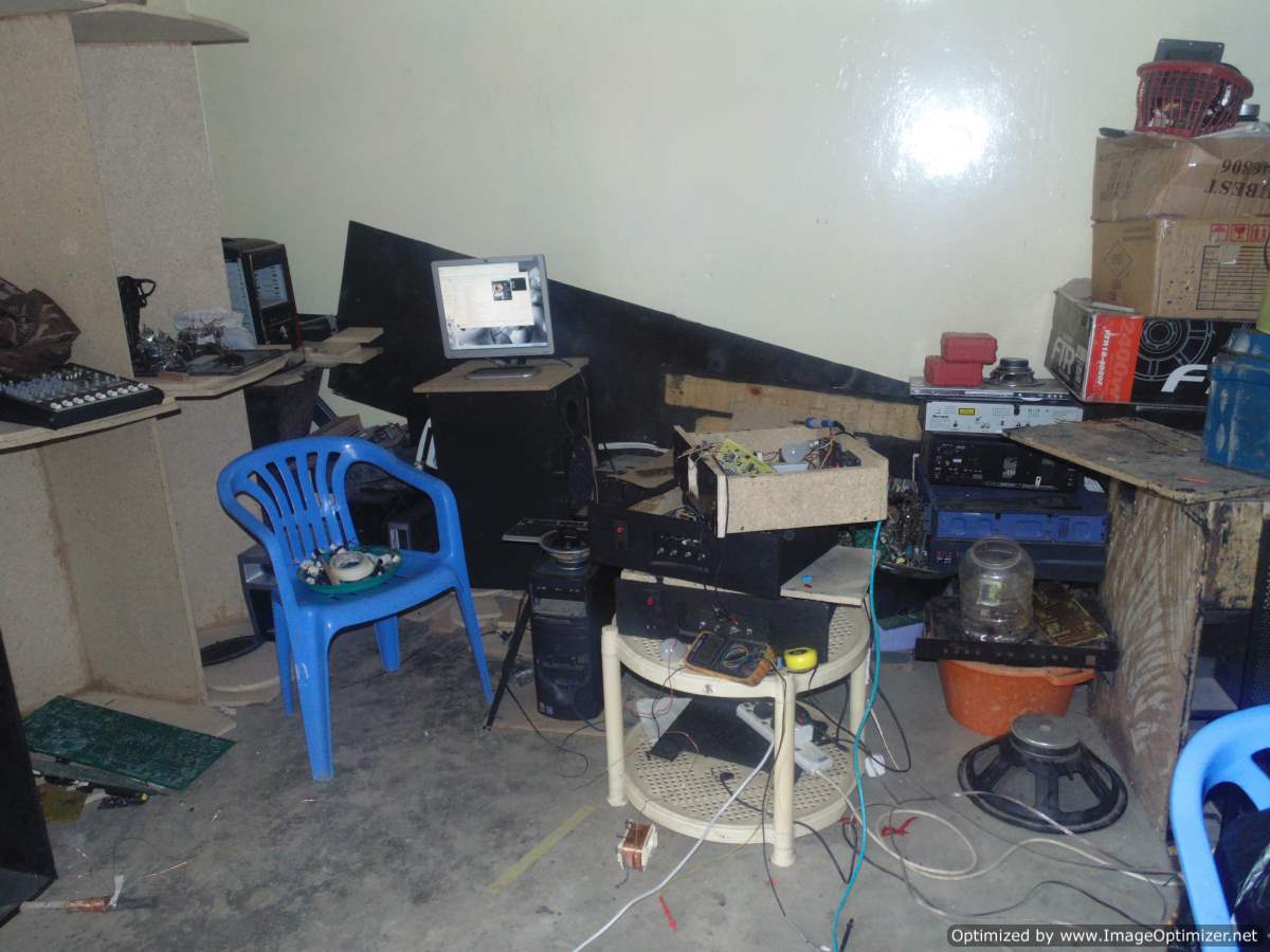

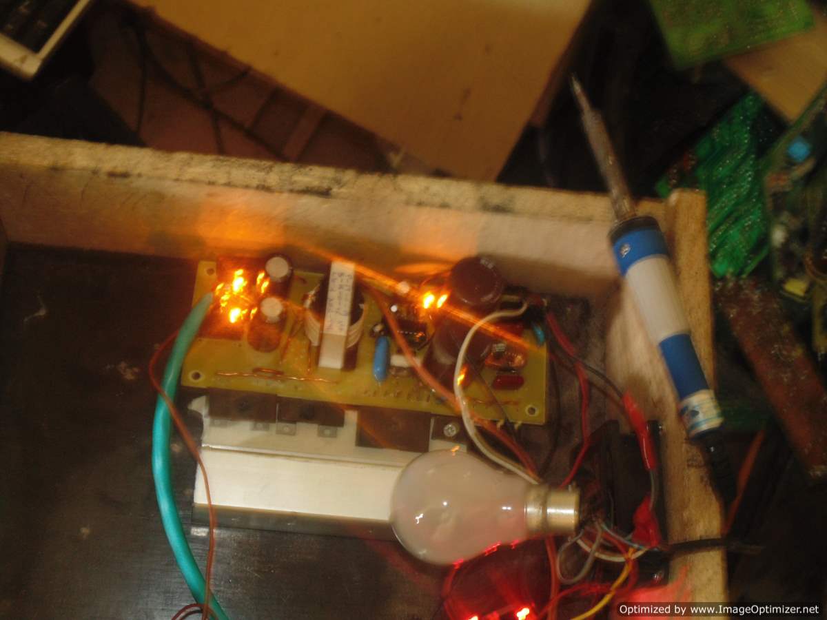

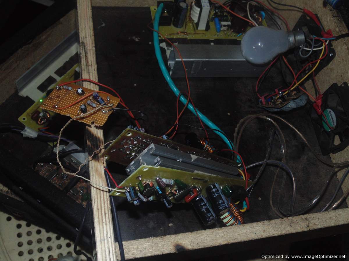

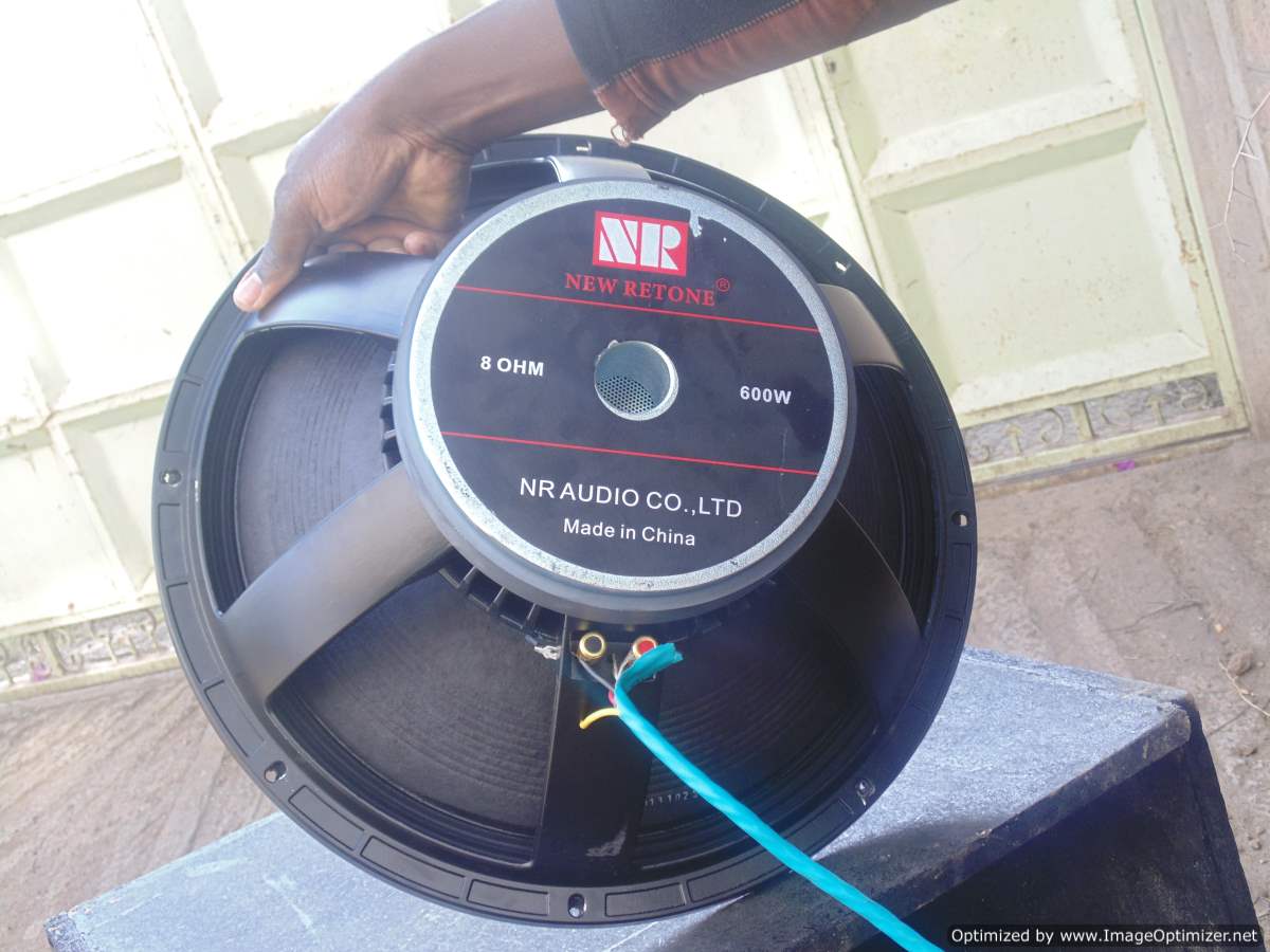

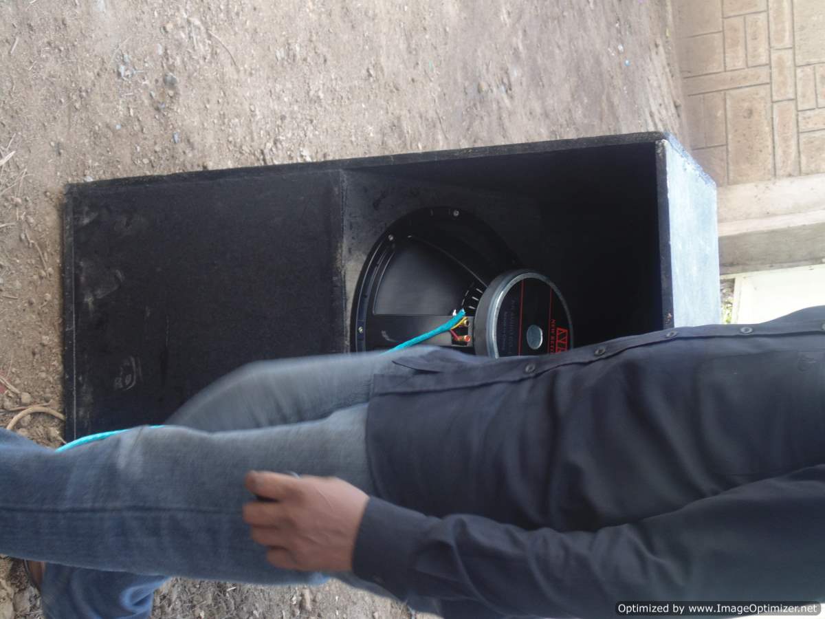

some photos of the current project i used one 18" with xocs cab design.
more photos 😀😀😀
