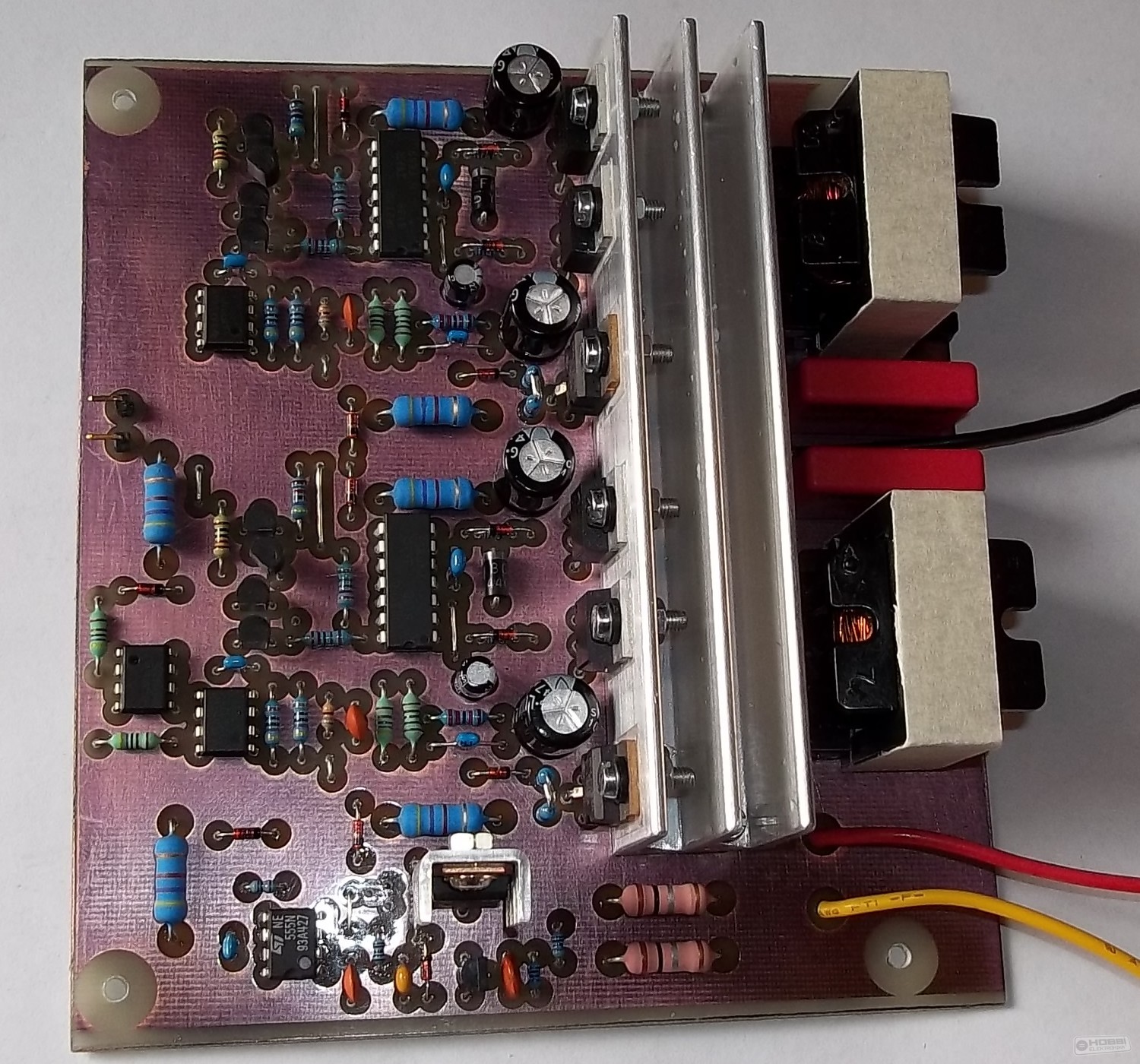

hi what about this layout ?
Just this one is little bit ok from others in the pics.
But missing bulk capacitance for rails.
This is from the Hungarian forum. It is made by a member called Ge Lee there. As stewin and others can see: minimal tracks, good placing, and proper ground plane.
As Workhorse noted, there ar no bulk capacitors, and Ge lee realized it. At high loads, distortion increases, partly because of suppply drop and spikes due to long paths.
He soldered MKP capacitors on the bottom of the PCB, just to MOSFET legs, which helped this. He experimented with more X7R caps at 1812 size, according to him, this did not improve much. MKP has much lower ESR and dissipative factor than X7R.
But X7R is very dependent on manufacturer. This code is not exactly the material, but the temperature and tolerance classes.
I also experimented with MKP caps, but my 1812 sized 330nF 100V X7R caps were good for coupling, right next to MOSFET legs. I also used multiple 220uF 100V LOW-ESR elcos near (distance<1cm).
