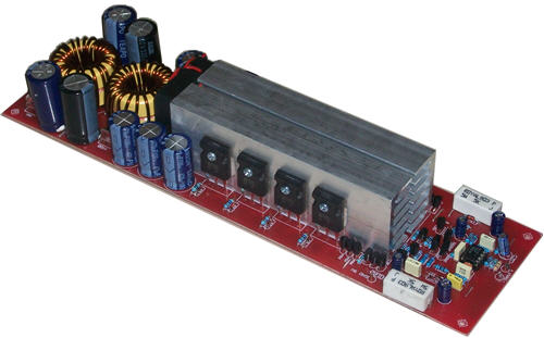

hi andrew thanks for the quick reply pls post the pcb files for smps detex 3000 .
also how is the amp and how many voltage +/-? also what fets are you using for outputs.
detex 3kw smps
Hi Steven
greetings i use FDA69N25 mosfets for my IRS3000 dc volts 95+/-
with FDA59N30 i use 125 dc volts +/- the dclass amp at side of detex smps has 6 pairs @ 90 volts dc its for .5 OHM LOAD

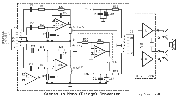

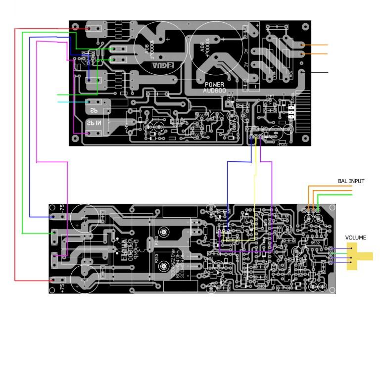

Hi all,please help me,how connect in stereo and bridge mode\not only bridge\, two irs900 module,enough to revers the fase in one channel input?

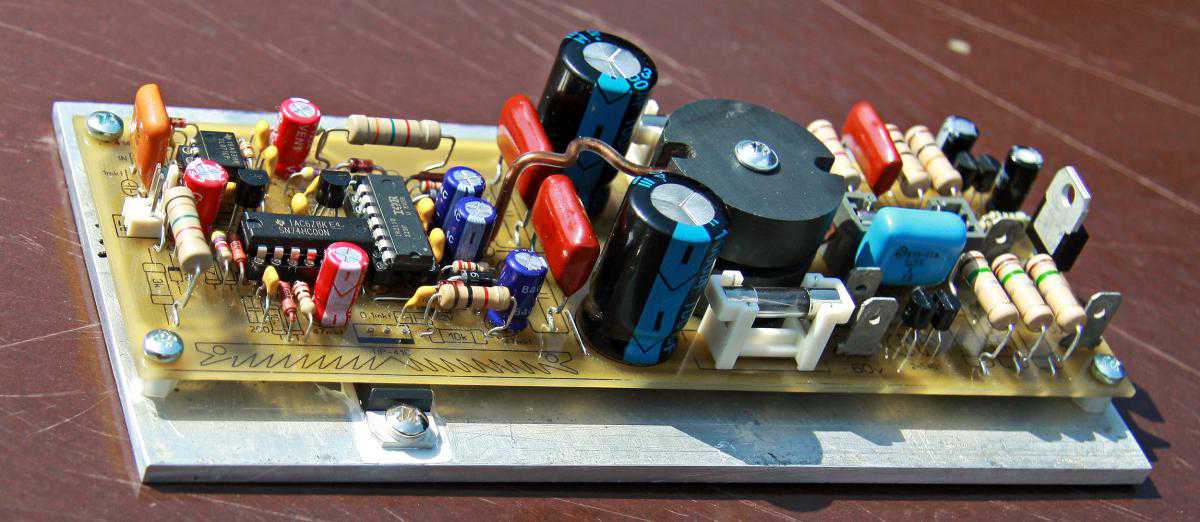

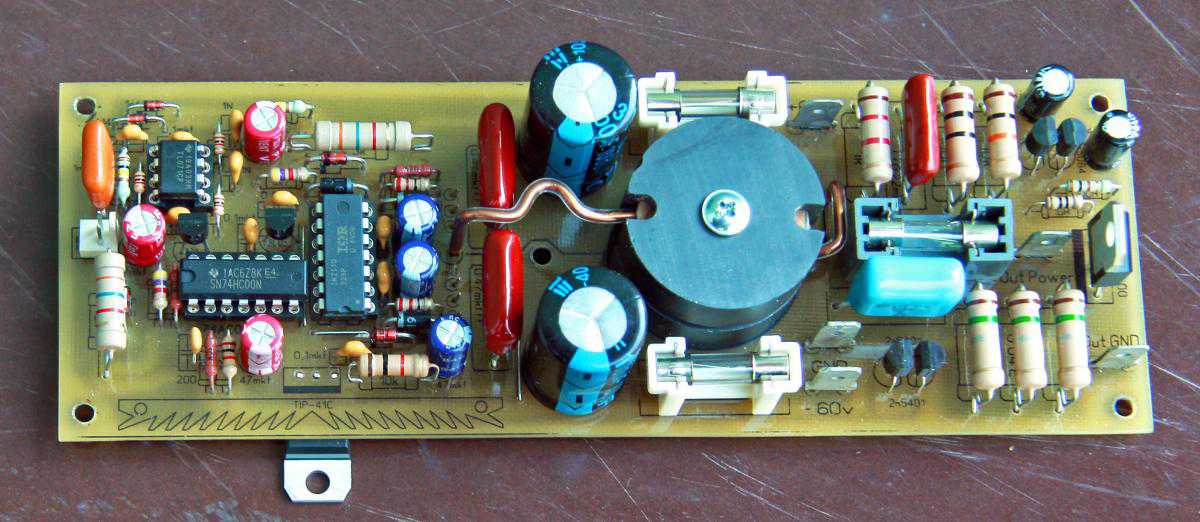

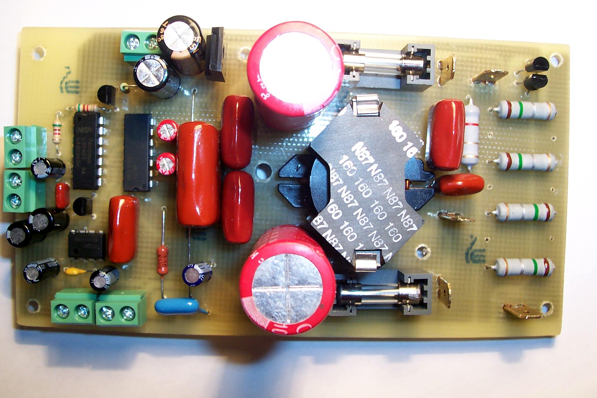

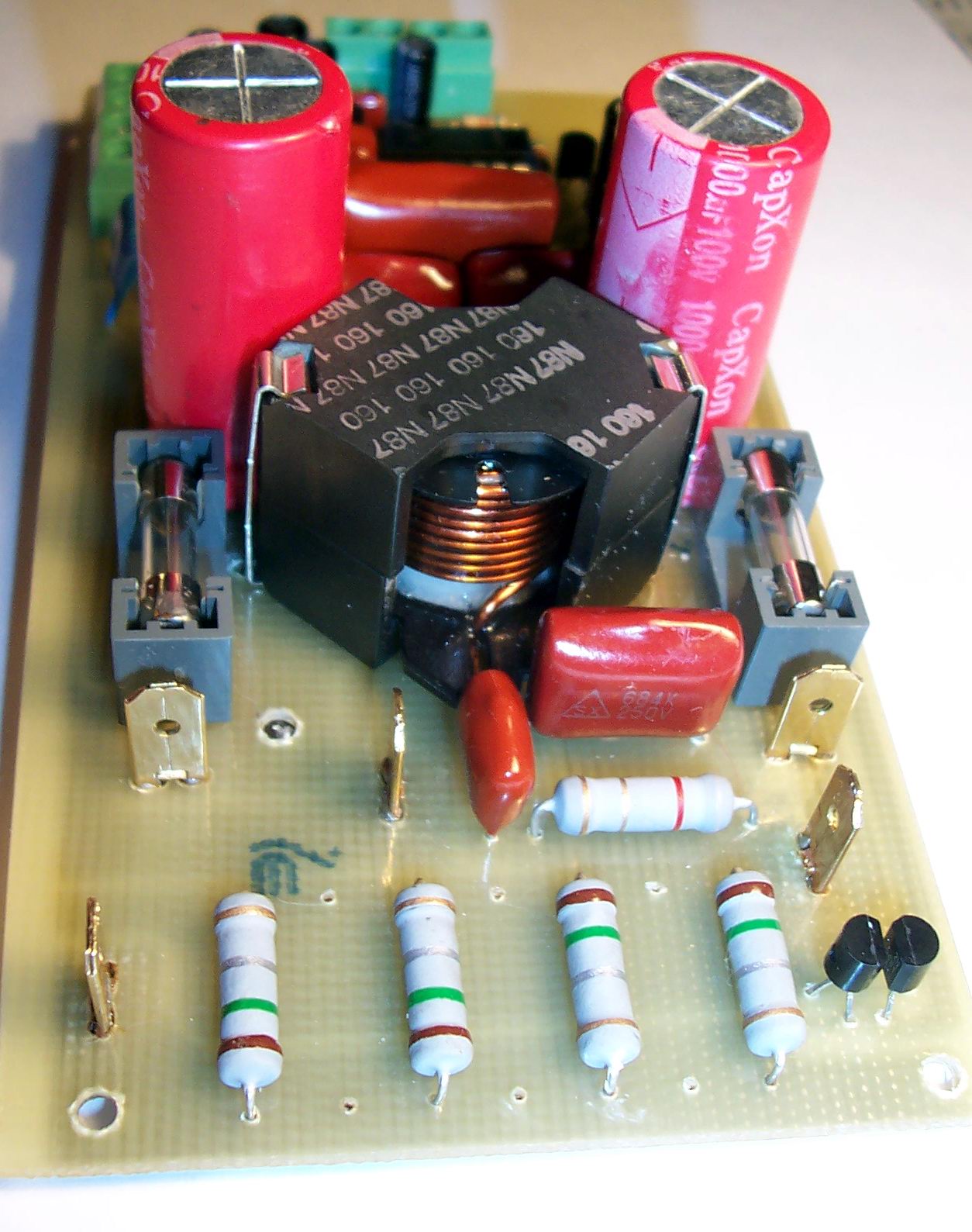

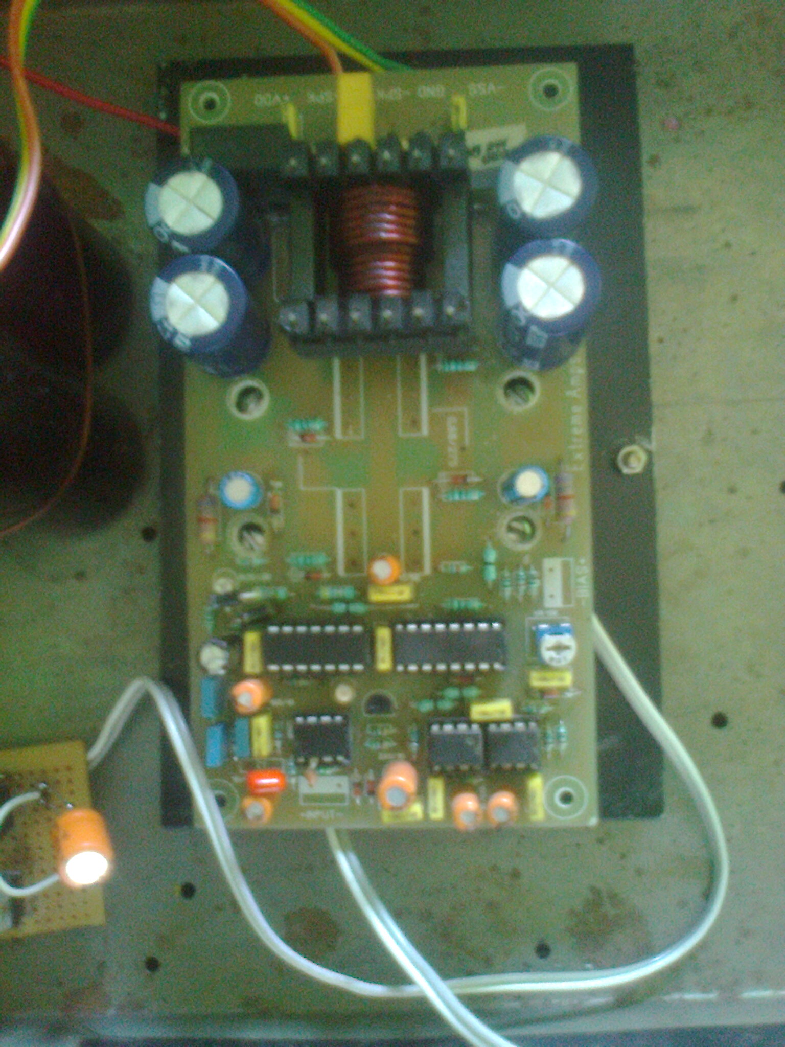

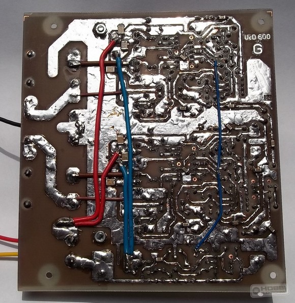

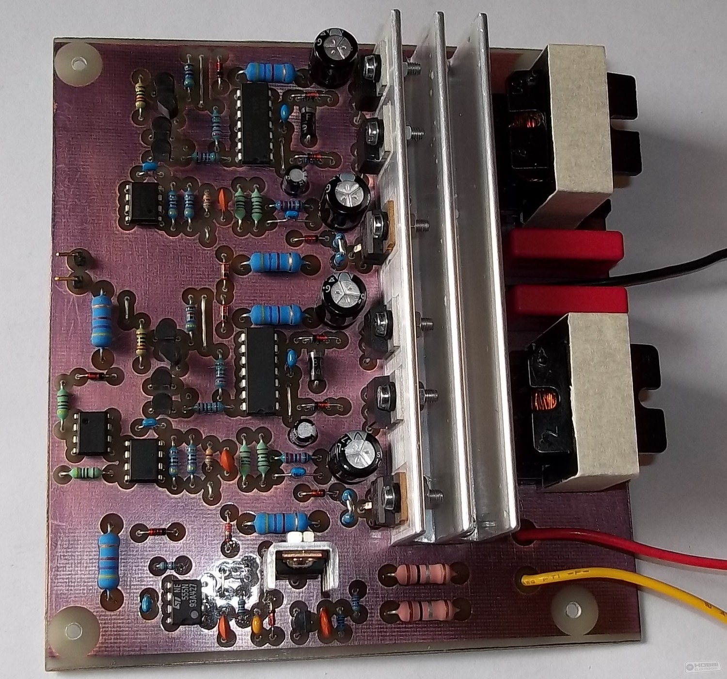

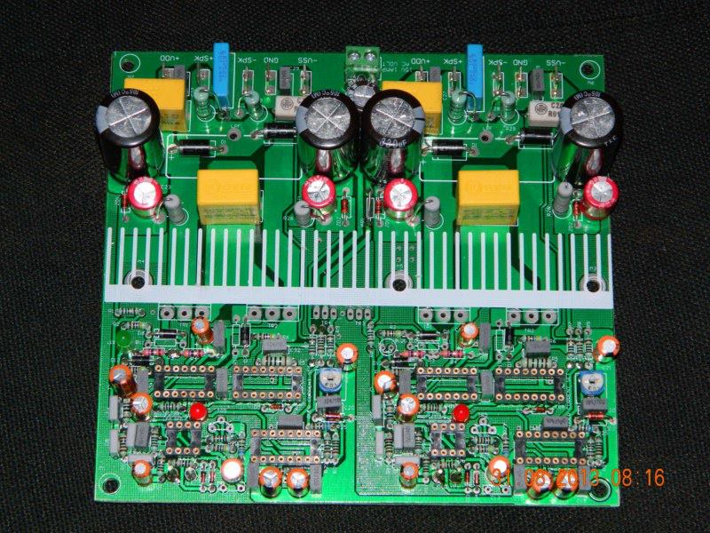

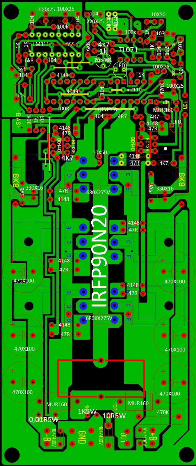

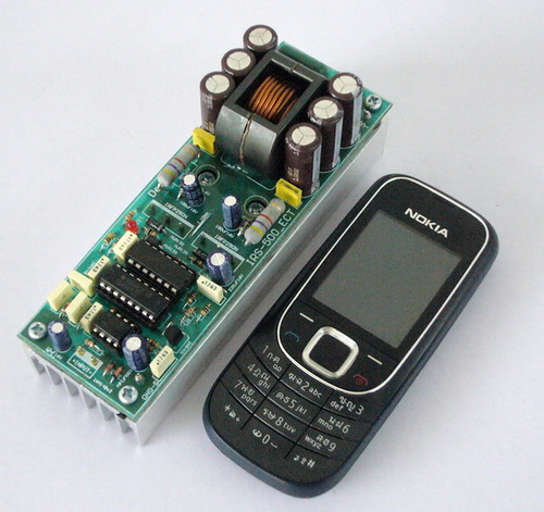

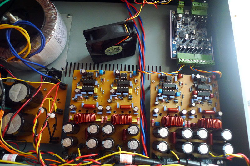

These are EMI infernos not Class-D amplifiers... 😀 Switching node directly lifted above the PCB to act as HF transmitter 😱 😱
how comes in his forum he has the measures an has made many pcbs with success?😕😕
A working class-D doesn't mean, its a success in EMI also. The type of PCB layout used in the above examples is terrible and can cause huge amount of EMI.

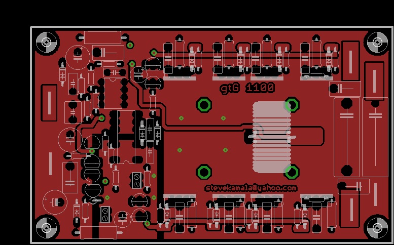

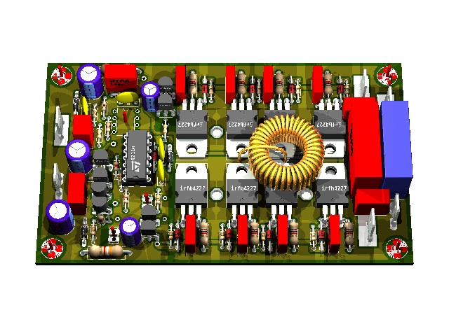

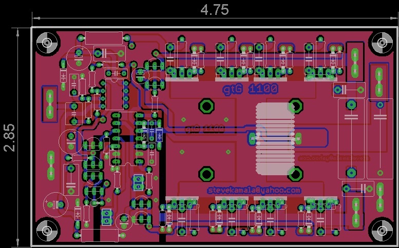

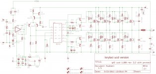

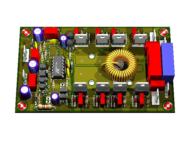

hi kanwar pls share a simple working class d schematic with pcb layout.🙂

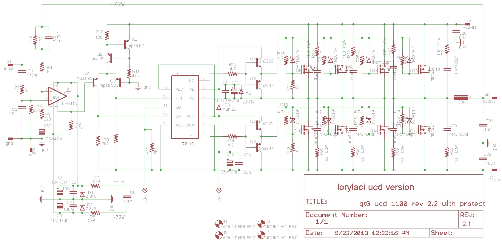

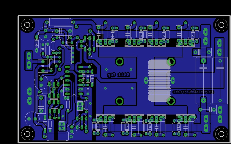

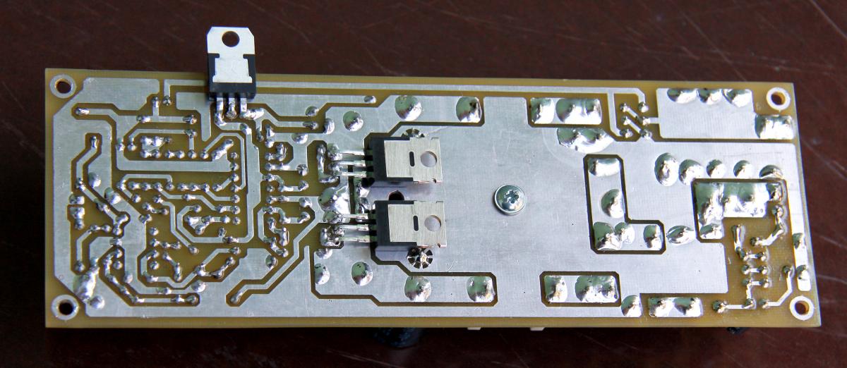

hi workhorse i drafted the pcb based on this forum., is this layout o.k it is ucd .😕
You have made the layout as if its some class-AB amplifier with devices on each side. Try to learn why class-D demands different layout.
