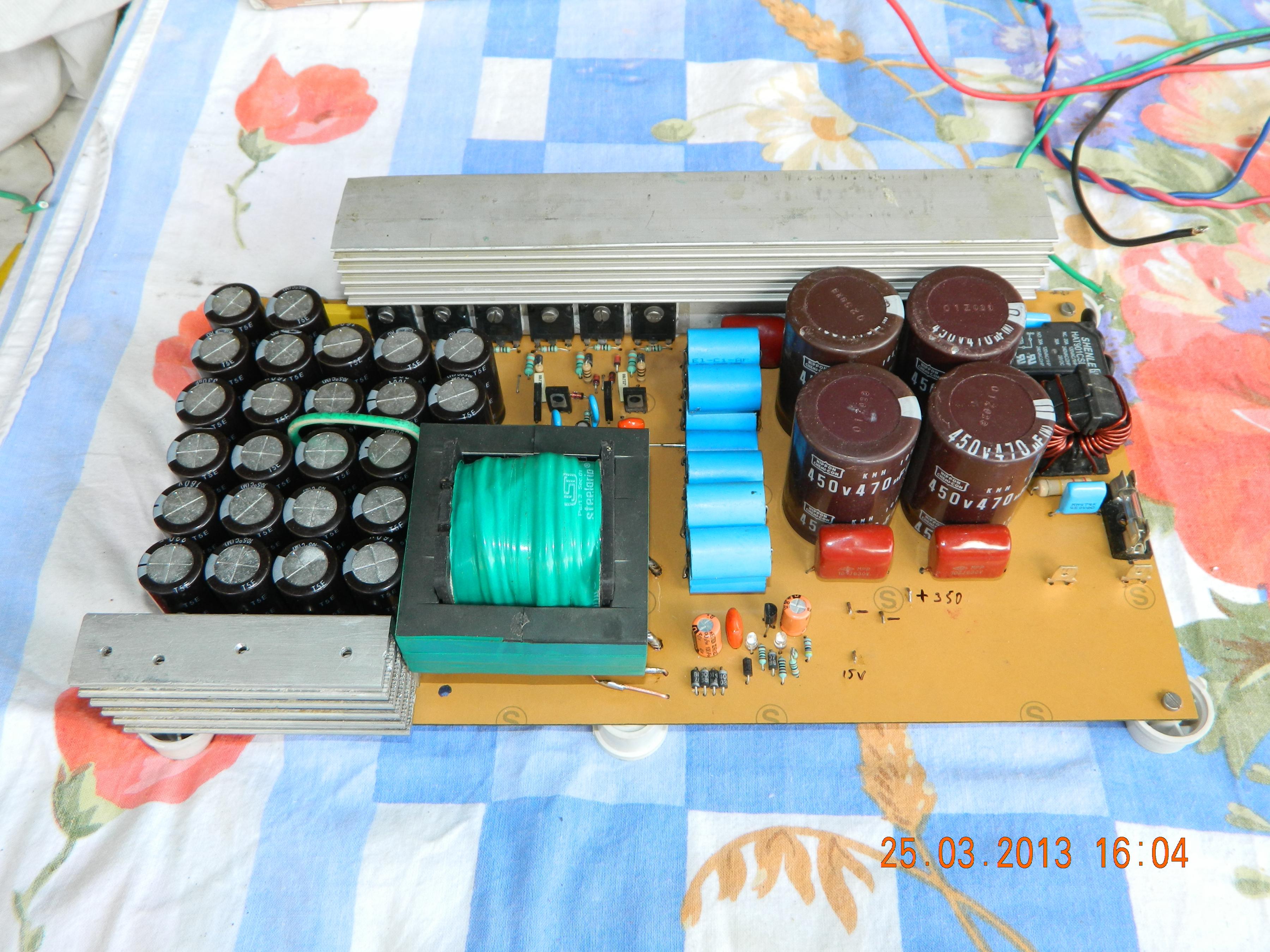

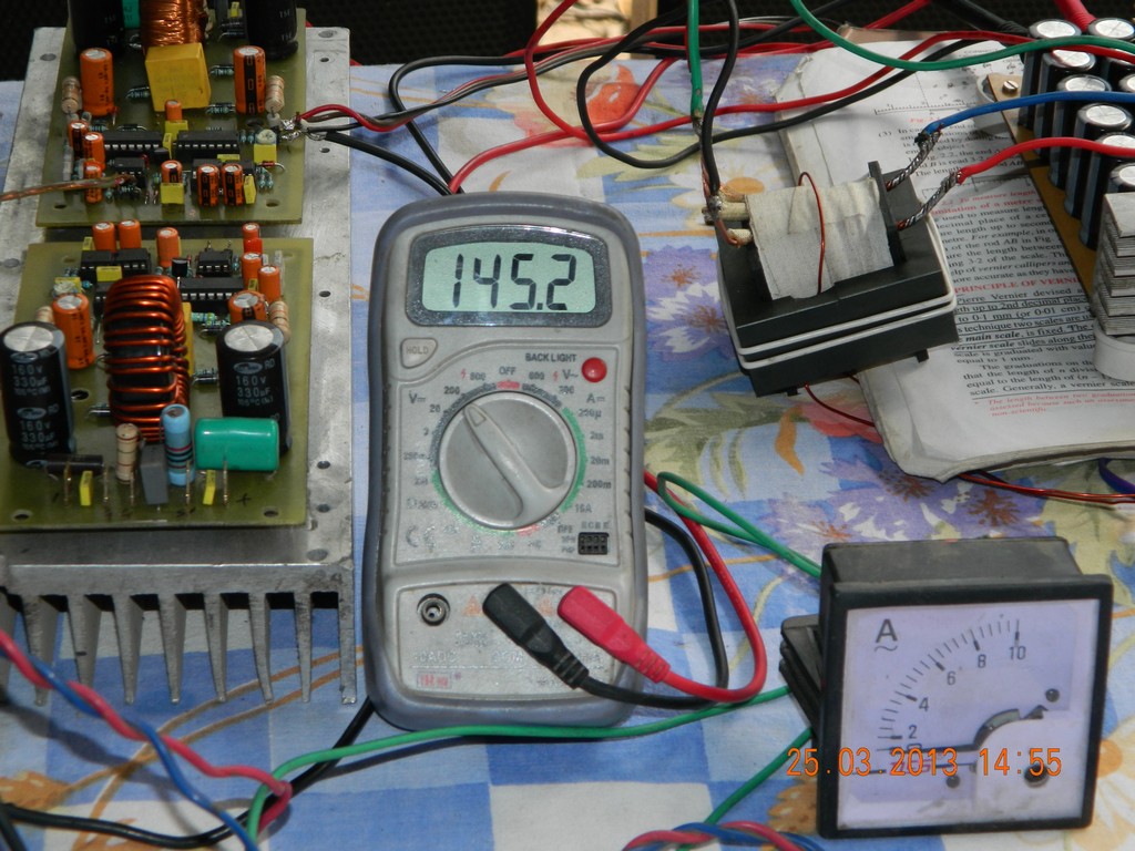

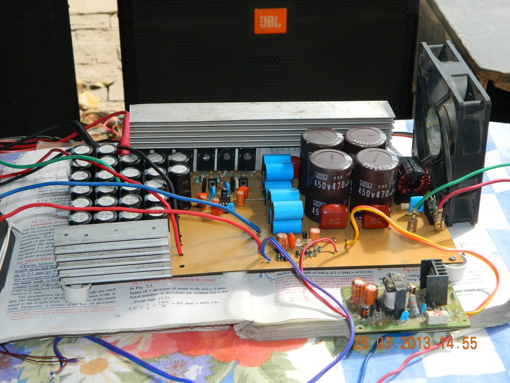

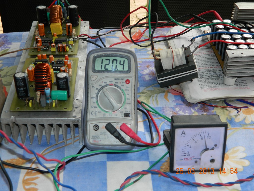

SMPS WITH CLASSD AMP
Hello
greetings some pics of smps with class d amp still to be fine tuned made by SAMEERX1 and me
warm regards
andrew lebon
