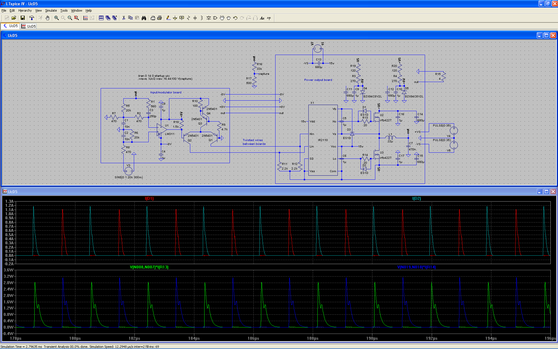

Anyone has a guess on how hot a 3A(source/sink) gate driver such as IR2010 or FAN7392 will get with 20 ohm gate resistor and mosfets with a total gate charge of 100nC at 400kHz ?
At 400ish kHz even with 30nC gate charge(IRF540) a IR2010 gets pretty hot.
Something tells me this will not even work at all.
These gate currents are scary!!

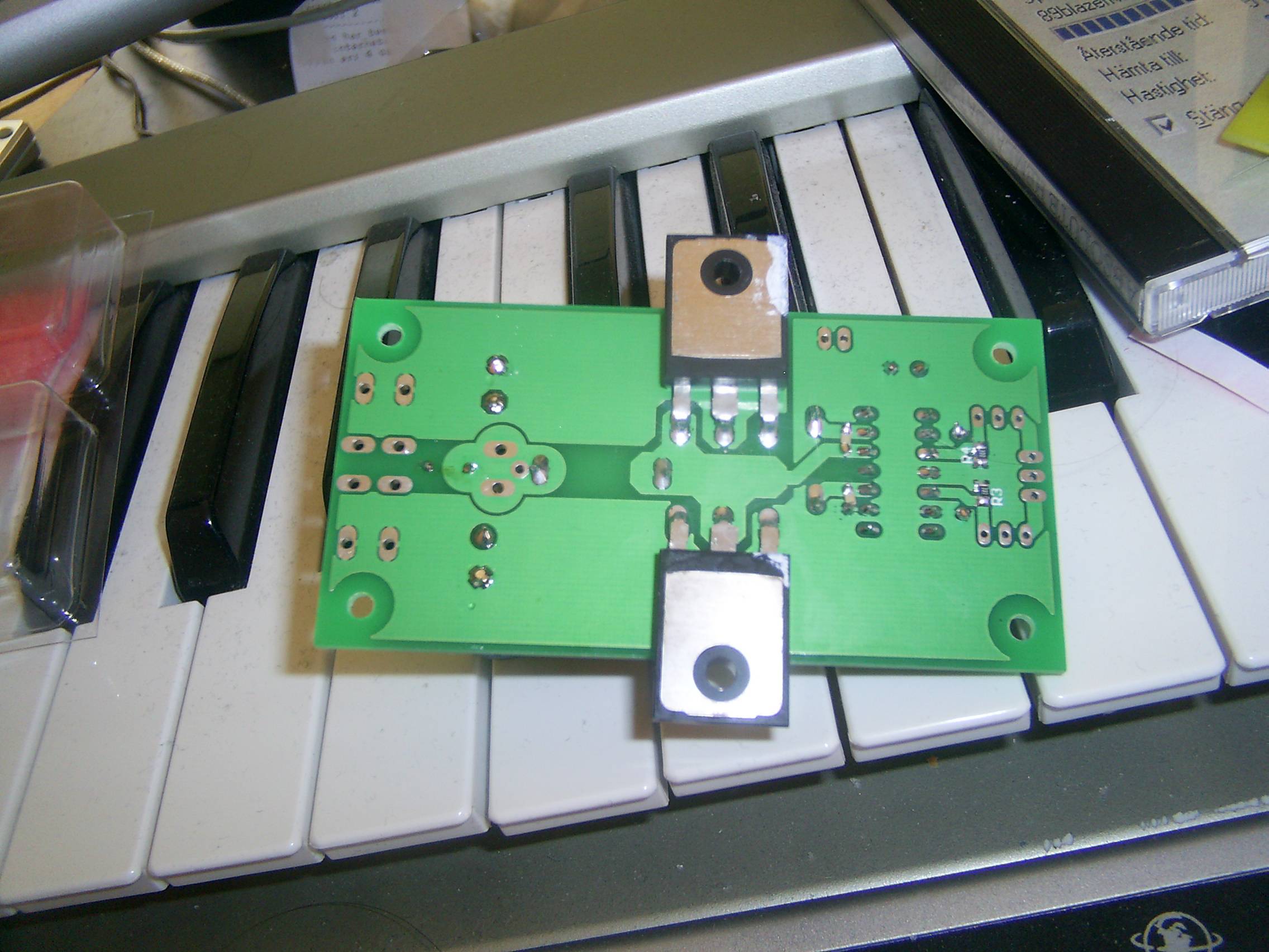

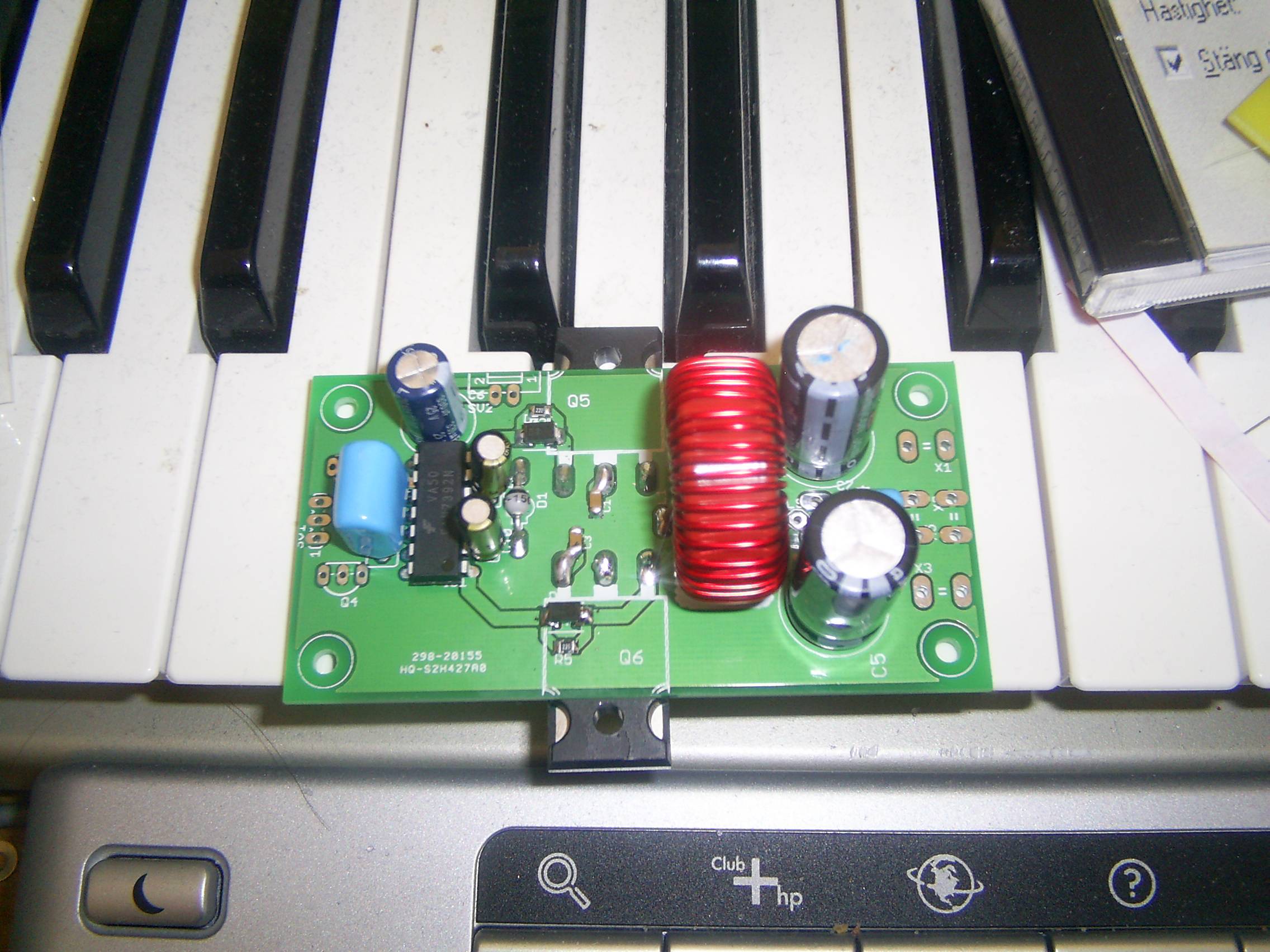

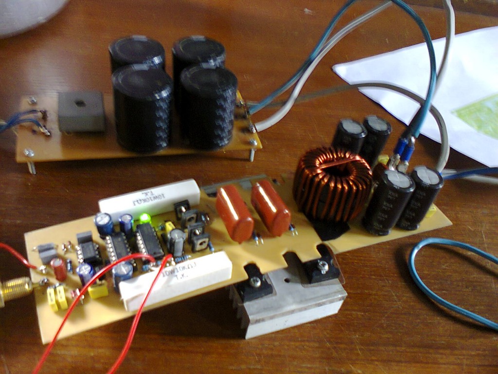

That's a darn small and compact 1200 watt class D amp if it works. Nice job! Is this the same circuit as in Post #13(around there)?
Note that this is a power module only, no modulator. However i have tested it now and at first glance i can say the protoboard prototype sounded better.
Also i do need to lower the gate resistors as on 2x25VDC the heatsink is already getting warm, but 6 minutes near clipping did however not heat it excessively.
So i halved the gate resistors by adding a second 22ohm on top of the existing one and now the amp is HOT.
IRFP150 is NOT a good dtransistor for class d!! Its quite the opposite, a clunky old piece of silicon, as soon as i get some better fets they'll be replaced.
