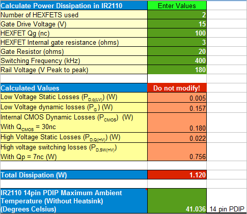

Anyone has a guess on how hot a 3A(source/sink) gate driver such as IR2010 or FAN7392 will get with 20 ohm gate resistor and mosfets with a total gate charge of 100nC at 400kHz ?
At 400ish kHz even with 30nC gate charge(IRF540) a IR2010 gets pretty hot.
Something tells me this will not even work at all.
These gate currents are scary!!
I've created a spreadsheet for calculating the approximate dissipation of the gate driver IC (based on AN-978) (Must be opened on libre office/open office) Feel free to edit if you found errors in calculation.
2pcs mosfets with total Qg of 200nc running at 400kHz is not safe without active cooling. Calculated dissipation is 1.1W (close to 1.4W max of 14pin PDIP IC case) and in reality, the actual dissipation might be worse than the calculation.
The result of the approximate dissipation shows that the surrounding air at the IC must not exceed 41 deg celsius for safe and reliable operation. I think it can be done with a heatsink on the top of the IC and active cooling to move the air around it. (Active cooling is needed because the ambient temp (inside the amplifier case) will rise when the IC or the amp itself is emitting heat)
