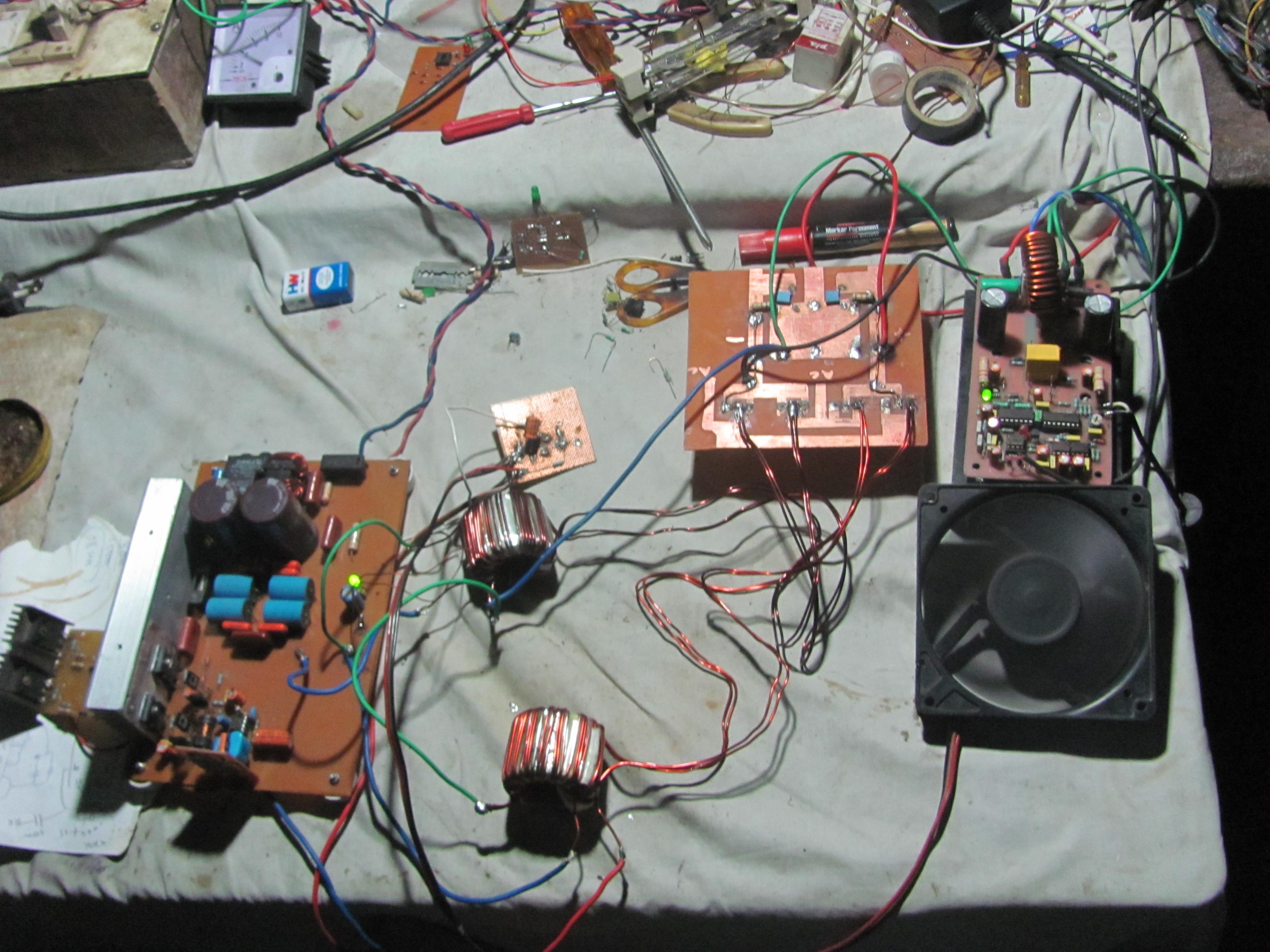

Hi guys..
so I've just finished IRS1500..but there is also a problem 🙁
please watch this video :
Class-D IRSD1K5 - No & Low Level input Problem - YouTube
when i turn on power supply..after s short delay , speaker connected to amp's out. as you can hear in video , there is a noise available at output. (input volume = 0) and when i increase volume up to 4~5%, a really bad audio signal become appear. also the active led indicator isn't bright constantly.
when i increase the volume (about 7~8 %) the amp start to oscillate and those problem solved.
guys please help me. anyone have similar problems ?

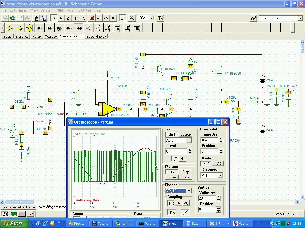

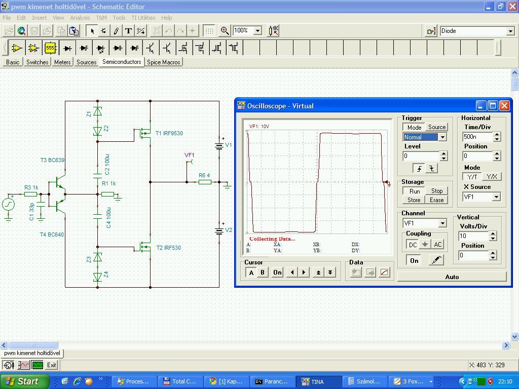

Simple D class amplifier non smd part, without feedback.
http://www.hobbielektronika.hu/forum/getfile.php?id=191446
http://www.hobbielektronika.hu/forum/getfile.php?id=191441
hi ,highand can you tell us some THD numbers? 0.0000X%? oscilating frecvency,can be made only with N chanel mosfets?
This circuit is TDH 0.1% high mark and TDH 0,3% low mark ( cross distortion). Possible to build only N-channel FET, such as Philips gate drive circuit.
