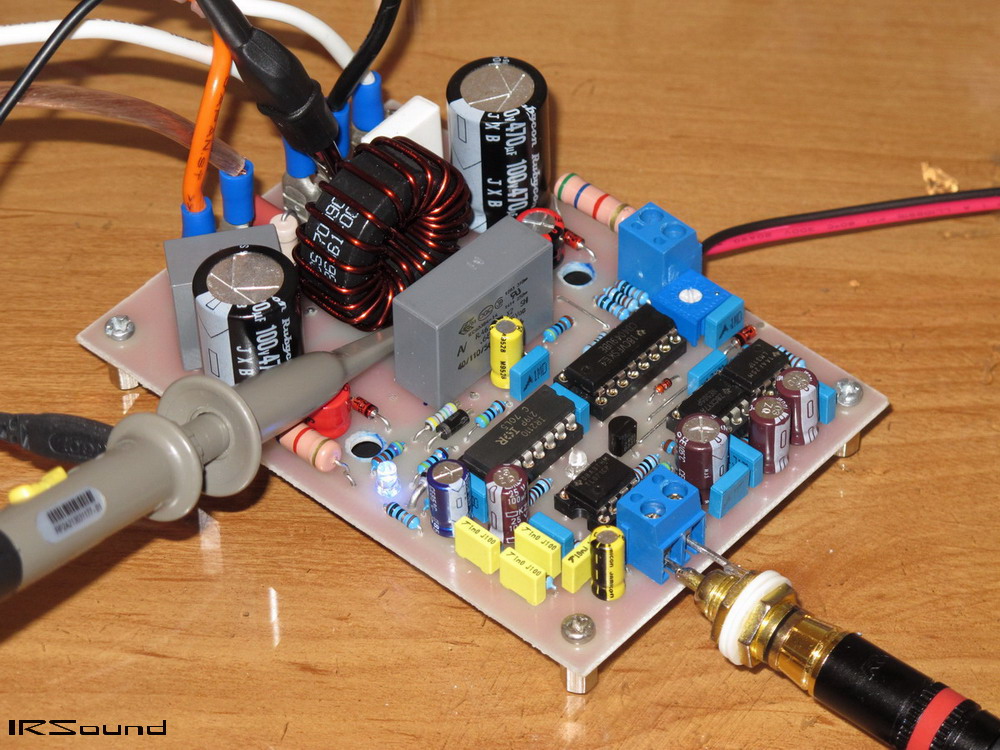

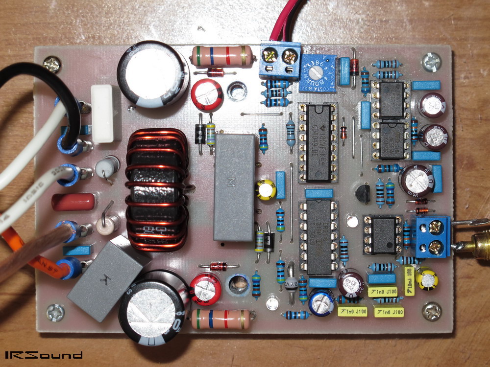

Hi guys..
so I've just finished IRS1500..but there is also a problem 🙁
please watch this video :
Class-D IRSD1K5 - No & Low Level input Problem - YouTube
when i turn on power supply..after s short delay , speaker connected to amp's out. as you can hear in video , there is a noise available at output. (input volume = 0) and when i increase volume up to 4~5%, a really bad audio signal become appear. also the active led indicator isn't bright constantly.
when i increase the volume (about 7~8 %) the amp start to oscillate and those problem solved.
guys please help me. anyone have similar problems ?

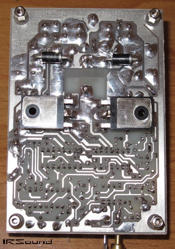

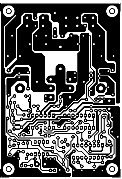

post pcb picture in high definition to see what his mistake was.

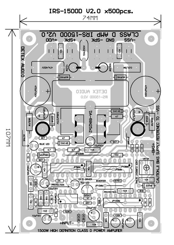

Hi Jcoelhogsia,
Thanks for helping me..🙂
this list shows the difference between my component and attached layout :
- Using BYV28-600 instead of MUR160 (beside IR2110)
- Using MUR460 instead of MUR160 after inductor
- Using 1N5819 instead of 4148 (mosfet's gate)
- Using IRFP250N instead of FDA69N25
- Using 47.5 Ohm gate resistor
and i have problem with no input signal and lower level input , like what you see in that video.

post the other side of the pcb.

pcb ok, its assembly this perfect, as you have to replace the diode mur160, what voltage are you using? My run this perfect./http://www.youtube.com/watch?v=HU4e88xkp_M
