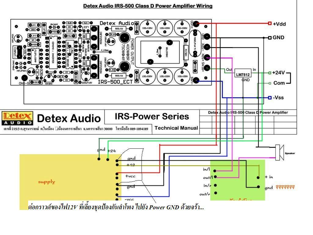

Hadi very strange irs 900 its easy work may by a cut in the out the capacitor or the inductor very strange y use various ,vmos and inductors work chek the diodes tensions and the 12v auxiliar the negative its -vrail comon and the external wire gnd to te imput

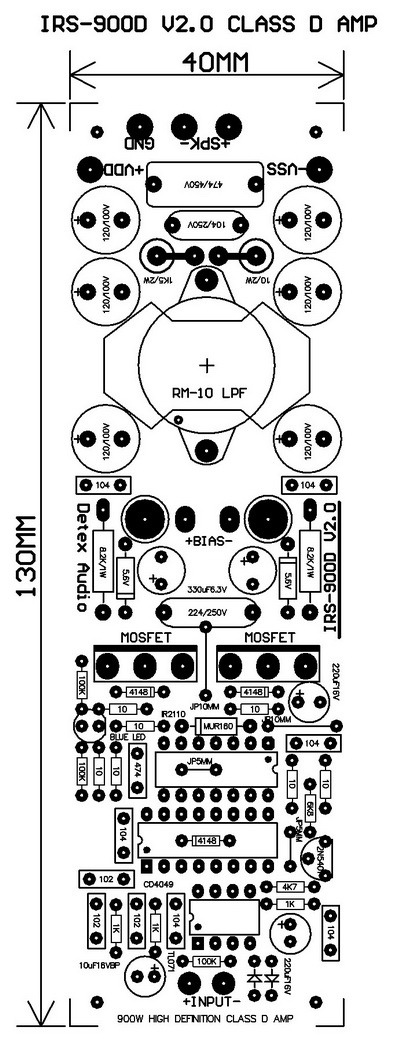

IRS900D dont work again and generate smoke when conecct input signal to car player
what part did smoke ?is your connection correct? input ground to main ground?
its weird

how can i know about cut in the out capasitor ?
i was used T106-2 and wire 0.8 mm and 43turn
i was used original lm317 board for 12 volts
i was used another power source for 12 volt board and my negative amp power not conected to lm317 negative power and not common
i dont conect my input gnd to out put or power gnd
please show to me on a picture
