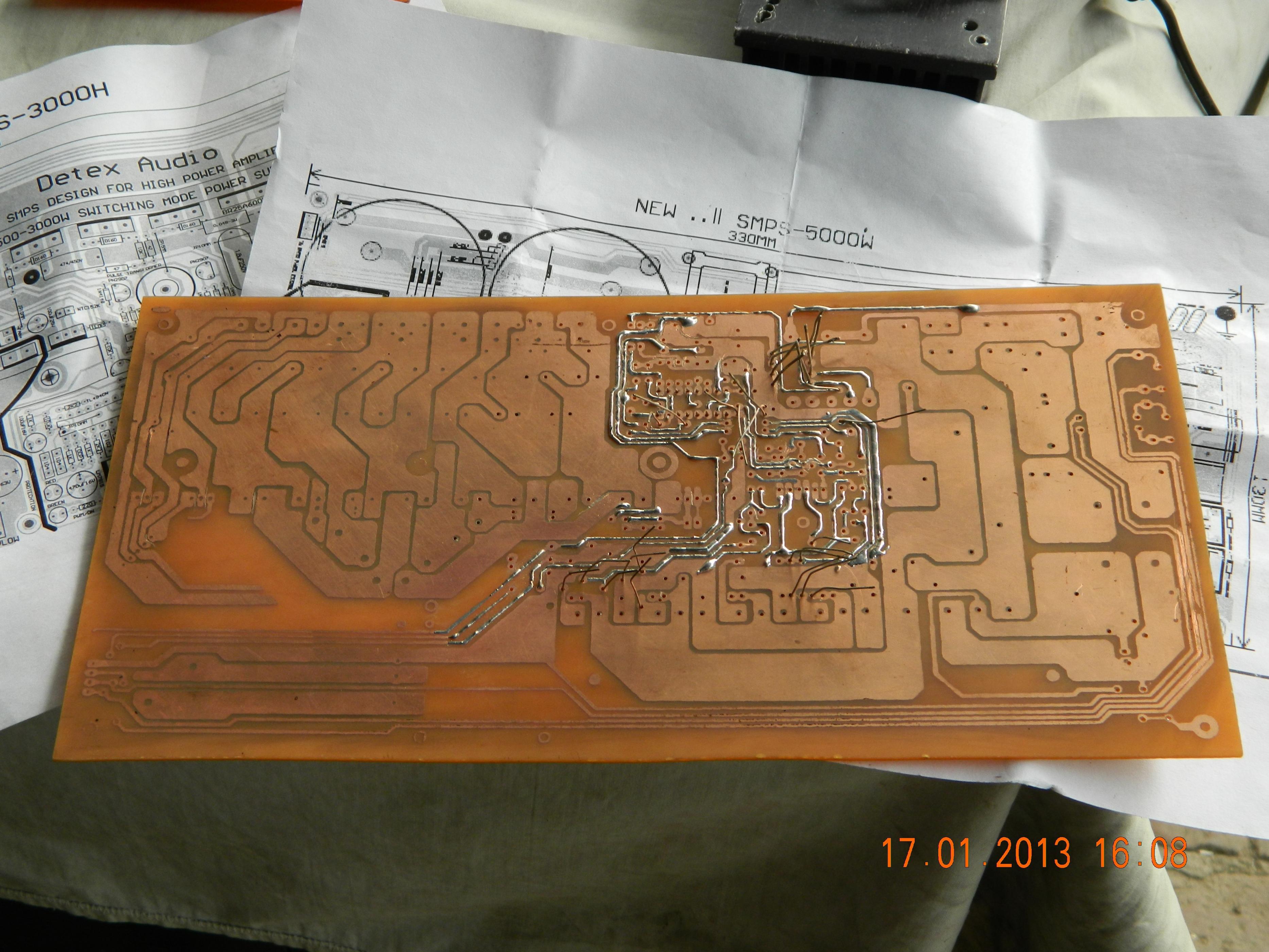

small smps under construction😉 trafos 2 heavy😎

Hadi IRS 900 its easy and work cheap material use a correct pcb and the out filter coul use
ei33 old pc with gap 1mm and the sound its very good start 45v and irf640 good choice
Hi🙂
mey be my pcb was wrong
but i dont have another pcb file
do you have it ?
i have T106-2 and dont need EI33
i was used IRF250N and 1K ohm OSC resistor
in 45 volt my IRS900 generate smoke in filter capasitor
how much power with IRF640N can generat this amp ?
