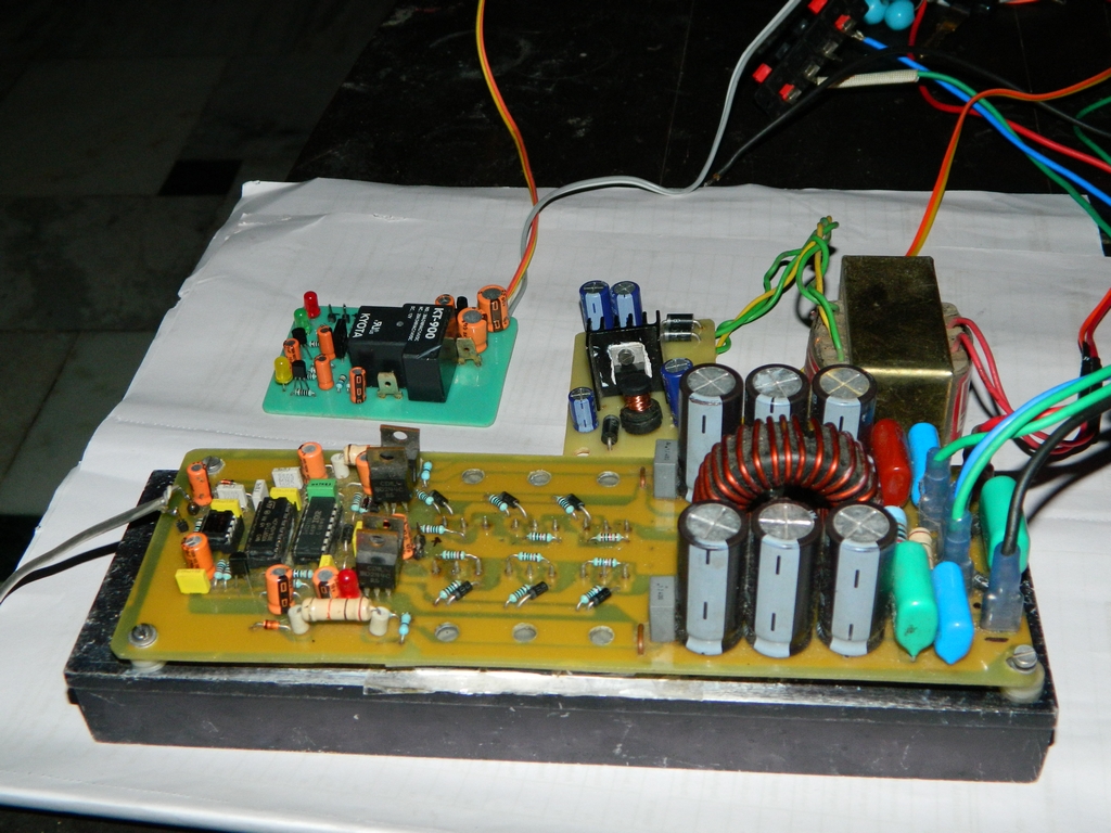

for class d filter use ETD29 core with 1mm air gap( supply +75v -75v)

[/URL][/IMG]Hi stewin,
i used 40T .85mm core 1mm gap all (@70uH) fsw=250KHz cap=2.5uF/250V, cool quite
MOSFET IRFP250N with resistor 39 Ohm.
Regards
MANOJ

what voltage? and speaker impedance? did you drive hard?

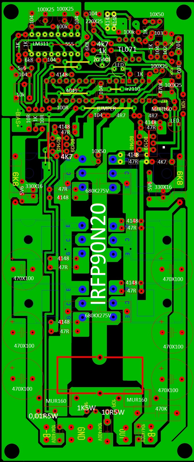

the component side side of pcb
thanks to ht forum
Hi stewin,
Voltage +75V -75V 10A
SPK = 8Ohms 300W tested
SPK = 4Ohms 600W tested
SPK = 3x 8Ohms(Parallel) 900W tested.
Input 1.3V p-p Audio signal from mixer @ max clip level (1hr tested)
Regards
MANOJ
NANOS PCB for 3 pair
warm regards
andrew lebon
Hi andrewlebon
can I get schematic from this amp ?
have only chesthap/triell 3200 1 Ohm schematic

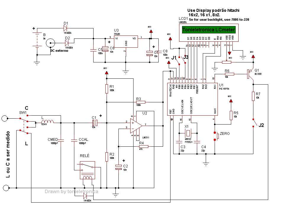

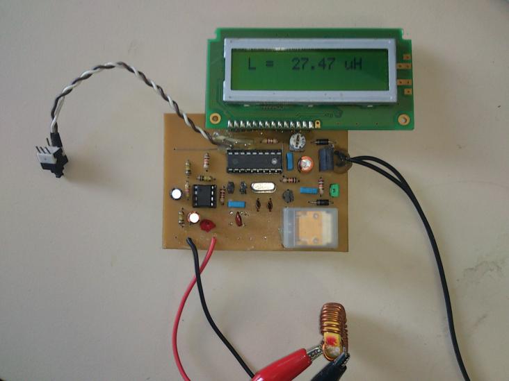

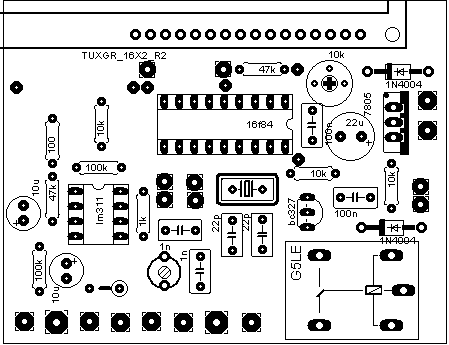

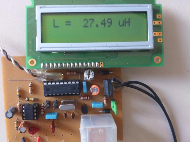

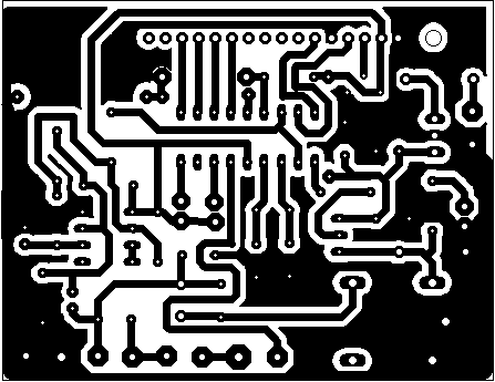

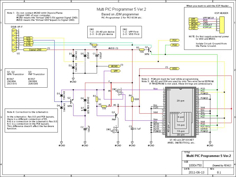

here is the inductance meter artwork, schematic and pic hex files have fun all
thanks to systemjol htforum.com

Hi Nmos
greetings no schematic exists just make the pcb and put components there are different variations all work power output depends on mosfet used trying to put dc protection clipping temprature cut off on one pcb
warm regards
andrew lebon

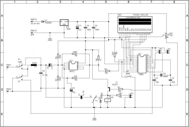

a more clearer schematic
thanks to stewin
thanks for every thinks you do for all peopel in DIY site
and thanks for clear shematic
i was buy component for this LC meter today
i will try it tomarro morning
sorry for my bad english😛we thank GOD 🙂 🙂
