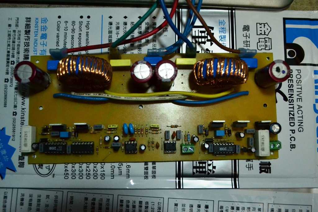

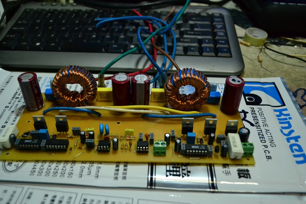

UCD 25 watts to 1200 watts using 2 mosfets

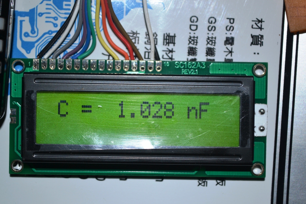

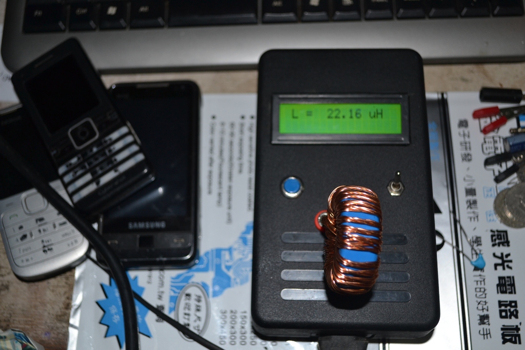

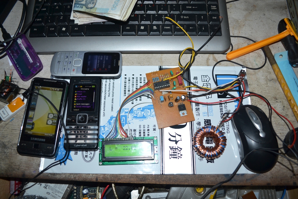

LC meter
here more updated LC meter i also made and it works well
small 100uh coil can be found on defective tv or psu

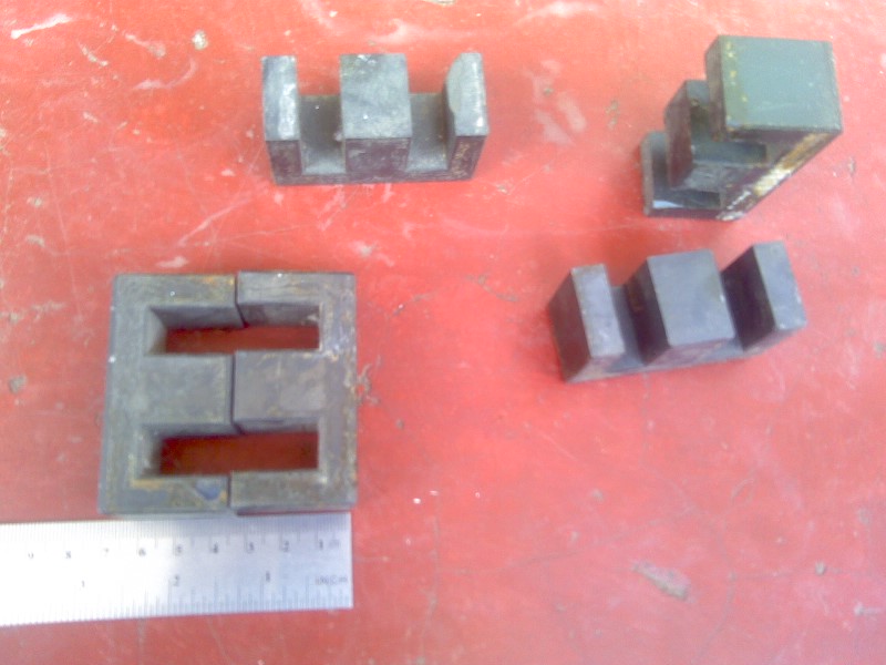

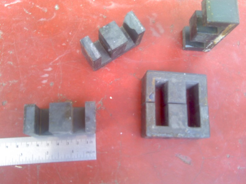

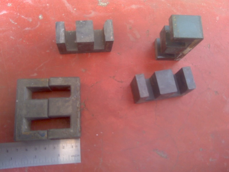

hi guys, i have these cores i think they're E65/62 cores can they work with a IGBT30n60d to produce over 5kw power? I found them in an old ups as inductors.
please help.

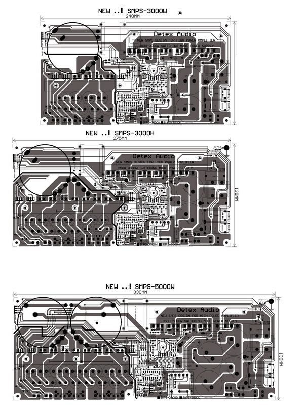

hi again mr manojtm
can you please share part list of your amp and swichin power?
it is important beacuse i do not know which of resistor are 1% for example and some of part is unknown to me.
very thanks friend
Hi Hadi,
all resistors are 5% except ** one (1K 1%) you can vary the value ex: 1K or 820 Ohm or 680 Ohm or 560 Ohm or 470 Ohm. lower the value will increase the fsw. NB:keep in mind your MOSFET(low switch ON,100nC and high speed switch) will support the high fsw.
LC value also vary when you change the fsw ex: 500 Ohm resistor L&C will be 33uH & 0.47uF/250v (fsw = @400KHz)
IR2110 pin 5 & 6 connected capacitor is 1uF/100V.(type mistake 10u/100v)
and snubber 47 ohm 0.5W with 100pF/1kv,MUR1560 & 25uH coil is an optional ( it is for EMI reducing)
Regards
MANOJ
