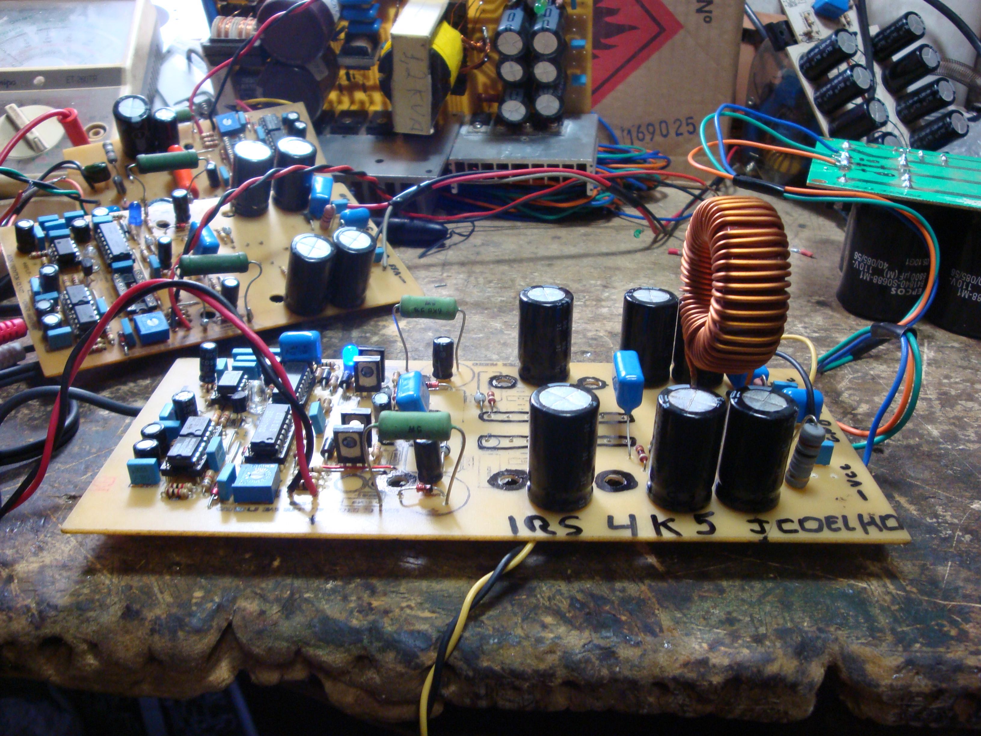

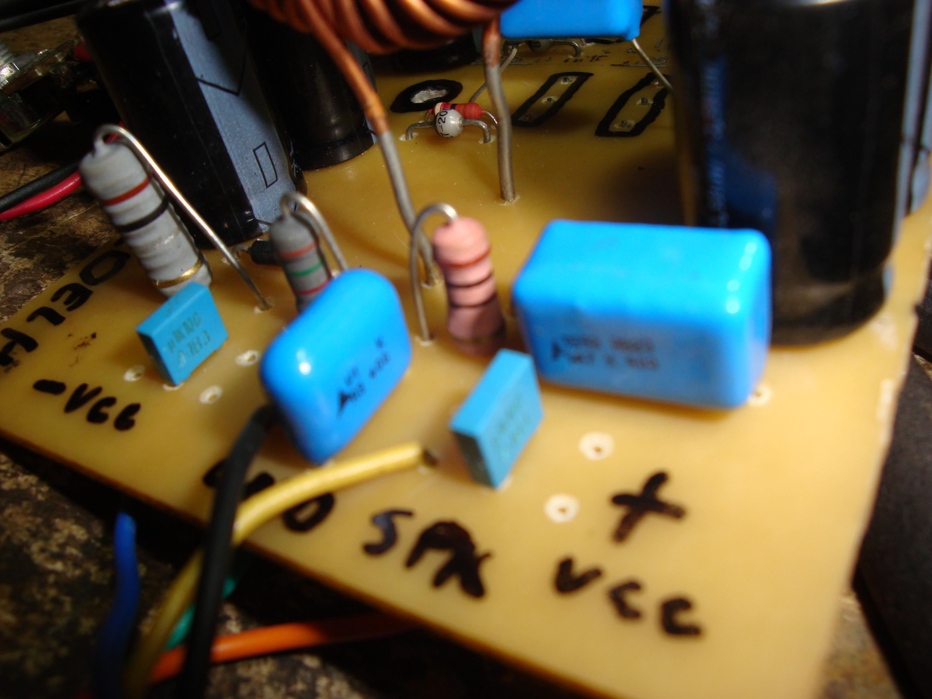

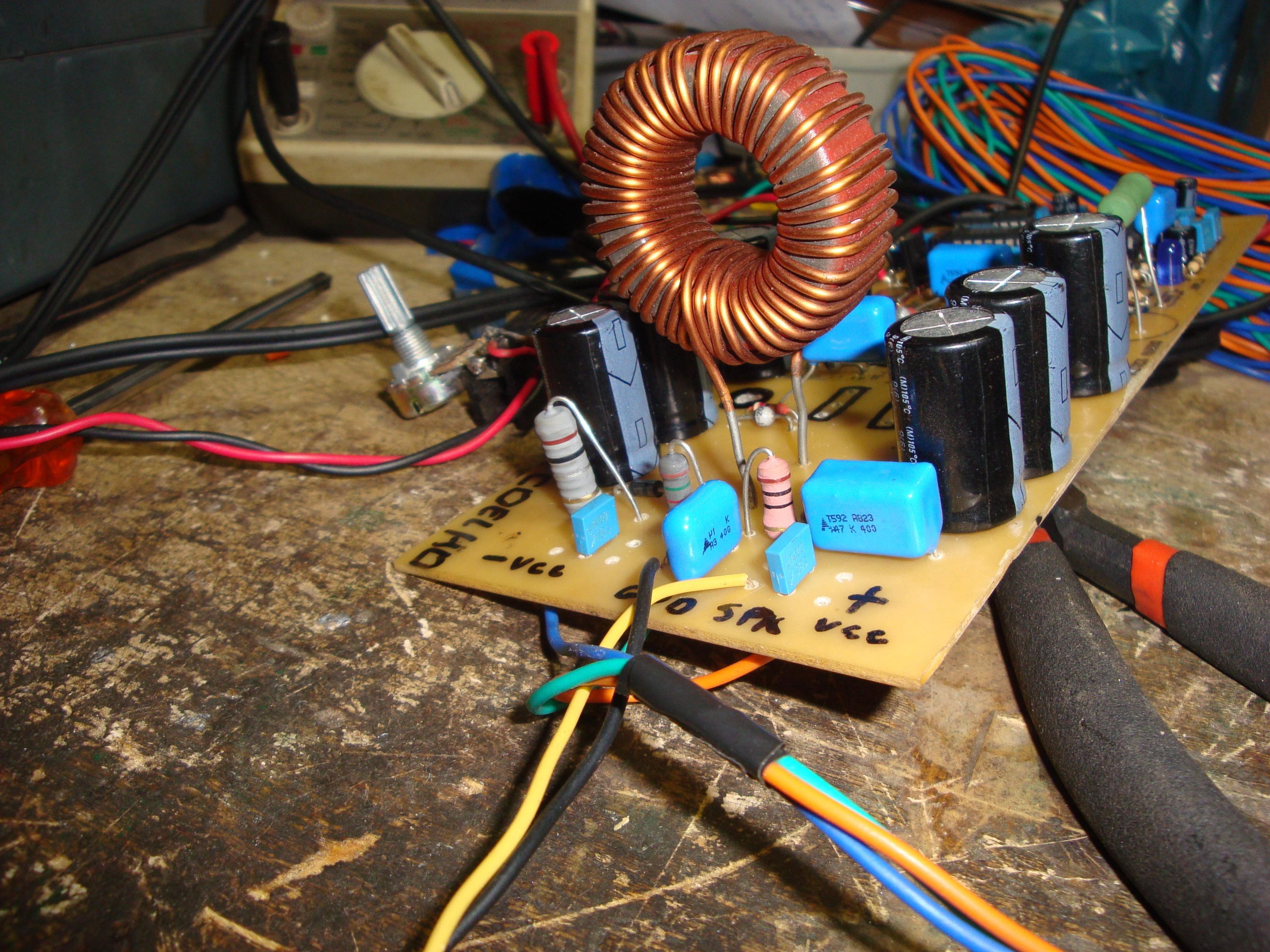

i've mentioned it already in the previous post. it's T106-2 iron toroid.Hi,
What's the size of your inductor? Is it T106 or T130?
wound with 1.5 meters of 1.2mm/AWG16/SWG18 copper wire for a total of 21-22uh of inductance.
D
Deleted member 148505
Oh that's why it's getting hot, maybe the T157 is sufficient for 900watts. 🙂
after adding the fan blowing some air to the pcb it doesn't heat up anymore. i've also rotated the top cover with ventilation hole directly on top of the pcb.Oh that's why it's getting hot, maybe the T157 is sufficient for 900watts. 🙂

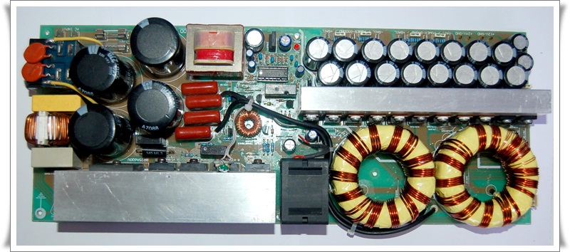

NANOS PCB for 3 pair
warm regards
andrew lebon

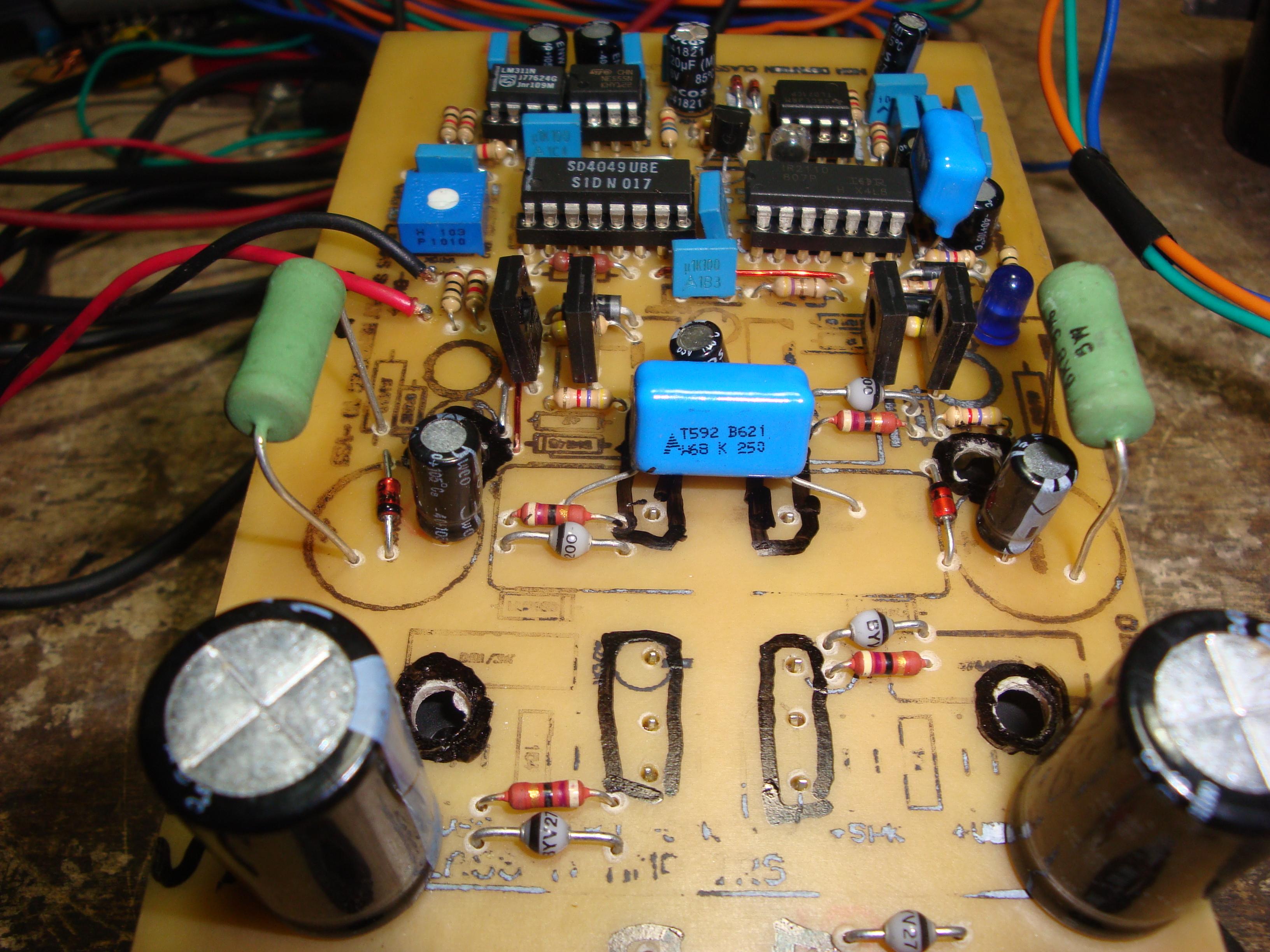

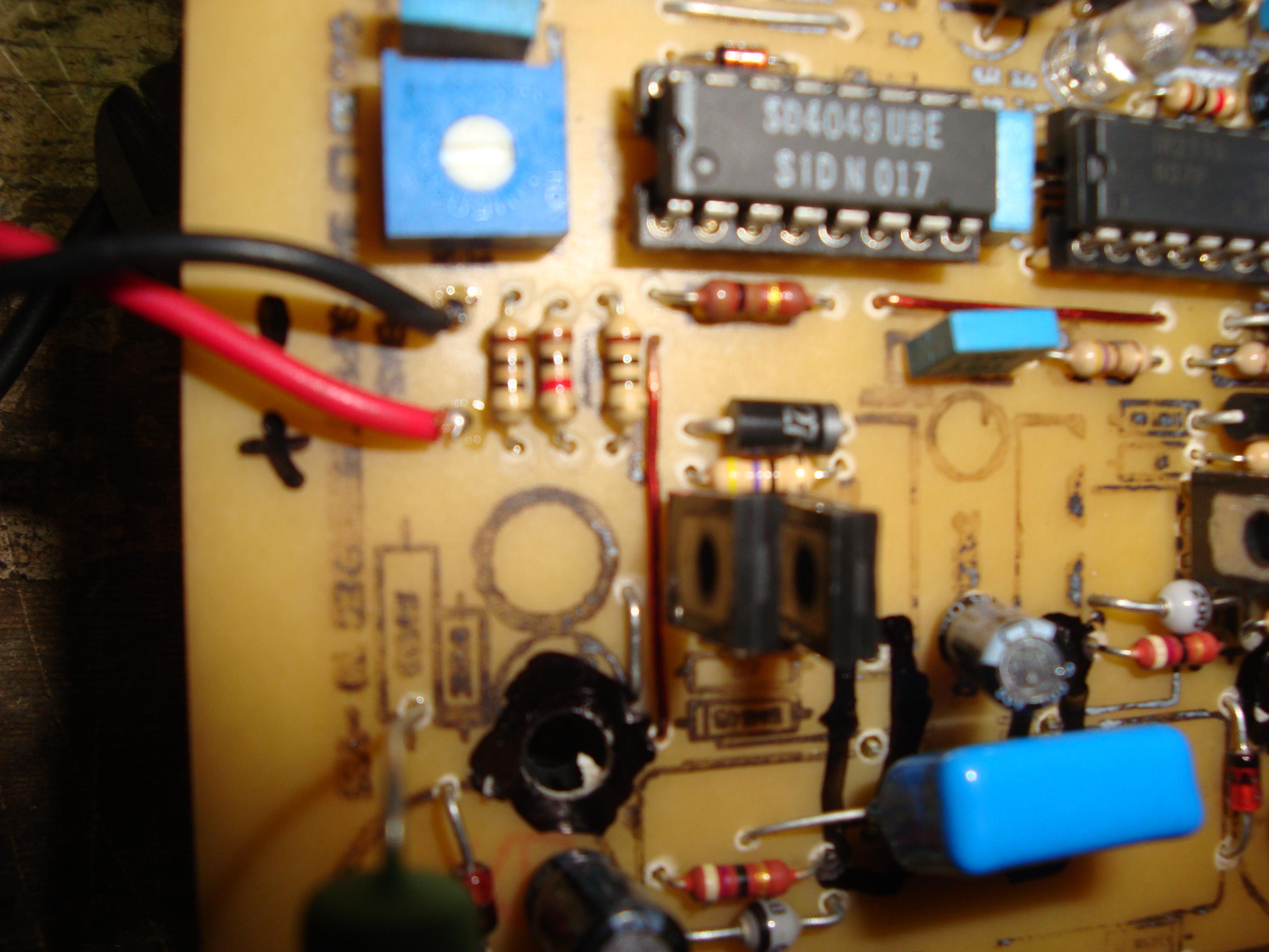

does it have overcurrent protection?
the components in the photo are not labeled, do you have a clearer one.
thanks andrew GOD bless you
sir andrew lebon can u share schem and overlayout?NANOS PCB for 3 pair
If it uses IR2110 then it doesn't have OCP because the sd pin is connected to ground... Also didn't include shunt resistor and over current sense amplifier.

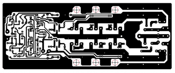

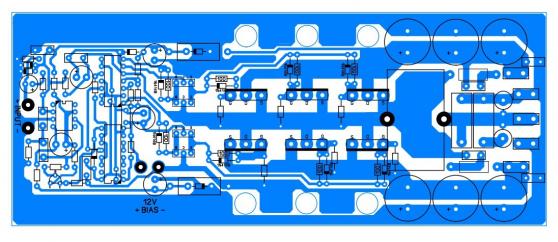

hi andrew the pcb files and schema? the one with protection, totem pole and 3pairs output.
4k5 guys
hi guys here is the best i could come up with . i hope the author can post the original schema and detailed pcb files but it works.
AMPLIFICADOR DIGITAL IRS 4K5 - YouTube
Amplificador Classe-D pg 71 lRS4K5 14....10.....2012.zip936.5 KB · Views: 1,600
Hi Stewin
greetings YES it works the pcb with bd139 bd140 is of ht forums thats why no pcb files if you are planning 3 pair fet amp CORE IS VITAL dont try gapped core wont work at high volume core saturation personally i would go for zetex trs in totem maybe this week i finish pcb protection included but totem would be smd devices

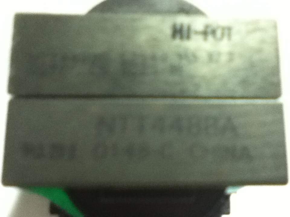

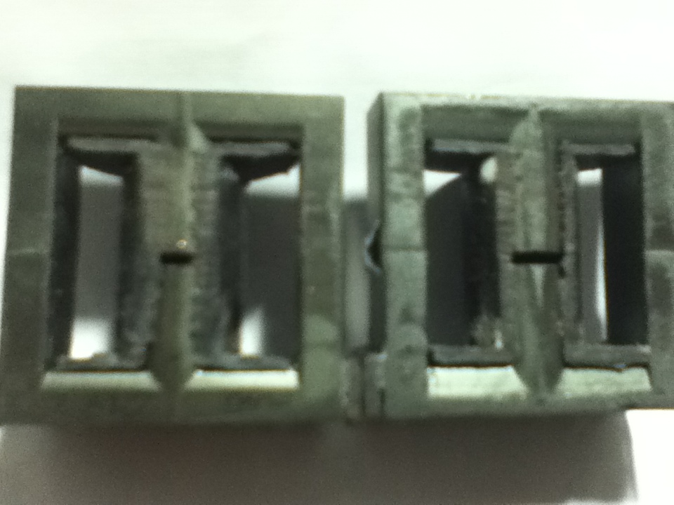

Hello Michelle and Stewin will this type of ee core will work?i'll removed this from an smps,cannot identify it.
As what? Push-pull transformer? No. Output filter? Yes. Air-gap!

thanks pafi for answering. why can,t it work in smps?
It depends on the type of SMPS. Push-pull, half-bridge and full bridge dc-dc converters require an ungapped core, whereas a flyback type requires a gapped core.
