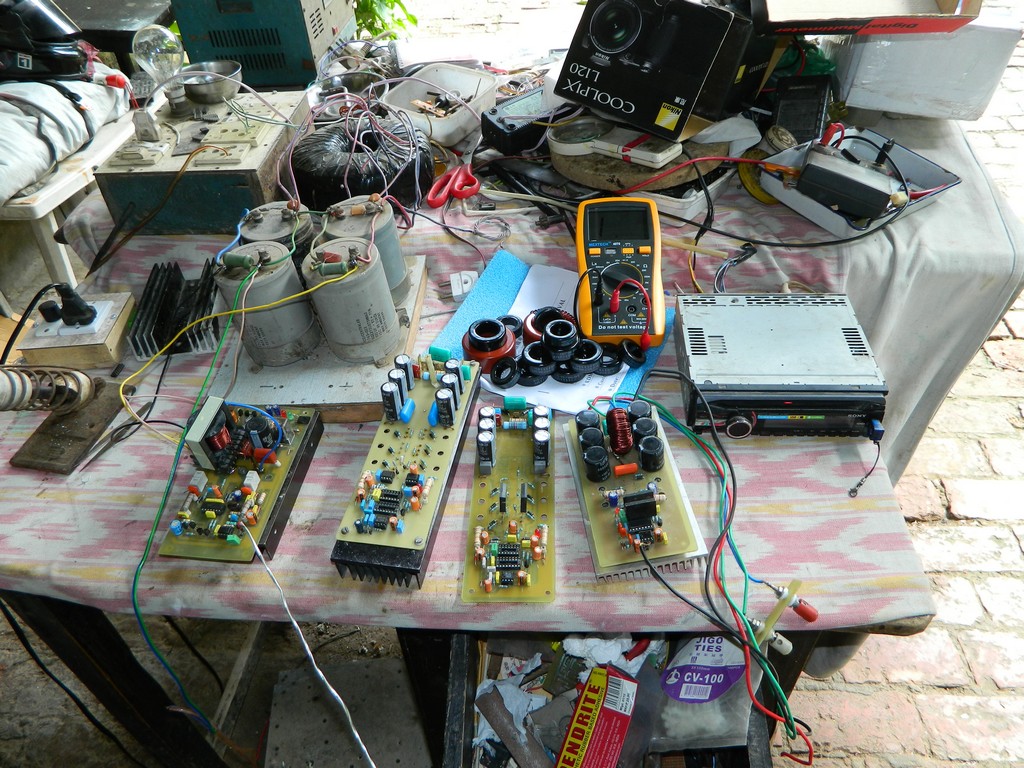

Hi andrewlebon which is better to used?totem pole BD139 & BD140 OR TC4420 for 3 pair's of IRFP260 with 47R gate resistor cause i dont have distortion meter for measurement,thank's bhai.
Hi Don2007ksa
greetings TC4420 didnt work try bd139 140
warm regards
andrew lebon
Why didnt it work ?
I use tc4420 with irfb4227's and have no problems.

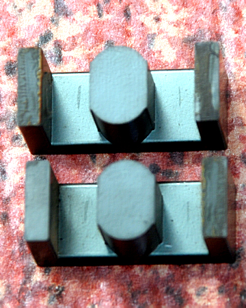

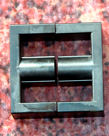

CORE SELECTION
Hello
greetings which is best suitable core for d class for power output 2kw to 3kw got some sendust cores from china sound has become clearer no heating
of core and fets lukewarm but after some time fets and ir2110 blow up
any reason for this happening for tests i used irfp250 2 pairs supply 70 volts dc+/- any clue why this is happening
warm regards
andrew lebon

Why didnt it work ?
TC4420 worked with how many pairs?
how do you explain that not work with pci TC4420 and worked with bds.
TC4420 in my test only worked well with a pair. use 2 pairs of IRFP260N as is?

greetings i used 3 pairs irfp260n with tc4420 but i try your bd139 bd140 totem today easier to get and cheaper hope it works out
