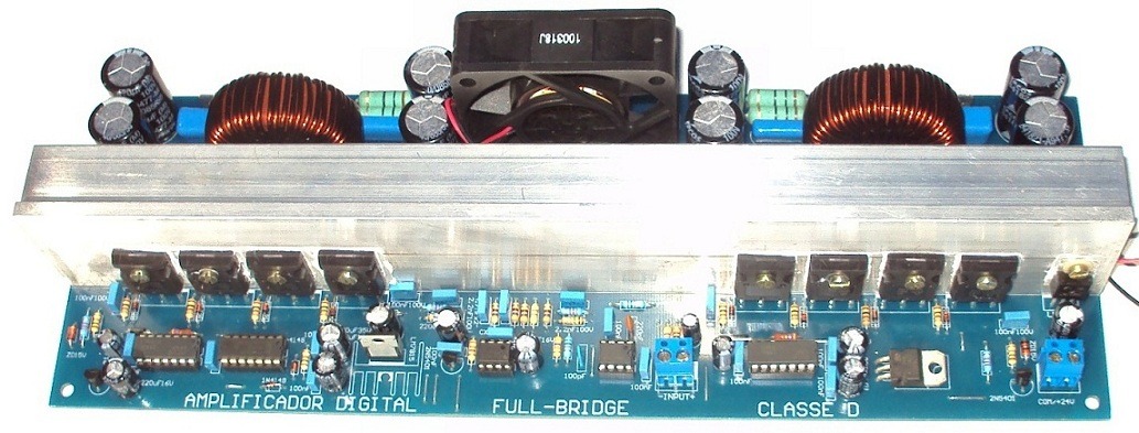

UCD 25 watts to 1200 watts using 2 mosfets
Andrew similar to working one bridge Triell, but 4vmos no 8 and use same out inductor contrafase (180degree)2 bobins
Andrew these design 100 omhs gate irfp250 no problem to ir2110. better design irvynejay totem pole and 4 pairs ofcourse.
These type design poor bass response, but big power and no buss pumping efect.
