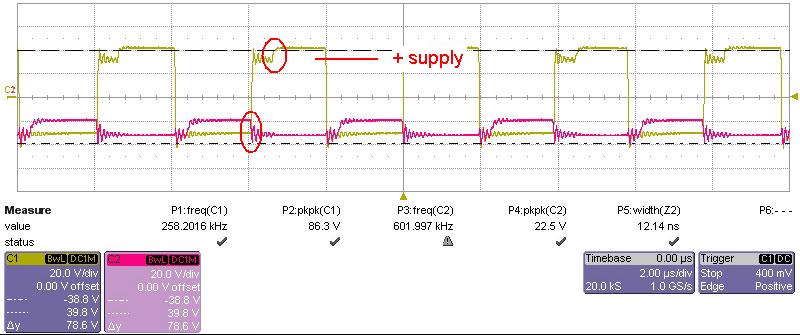

guys, anyway suggestion to improve the irs900d performance? i've used the original irs900d with some extra caps bypass but still sticking to the original tl071, cd4049, ir2110 but with irfb5615 and 20uh i got these at the output:
at the mosfet gate:
at the inductor input:
initial testing done at +-30V using uf4007 and 1n4148. gate resistor is 10ohm. the amp plays fine without distorting but just wondering if the result i'm getting is optimal?

Look at the gate drive's supply, measure first the largest spurious swing at the gate pin of the FET. Then select cer-cap to comply resosnance frequency.
Then take new curves. And now the largest again, put that MLCC in between driver power supply pin and previously chosen cap. 3 different is enough. you increase efficiency many %!!! and that serial res, lower that to 3R or so...
guys, anyway suggestion to improve the irs900d performance? [...] the amp plays fine without distorting but just wondering if the result i'm getting is optimal?
Dead time seems to be very high (400/200 ns), this leads to distortion, however feedback tries to compensate it.
P.S. Nice to see someone who does measurements, and posts it!

i don't. though i could try and ask around for it. issit important to have one?Do you have isolated probes?
Hi,paskal9 does by not changing the RSS(8k2) will not affect the whole circuit?cause you're using -/+30,for your initial test. i think 8k2 is for -/+ 90v please correct me if i'm wrong.thank's.
supposedly, yes. but i measured at the TL071 rail and got 4.5V something from using 4.7V zener. so i assumed that the TL071 still get enough voltage for it to work.Hi,paskal9 does by not changing the RSS(8k2) will not affect the whole circuit?cause you're using -/+30,for your initial test. i think 8k2 is for -/+ 90v please correct me if i'm wrong.thank's.
Hi Pafi
how you say that 400/200 ns . picture shows 12.14ns (1st picture at the mosfet gate)

I don't know what is Z2, but I doubt it was the dead time.
The high side gate voltage is added to the output voltage! I indicated actual turn on and off transitions on this picture.
Measurements shoud have been made referenced to negative supply, as close to lower mosfet source (or IR2110 GND) as possible. With NOT grounded oscilloscope, of course! Probe grounding lead should be as short as possible.
Yes,because you have connected oscilloscope ground to switching bus..Upper mosfet waveforms are not valid without isolated probes

tq for the clarification. i was wondering why the high side signal is higher than the low side all this while. Z2 is a previous function that i've since removed.I don't know what is Z2, but I doubt it was the dead time.
i'll try and scout around for any isolated probes. but slim chances that i'll be able to borrow one.
but from the measurement done i think it's apparent that the dead time could be reduced. any idea on how to optimize the dead time for the design?Yes,because you have connected oscilloscope ground to switching bus..Upper mosfet waveforms are not valid without isolated probes.
Show point B with 25 us time div to see deadtime before ir2110.From the measurement done i think it's apparent that the dead time could be reduced. any idea on how to optimize the dead time for the design?
i was afraid someone would say that. i guess that means the dead time are directly affected by the propagation delay time and transition time of the inverter, right?Show point B with 25 us time div to see deadtime before ir2110.
so there's no easy way to change the dead time other than playing around with the VDD and VIN, right?
Unfortunately CD4049 is not an ideal comparator, it has a quite low gain (transfer characteristic is not square), this means when it is fed by a slew rate limited signal, then the delay is more, and depends on the slew rate. Measure A also at low time/div! (2 us/div, during normal operation!)
2 more stages of inverter can fasten the transition, and then you have to set a dead time somehow else. CD4049 output current is very asymmetrical, this is a chance to make asymmetric delay = dead time. But first you have to make a correct square!

A way to achieve faster transition is to provide more gain at level shifter. Use lower emitter resistance + z-diode to maintain operation point! A current generator (with j-FET) can be useful to limit max current.
