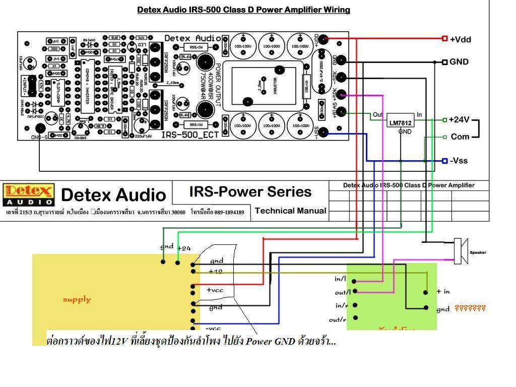

greetings want to try your ir2092 hows sound and power output with FDA90N20

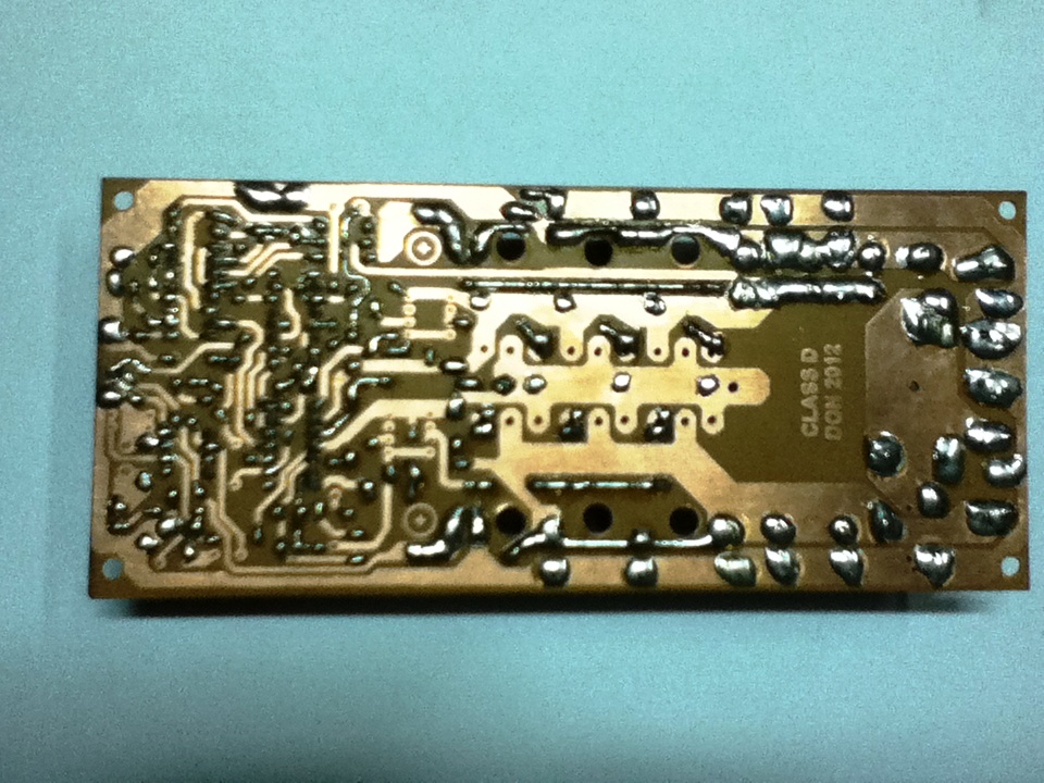

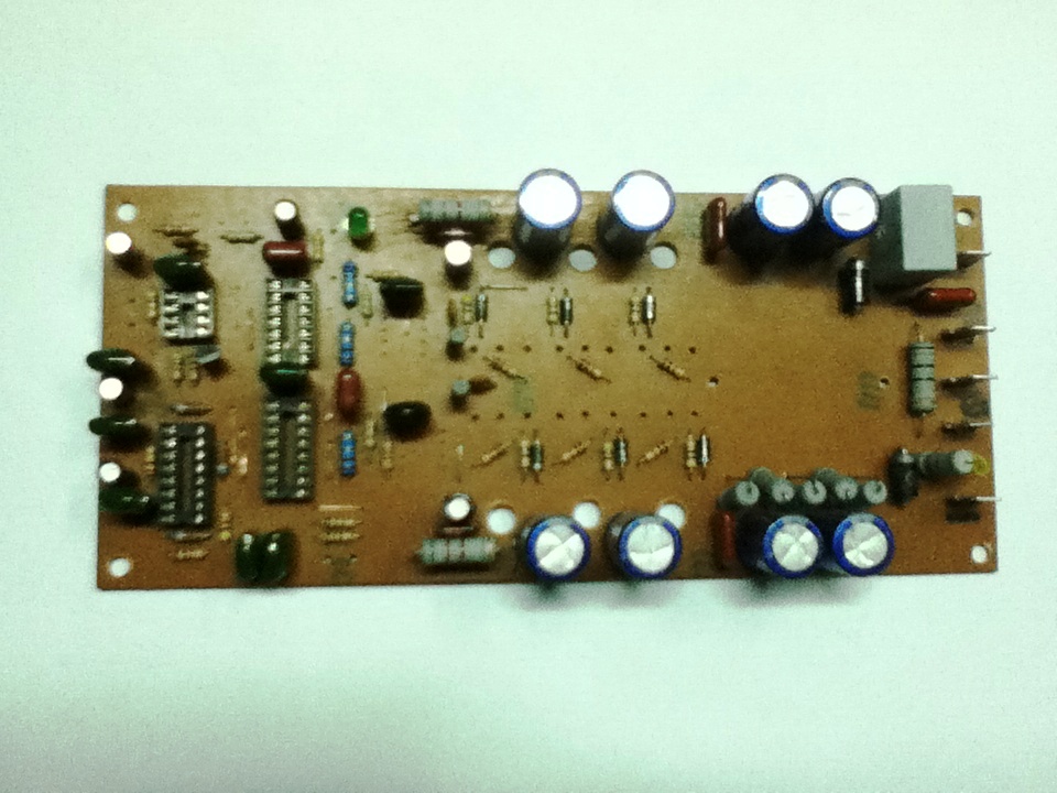

Hello Don
greetings nice to see your pcb hope it works out what values are you using as current sensing resistors is it .1 3 WATT into 5 for your 3 pair version

waiting some part's almost done.
Hello Don

Yes andrewlebon,(.1RX5) and maybe on my OCP res. say 220r,for around 20 amperes current limit.and i'm going to used BD's for my buffer as what you've said it's cheaper than TC's and it's easy to find here,hope i can finish it ASAP,thank's.
the BDS will work better in totem configuration my next project designing pcb for it

the design is stable with other mosfets. i've tried it with irf540n and irfb5615 and they're both stable.Jlester IRS900 use irfp264
do try the irs900d. you could just use 1n4148 for all the diodes except for the bootstrap diode nearest to the ir2110. 1n4148 should be easily available locally to most people. use 27-30 ohm gate resistor and you should reduce the mosfet and ir2110 heat.hi to all,
help me to design class d amp 500w using ir2110 i will try to many time its will fail. will try irs900 but is get warm in ir2110 so pls give any suggestion to make success full class d amp or give no error class d amp schematic.
also it makes much sense to run two of the irs900d bridged if you're thinking of drawing high power from them.
