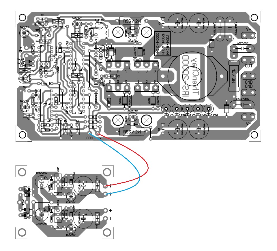

Do yuo also have DIY files for the 12v bias regulator of IRS900D?...
thanks!

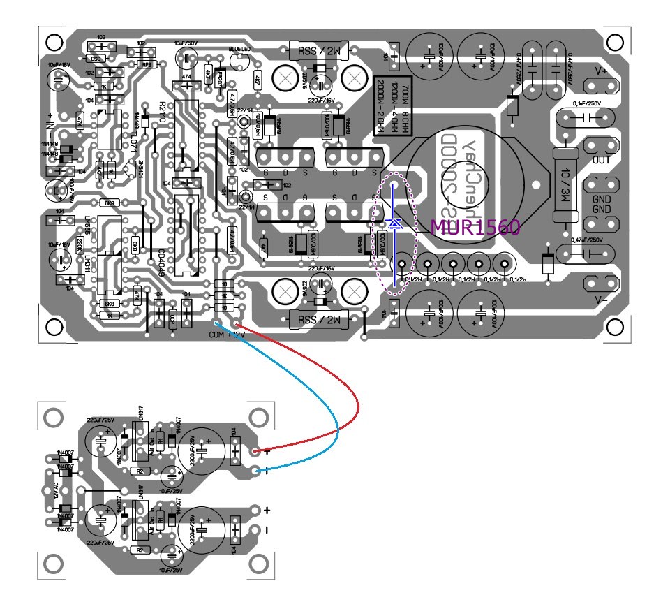

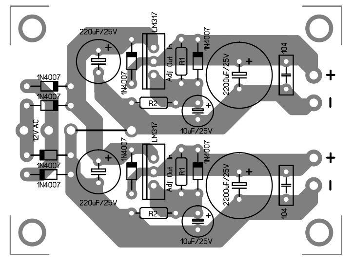

Yeah , i used LM317 for 1 Channel .
This my Layout and PDF file 🙂
Regards

Hi
+ (12V) on Regulator Board connect to +12V on Power board
.... and - (GND) on Regulator Board connect to COM (V-) on Power Board .
GND of Regulator must be connect to V- on Power Board .
