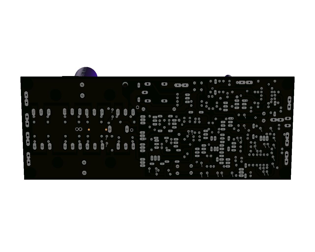

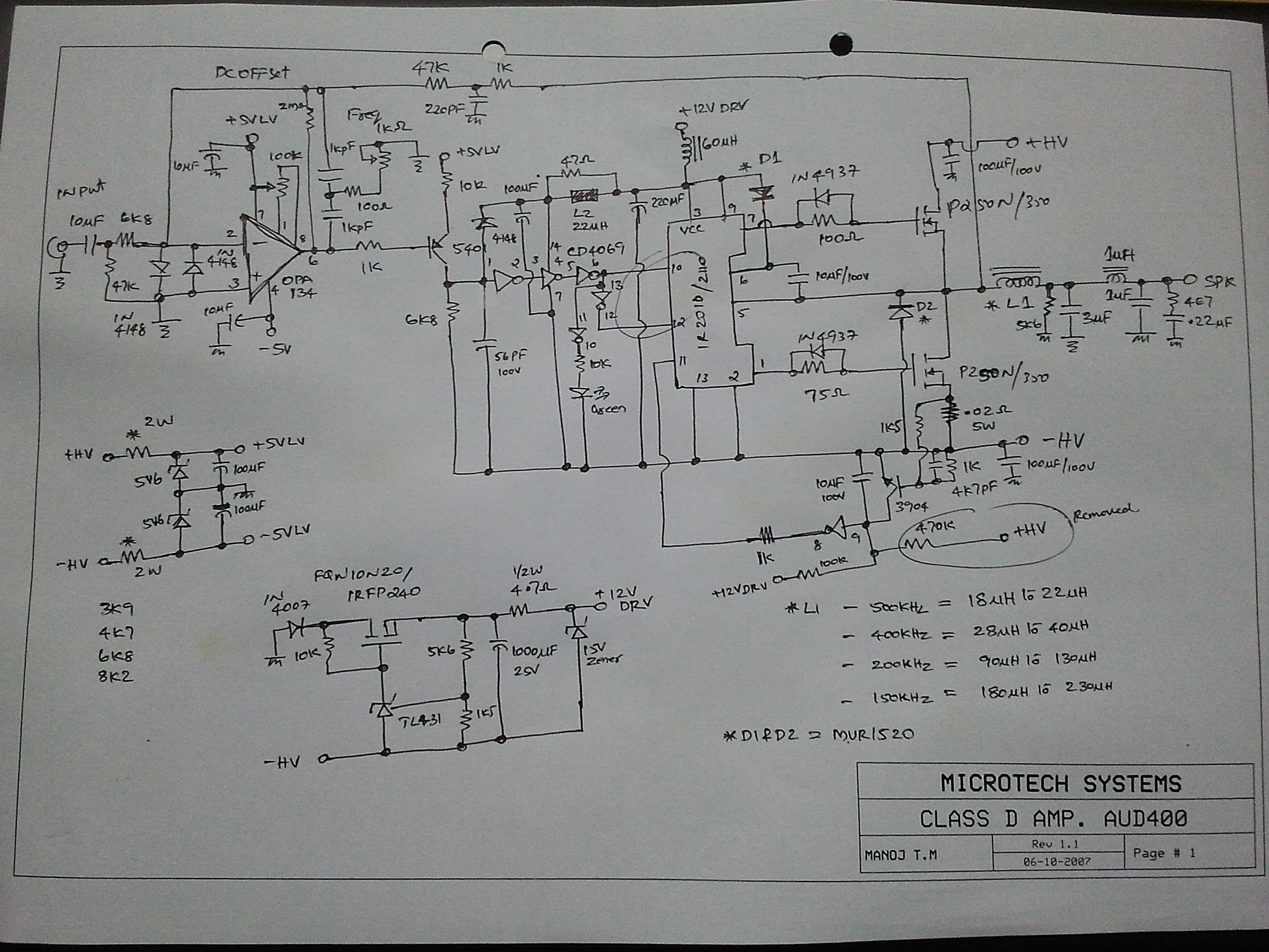

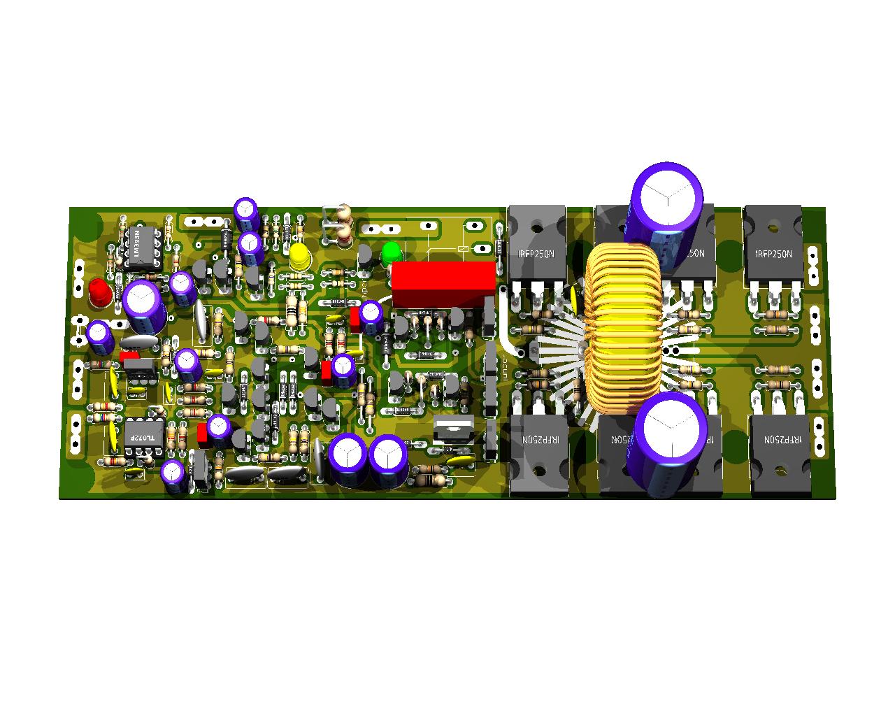

Hi stewin,
My old design, i was tested with common PCB and sound not good more noise so i discarded my design change to carrier based one. i use some part for my new class d.now i saw this thread it is great.so anyone can change this and design a good PCB don't ask me why i change L1 value(changing uH sound is good)some mistake is in my schematic i know that.Good luck

what voltage did you use and was the outputs heating ?![]()
i use only 60 0 60vdc at 8 ohms. the mosfet still cold without heatsink only inductor coil has slight heat🙂

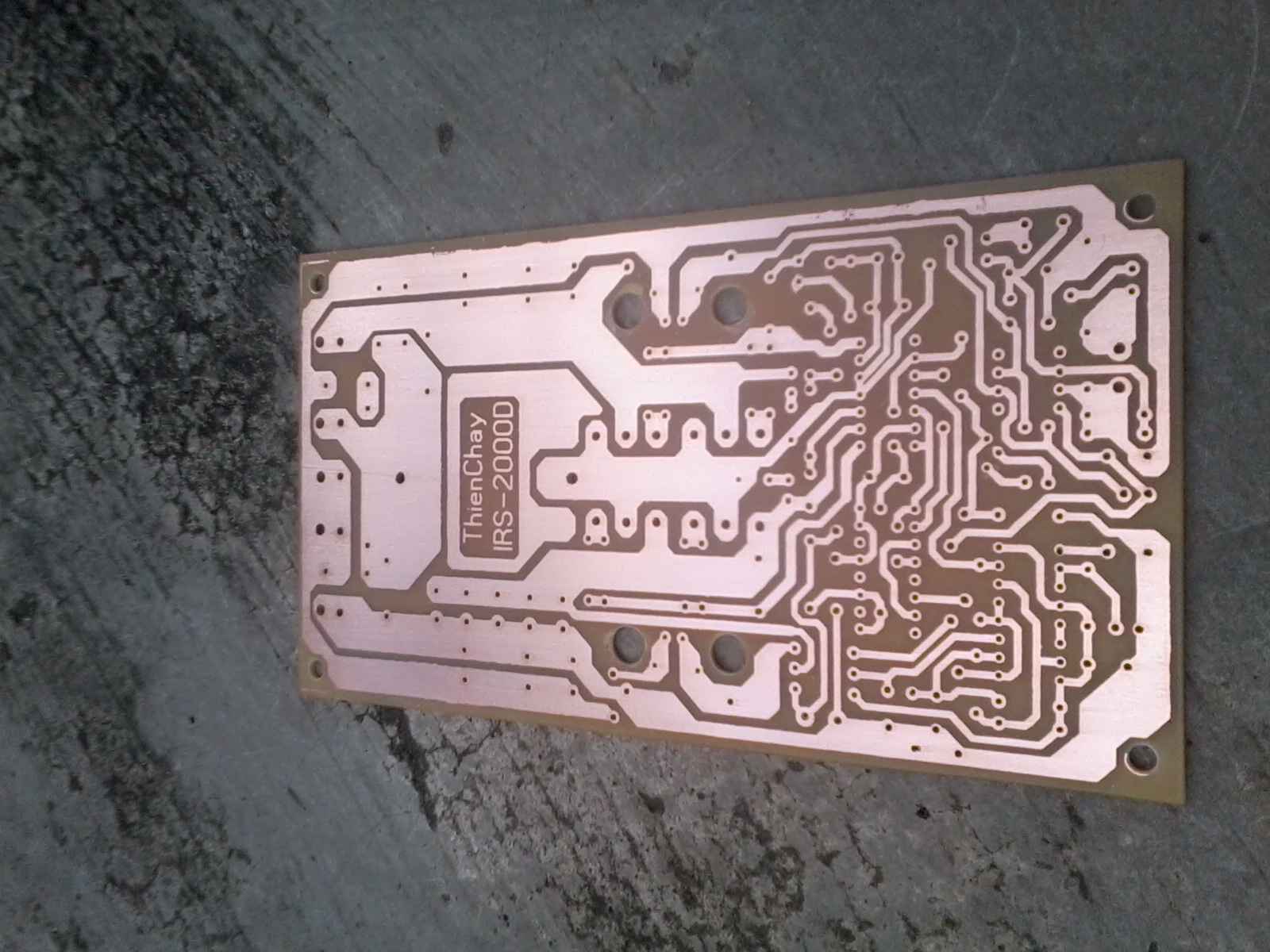

willing to share the schematics and pcb? looks like 2 pairs of mosfet with totem pole.My New PCB , IRS-2000D , will be IRS-3000D if used +/-130V 😀 .

Yeah , 2 pair mosfet for 1 channel , will load 2 Ohm at +/- 130V max , 3000W .

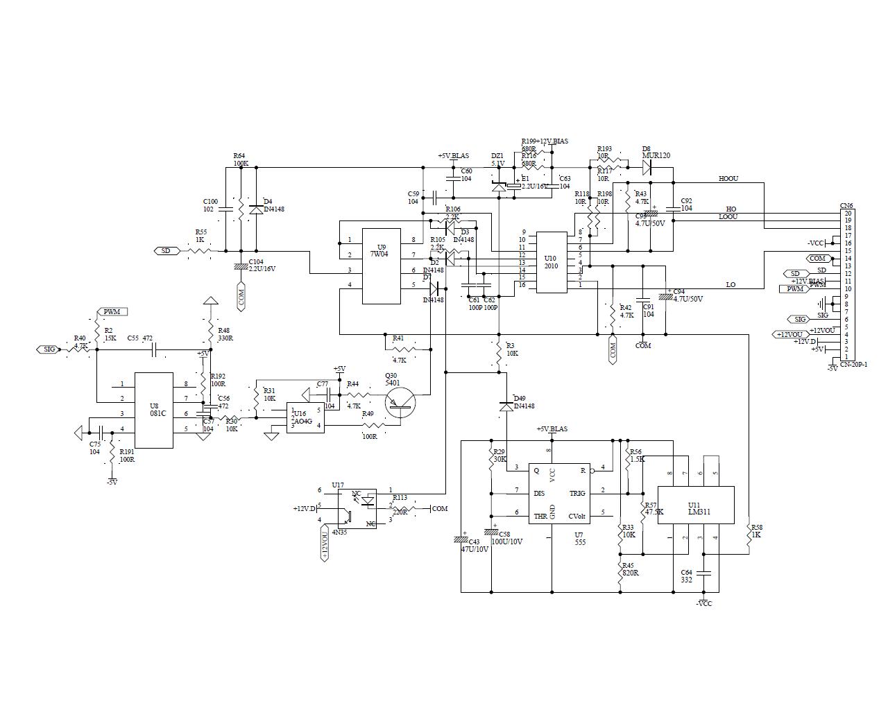

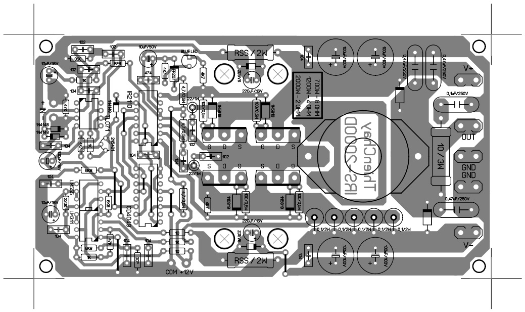

I'm not yes draw the sch , i can share my PCB , i'm remake of Detex IRS-3000D .
This is Layout
are you sure it will work with that voltage?? what fets are you planning to use?? 😀
Hi thienchay,
you are not connected a diode from junction to -VE rail it is must for class d amp
Your PCB is look good

That information from Detex 🙂 .
I 'll used IRFP460 .

Thanks , you can show me that . Maybe i have some mistake 🙂
