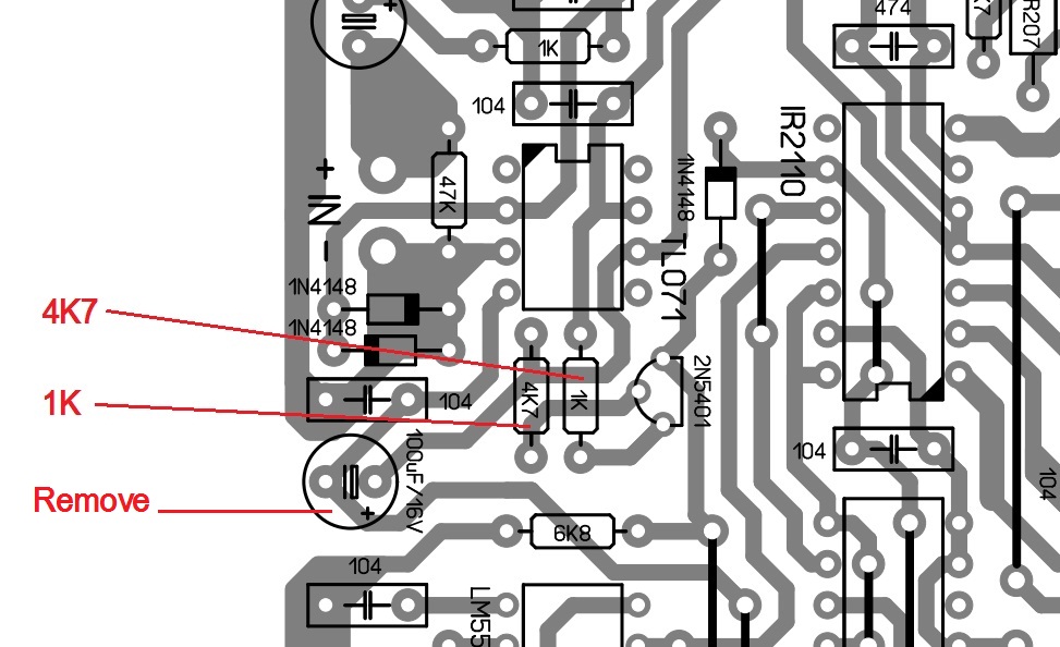

che-900e is not working ir2110 ic get hot i think ic voltage com to Vdd is 5v but this schementic is give 12v
when using these designs....once u get succes but using same next time it causes u a failure what kind of stuff this is can anybody make it clear

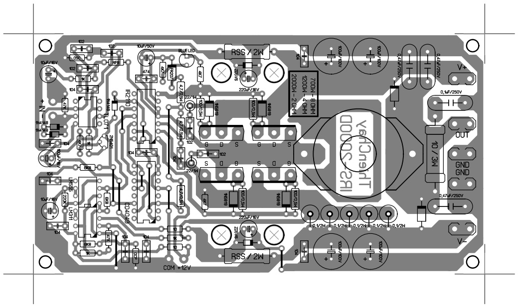

the irs3000d dint gave up signal out from 2n5401 and the other one just blew the **** out from IR2110....cause me to lose 5 of it in a time......the frequency was a good square wave from 2n5401 in other design...but no respose from 3000d.....inspite of the frequency on the outputs there was no response from IR.....the low output of IR gave out square wave signal but the low side was still showing something and that something was a freaking "NOTHING"

Traces are long,ground plane is missing,ground is not thick enough,you will have problems in high curents, but it should work ok for a few wats,if it blew form the start then you made some mistake🙁..

i could end up saying that i commited some mistakes but this aint the fact...i checked the design on my breadboard 100 times but there was no such mistake....the 5401 gave the clean square wave output...

i built one of the ir2110 model but it had lot of distortion...then i got the pcb design from thienchay of irs2000d/3000d which i tried to see whether works or not...can u tell me does that work well...and what will happen if i install all the things except output fets..to see whether the IR2110 gives the high and low output correctly??????????

Abeteer this pcb a mistake the 3,7v zener on lefth rail ,the catode mus be conect to gnd
abeteer sameer x1 design I think its is true

I'm temporary check , and i see R 4K7 and 1K is wrong , Detex is deceit , and i see C 100uF is not a bypass Capacitor , it connect from Ouput of TL071 to -5V6 😕 , try swap 4K7 - 1K , and remove C 100uF .
And i 'll check it soon to find a good sch and PCB , some mistake from me , sorry .
