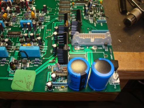

Please note, that it is necessary to mounting the regulator devices ( presently mounted on heatsink) on the bottom of the aluminium envelope (aluminium case) to use this case for the heatsink function. Now the life expectancy of the caps near by the old heatsinks is higher because now don't burn longer. Stuff for electric isolated mounting is additional necessary.
Various compensating caps you must solder directly on the leads of the regulators (LM317 and two BjT's in TO-126/SOT32 outline - as I know). now the length of the additional wiring (at whole 9 leads) are not longer a problem.
Use in all cases 63V versions. 1000uF/63V for the main caps behind the rectifier e. g. is a much more better choice than 4700uF/25V.
High Capacitance values are nonsense in general, if capacitor is connected in front of the voltage regulator instead behind.

I'd strongly recommend to do these mods to any owner of a LK2/60:
- do the Reliability Mods (R33 und R49 > 2 W, C6 & C19, see below)
- heatsinks for Q10, Q11 und Q14 (the still get hot)
- evtl. heatsinks for LM317/337
- add the two 100 µF, the LK2/75 comes with
- renew several lytics, e.g. Pana FC, Silmic or Nichicon Muse
- consider to renew the big lytics, go for 10.000 µF
- if you remove the transformers and put them in an external case, you'd gain spce for additional capacitance
- swap C5, C6 & C19 for Micas
- decrease C1 to 2.2 nF, C2/20 > 330 µF + MKP (e.g. 150 nF)
Hope I didn't miss anything.
