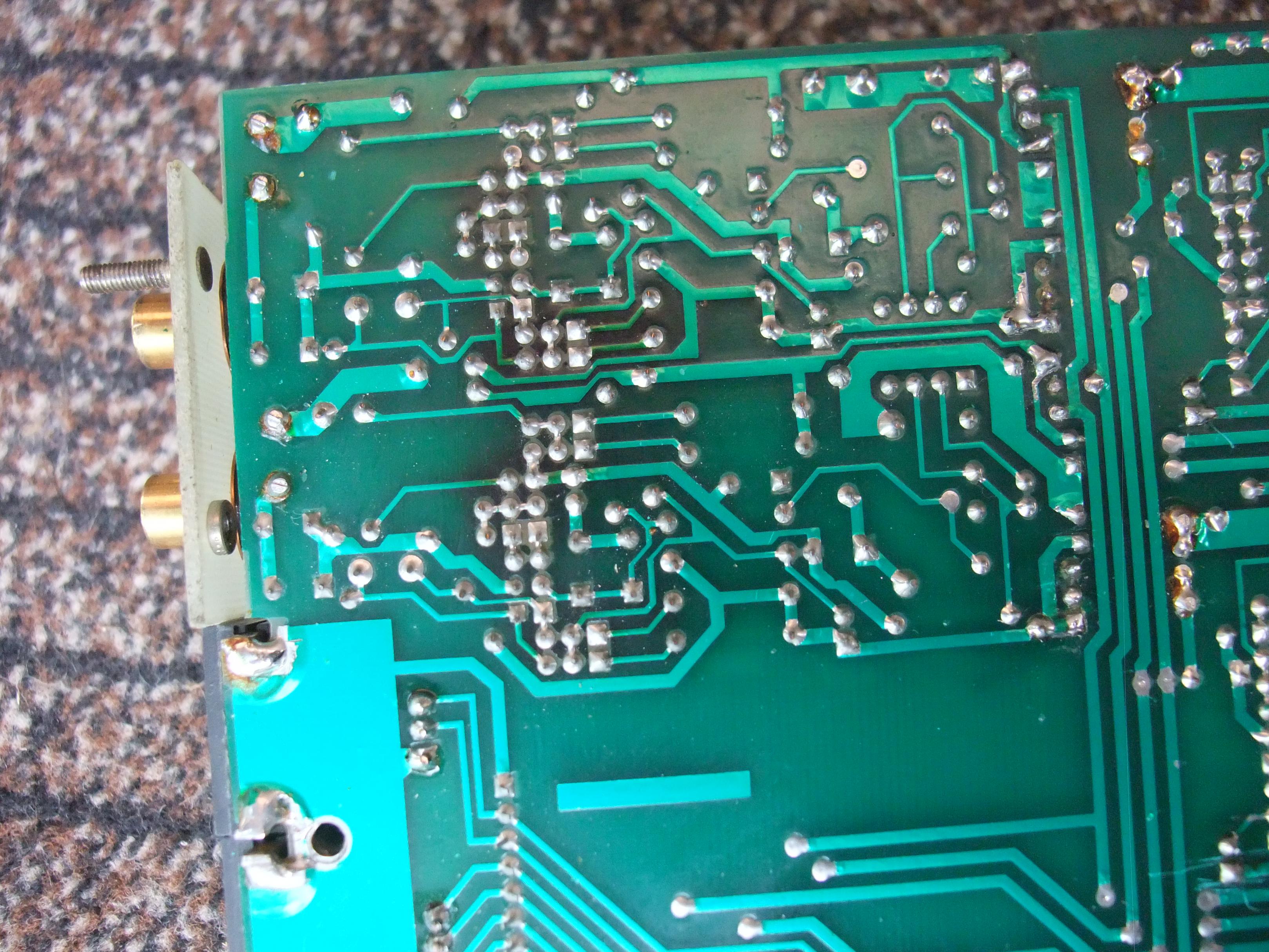

Burned PCB arround MC Pre-Pre in LK-1 - what can I do to remedy this deficiency ??

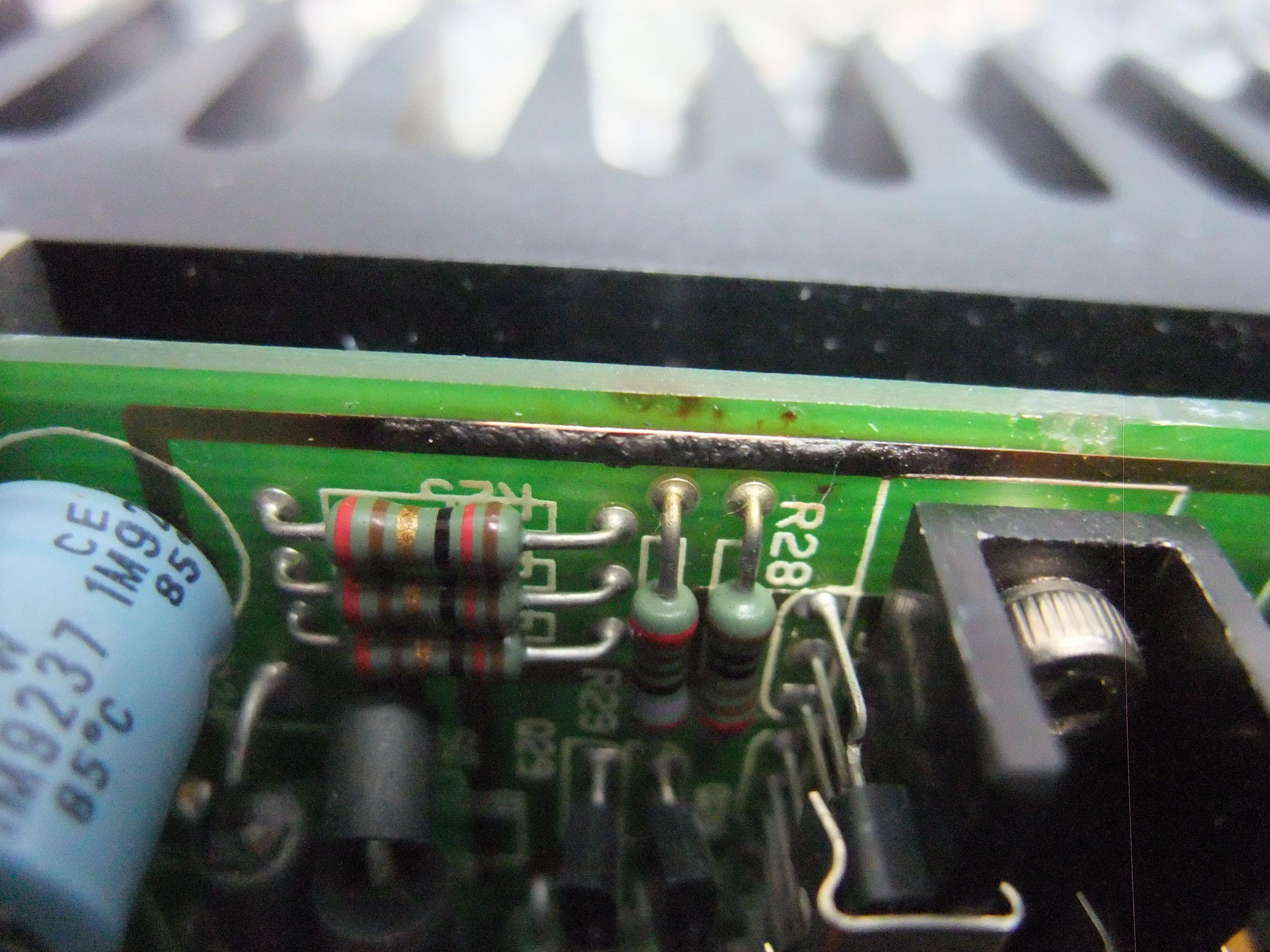

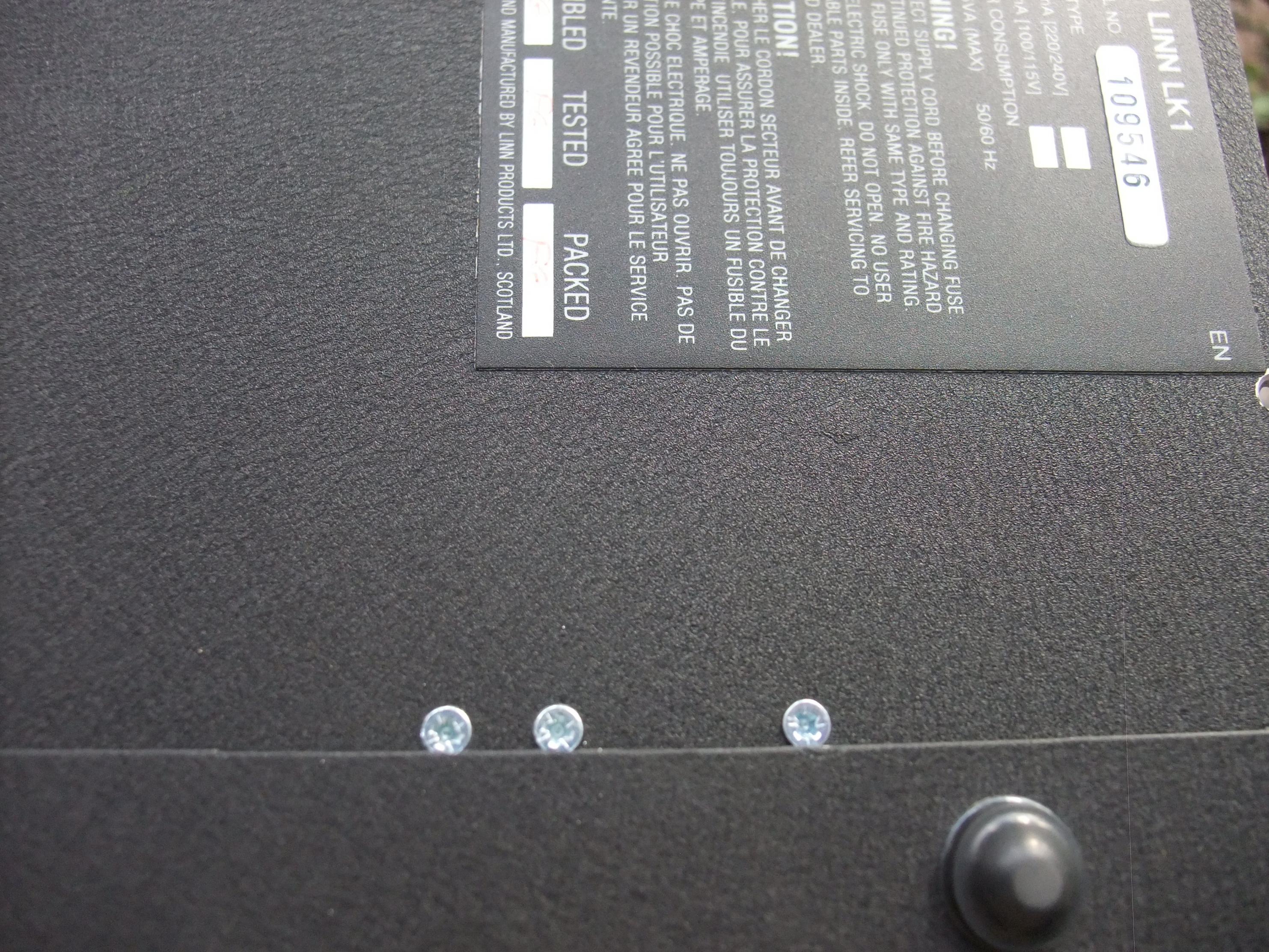

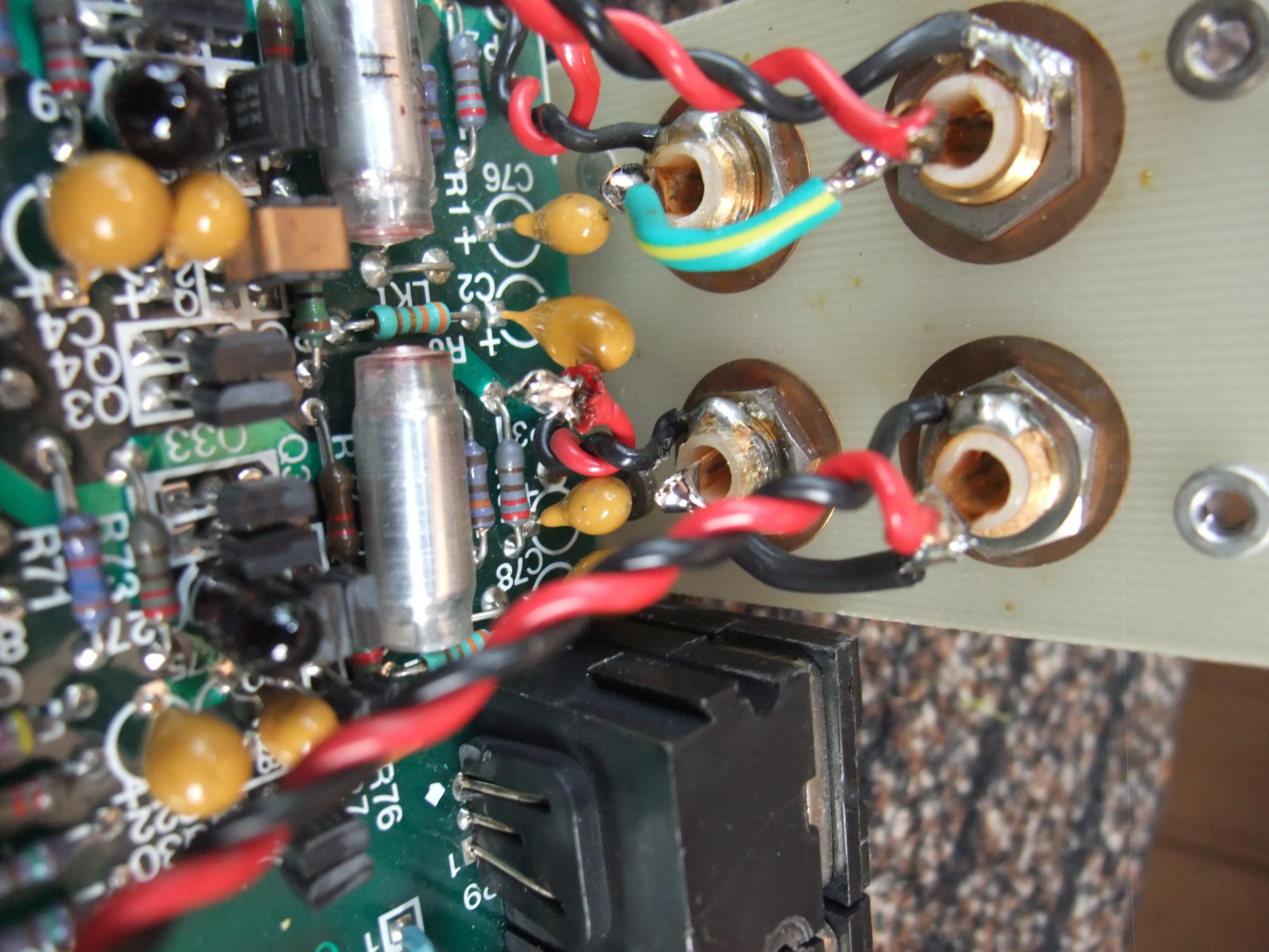

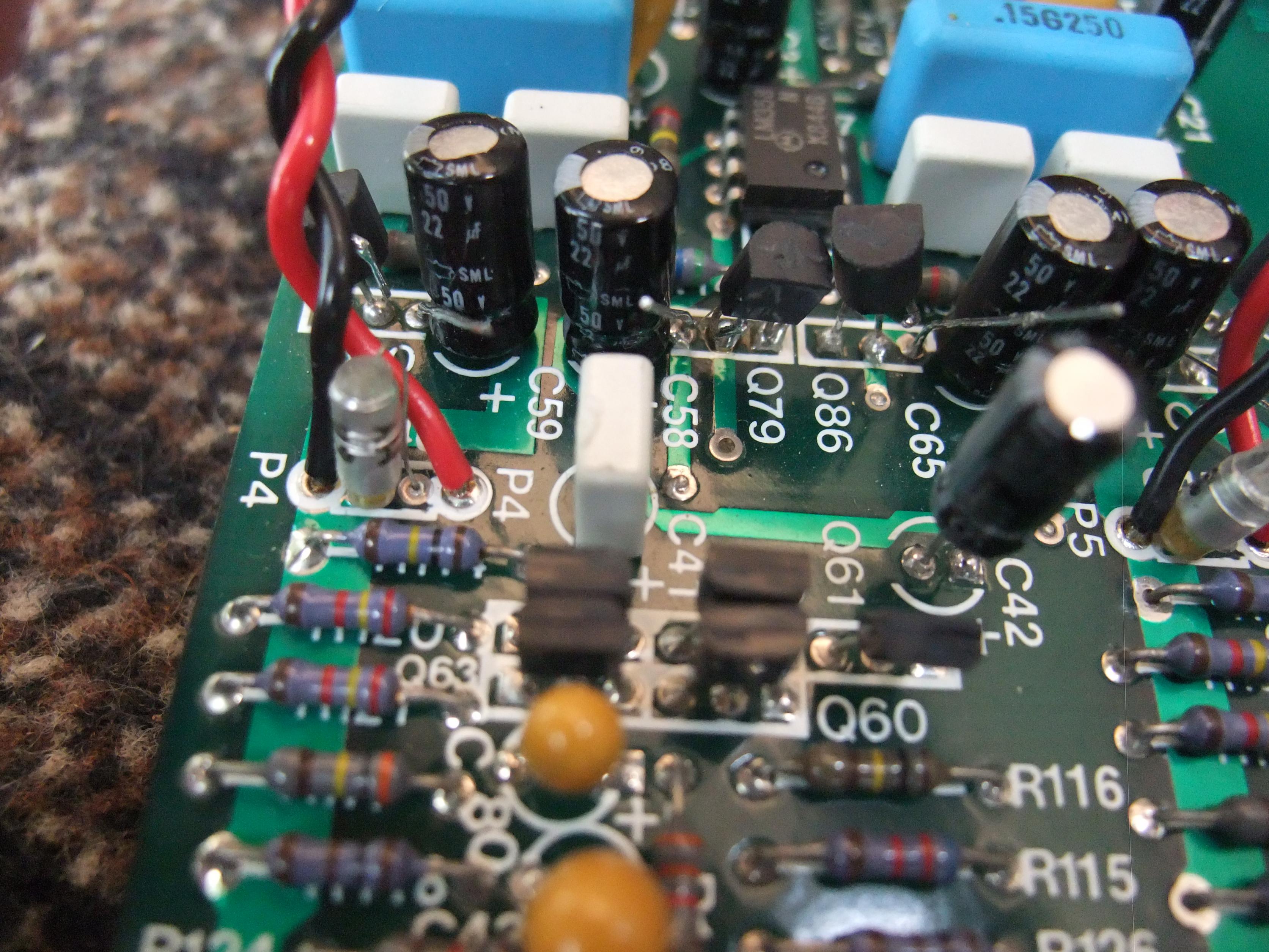

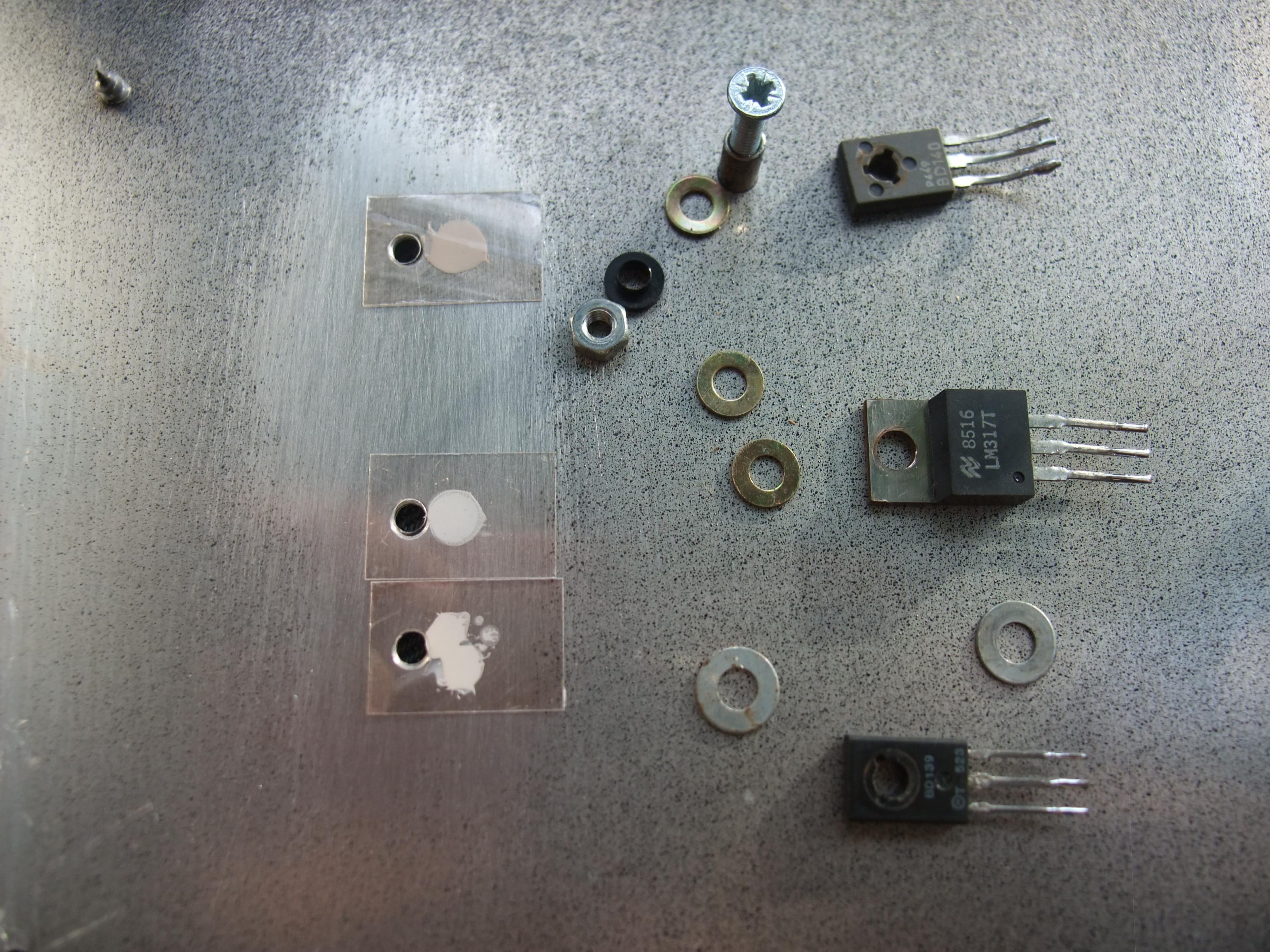

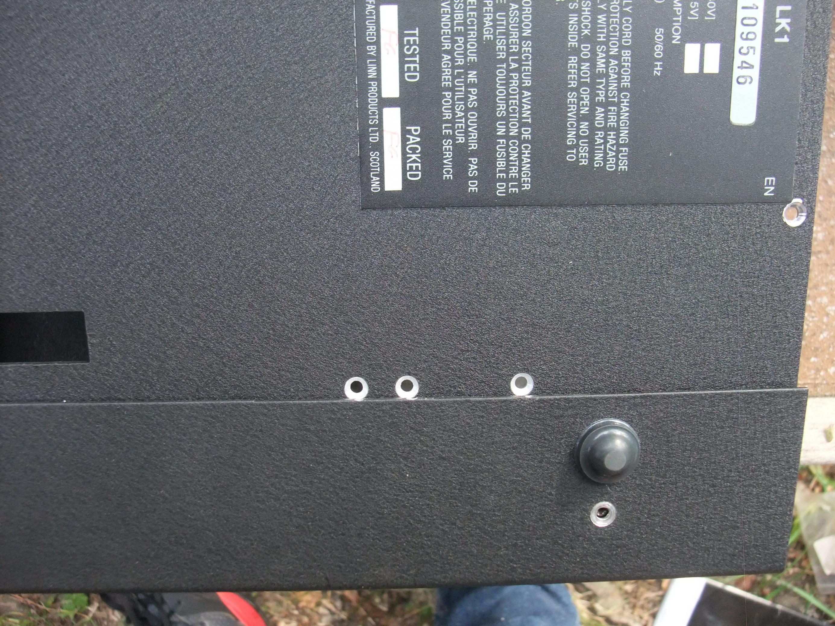

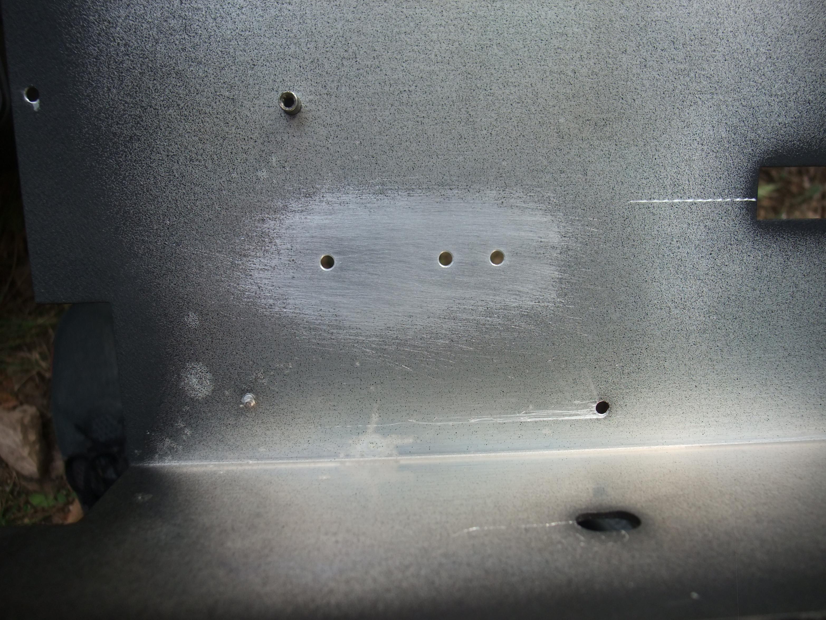

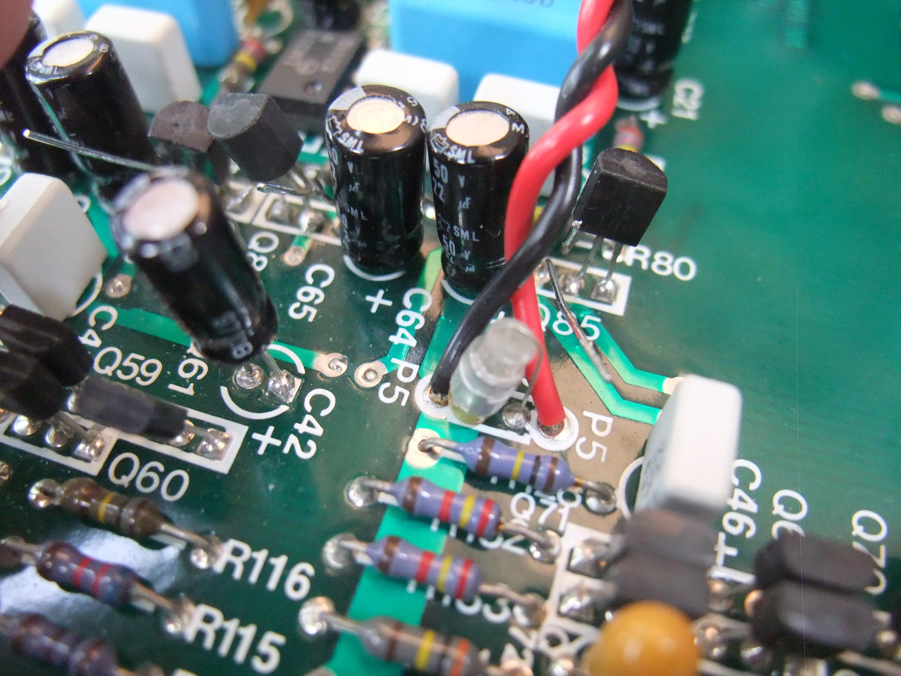

Supplement to post #71 of LK-1 Preamp Device, Ser.-No 109546
Various images concerning better cooling of the voltage regulator IC and associated transistors (images No 1-6), burning PCB of MC input area (despite only low operating hours, image No 7), disconnect voltage rails for MC input stage (images No 8+9, see my question in my previous post) MC input socket in parallel to MM input socket for the aim of use of cinch plugs with integrated resistor and capacitor to adjust the necessary cartridge load (last image).
