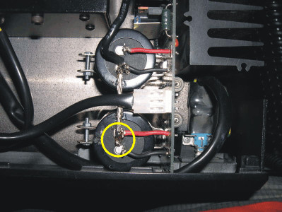

So, basically, I did the PS cap upgrade some time ago. All went fine except that there is now hum on the right channel and that I've lost the turn on-off protection (I can't hear any relay action). Unfotunately, this is not covered by the service manual. The sound seems not to be affected apart from this.
It turned out that the stock ground cable between the reservoir caps and the speaker connector is very hard to work with because it's thick, rigid and refuses solder. I wonder if my problems come from here. On the photo, you can see that the soldering, though firm, is not ideal. I plan to change the cable + connector very soon.
In the mean time, I will check other parts though I have no experience with transistors and have only a multimeter as a tool. I remember that I unscrewed the metal panel on the power transistor just to check them and it could have put out some of the compound (?).
Anyway experience form other users is appreciated, especially those who succeeded the cap upgrade. A great amp indeed!

ACD said:This looks dangerously close to a shortcircuit![]()
I know it does and it also look like dry solder, but it's not

By the way, I soldered agin the power suplly caps with a more powerful iron and everything works fine now.

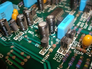

LK1 Troubles
I appreciate kepa1's response, but I cannot respond to your email because I have not posted enough, even though I have been on board about three years! I have found some troubles with my LK1: The memory battery is bad (leaking juice!) and there are two swollen 22mf, 50v caps on the main board. Any help with parts would be greatly appreciated! Email me at rogerben@bellsouth.net please with a parts list.
May I ask you guys what the reason for the current hype around parts lists is?
You have the unit already open, so what's easier than to use a ruler to measure the diameter of the cap, its length (usually not even necessary as there's lots of space), have a look at its lead spacing, the ratings you already know, so here we go to order parts at Digikey or somewhere else.
If you're at it, redo for all electrolytic caps.
By the way I cannot see any swollen caps on the pic?
Have fun, Hannes

LK1 Troubles
I appreciate the fact that when I SEE a bad part I have no problem identifying it - provided it's not a completely burned resistor or a blown apart transistor, but I like to analyze the unit by studying the schematic and knowing the parts values helps. I'm not trying to be cute. It just helps to know what to look for. I read the color codes as fast as I read a book and not having a component layout makes it difficult to know where to look to isolate the problem to a particular section of the circuitry.
As far as "seeing" the swollen caps in the picture, I agree that they can't be detected by viewing it unless it is blown up from the original bit size. The score marks in the top of the cap are there intentionally: They allow the case to expand rather than explode. Knowing this design feature helps. The picture size restrictions do make it a bit difficult plus the 67 year old cameraman may not be the best either! But, replacing the two 22mf, 50v caps (C72 and C73 - filters for the + 15v and -15v in the MM section) did fix it. I have a 3-pin, 3.6v, 150mAHr Varta 3/V150H memory battery on order from Mouser Electronics for $11.98 plus S&H. The old one will not accept a charge past 0.7v and it is leaking.
Thanks for all your help. May God bless your day!
