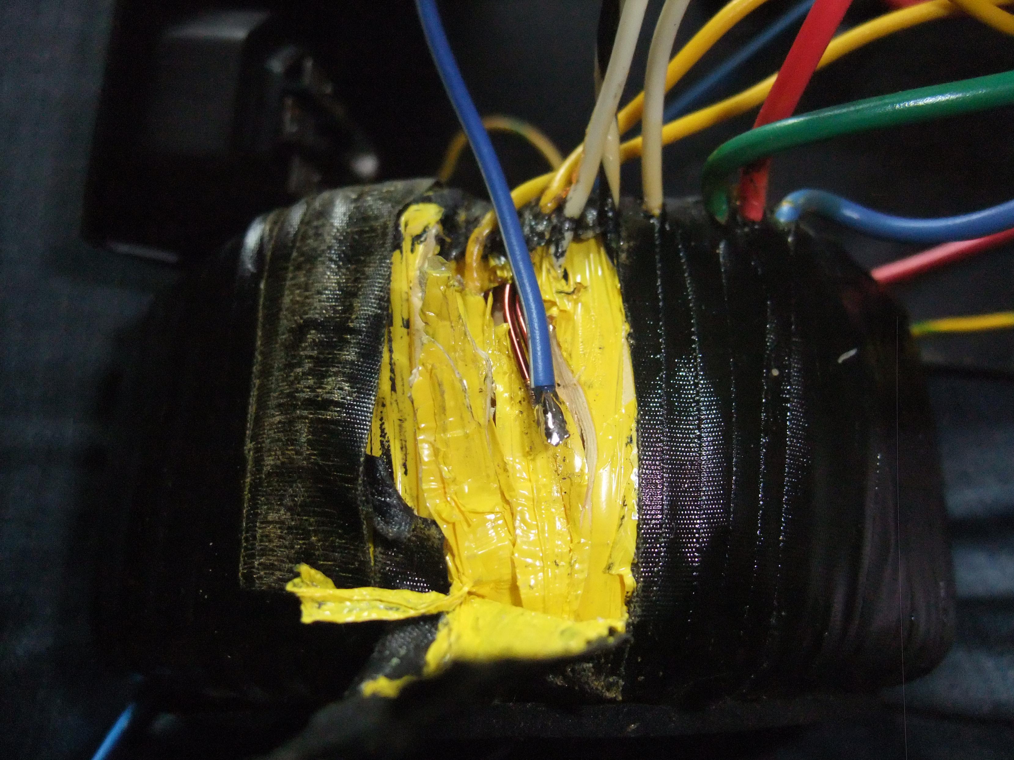

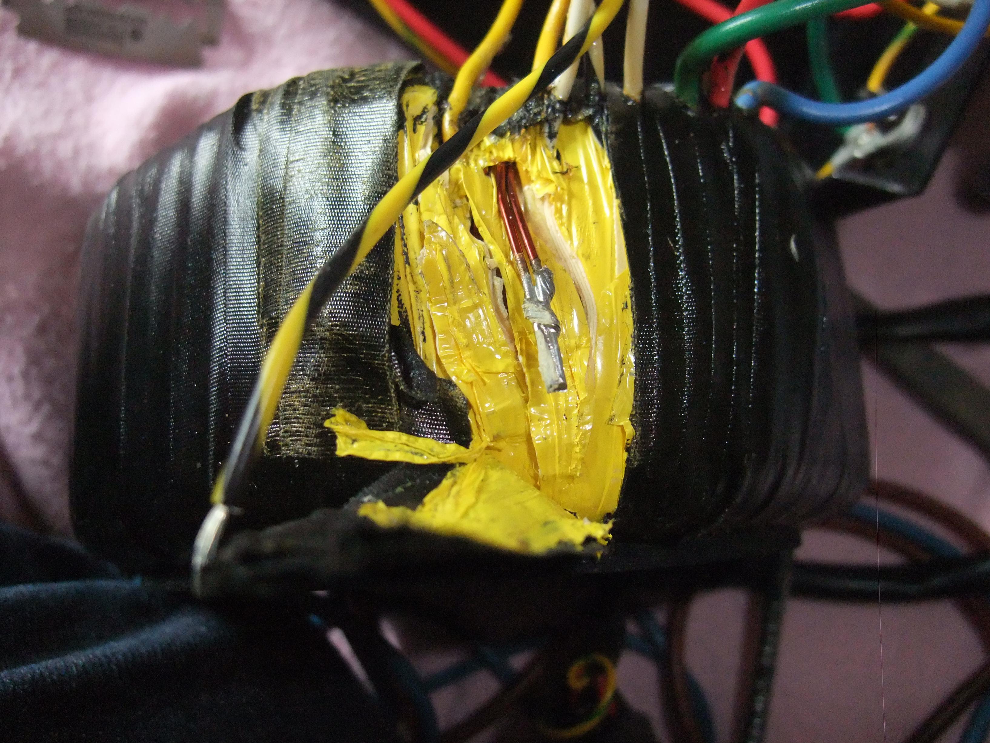

Issue fixed. Very rare occured unwanted internal disconnecting between the GND transformer winding and the outside cable coming from transformer winding going to the outside secondary winding connector.A friend of me have issues with his LK2. The input voltage (measured to GND) from the regulated power supply rises up to nearly +110V at the positive rail and fall down to -10V at the negative rail.

I open the transformer and note an interrupt between the winding wires for GND and the flexible cable, that goes outside. The reason was oxidation (maybe by aging of cable insulation - this I have never seen before). After resolder and replace the cable, that goes outside, transformer works correct. But as consequence, the power amp was damaged (one half get two times voltage for a too long time) and I need new power devices TIP35C/TIP36C or BD249C/BD250C in the old TI-outline as show in follow image:Issue fixed. Very rare occured unwanted internal disconnecting between the GND transformer winding and the outside cable coming from transformer winding going to the outside secondary winding connector.
Thus transformer's GND-reference isn't available from outside and I need therefore a replacement. Maybe there are user's, which had make an upgrade to a SPARK and can make me an offer from such a no longer used toroidal transformer. Please avoid PM and send an information concerning this to my own email address

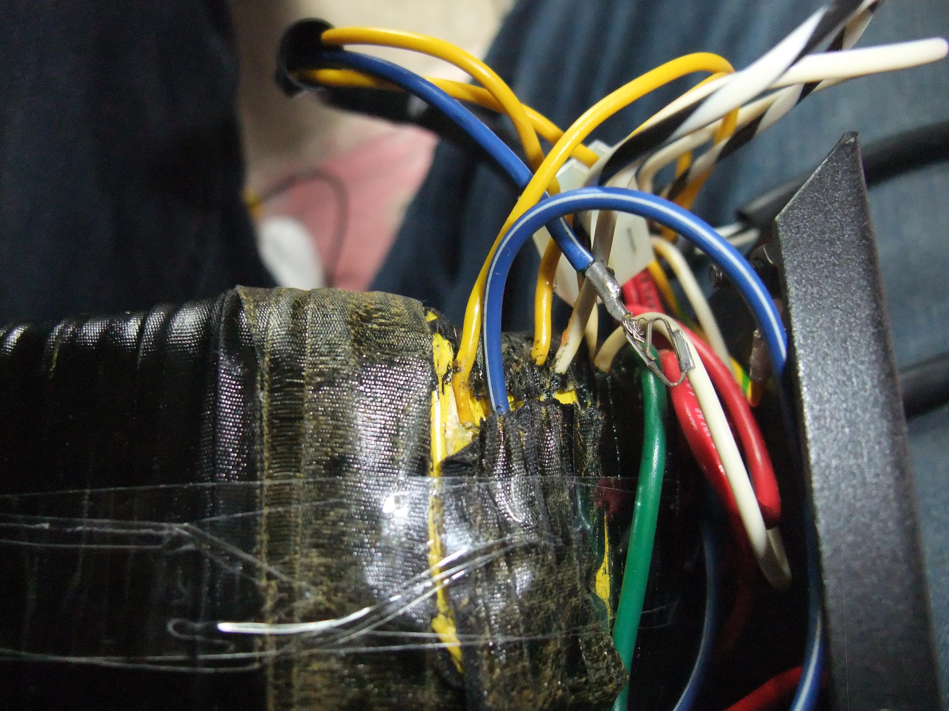

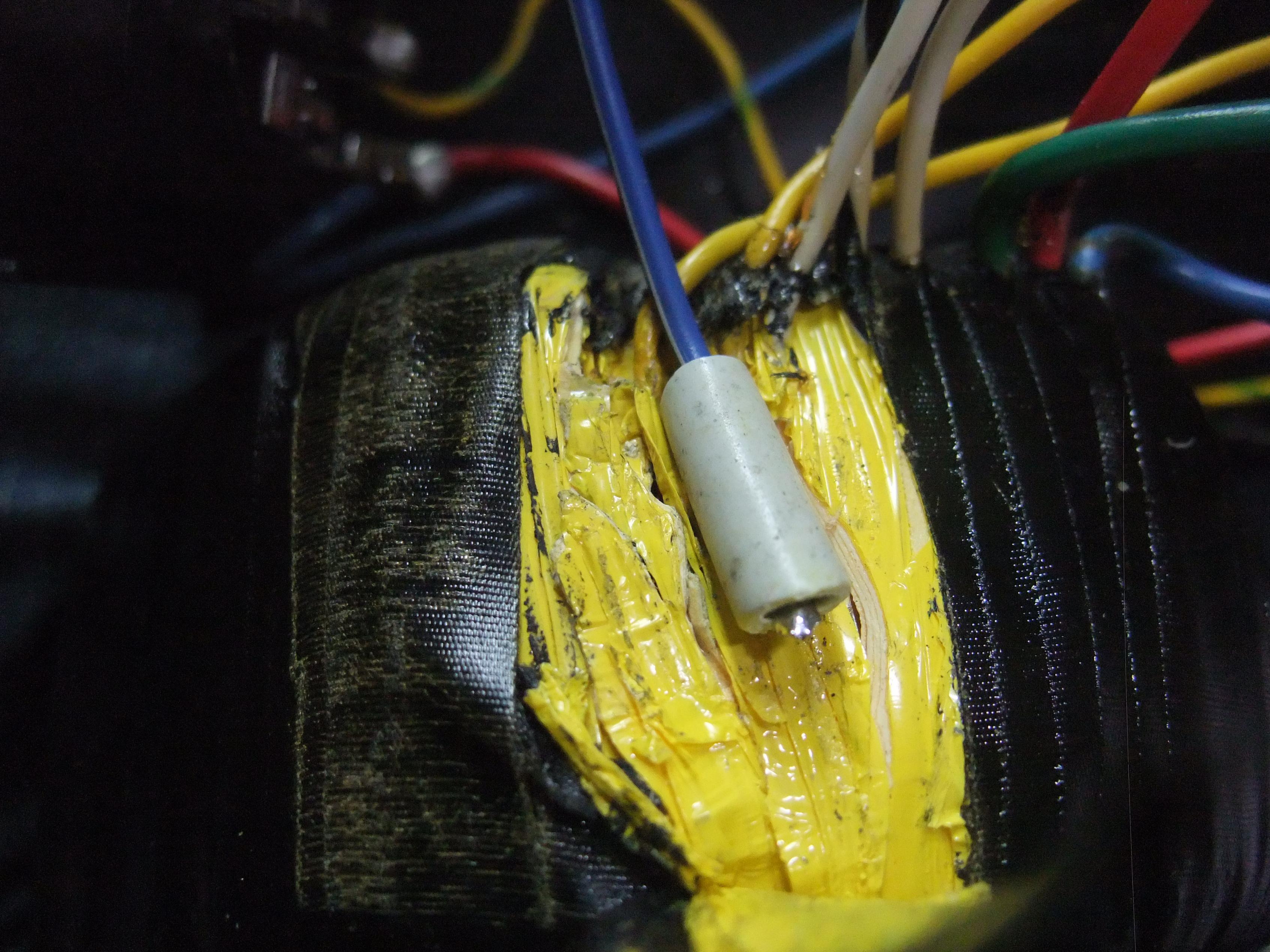

Here the pics thereforeI open the transformer and note an interrupt between the winding wires for GND and the flexible cable, that goes outside. The reason was oxidation (maybe by aging of cable insulation - this I have never seen before).
the yellow/black colored wire was replaced by the blue wire.

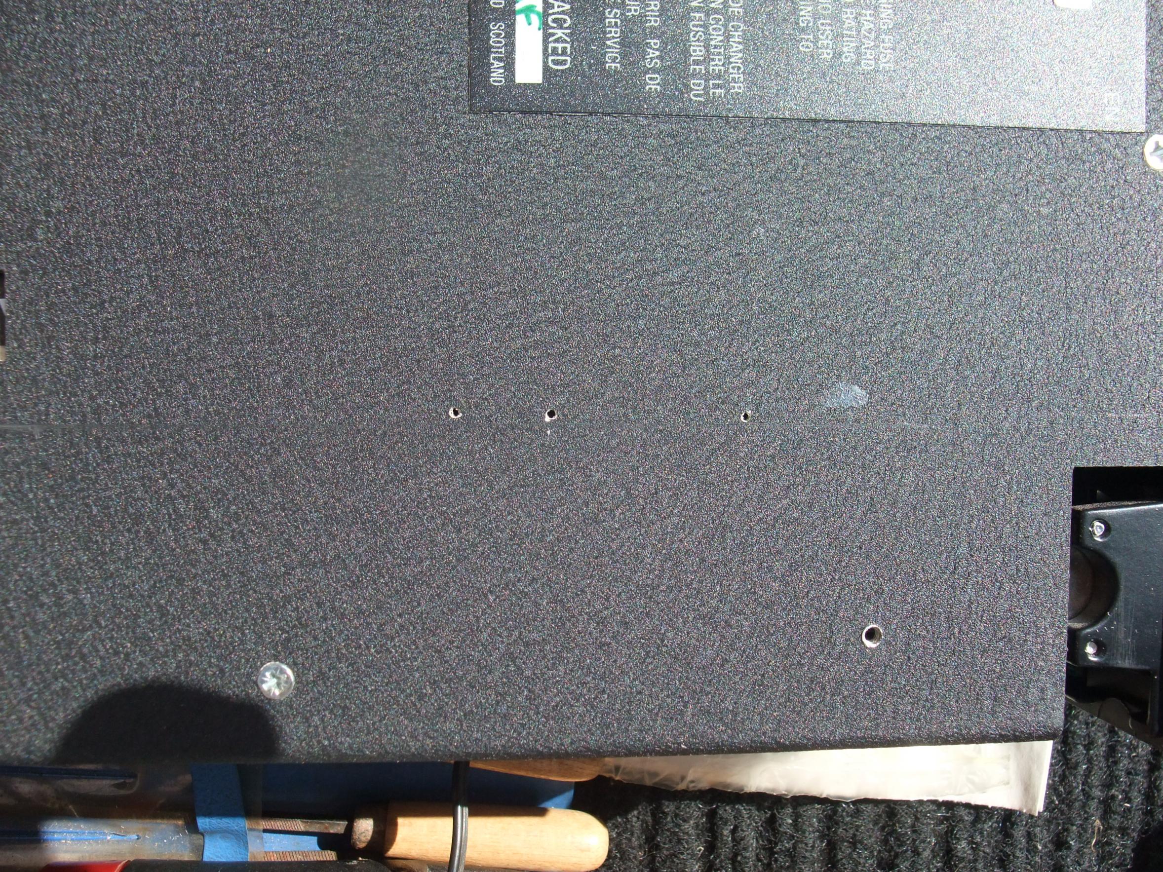

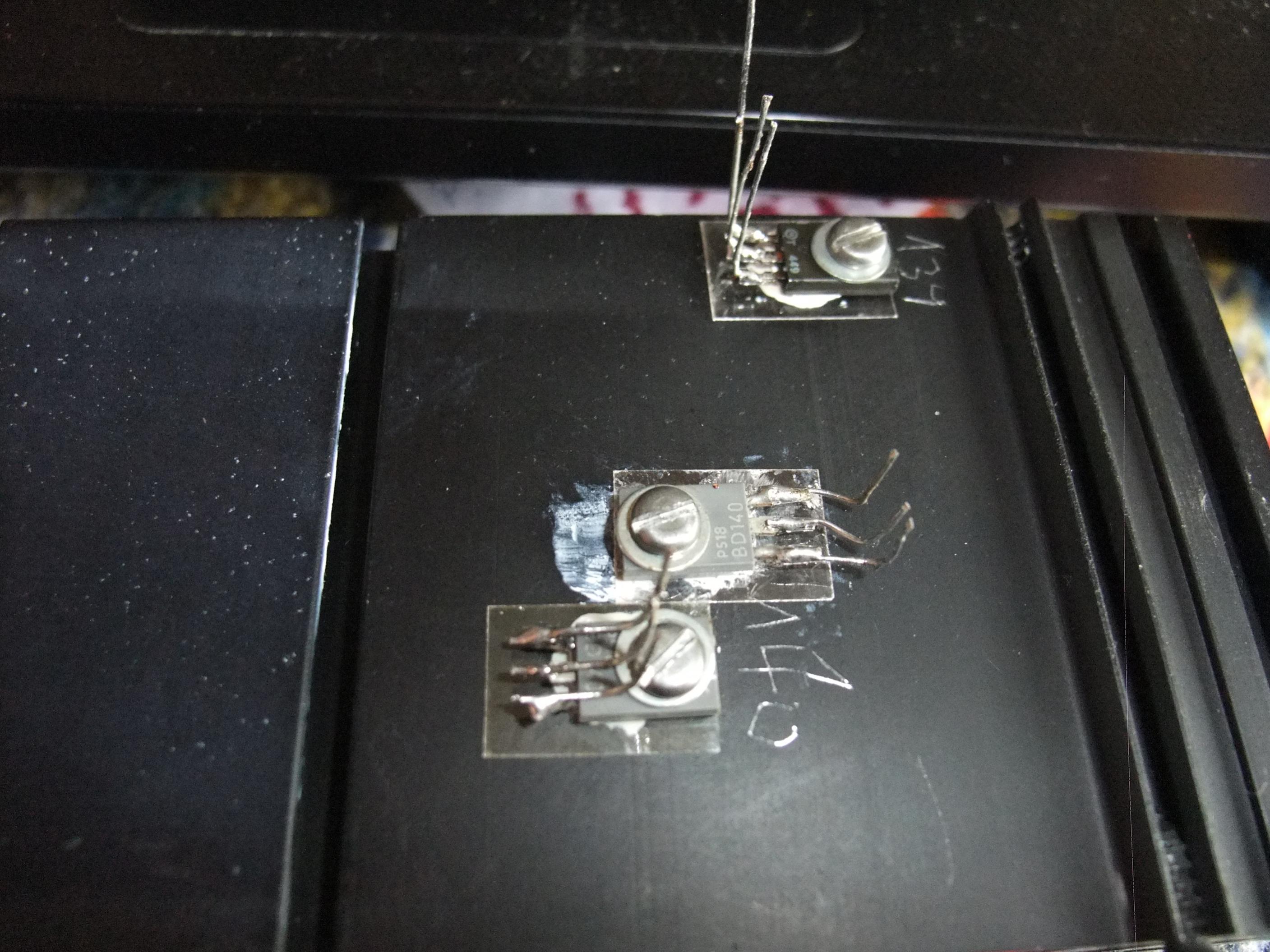

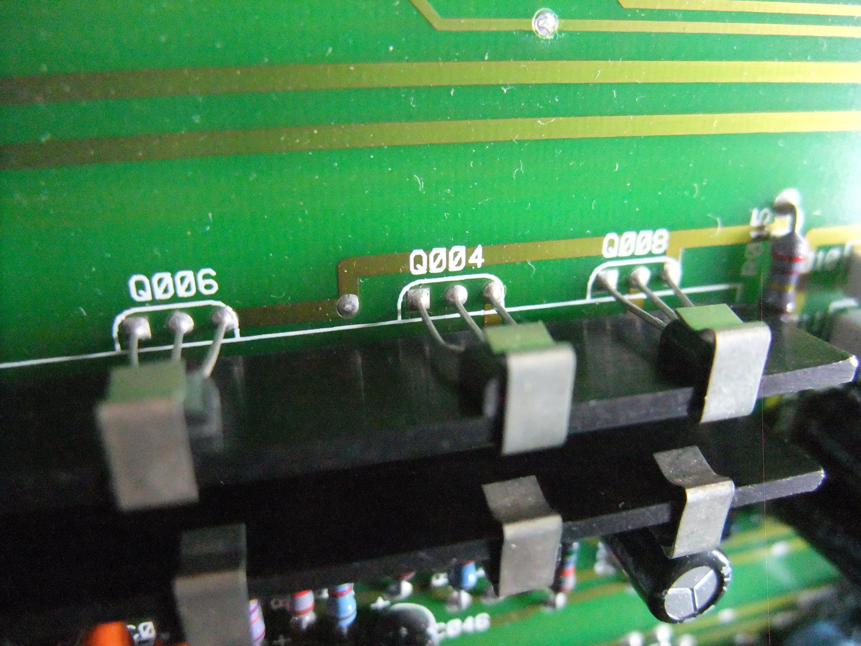

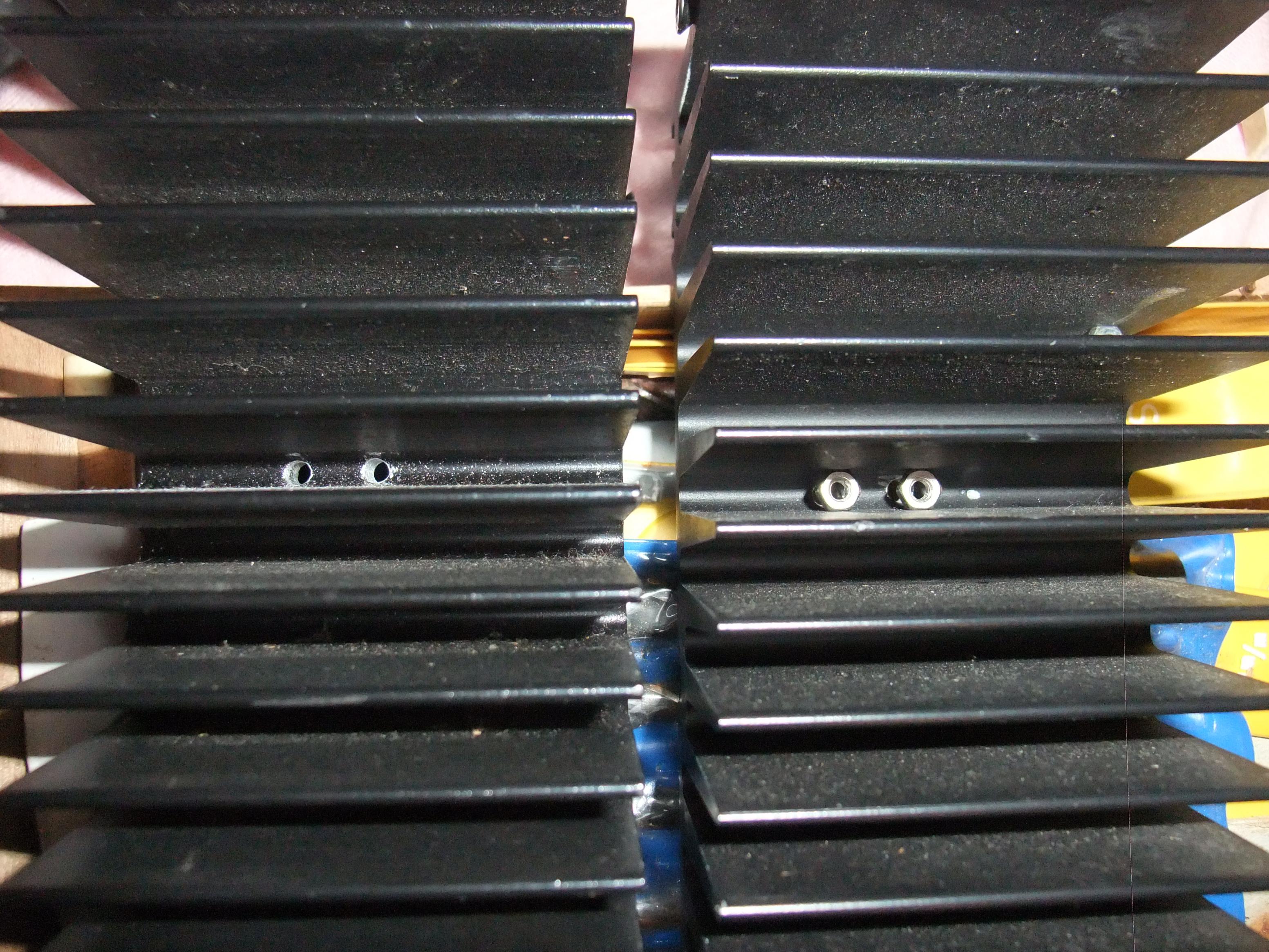

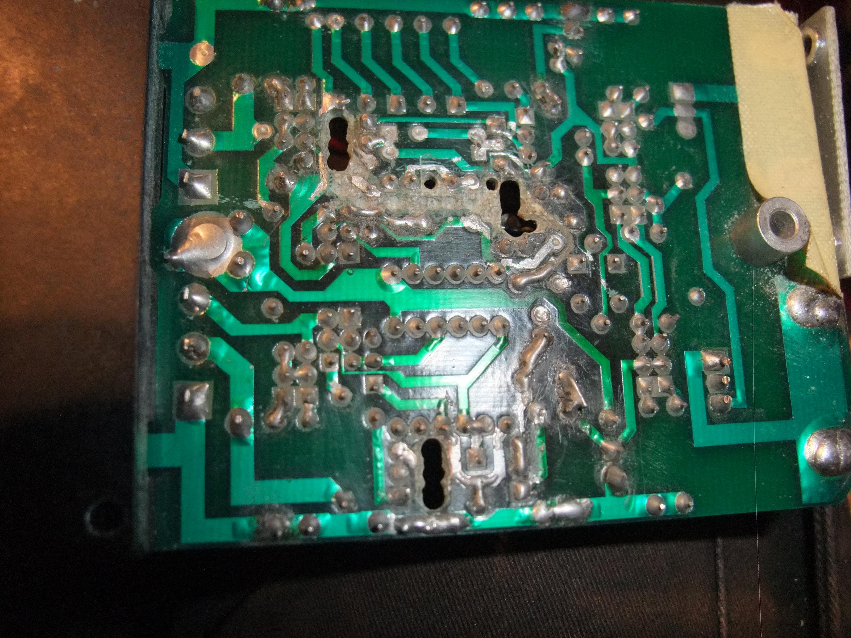

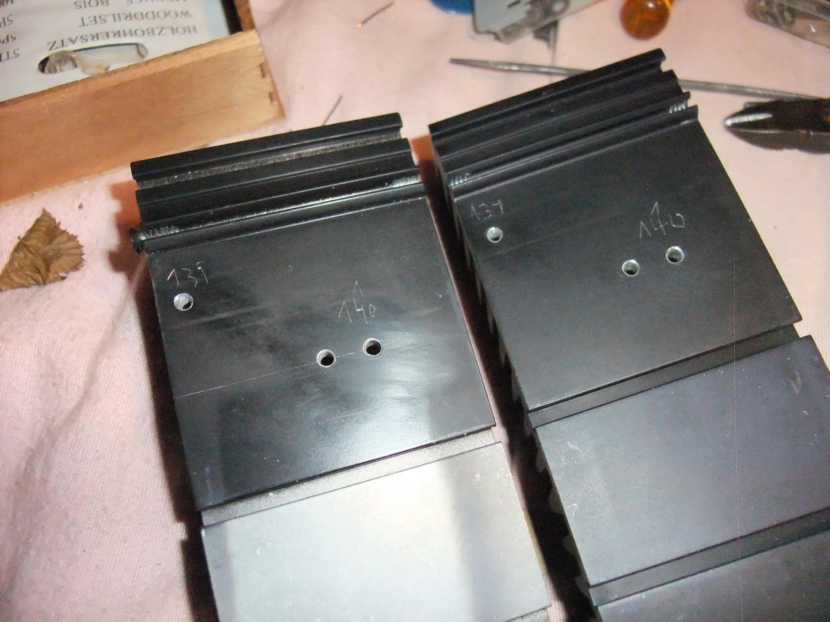

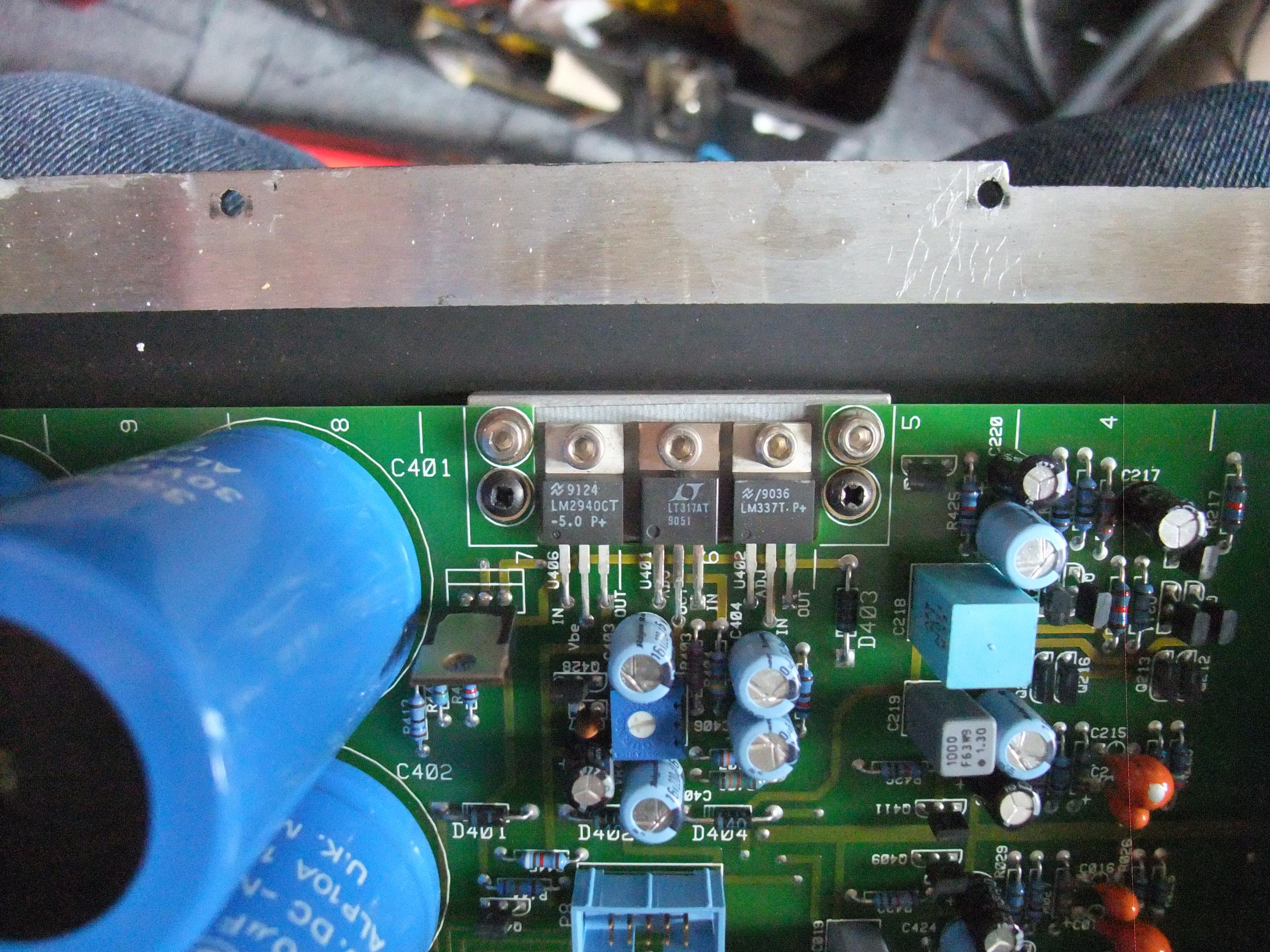

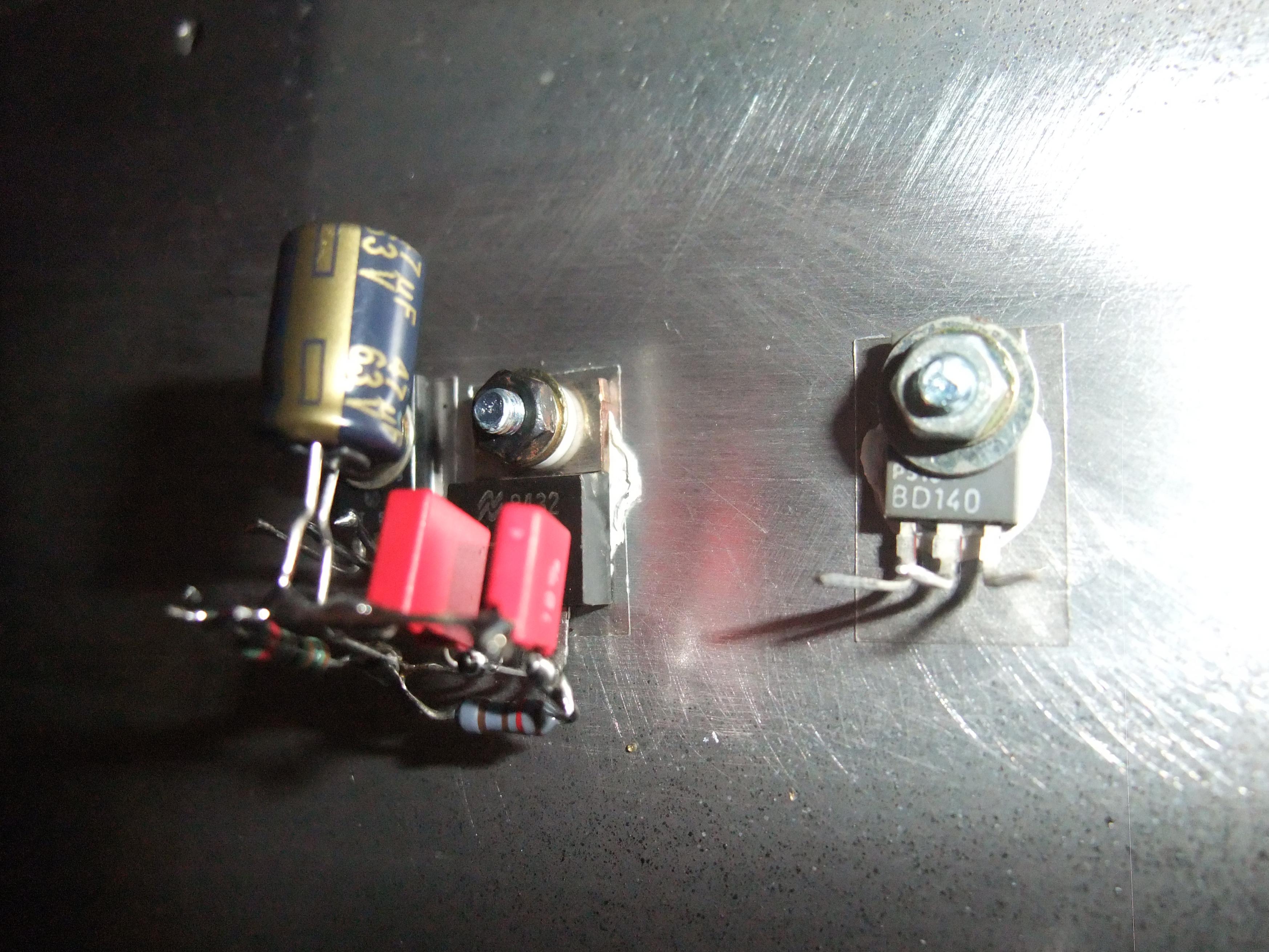

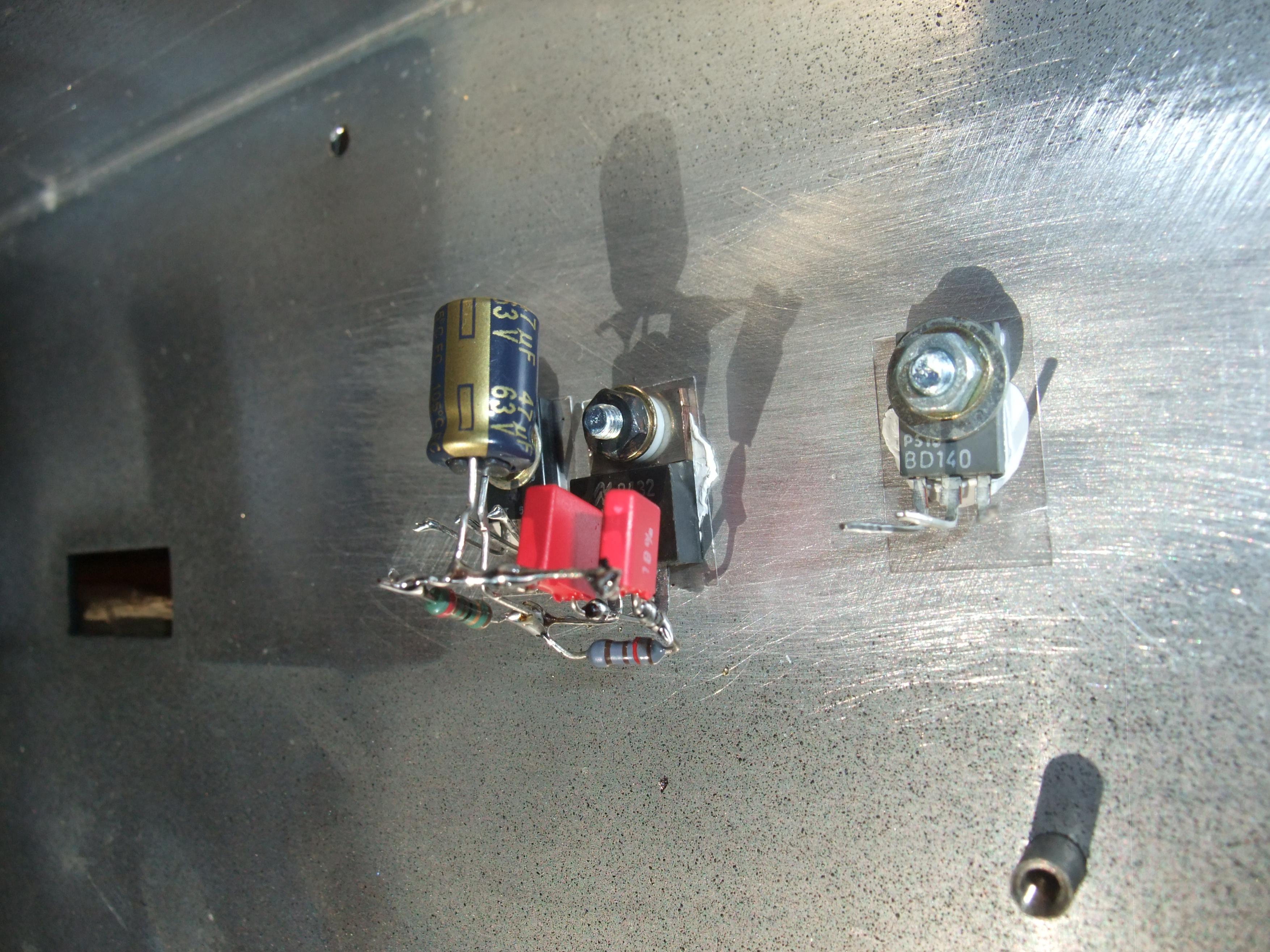

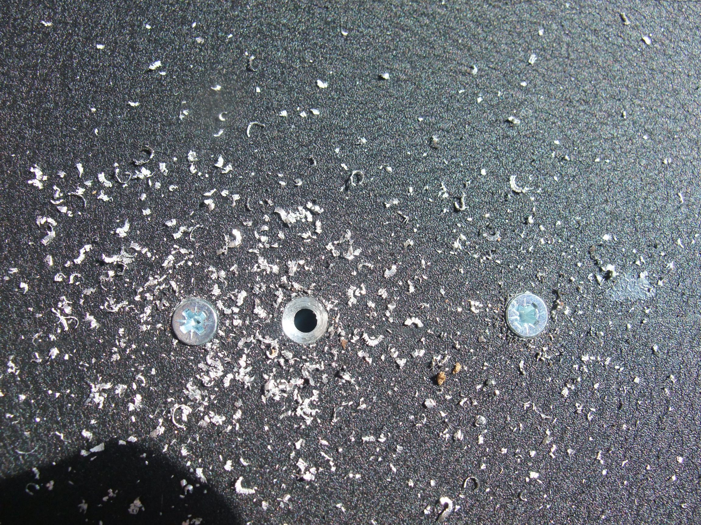

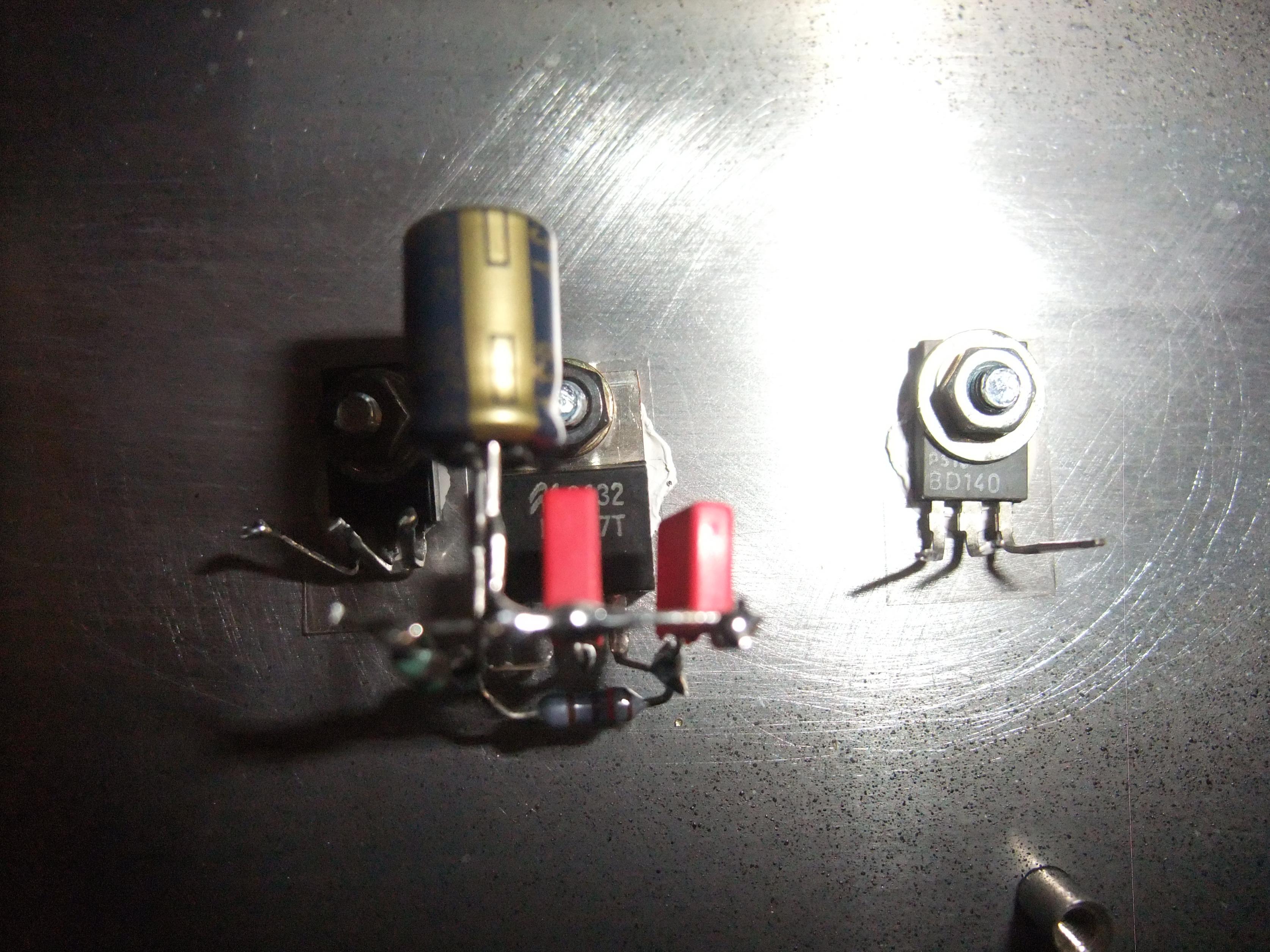

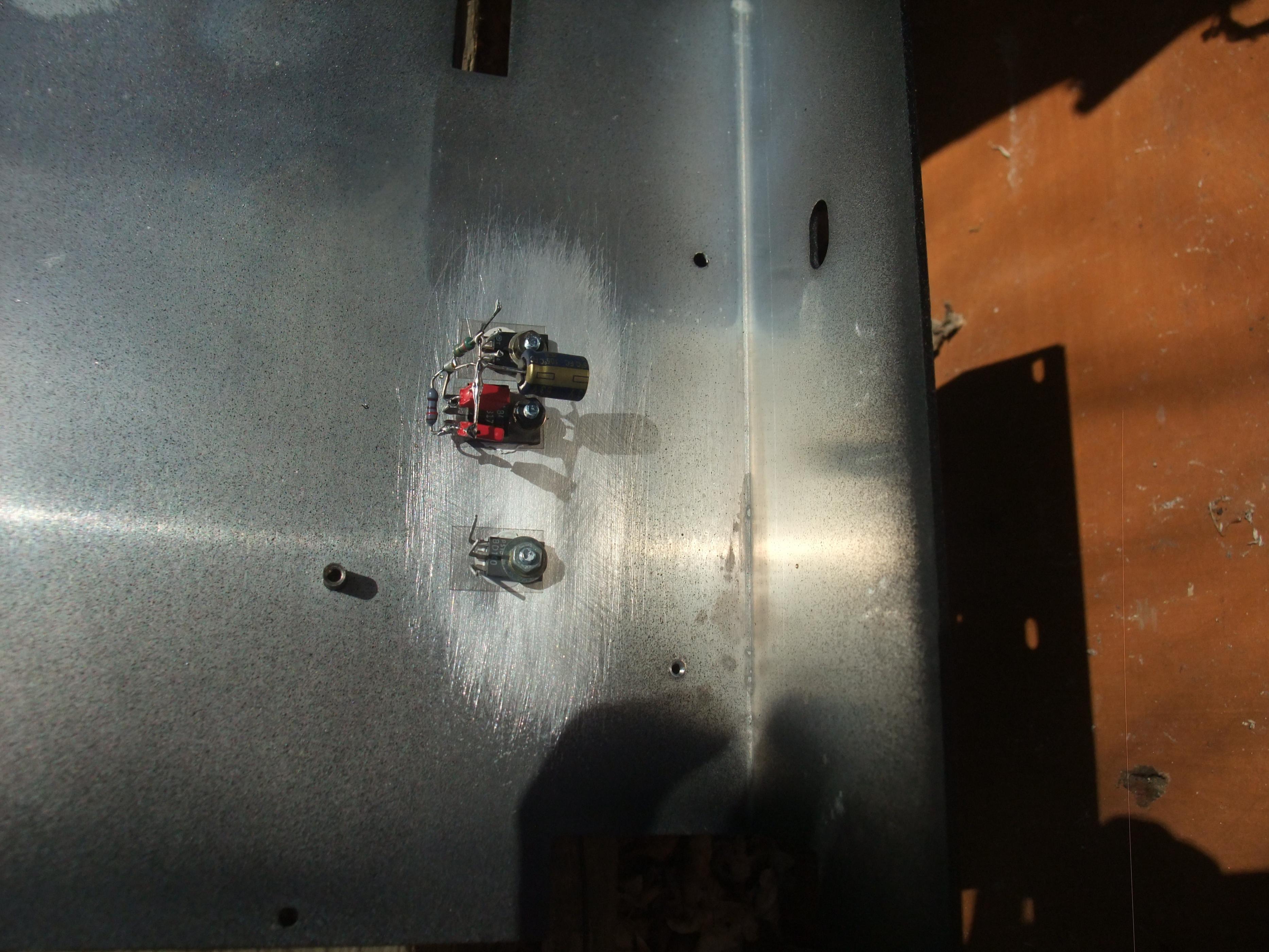

Realizing of a very large Heatsink for Linn's LK-1 Voltage Regulator Transistors
In genuine condition there are three small heatsinks and consequently burned PCB area arround this. For me the best solution to avoid this are the approach from Linn's modell KAIRN and KARIK - go to the first two images below.
In order to realize the LK-1 in retrospect, many steps are necessary - go to the additional images.
Continuation Picture Series
more images
more images

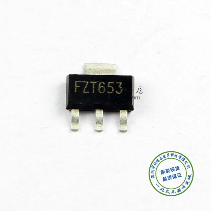

Not only the voltage regulator transistors, but some components in the moving coil head amp goes also very hot - there is to observe also a burned PCB arround the parts of this unit. Each channel has two 150R resistors, which are to be soldered at a great distance from the printed circuit board - go to image No 5 and 6.
But what can I do for cooling the ZTX653/753 ?
Maybe using of the FZT653/753 (SMD outline) with the possibility to solder on a small copper heat sink ? - go to

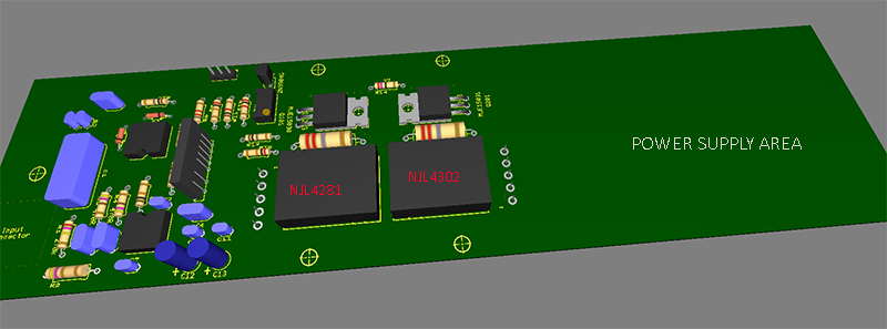

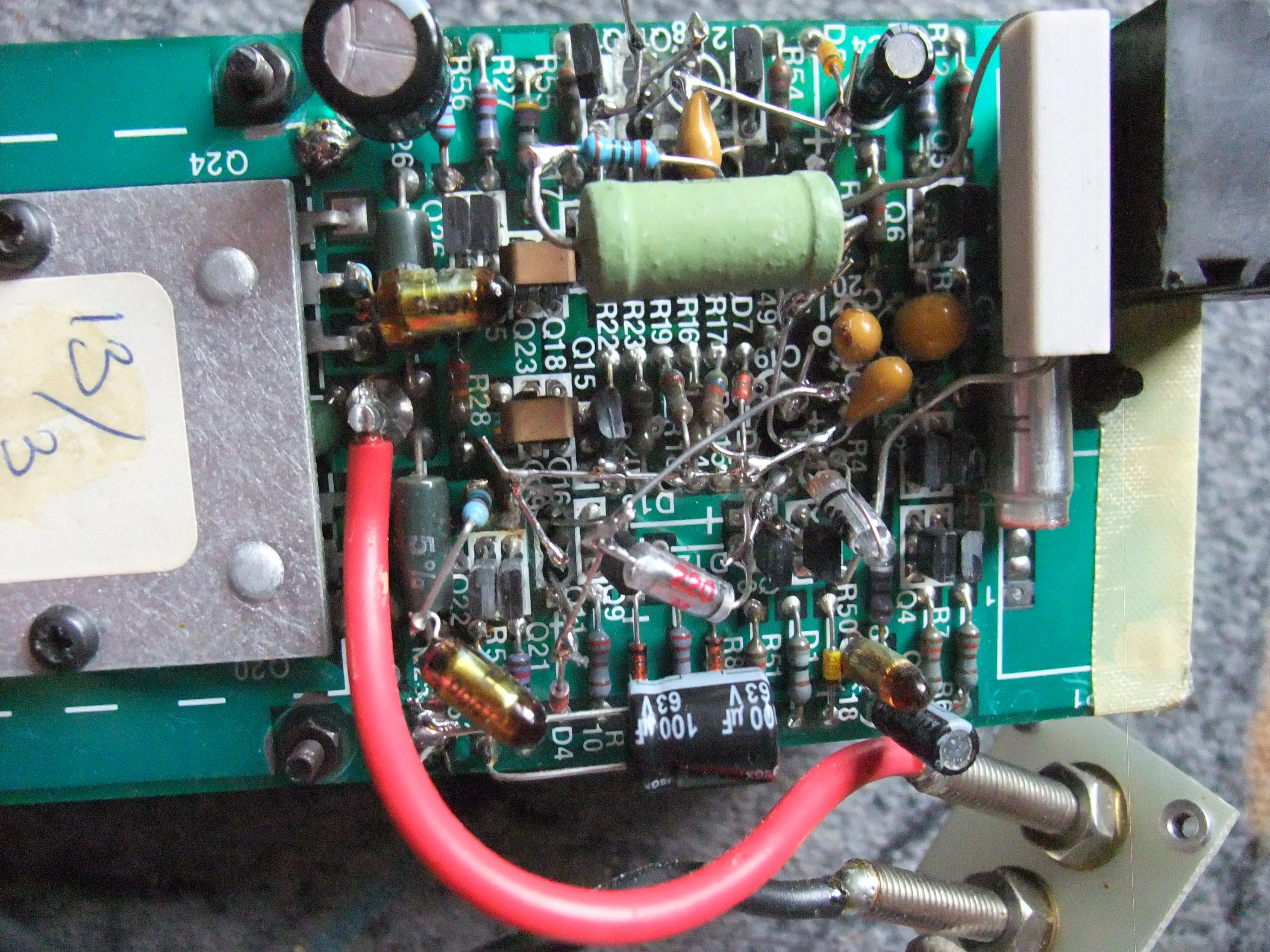

Hi
from yours photos i see, in 317 3D circuit, the resistor normally called R1 is connected to IC input pin .
Have You checked if the regulator output is stable changing input voltage ?

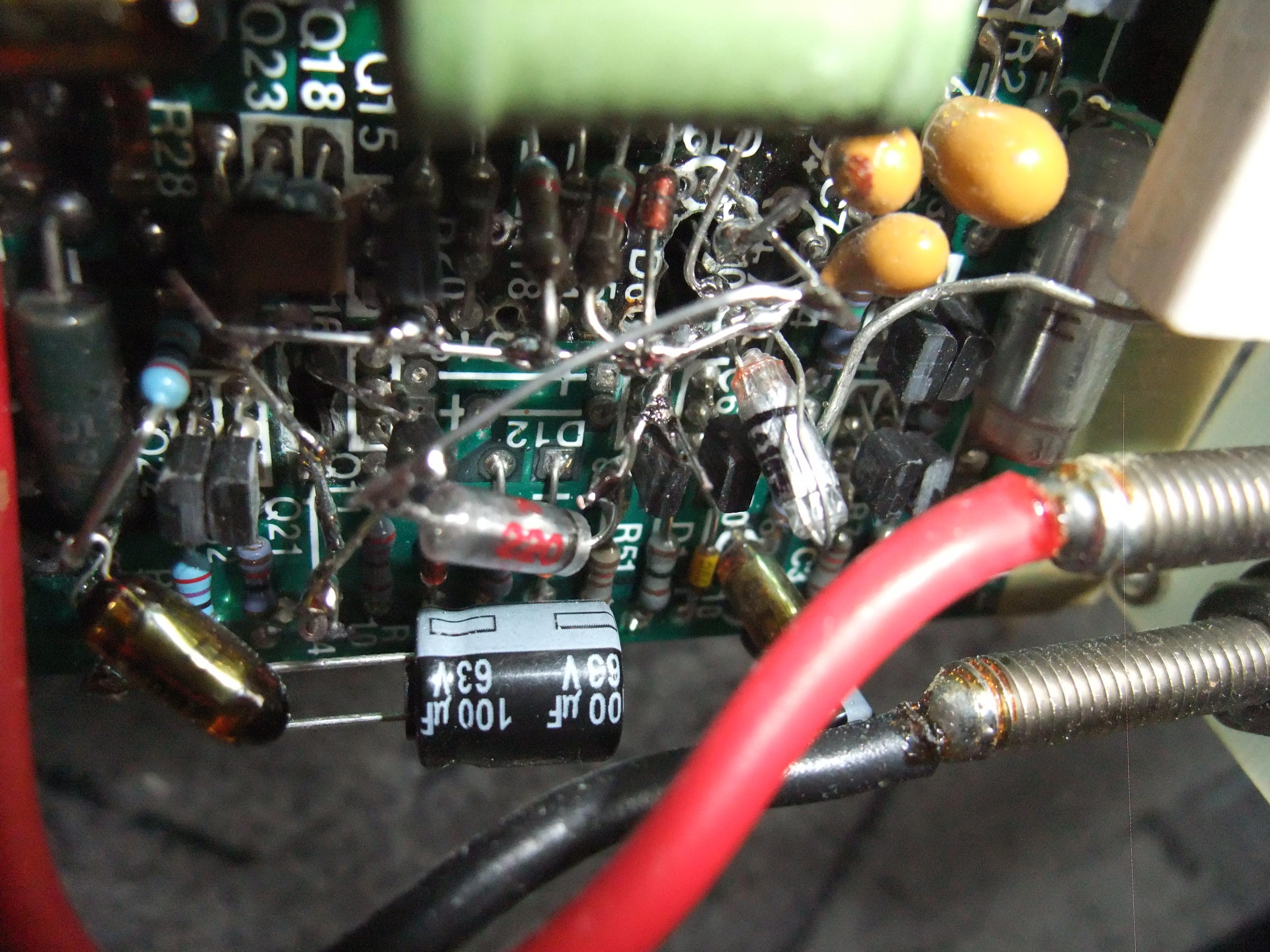

Yes (go to image number 7, post#72 - the right-hand wire of the 120R resistor must connectet of the output (middle) PIN from LM317).Hi
And a second mistake was present while photo shooting:
The GND-connection between the upper end of the LM317 parts and the mainboard (near by the main capacitors) was missing (go to image number 3+4, post#73).
But both errors were eliminated before performing the operating test procedure.
Nevertheless - thank you very much for this advice.

Hard to understand why Linn chose C1 so big and C2/20 that small. I cannot
understand als why there are no heatsinks on Q10/11/14. Even with some
Copper HS they still are 55° - 60° C hot. No wonder the melt the styrenes.
R49 also still gets hot. This one is prone to burn as it's just two 1/4 W types
from factory.
1) R49: 2K2, 5W (VAS stage, was in the first version 2K2, 0,125W, later 2x1K1, 0,125W)
2) R50+R11: 8K2, 5W (for reference current through zeners D1/D5, was in the first version 2x3K3, 0,125W, later 2x4K3, 0,125W)
3) Q10/11/14 from VAS stage on the exist main heatsink (very difficult steps necessary, but possible - go to the attached images; please note: this is not possible on the LK2-80 PCB's "PCAS020")
4) replace burned C6 (68p) and C19 (220p)
5) R33 (20K, 0,125W) replace by 2x10K, 3W
Now the main heatsink for the output power and serial voltage regulator devices will be more hot. But now no longer burned parts on the PCB.
But a question: how can I adjust the idle current through the output transistors ?
