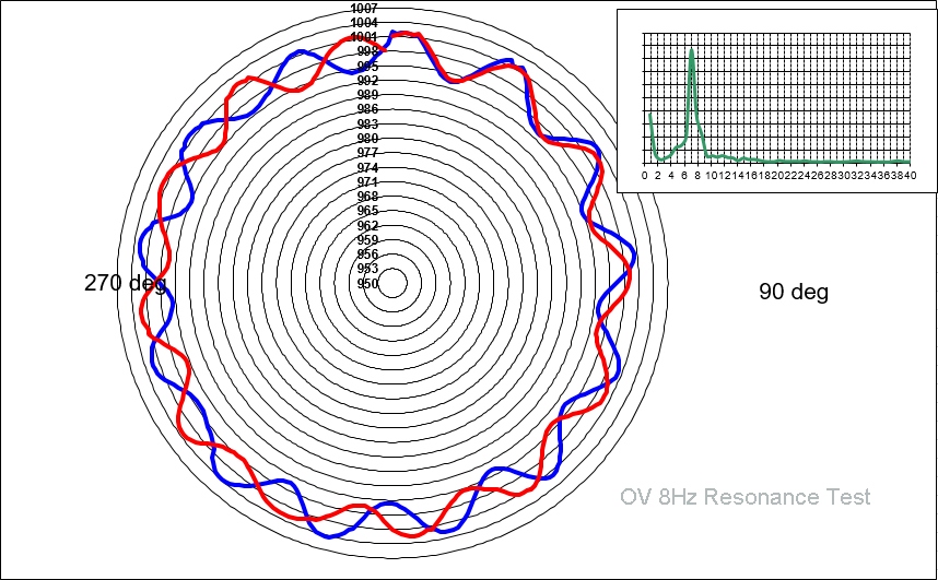

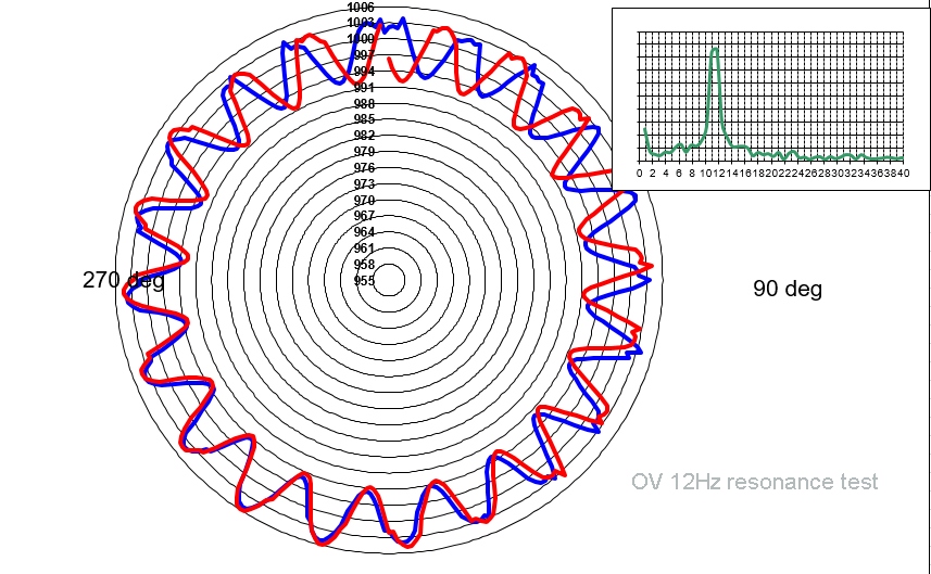

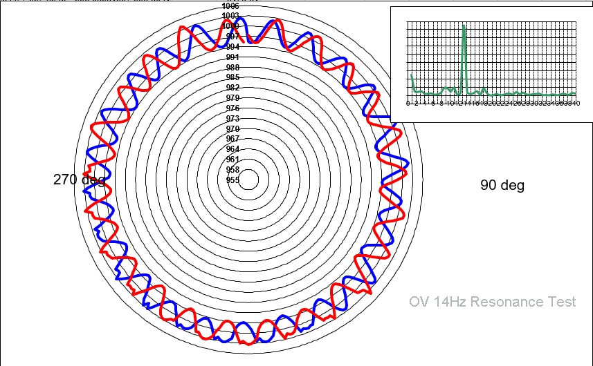

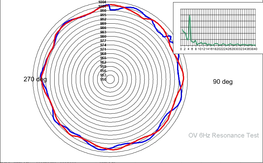

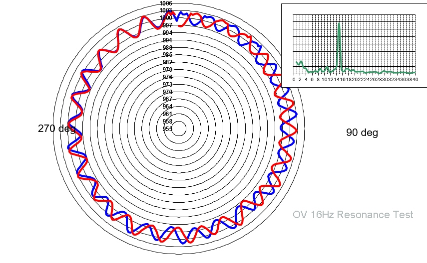

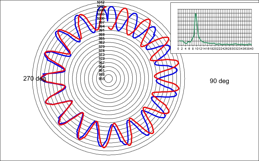

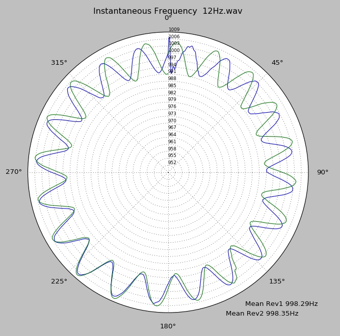

LD, re the plots of #741, are these from my original files, or did you apply filtering on those two without (much) lo-freq content?
R.
Hi, OV - methinks you mean #641 and the posts which precede them........ but actually I didn't yet analyse or post polar plots for those files, despite being interested to do so.
Anyways, I've found time to run them now, so here's polar plots for that series of resonance test files, which seem to be extracts from a resonance sweep, centred at 6Hz, 8Hz, 10Hz, 12Hz, 14Hz, and 16Hz. With a 1kHz carrier.
NB the scale has been changed to 0.3% per tramline, to fit in the large excursions associated with resonance.
In this case, the resonance seems to have a fairly low Q, which is a good thing IMO, and seems centred be near 10Hz.
This is always interesting IMO, because it illustrates the FM effect of cart-arm free motion, and its relatively large contribution to pitch variation in the scheme of things.
Consecutive rotations don't align in these plots, presumably because the test file stimulus is a sweep? Just by way of explanation......
Interesting ? Similar to George's test files and plots, previously posted but with lower Q.
BTW, to answer your question, no filtering is applied: the method is exceptional at rejecting out of band content.
LD

Thanks LD, yes, the arm-cart resonance is near 10Hz. This is no sweep, the tracks on the Test LP are dedicated tracks (1khz/16Hz, 1kHz/14Hz and so on). At 10 Hz, arm movement is massive, and somtimes the needle got catapulted out of the groove, so I'm not keen on repeating it to often...
(I fear I have to take my GT2000 on the bench, anyone happen to have a SM?)
R.
That's odd, because one can see phase slip progressively around a revolution, when comparing two consecutive revs........ sure does look like a frequency sweep......... same in Scott's results too.
Yes, looks like momentary mistracking in the raw data, once per cycle too - shows up briefly in the FM as well.
LD
I double checked, both by looking at phase slip between 2 successive revolutions, and by mining the FM modulating frequency at the starting segments of successive rotations: both ways it comes out as the FM modulating frequency appears to slow by ~ 0.25Hz per revolution for the 10Hz test file. Looks similar for the other test files, visually.
I think most likely the test recording was cut into segments from a longer resonance sweep track? Otherwise perhaps the TT was slowing down smoothly (??) or perhaps the headshell resonant system was beating very slowly with the resonance test............(???)
LD
