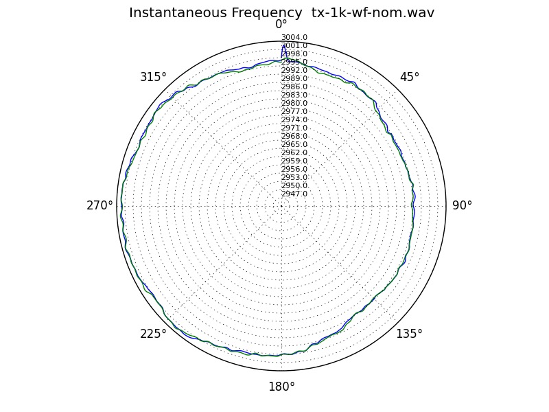

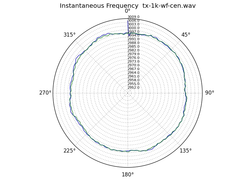

Remember my calculation for motor revolutions in 1.8 seconds? If the file was made on a 50Hz turntable and a 16 pole motor, exactly 1/4 cycle offset per revolution is expected

However, this case is totally different: the test files intentionally induce headshell motion at determined LF frequencies, inducing FM in the carrier, and this clearly happens for all of the six test files at different frequencies as intended. In this case, nothing to do with motor cogging in any of the test files ...........Remember my calculation for motor revolutions in 1.8 seconds? If the file was made on a 50Hz turntable and a 16 pole motor, exactly 1/4 cycle offset per revolution is expected
On another occasion, when motor cogging is at issue, you would be right - except that phase slip wouldn't typically be progressive around a rotation, unless something is very seriously slipping...........
LD
Cogging with 11.25 cycles per revolution would be progressive and if you could display five revolutions, you should see the fifth pattern on top of the first.
However, that is not what we see here at all. Rather, a continuous progressive phase slip within one rotation..........Cogging with 11.25 cycles per revolution would be progressive and if you could display five revolutions, you should see the fifth pattern on top of the first.
.......frequency being rate of change of phase and all.........
Besides, posts crossed and Onvinyl confirms the test files are cutouts from a longer test track. That makes sense. If it looks like a duck and quacks..............🙄

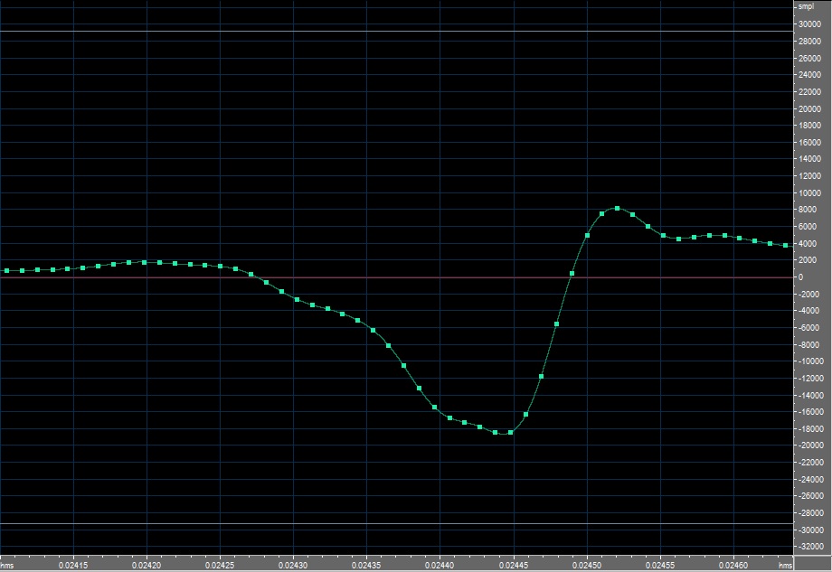

I tried the locked runout groove speed check last night. I was easy to find an LP by ear that seemed to be a sharp distinct click.
It was easy by eye to find its position to better than one sample period at 96K, more than enough resolution. Problem, if you look at our plots of continuous speed there are "bumps" that repeat every revolution, this technique only samples a single spot. This would be true of the scratched groove technique too.
Still in many cases this give a good indication of relative speed within the accuracy of the clocks in your DAC. I got 33.375 RPM and 33.373 RPM 30 sec later.
Yes, but that misses the point that variation in pitch is far more significant to audibility than absolute pitch......... reasonably, so long as there's no gross-out....Still in many cases this give a good indication of relative speed within the accuracy of the clocks in your DAC. I got 33.375 RPM and 33.373 RPM 30 sec later.
LD
Simply an attempt to double check the frequency calibration.
OK I get it thanks: checking absolute frequency of the recorded carrier tone on the test record.Simply an attempt to double check the frequency calibration.
LD
I thought it was just to measure how long it takes for the LP to make a full turn. At a 96kHz sampling rate, the measurement is very fine.
Yes that is true but there should be 1800 cycles of a 1kHz tone in 1.8 seconds at 33 1/3 RPM. So it is a double check on the frequency accuracy of the recorded tone on the LP. This information could be used to scale your results to as good as the clock on your DAC is.
