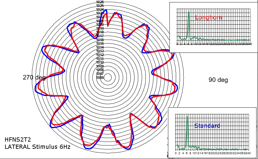

My SW doesn't use Hilbert transforms, and methodically is different. For whatever reasons, it doesn't suffer from strong out-of-band content issues, and LF noise rejection generally seem to significantly outperform the current version of the python sw.
So every encouragement to keep developing it and fix these issues: I think it's necessary and worthwhile.

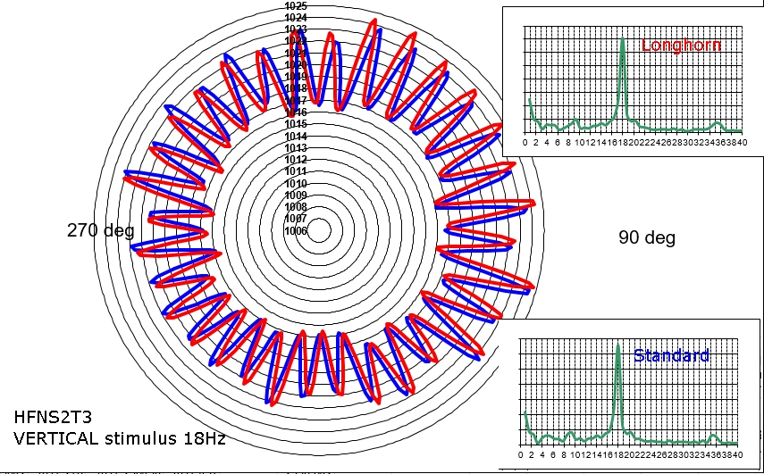

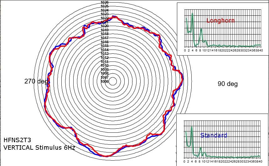

Here's a couple of polar plot reposts from earlier on the thread, showing the effect of playing a resonance test track near cart-arm resonant Fs. These were part of George's Longhorn mod tests, which seems to bury some demons.................
LD
