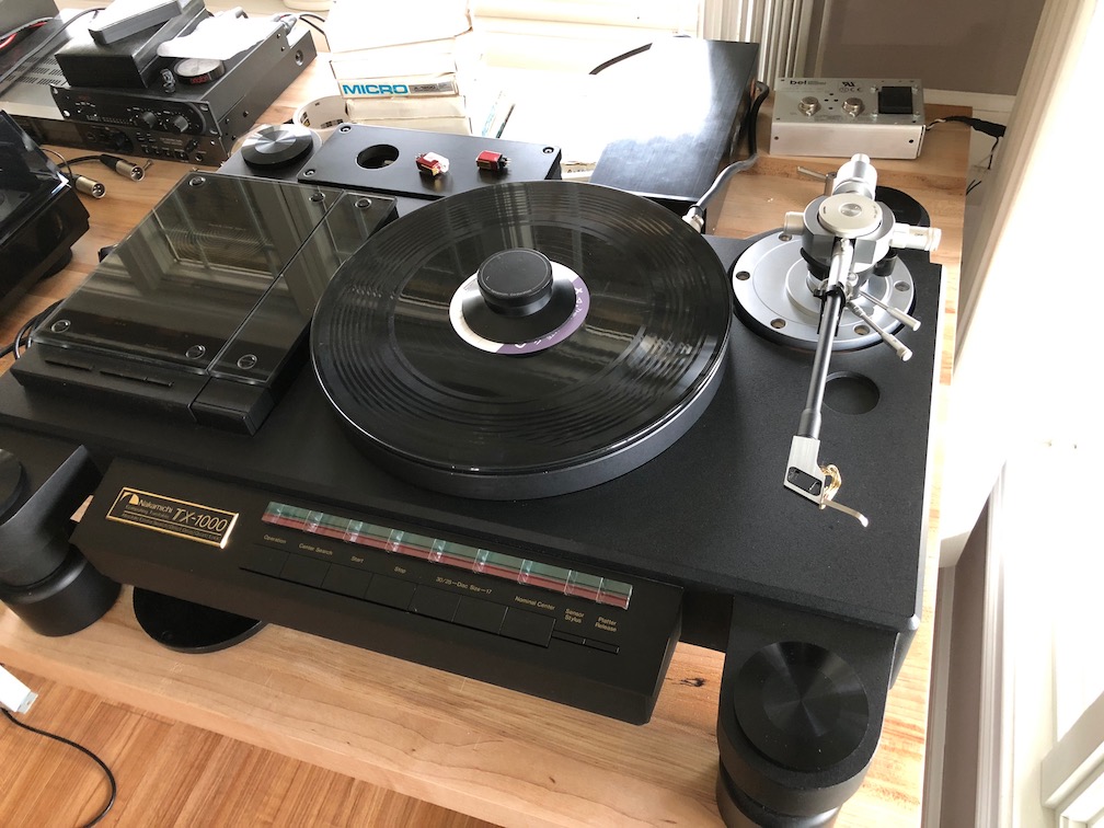

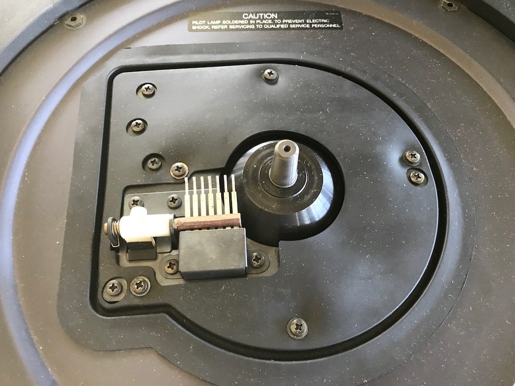

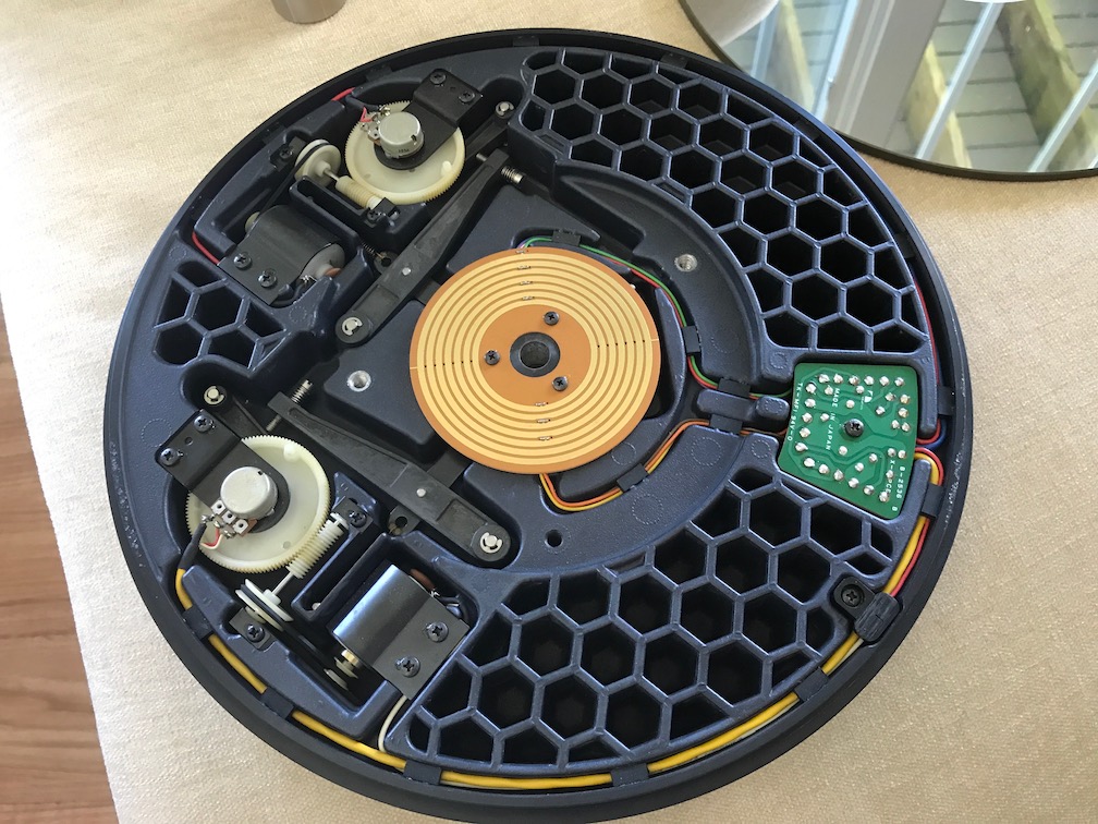

One of my (many) project ideas is to make a TT that does that. The platter would have two hobby servo motors to do x-y movement of the spindle, and they would be powered by concentric slip rings under the platter using contacts that would only be engaged while the servo motors were being adjusted. I have yet to design the offset-sensing apparatus.
Thanks JP, very nice. A giant leap for playback performance.TX-1000 before and after Center Search.
As simple a thing as centering makes such a difference.

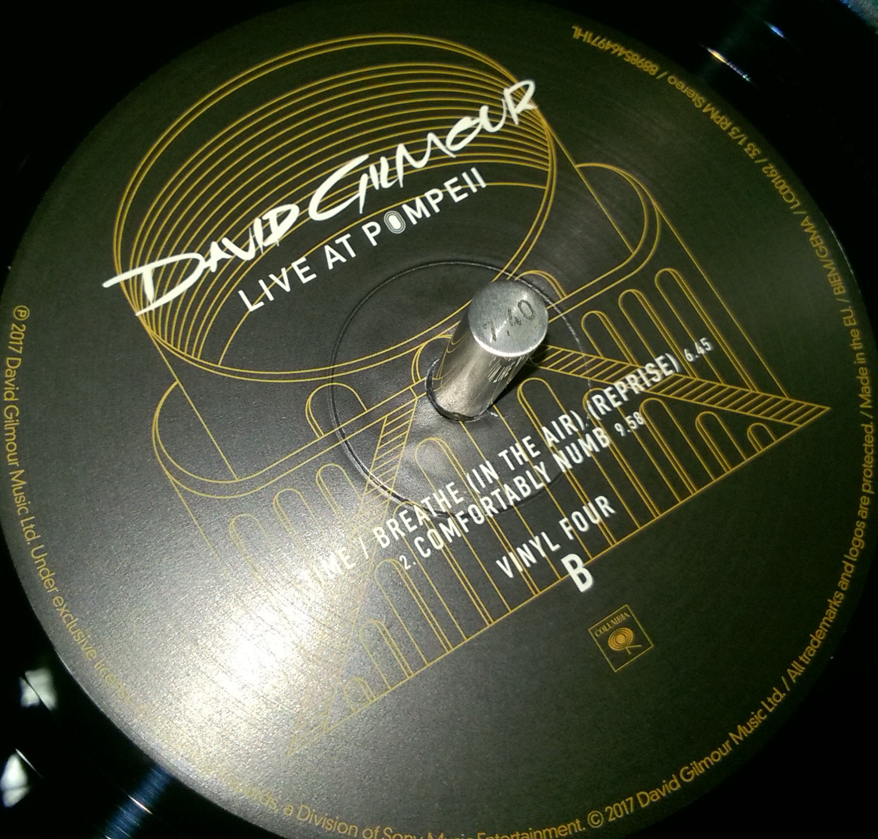

Just read this about the Nakamichi player on the moment I have a discussion with some pressing plants about the centre hole after receiving a new record box from David Gilmour .

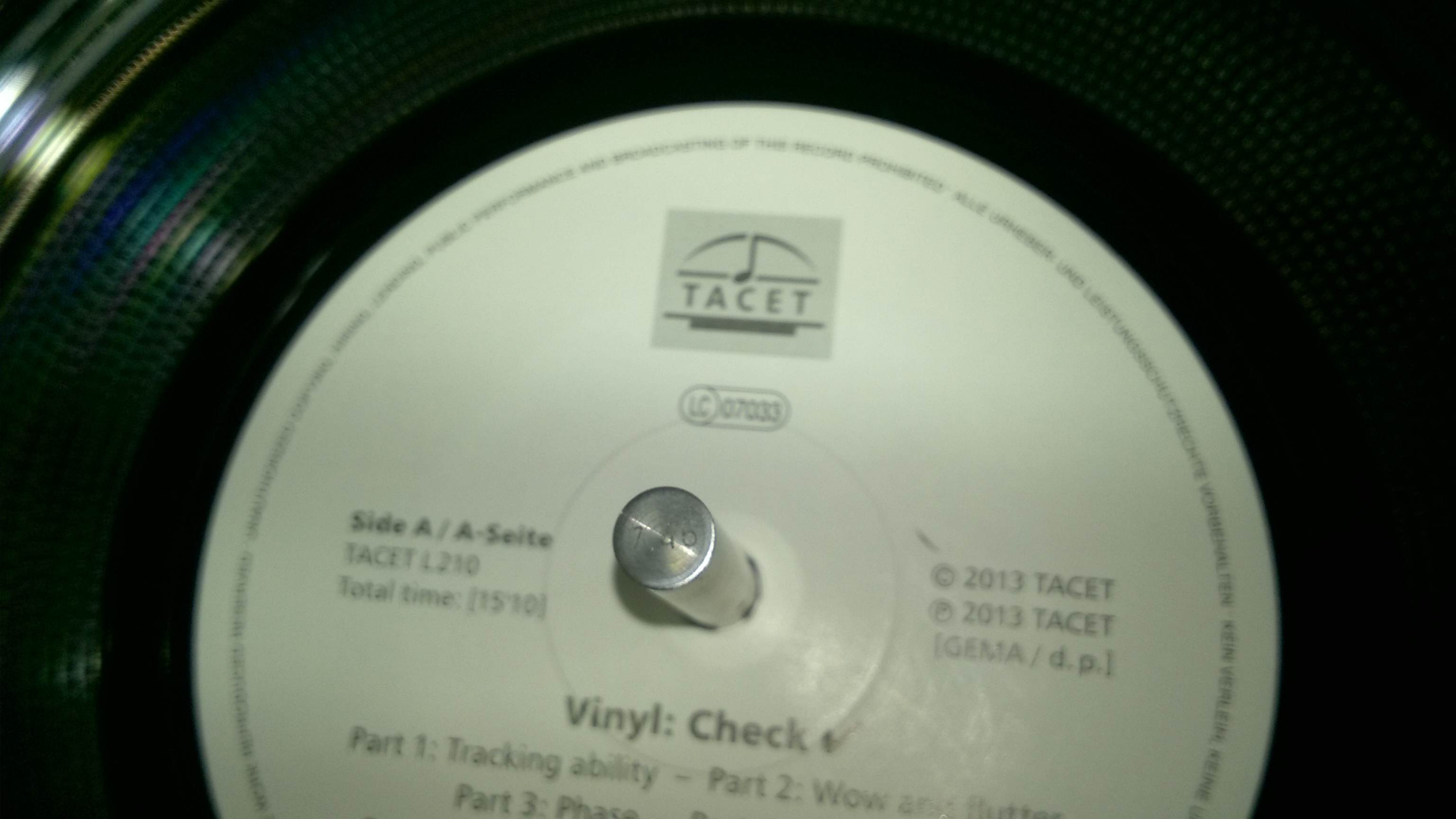

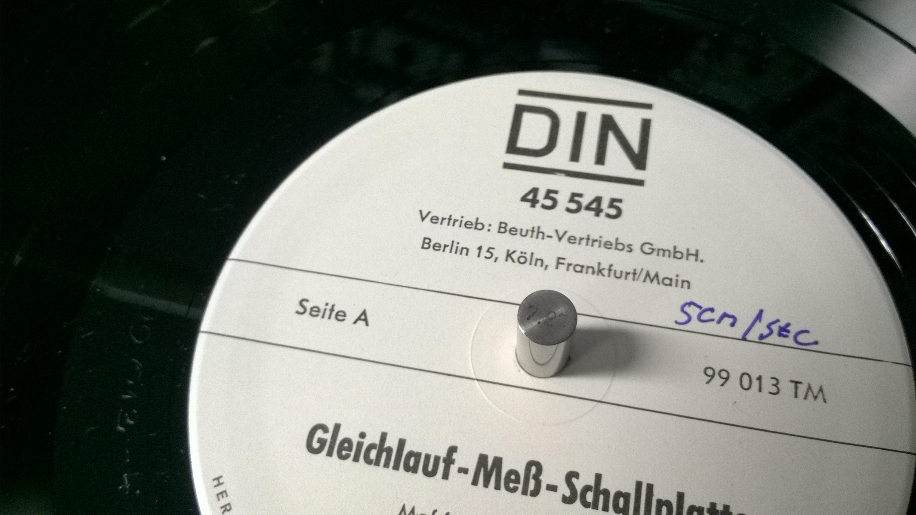

For my own W@F measurements I use some known testrecords were the older ones are within spec ,the later ones not as you can see in the picture .
Important thing to keep in mind because not all plants are serious about that.

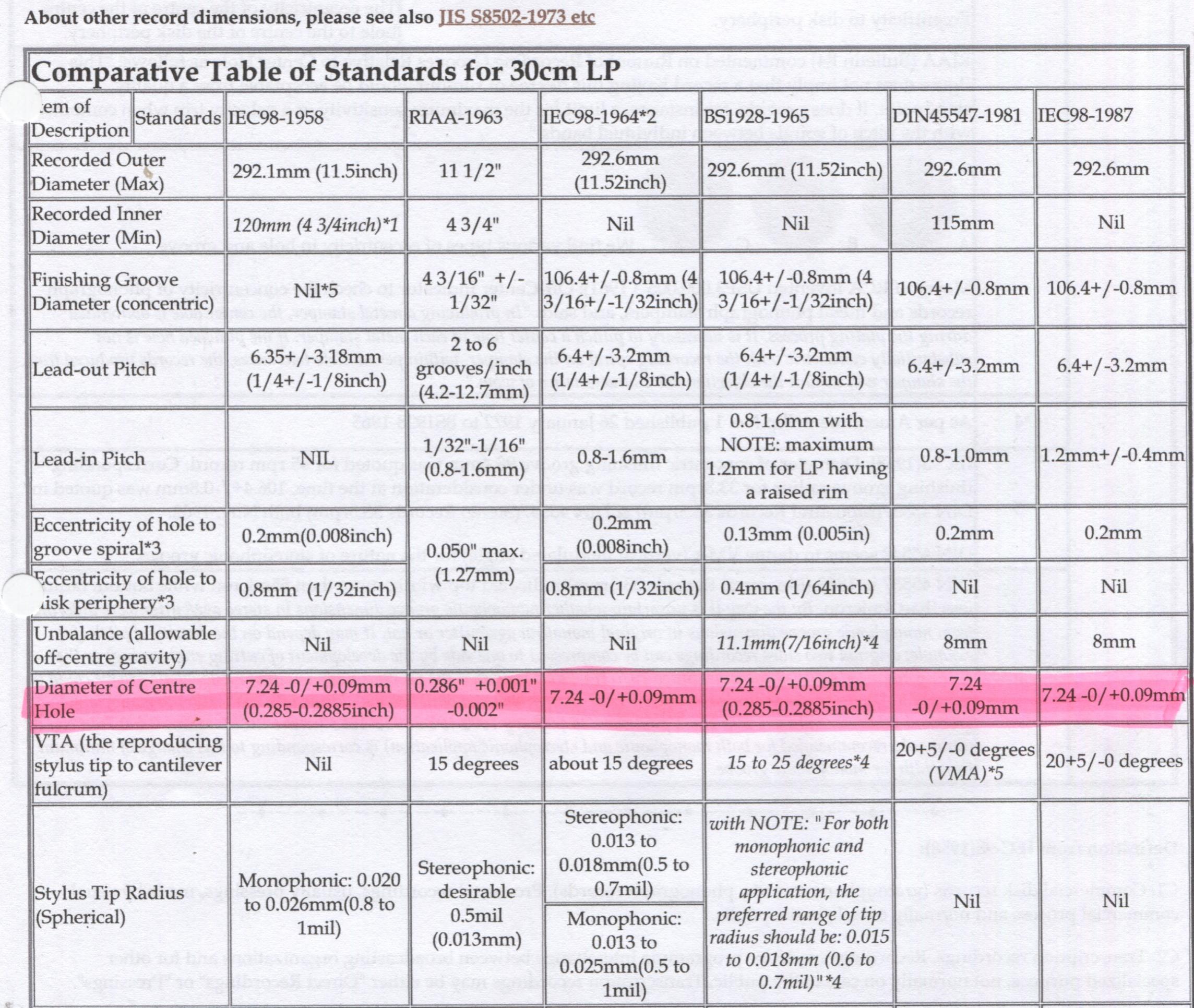

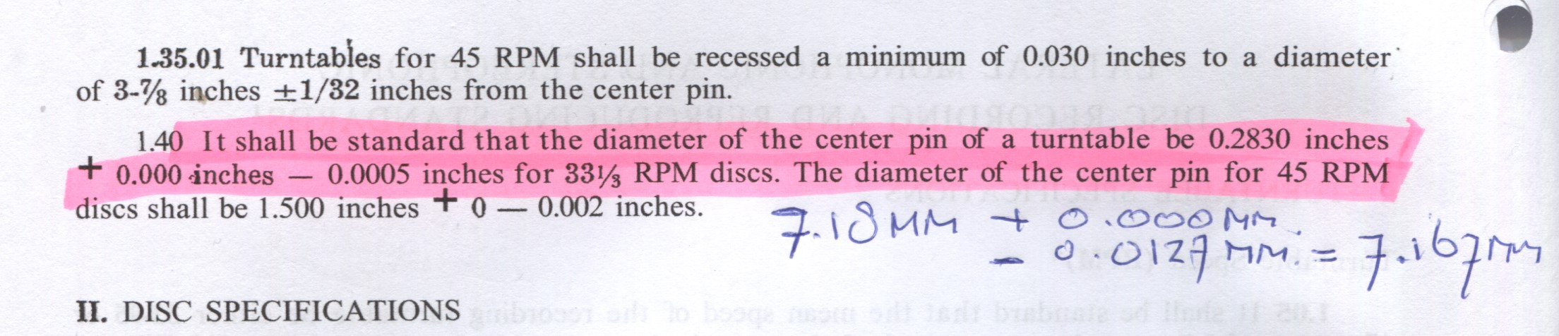

Looks like the eccentricity spec for RIAA is much sloppier than any of the others. 1.27mm off center who cares if the hole diameter is perfect?
Mama. Let's hope it's a typo and should be 0.005"/ 0.13mm. Then again, there are many production records that don't meet the consensus hole size or centre specs, IME.Looks like the eccentricity spec for RIAA is much sloppier than any of the others. 1.27mm off center who cares if the hole diameter is perfect?
Even if records did meet those specs, the limits still seem set by what might just about be achievable in mass production rather than what's needed to be inaudible..........
