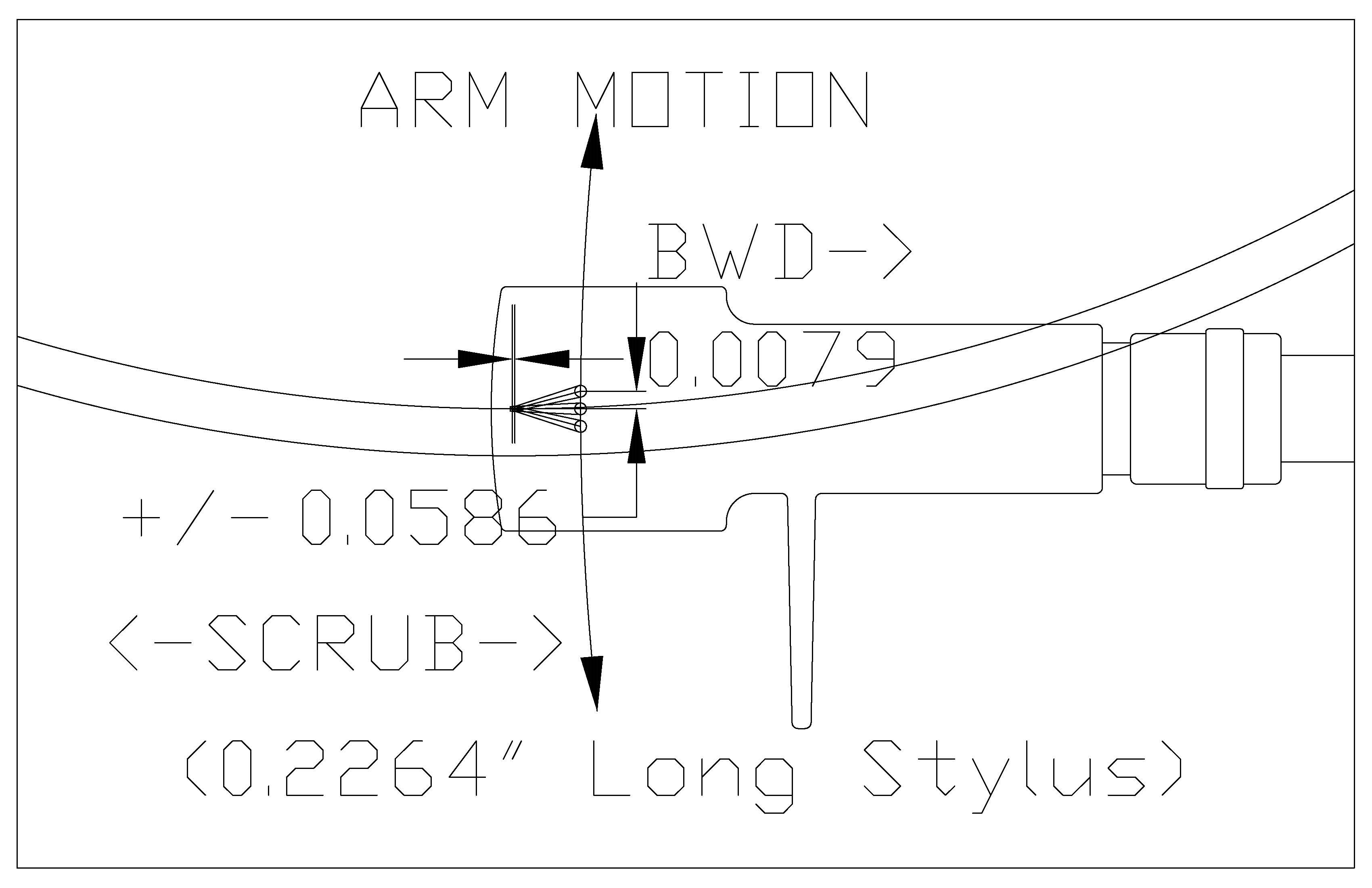

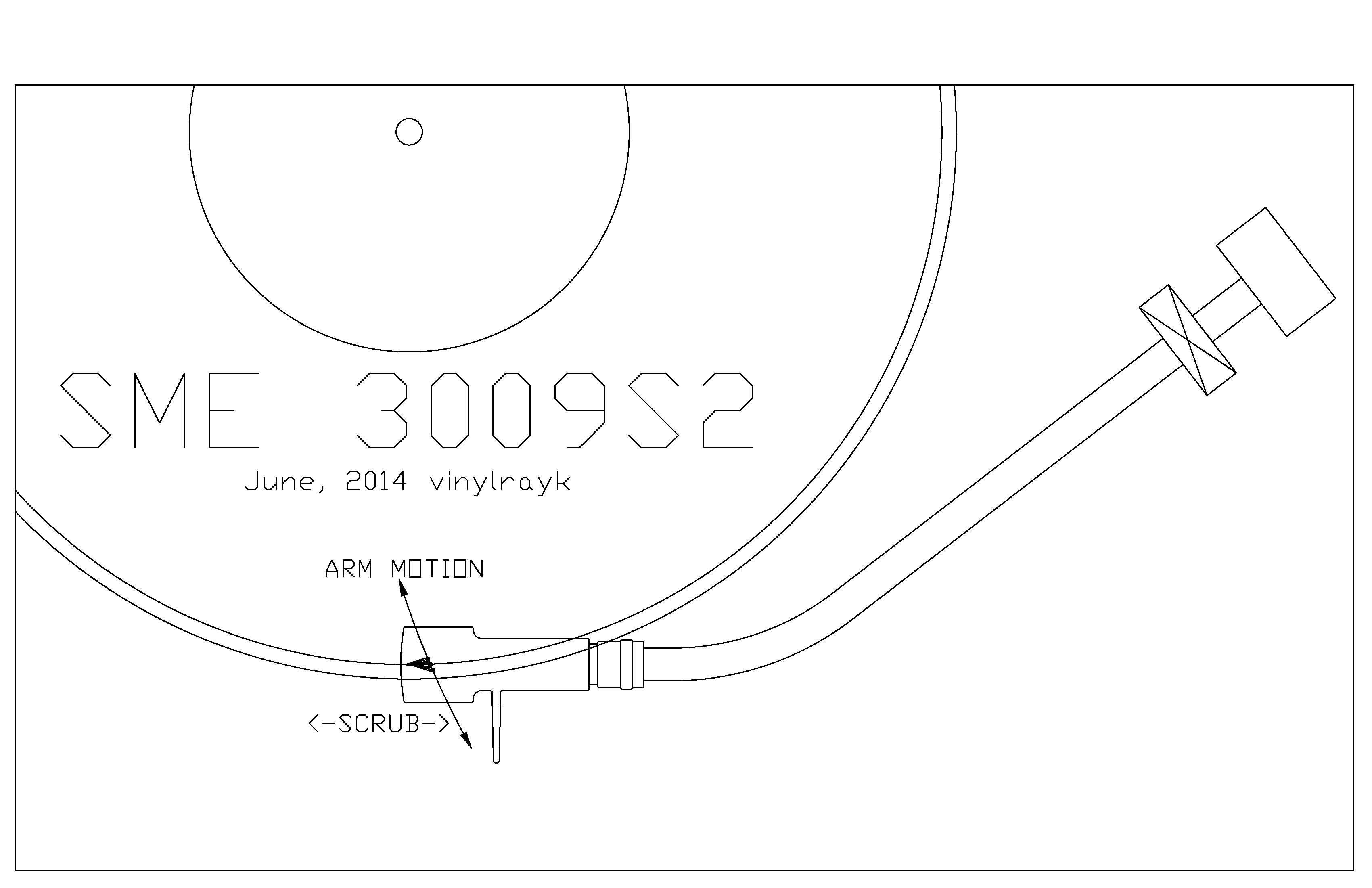

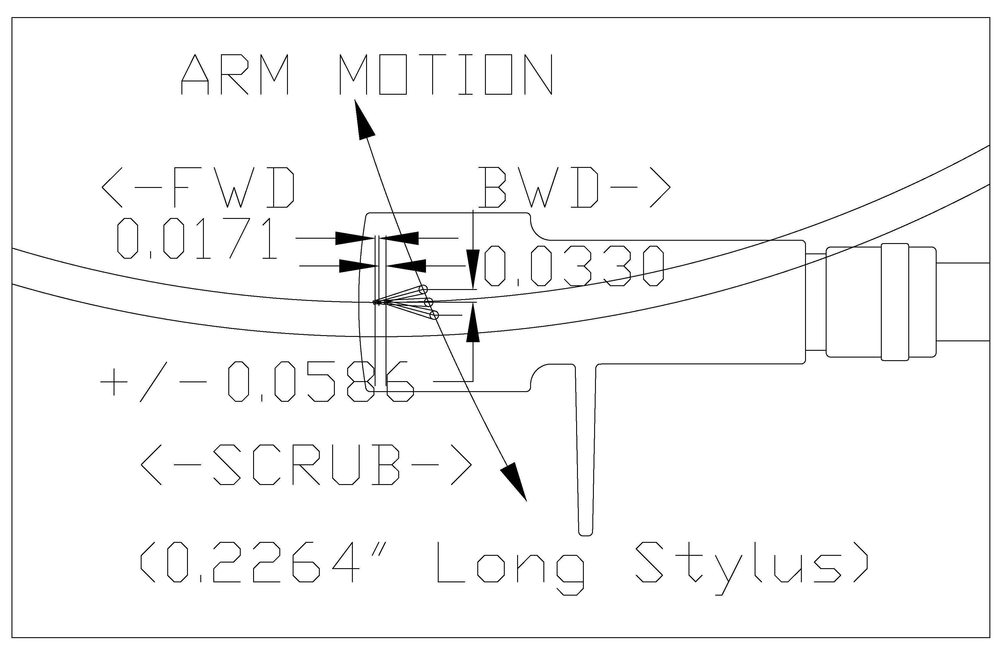

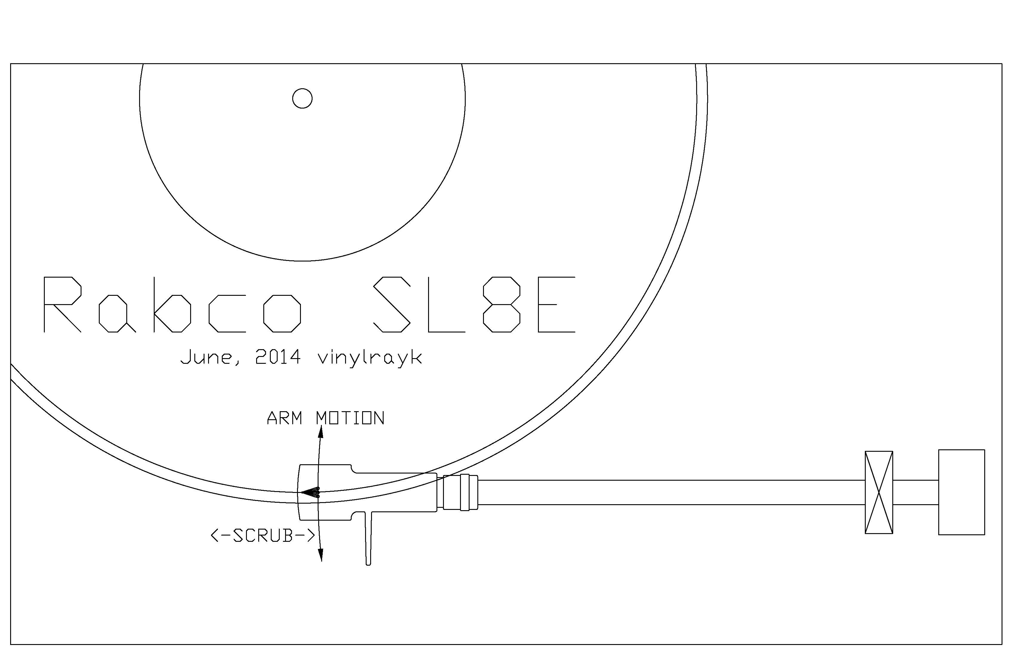

Damping, and tonearm geometry. For a given arm/cart displacement in the horizontal plane, stylus scrubbing (and FM) is intrinsically dependent on the offset angle.
Conventional pivoted arm:
http://www.diyaudio.com/forums/attachment.php?attachmentid=651970&stc=1&d=1513694774
Conventional pivoted arm, with a horizontal displacement +/- 1.5mm (0.0586 inch):
http://www.diyaudio.com/forums/attachment.php?attachmentid=651972&stc=1&d=1513694957
Linear tracker:
http://www.diyaudio.com/forums/attachment.php?attachmentid=651973&stc=1&d=1513695050
Linear tracker, with a horizontal displacement +/- 1.5mm (0.0586 inch):
http://www.diyaudio.com/forums/attachment.php?attachmentid=651974&stc=1&d=1513695099
Full disclosure statement: I am 'biased' towards linear trackers.
Ray K

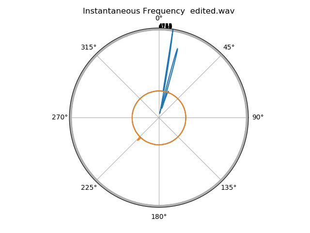

Hi Scott,
I got your script from post #562 (as well as the other changes you mentioned in the next few posts) and it is plotting something strange. Can you help? For starters, I had a lot of trouble to get the script to open the file in the first place (quotes and all). I'm on a Win7 machine. Here's the wav file:
edited.wav - Google Drive
Thanks!

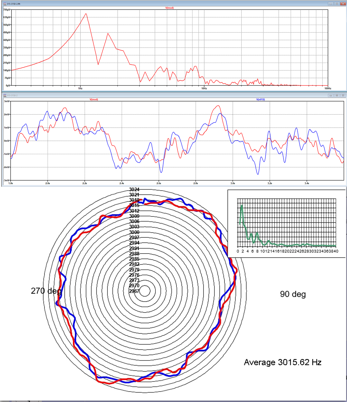

At first sight it looks nice to have a circular display of pitch variation.
However, this way of imaging distorts the data to some degree.
That's why it could be an option for the script that is still under development, to have the choice between linear and cicular displaying the data.
Personally, I prefer the linear way of displaying.
Also the FFT from this data reveals quite a lot more when displayed on a logarithmic scale, this could be another option for the script.
I used the file 12.wav, made available by Ovinyl and processed in a circular way by LD.
You can very well see that the pitch variation data is identical in both images for 2 consecutives revolutions
On the linear dispay, 1mV corresponds to 0.1% pitch variation, just as the circles in the polar display are 0.1% apart.
It is also quite obvious in the logarithmic FFT at the top of the image, that this TT has no 0.55Hz component, but a very strong 2nd and 3rd harmonic at 1.1 Hz and 1.65 Hz.
And the higher harmonics at 2.2Hz, and 3.3 Hz are still visible in this logarithmic image.
Also the resonance of the Cart/Arm looks a bit unusual, maybe they show resp. the horizontal and vertical Fres ?
A lot of information, all hidden when using a linear scale.
Hans

Hi Scott,
Thanks!
ra7-
Two things: The level is very low, try increasing the volume of the recording.
There is a ~0.5Sec blank at the beginning of the recording (no audio at all). If you can't edit this out, you need to start the analysis within the software by moving the pointers 1 sec past the beginning.
