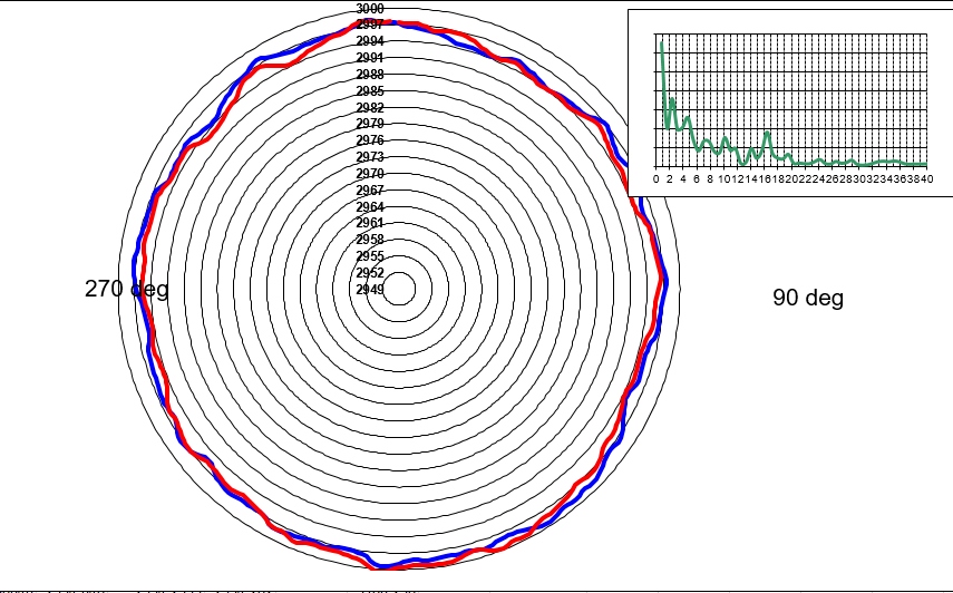

@luckythedog, I'd be interested in a polar plot for this one, if you'd be so kind:
Dropbox - 20170422-T003_WF_1.wav
Sure, here it is. Very good too, perhaps near as good as it gets.@luckythedog, I'd be interested in a polar plot for this one, if you'd be so kind:
What rig is it ?
LD
Thanks! That's one of my Technics SP-10 MK3. I may have another sample in a few weeks that hopefully shows some improvement.

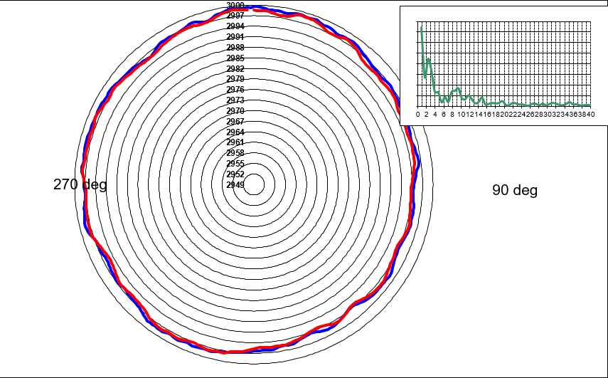

Perhaps this one if it's not too much:
Dropbox - MK4_XG-7001_WF_1.wav
The second one is an SL-1200 GAE, and this is an SL-1200 MK4. All three with the same test record.
Interesting. So it's not just the big block V8 of the motor world 🙂
As someone used to wimpy motor belt drives getting a 10kg platter to speed in a 1/4 revolution still makes me want one just for that party trick!
No, it's definitely not. Same important bits as the SP-02, for which they claimed 0.0034% W&F, though via measuring the motor FG.
Sure - if I understand it, this is the SL-1200 GAE.
Very nice too.
What arm/cart for these files, JP ?
