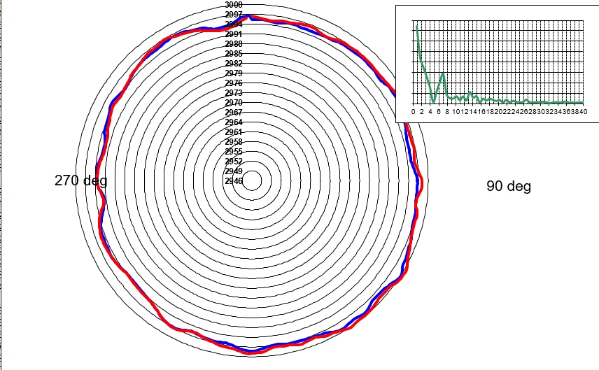

Here's the polar plot for this one, the SL-1200 Mk IV.Perhaps this one if it's not too much:
Dropbox - MK4_XG-7001_WF_1.wav
The second one is an SL-1200 GAE, and this is an SL-1200 MK4. All three with the same test record.
Good, but a few things going on and two halves of the rotation are somewhat different.........

Thanks, @LD. As both revolutions track most likely a bearing issue? Do you have a plot for a healthy MK4?
@Hiten - serviced and using my replacement module for the MN6042. This one does have an issue: something in the drive circuit is temperature sensitive so calibration drifts until it's warmed up. I'll try to record a sample from one of my completely healthy units.

I think one might tell a bearing issue from free rotation spin down time..... I have one SL-1200 MkII plot that shows a similar trait, but several others that don't.Thanks, @LD. As both revolutions track most likely a bearing issue? Do you have a plot for a healthy MK4?
Balance or levelling, perhaps........? In general, SL-1200's are exemplary IME, at least in terms of rotational stability.

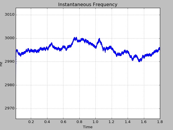

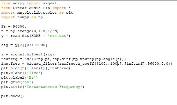

This is what I got with the direct Hilbert transform method and simple two pole filtering at 100Hz. LD, I just grabbed 1.8 sec out of the middle of the file do your plots represent more than one rev? This is the MK4_XG-7001_WF_1 file recently posted. I used the library I wrote for LA which is a free download at Jan's site. Again one nice feature is that Python does not care about power of 2 FFT's.
I need to finesse the cartesian to polar transform to make the polar plot look right. The default really wants the origin to be 0 so visually there is no resolution around 3kHz. I used SoX to convert the .wav to generic text data.
