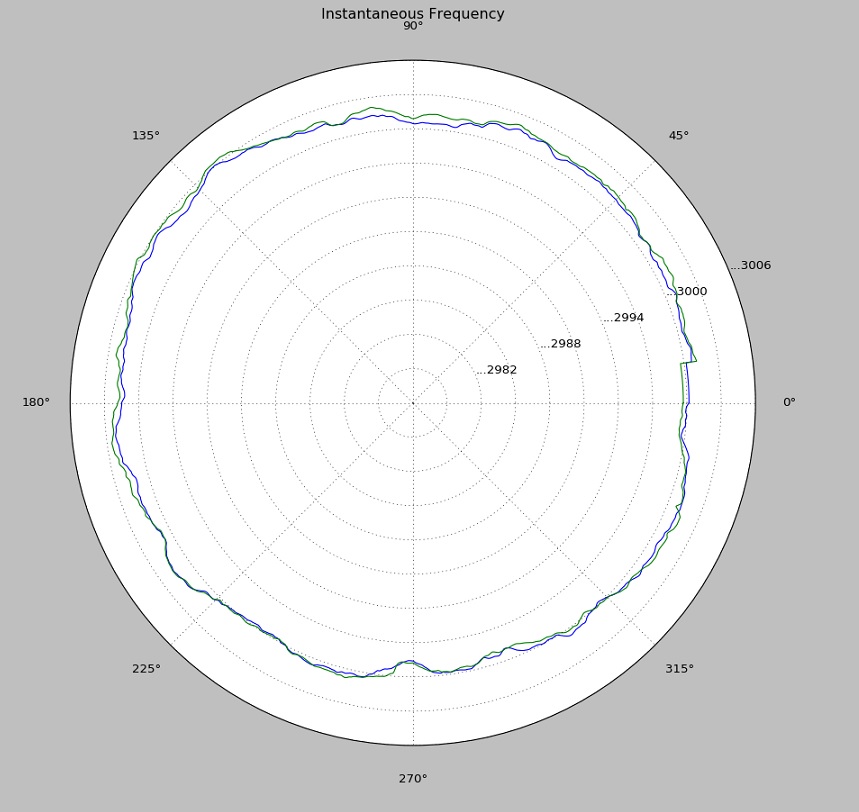

Great, at first sight it looks plausible, perhaps a bit noisy. I concur as to the range, and to check further I'd need to know the start time within the file: I used 10s as a start time and looked at 2 revolutions from there.This is what I got with the direct Hilbert transform method and simple two pole filtering at 100Hz. LD, I just grabbed 1.8 sec out of the middle of the file do your plots represent more than one rev? This is the MK4_XG-7001_WF_1 file recently posted. I used the library I wrote for LA which is a free download at Jan's site. Again one nice feature is that Python does not care about power of 2 FFT's.

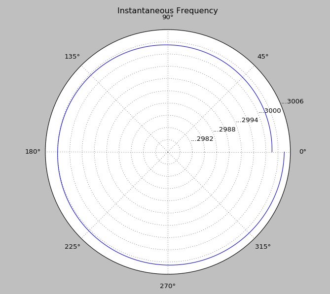

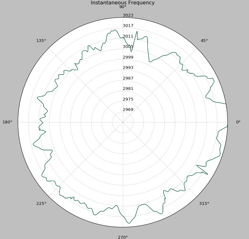

I think I fixed the polar display problem, seems there is not as many methods for tick labeling in a polar plot. I think I can fake something. The noise comes somewhat from the fact that this method samples the instantaneous frequency at the same rate as the data. I post filtered the output to get this plot. I also noticed the second harmonic is at 10% and when I took another file from last week there was less close in noise.
I will keep playing and it is easy for me to repeat this starting at 10 sec. BTW there is virtually no performance hit if you stick to numbers with small prime factors, 44100, 96000, and 65536 are not very different in a modern FFT library. the FFT of 1000000 points and 1048576 point both return to the prompt instantaneously (also because the FFT library is totally compiled C++). A 6 digit prime however might take several minutes.
OK here's the same data as LD's, two revs starting at 10s. I noticed I have the scaling off a little because I tried to keep the plot less busy, easily fixed. I simply filtered the raw data twice this time, getting close.
EDIT - it looks like the tick marks are spaced twice as far apart as they should be no time left today to fix it.

LD's plots have 0/360 deg at the top and the angles increase clockwise, which is more intuitive (at least to me).

I can probably rotate/flip the plot though I would first like to get his 0 equal to my 0, the start of a rotation is fairly arbitrary in any case. The default setup is the standard for vector notation I think.

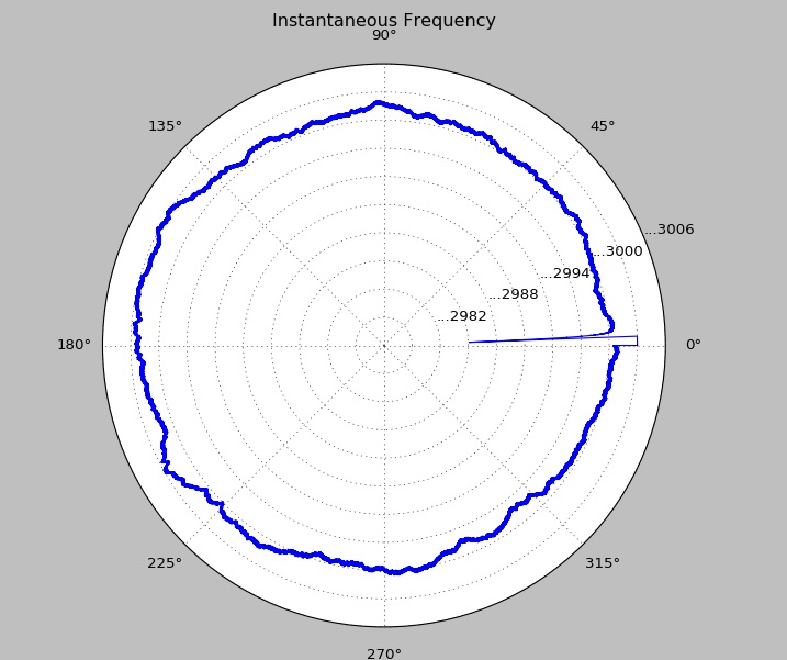

Decided to eat in tonight so I had time for a few more tweaks. This is a very old plot of a VPI HW-19. This is actually a before and after overlay of a 400Hz brickwall filtered data set. The noise immunity is pretty good.

All good stuff, Scott.And here is the data set from yesterday, the glitch is a discontinuity at 0 from the IIR filter that I used to smooth the data. I was surprised that this technique is also fairly robust with respect to pops.
The range seems different between this plot and your linear plot in #356..... and also the range in your polar plot of the same dataset as mine is different I think - suspect a display scale issue, if you haven't already spotted it............?
I think a convention of rotation which follows platter direction, clockwise, is intuitive, and starting data at noon seems good as a convention, if that's possible ? That makes it far easier to compare results.

OK just seen this - presumably, that should fix the scale issue ?EDIT - it looks like the tick marks are spaced twice as far apart as they should be no time left today to fix it.
Scott, is it possible to place the ticks at 0.1% or 3Hz intervals, by convention, for consistency, and to display either 18 or 20 ticks or that equivalent range?
LD
I already set 20 ticks up just need to shrink the font size a little to make it readable without blowing it up too much. Not all the axis labeling commands have correction for the polar projection built in but I know I can fix the theta axis labels somehow if even brute force changing their text.
