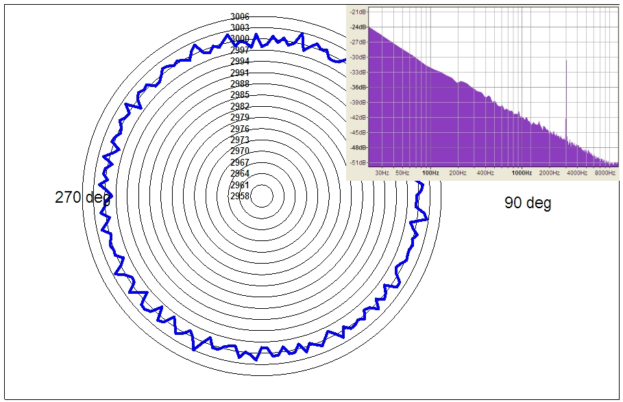

Here's the polar plot for that file, JP, an SL-1200 MkIII.
2 revolutions, starting at 10s in the file.
It is, once again, near as good as it gets, perhaps. The pick of a very good bunch. If one is super-critical, there's a slight flattening near 5 o'clock - similar events cropped up in the other files IIRC, so perhaps the test record is implicated ?
Again, the green inset spectrum auto-scales so only useful for pointers as to causes of variation, not how big they are in absolute terms.
All very good - what was the cart/arm for this one, JP ?

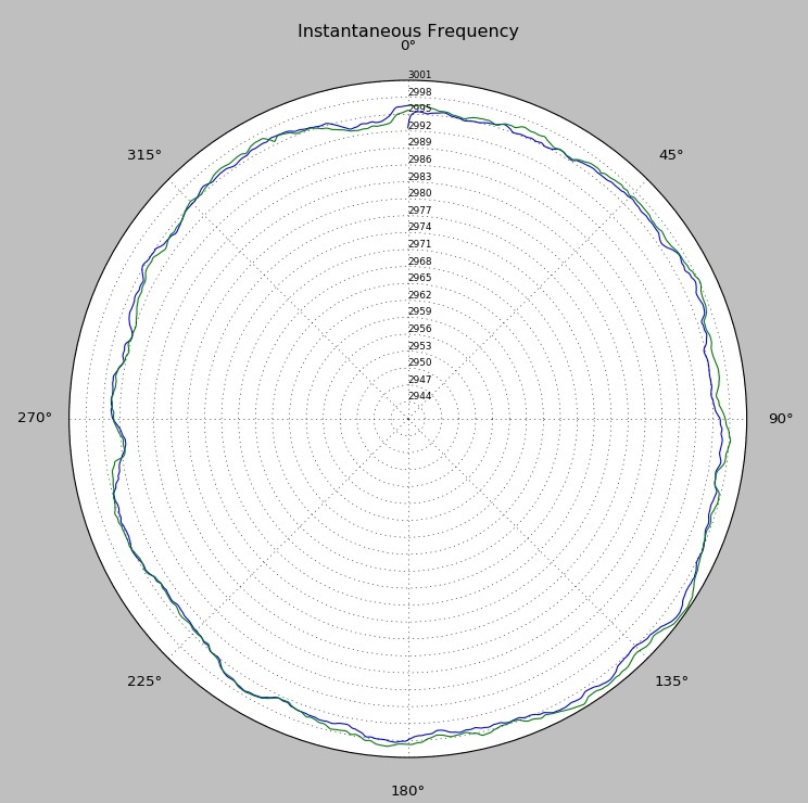

I will simply take 2 seconds of data and trim .1sec off each end. It will remain simple (with a little care) to keep multiple revolutions abbuting. In general I would think there could be a small discontinuity due to DC drift of speed but I don't see it in your plots (maybe it's too small).
I should finish tomorrow and will put up a .pdf.
LD
Could be - it's the same test record for all of them. This is another SP-10 MK3 with the same B500/A505 arm, though with a P205CMK4 cartridge.

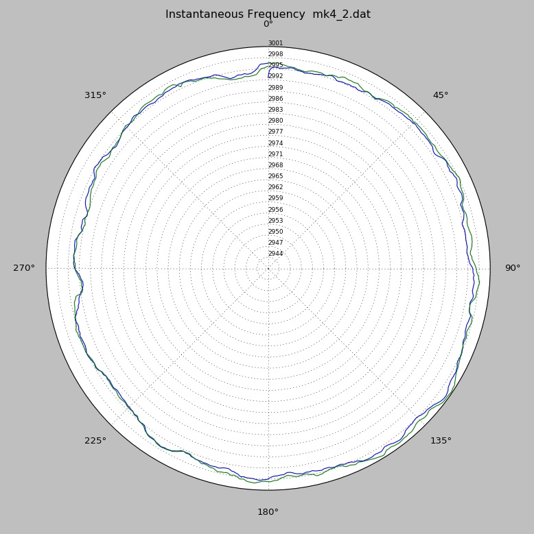

OK, couldn't stop. I decided to all the revolutions at once and just pad the beginning to eliminate the glitch. Compare to post #346, scarey close.
BTW it is confusing as you advance into the file the plots move counterclockwise.

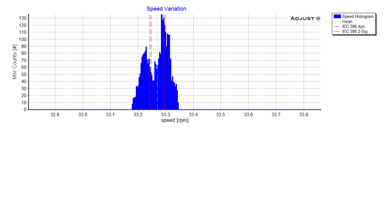

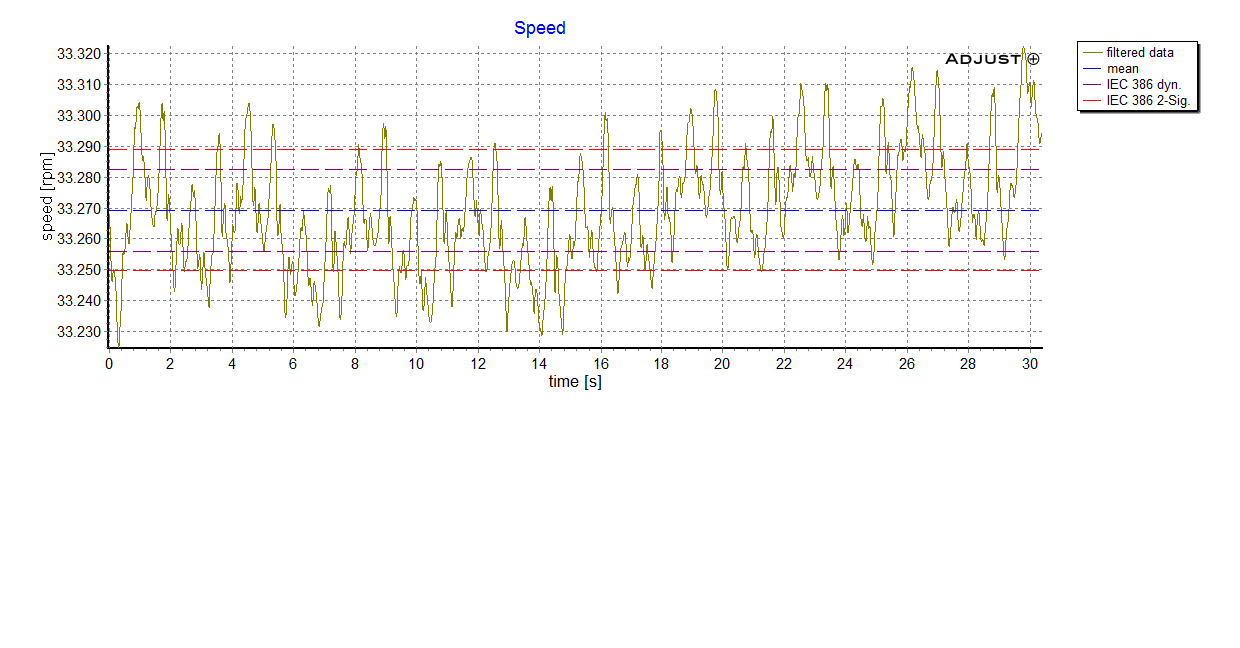

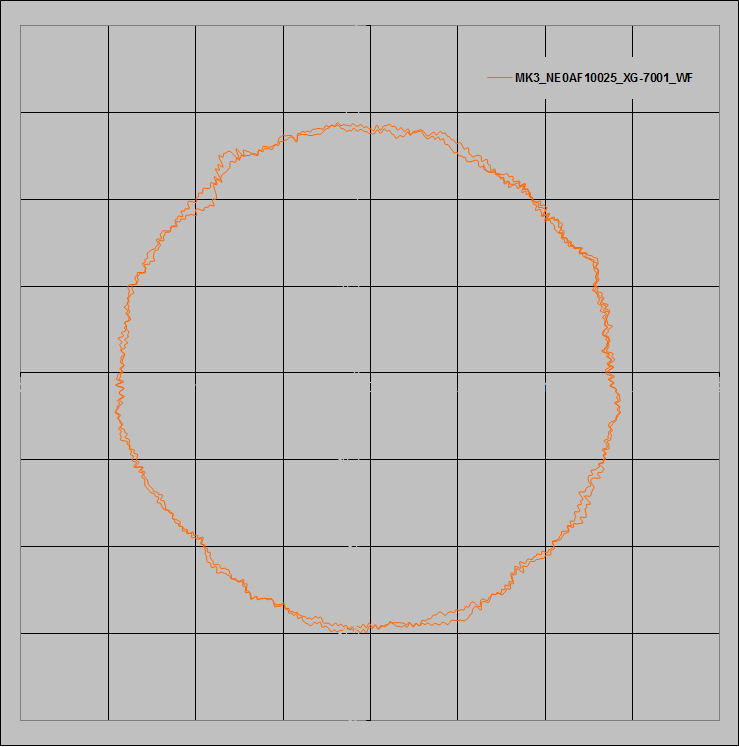

Coming late to the party, but I'd like to show some measurements in this context with the Adjust+ test system.
It indeed looks horrible compared to what we normally see from an electronic component!
Jan
Jan
Jan

I took your old code listing and figured out what is happening. It runs straight away as Python3

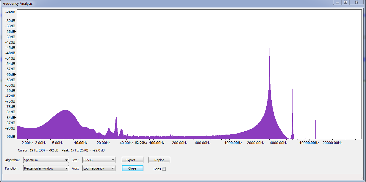

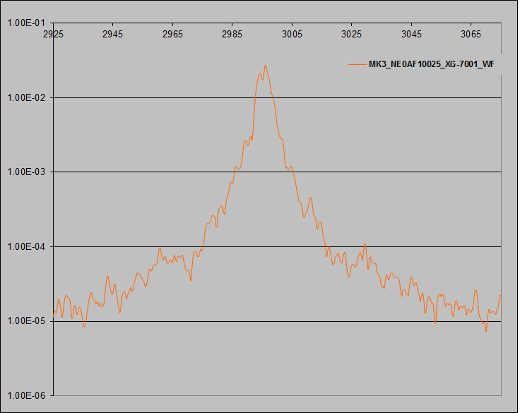

Hope no one minds but I processed the above sound file using the software I was given by the guy who used it on the Pink Fish Media Thread – see http://http://www.pinkfishmedia.net/forum/showthread.php?t=70027.
The polar plot does not give absolute values but as the software exaggerates any errors, such are readily apparent. The two FFT plots are, with respect to frequency, absolute values. The FFT Demodulated one was of particular use in sorting my Lenco out. I have also added an Audacity FFT plot of the sound file.
From my experience the results are very good and it would be hard to better. Only things to note are that the TT is running slightly slow (nominally 2996Hz (-.13%)), there is a slight peak at 16.5 Hz (which is apparent on LD’s FFT plot as well) and the Test LP is very slightly off centre (not a TT failing!!). It would be good to see a PlatterSpeed app result for this TT.
I hope this is of interest.

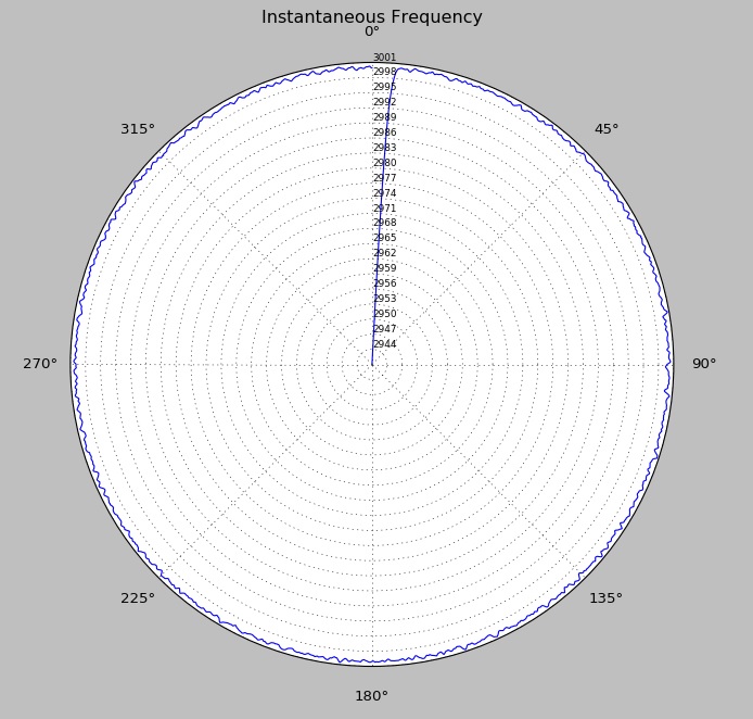

Ok here's the code in plain text format, I've commented it and removed any hard dependencies on sampling frequency so any sampling frequency should do the right thing. Also one last plot run on this exact code with file label added (compare to plot in post #346).
@ Pano that's a good idea and it would not be difficult, but a little work to get 3K, 3.15k, and even 1k to work as the base frequency.

Thank you Scott, that's very tidy and results look excellent.Ok here's the code in plain text forma
I'd guess that Python library function performance is, in practical terms here, at least as good as the one I came up with - and certainly more compact from a coding perspective ! So I think this outcome is, pragmatically, far more useful.
Though I doubt my algorithm is original, I'm very happy to see the Python library supporting a function that, in this application, appears to at least match performance. Next time, I'll look there first (!!)
Well done indeed, this takes the art forward !
