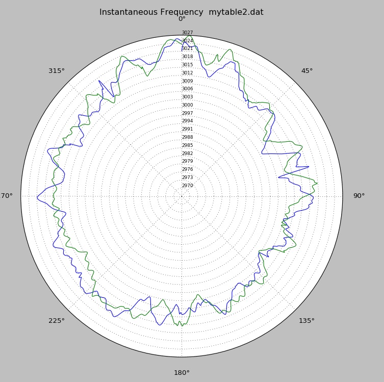

Here's the original VPI HW-19 the sample TAS reviewed (I bought it from the reviewer) with MMT arm and Grado Reference cart. This data is tainted by the fact that the MAudio USB Duo was off by 0.6% at 44.1, this was also verified in the lab with calibrated reference equipment. I think I'm the only one that ever noticed.

Great, looks plausible to me.
First question that begs is what f's are the apparent periodic contributions ?
It's straightforward to take an FFT of the display data series, to provide spectral composition. Bit-bucket spacing is then simply set by display repetition frequency, so one can readily calibrate frequency.......... amplitude I can't get my head around so I just left it to auto-scale, perhaps you can work it out?

We can all work on it and you don't have to give away your tricks. The noise rejection of your technique is remarkable. For the problem at hand I do think we can get a lot of useful data with the simplified version. For the amplitude of the frequency components maybe dB re 1%? I don't know but referencing it against some standard of "goodness" might make sense. The 9Hz wobble on that VPI is pretty obvious.
Yup, I have brain fade when it comes to mapping amplitude per Hz onto frequency deviation (Hz)............😉

I've had a think and I understand what I missed out saying. I was thinking of an interference fringe type situation, so the ripples will cancel and enhance depending on offset, but of course that won't tell us too much other than relative magnitudes, which might be enough. But a 'clicktrack' as s 3rd channel input triggered off a fixed point on the platter might add more information. I suspect most of us have bigger issues to fix before we get to this level, but worth consideration for enhancements.
Don't understand why. Can you elaborate. I must be missing something.
Take the example of a trace that shows a 1.8Hz ellipse. This might be an offset hole or a bearing/spindle problem. Now rotate the record. The new trace still shows the ellipse, but without a reference tick from the platter or the record how do you tell which it was? The 12oclock of the polar plot is determined by the start of the capture file, nothing to do with physical
