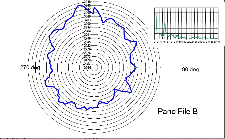

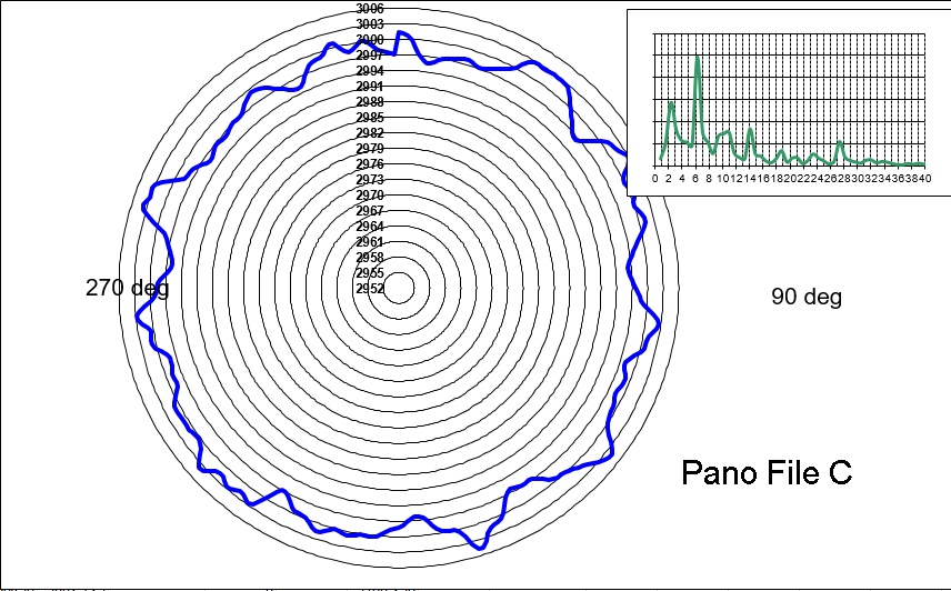

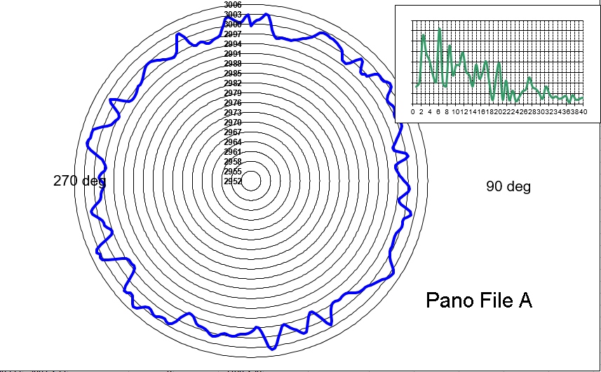

Thanks, Pano.Here are TT files that davidsrb posted that have been run thru the Capstan software.
3 files. Non-corrected, full correction, smoothed correction (not necessarily in that order.) Let's see what they look like in a polar plot. How much - if anything - was detected and fixed?
Here's the polar plots. To keep it simple, just one revolution per plot and the same start time in the files.
Seems obvious which is the 'non-corrected': file B. The others apparently have interesting artefacts, but seem to have corrected the 0.55Hz eccentricity.......if not the circa 6Hz element.......or sort of scrambled it spectrally.
The attachments have appeared in a strange order, A,C,B so check the labels on the images !
Interesting ?

Thanks Lucky! Interesting indeed. Maybe Capstan just doesn't fix fluctuations that tiny.
A= Full default correction
B= No correction
C= 30% Smoothed correction
B= No correction
After correcting, the stability of arm/cartridge is getting worse(green curve). What does this mean? I understand it is all in digital domain. But how does this have effect on listening? Does the correction make things better or worse?
Careful about the scale. "A" is the best at +/- 3Hz variationAfter correcting, the stability of arm/cartridge is getting worse(green curve). What does this mean? I understand it is all in digital domain. But how does this have effect on listening? Does the correction make things better or worse?

I chose the scale of the polar plot so that one pair of tramlines represents the so-called threshold of audibility to warble tones. It's easy to check: listen to the files ! Speakers are best, 3kHzdoes some weird spacial cue things - also check the effect of moving one's head and hear the pitch variation vanish when it's moving !
In file A (which isn't music, of course) on that test, it seems the 0.55Hz variation was pretty much eliminated and the 6Hz component pretty much randomly scrambled spectrally, leaving what looks like a quasi-random residual variation. Which methinks should be an improvement on the mostly 6Hz that was there in the first place. The magnitude of this residual variation, as I understand it, is still above the audible threshold in theory, and can be 'beaten' by a well tempered TT without correction, IME. I think it's impressive.Thanks Lucky! Interesting indeed. Maybe Capstan just doesn't fix fluctuations that tiny.

Here's a polar plot of 2 successive rotations of file A (fully corrected), which seems to show the quasi-random nature of the residue.
LD
The motor rotation is not necessarily related to the platter rotation by an integer and would scramble the peaks in successive rotations.Here's a polar plot of 2 successive rotations of file A (fully corrected), which seems to show the quasi-random nature of the residue.
LD
Only DD turntables are certain to repeat cogging artifacts at the same angle
Yes. But after correction it doesn't look like one can 'rotate' the two patterns and obtain a reasonable fit, plus the spectral content is significantly different after correction. Those patterns probably aren't truly random because they have roots in a non-random stimulus, however they do appear quasi-random, IMO, moreso than normal.
I understand A is the best from the blue polar plot, but look the green plot on right up corner. Isn't A getting worse?

Appols - the spectrum inset auto-scales so it's not possible to compare any two insets.Hard to tell when there is no scale
This is historic left over from when I was struggling to meaningfully calibrate the spectral content, and for me it's just useful as a pointer as to the spectral source of pitch deviation......
It's also a way of coping with being swamped by 0.55Hz content - so when that is removed the autoscale kicks up the remaining content.
So don't try to compare amplitude of spectral insets - they auto-scale and aren't calibrated (!)

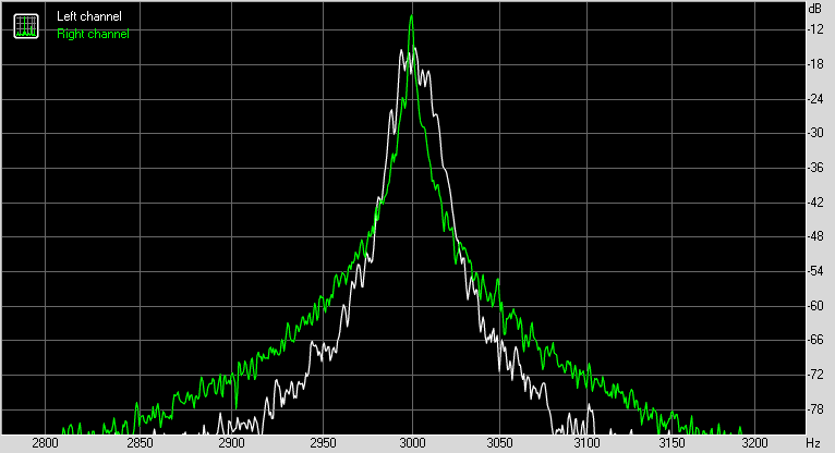

Using the tools I have - FFT - I took a look at the original and the fully corrected files and the low end is almost identical. Up at 3K and its harmonics is where we see the real difference. The correction has tightened up the 3K tone nicely, as well as its harmonics.
