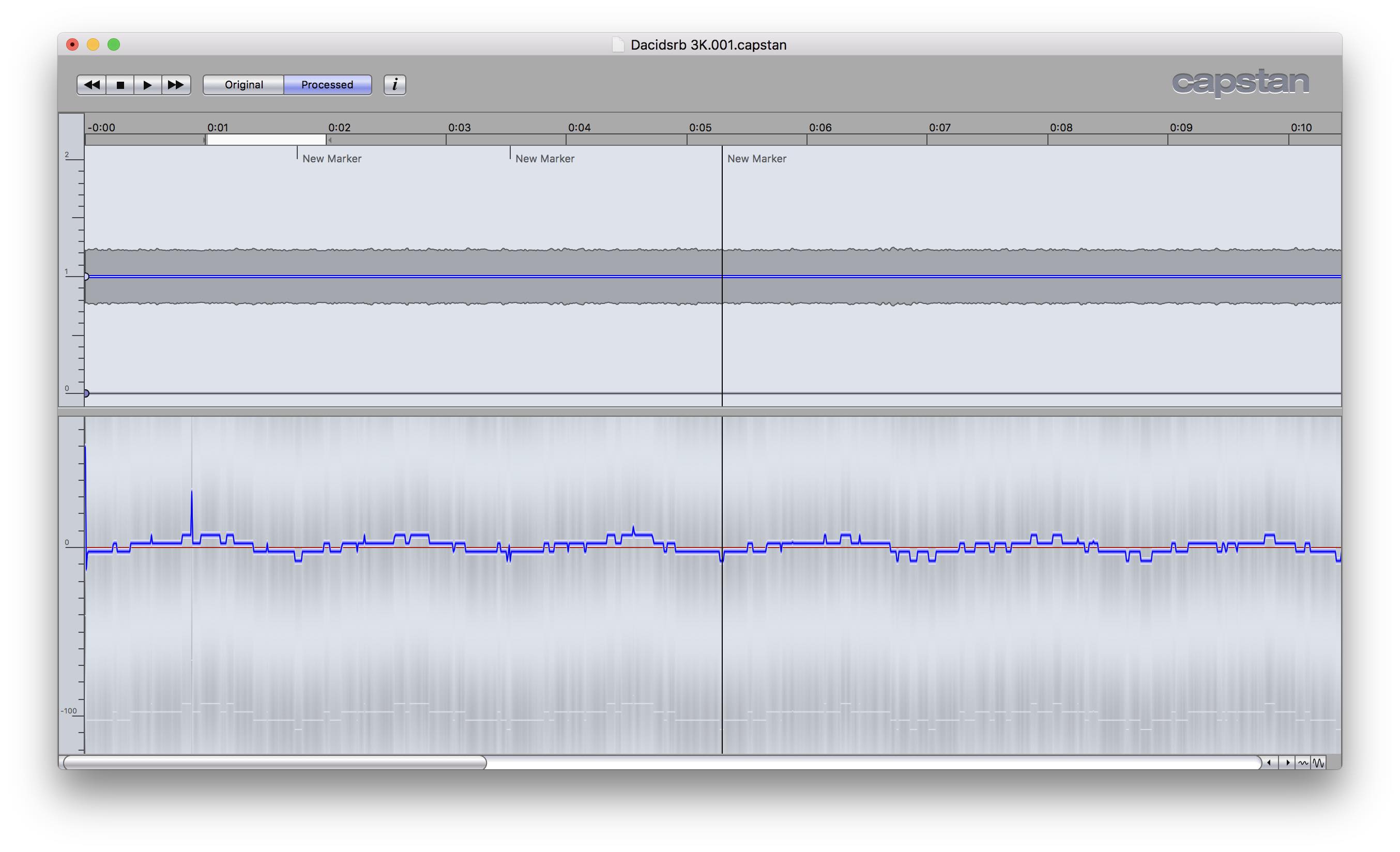

David I thought I'd look at your file and some others in Capstan software that is used to correct wow and flutter. Although pure tones are not what the software is meant to analyze, it did a decent job. Mostly is shows a pitch variation at close to 2Hz. There is finer, faster variation there, too. Just for fun.
Believe me Bill, I have only the demo version. It should remove the FM, yes. It's very simple but does an amazing job. It's really meant for music, not anything else. It can correct sliding pitch, so it should be able to fix the instability of an LP, no matter what the cause. It's not something we'd ever use, but it's fun to hear.

Unfortunately, the arm and cartridge oscillation triggered by the eccentricity and cogging causes much more complex errors than tape speed variationBelieve me Bill, I have only the demo version. It should remove the FM, yes. It's very simple but does an amazing job. It's really meant for music, not anything else. It can correct sliding pitch, so it should be able to fix the instability of an LP, no matter what the cause. It's not something we'd ever use, but it's fun to hear.
