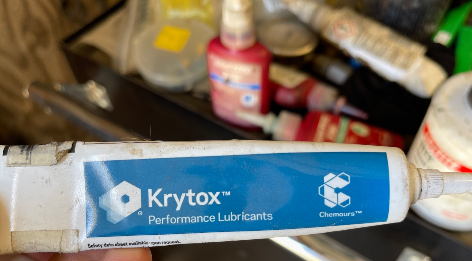

I was chatting my my local engineer buddy and he showed me this grease that was a $60 tube, I'll attach a pic, it's called "krytox." Apparently there are many different flavors, and many price points up to a grand, I assume for the same tube. That's cool!
And galling. That's something that happens to ball bearings over time. There was a specific steel designed to resist galling in a "low lube" environment like a turn table, its called Nitronic (wikipedia), and apparently you can get ball bearings made of the stuff too.
From Mcmaster
Chemours Krytox™ XHT-BDX—Boron Nitride Thickener is the spendy stuff they've got at $144 for 2oz and $1400 for a tube of it. Good times.
https://www.mcmaster.com/krytox/
