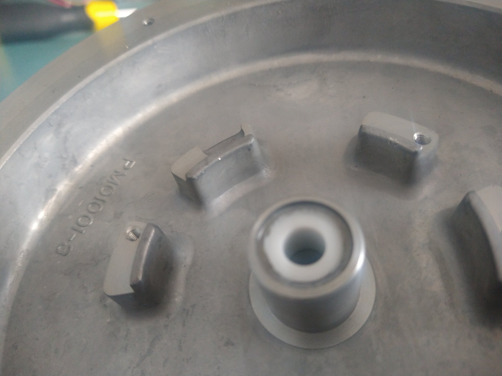

I've recently machined an inverted bearing motor modification for an SP10mk2. The platter is 13kg sitting on a 5mm SI3N4 ball running on a Vesconite Hilube thrust pad. I ran this in the lathe at 300rpm with well over 13kg of pressure and there is only a very small divot in the thrust pad. This was done to check longevity. I also machined the journal sleeves from Vesconite Hilube and placing the platter upside down with a mass on the motor so it spins for a while and there is ZERO audible bearing noise in the platter using a stethoscope.

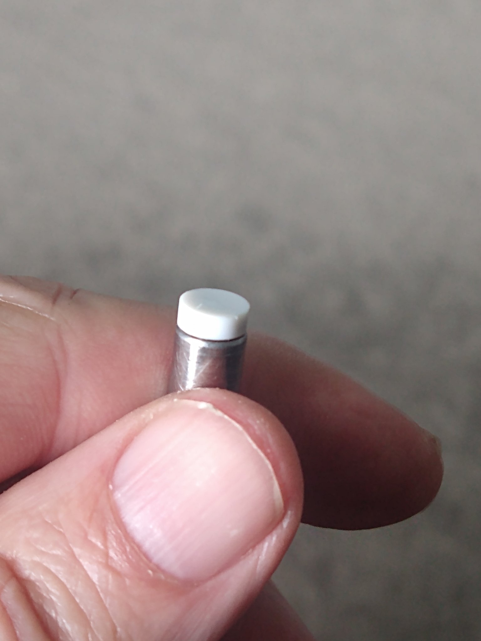

1st pic is a Vesconite Hilube thrust pad I made for a stock SP10mk2 motor, 2nd is a Vesconite top sleeve in an SP10mk2 motor housing.

First is an empty SP10mk2 motor (no stator and rotor) fitted with Vesconite sleeves. Second is a stock SP10 bearing where the metal to metal contact is clearly audible, (this motor bearing has been cleaned and new oil added. I have attached a contact microphone on the bearing housing and the record level is at maximum. For comparison is a Linn Cirkus bearing I found on the web (not my recording)
