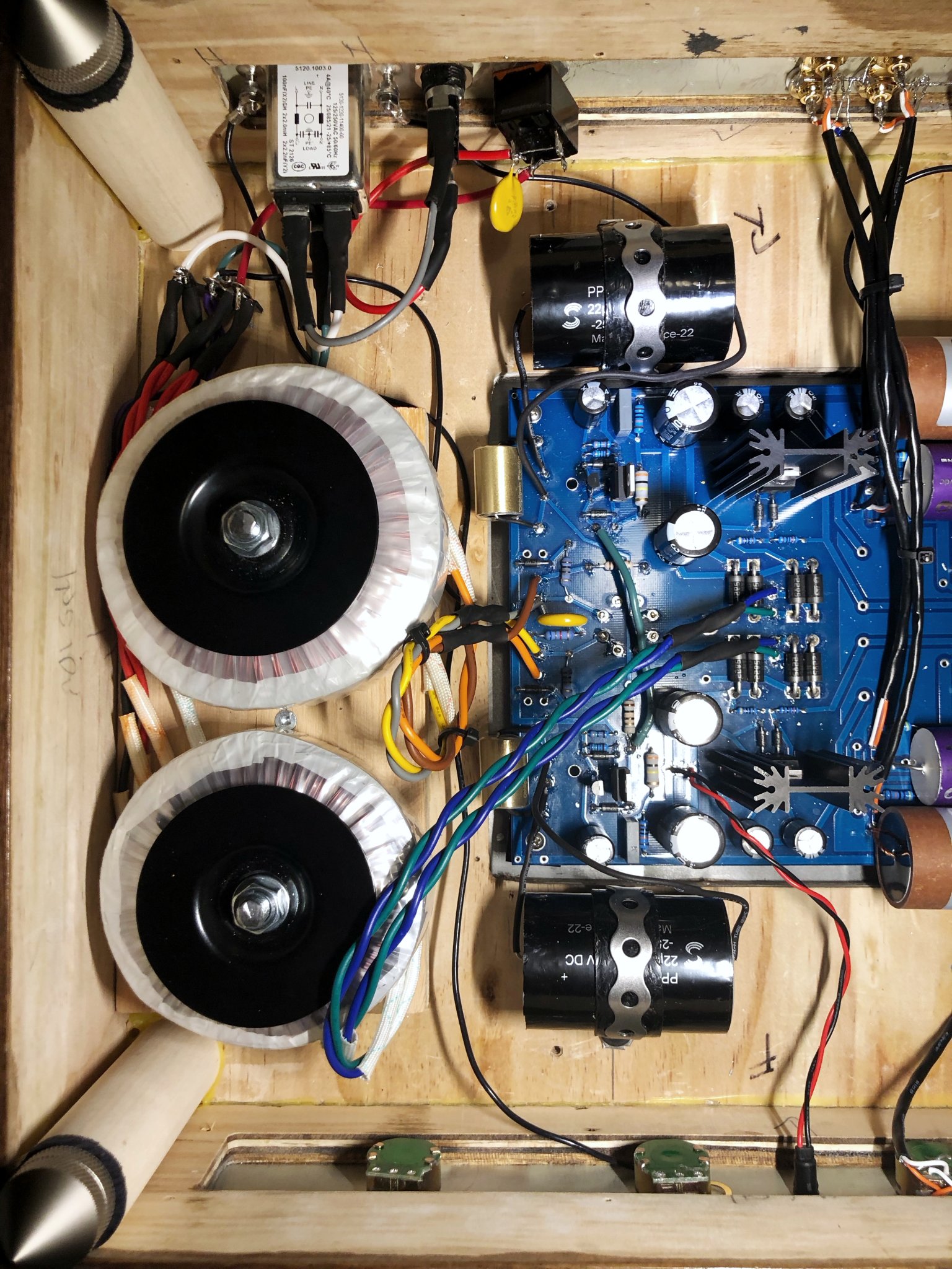

you can retwist and also lift the signal from the board, on my phono the 60hertz tube heater wires are lifter away from any board circuits.
120 hum is the rectifiers and some 240hz, make sure the wires input or output wires don't align with rectifiers (diodes)...
You could make a center ground from the inputs also, the best place to make a common 'star Groud' is at the capacitor bank.
Star ground works on the condition that all wires are same length so the signals cancel (each wire acts like an antenna and picks up a signal, but the signals but all the voltages are similar and cancel at the common point giving no room for potential buildup.

Hard to say what it is. I would tighten it down. Toroids are sensitive to DC on your mains line so a DC blocker can help, but that may not be the actual issue at all. You have hum, and we need to know how much there is on the offending channel’s RCA output while shorting the respective input. Do you have an RMS voltmeter with a millivolt setting? If it won’t read mV, try volts instead (AC not DC).One of the transformers is buzzing. I heard it before, but didn’t think anything if it.

The black wire going to the pot, is the ground connector for the front panel, didn’t think it would matter if the ground went near the transformers?
Not sure what to do about the large caps by the transformers? Guess I could move them further away from the transformers and run longer twisted leads?
you could try, if the ground wire is not close to the metallic (steel) casing it could be acting like an antenna to catch a potential from the transformer.
Moved caps, twisted wires.
Moved ground wire away from transformer.
Switched the leads on 47uf caps +/- just to check foil wrap.
No difference.
Still hums.

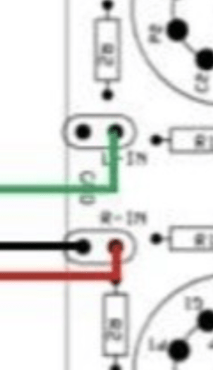

Then just short the inputs directly on the board. You won’t have to deal with the array of inputs you have on your back panel then.
You can remove these wires temporarily, tie them off and then just connect L+ in to ground and R+ in to ground. Now the PCB‘s analog inputs are completely isolated. You can even use clip leads if you don’t want to solder or just pinch a bare piece of copper and connect. Something easy!

Left Channel
.5mv DC/1.6mv AC
Right Channel
1.1mv DC/1.5mv AC
Input shorted at the board.
Going to hook it up to the amp and see how the noise is with the inputs shorted, and no inputs connected at all.
I trust that is safe to do?
.5mv DC/1.6mv AC
Right Channel
1.1mv DC/1.5mv AC
