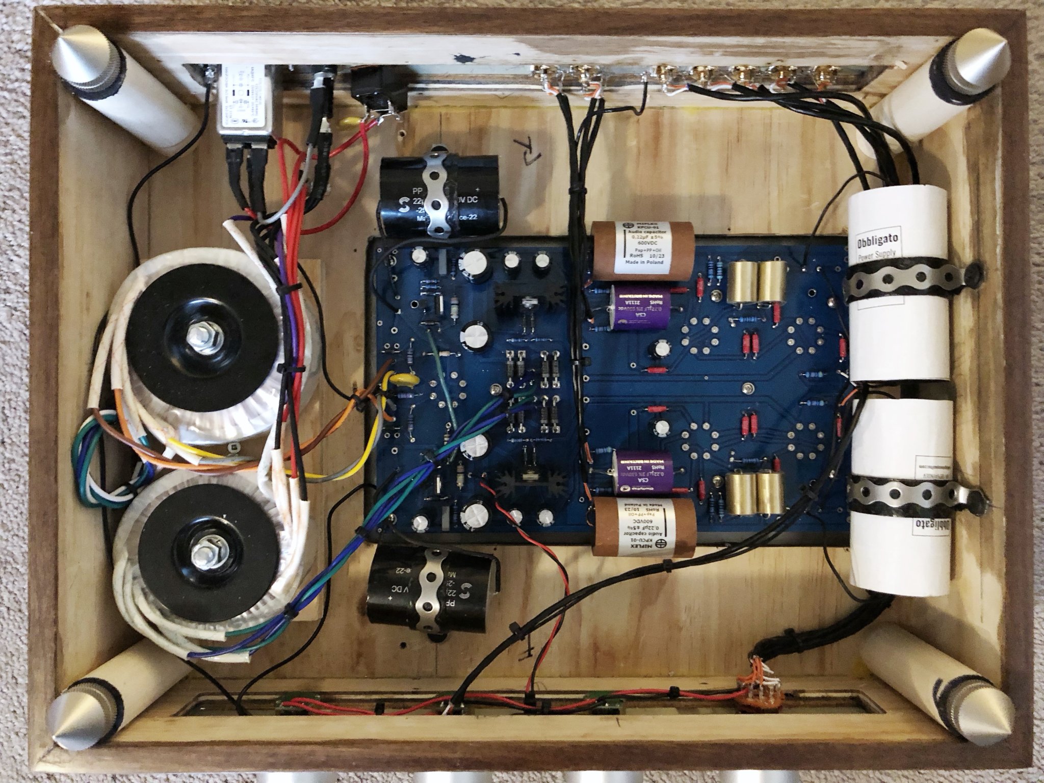

I built this preamp last Summer and have had a hum on one channel that I have never been able to get rid of. I have lived with it by turning the gain to 50% on my amp and that got rid of the hum. However, with the information in this string I am going to make another attempt at solving for this.
Thought had crossed my mind. Right channel is on the far side of the amp, so yes, longest wires. But shielded as they are supposed to be.
I wonder if the metal straps I’m using to hold the large filter caps in place could be the culprit’s?

First of all, really sorry that you are going through all of this. Quite frustrating I am sure as the Aikido design on its own is a good design (I'm planning on building mine from some Glassware boards) . From your spectrograph, it appears both 60Hz and 120Hz are significant. Have you checked the power supply with a scope? What is the amount of AC hum (in mv RMS) with your AC voltmeter on the output with the inputs shorted? Do you have an audio analyzer? Are all the PS capacitors functional (i.e. new, well soldered and not with poor ESR)?
Ideally you want at most 1mV RMS AC on the output of an amplifier, and about 10 times less than that for a preamp if possible. Or else, the chances that you will hear hum on sensitive speakers (like Klipsch) become high.

Definitely twist the AC leads like Grover has advised, both primary and secondary; the toroid and the leads seem to be far away from the input wires which will help; also the purple shield should be connected to chassis ground.
You may need to rotate your AC power transformers so that the primary wires are as far away as possible from the input wires. Please braid the wires, tightly couple with zip ties and/or use heatshrink as well. Your 120V wiring is most important, then your secondaries.
I know you have done a bunch cap mods to this pcb, but I do wonder about building it just stock, getting the hum addressed and then upgrading one by one. Larger boutique capacitors can attract 60Hz hum. One needs to be careful about that.

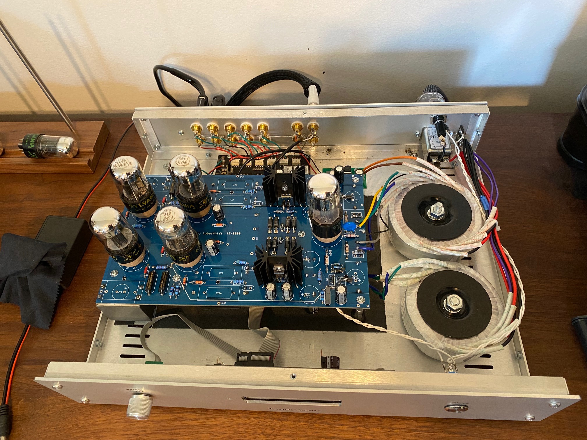

They do. They are grounded to the IEC plug.Yes, I would definitely twist all the AC leads, primary and secondary. Do both the power trannies have purple shield leads? I can't tell. If so, where are they grounded?
Secondaries are twisted, just no the primaries.

When the hum first appeared, I had built it with all the original caps. So the hum, in theory, shouldn’t be the caps. Though I am going to swap them L/R one at a time to see if the hum switches side, now that it’s only on the right channel. Was on both originally. Other thing that has shown up in research is directionality of film caps, and which side is outer foil and how this may effect hum.
Have to look at wire length coming out of transformers, may require some mcgyvering to be able to flip them over. But I will be doing that next. Unfortunately, the chassis build does not allow for moving the transformer in any way, other than flipping them over.

Lastly, here is my build. This is the SP20 which has the exposed tubes.

I would twist them a lot tighter than that. And twist the HV and filament secondaries separately.
Thanks. I’ve pulled the transformers, and I’m redoing the wires and twisting them tighter, using heat shrink on the ends as well.
