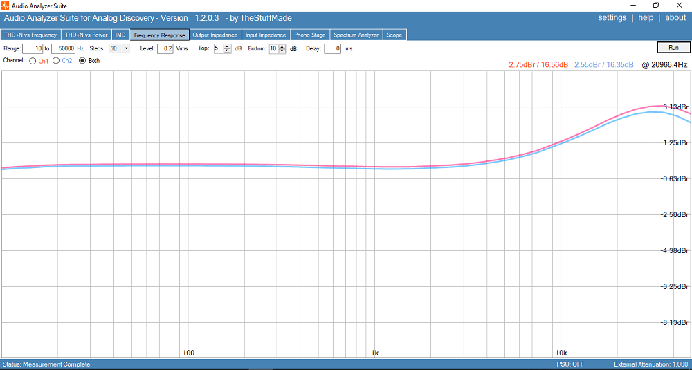

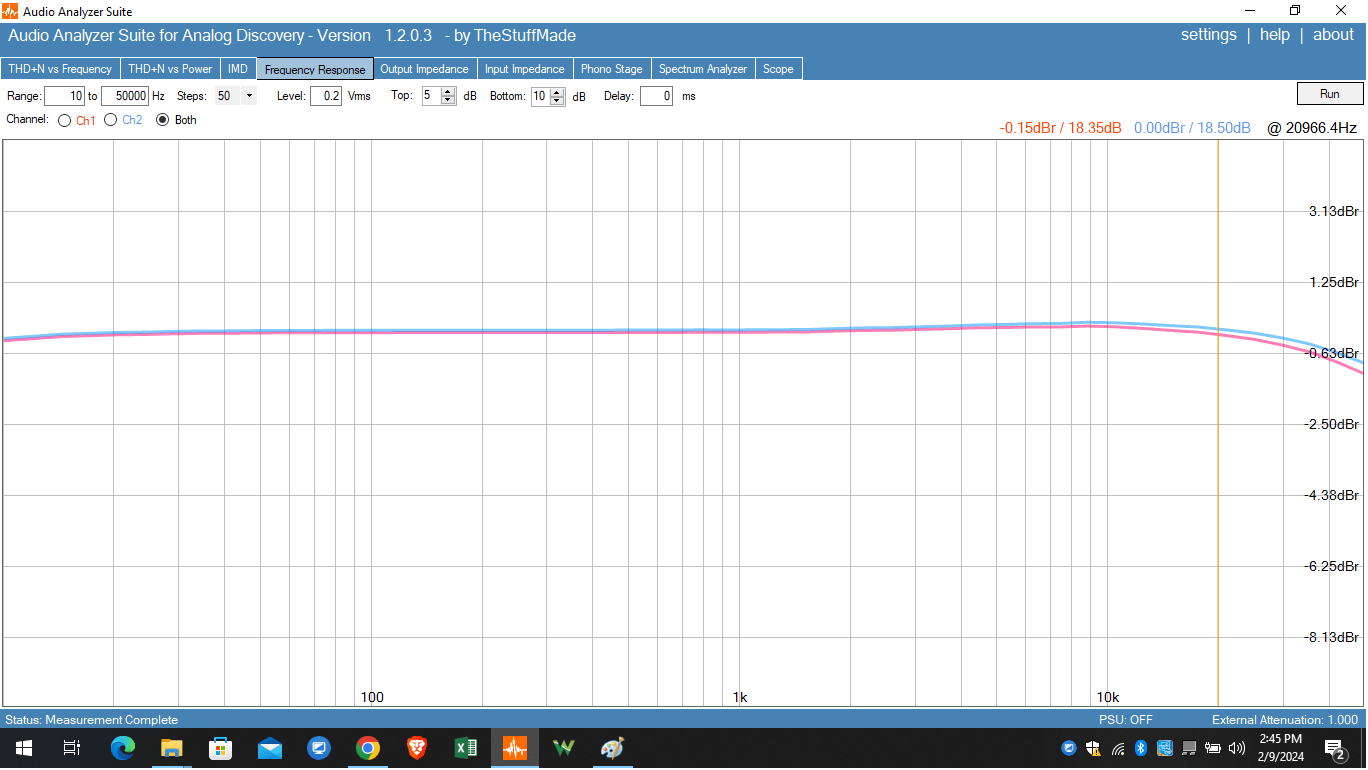

C3: 1uF, each 1uF will lose 3dB (Doesn't matter what value you have with C3, the frequency response is the same. I have tested up to 10uF_
For example: 1uF at 20Khz = 18.35dB where 2uF will be around 15.xxdB

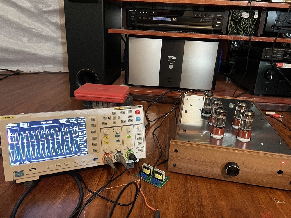

Interesting observation.
The front and rear panels are aluminium, top panel is steel.
Wonder if I should try to place some kind of copper/aluminium shield around the transformers.
The hum is quite loud with the Hiraga connected as everything warms up, but it subsides as both units warm up after about 10 min.

Do not use steel for top, That's where the hum comes from. I did shield around and had to place PT 6 inches away. But with top aluminum, you can place PT anywhere.
I only have top is aluminum, the rest are wood.
Mine can turn the volume max while turn on without hum/noise.

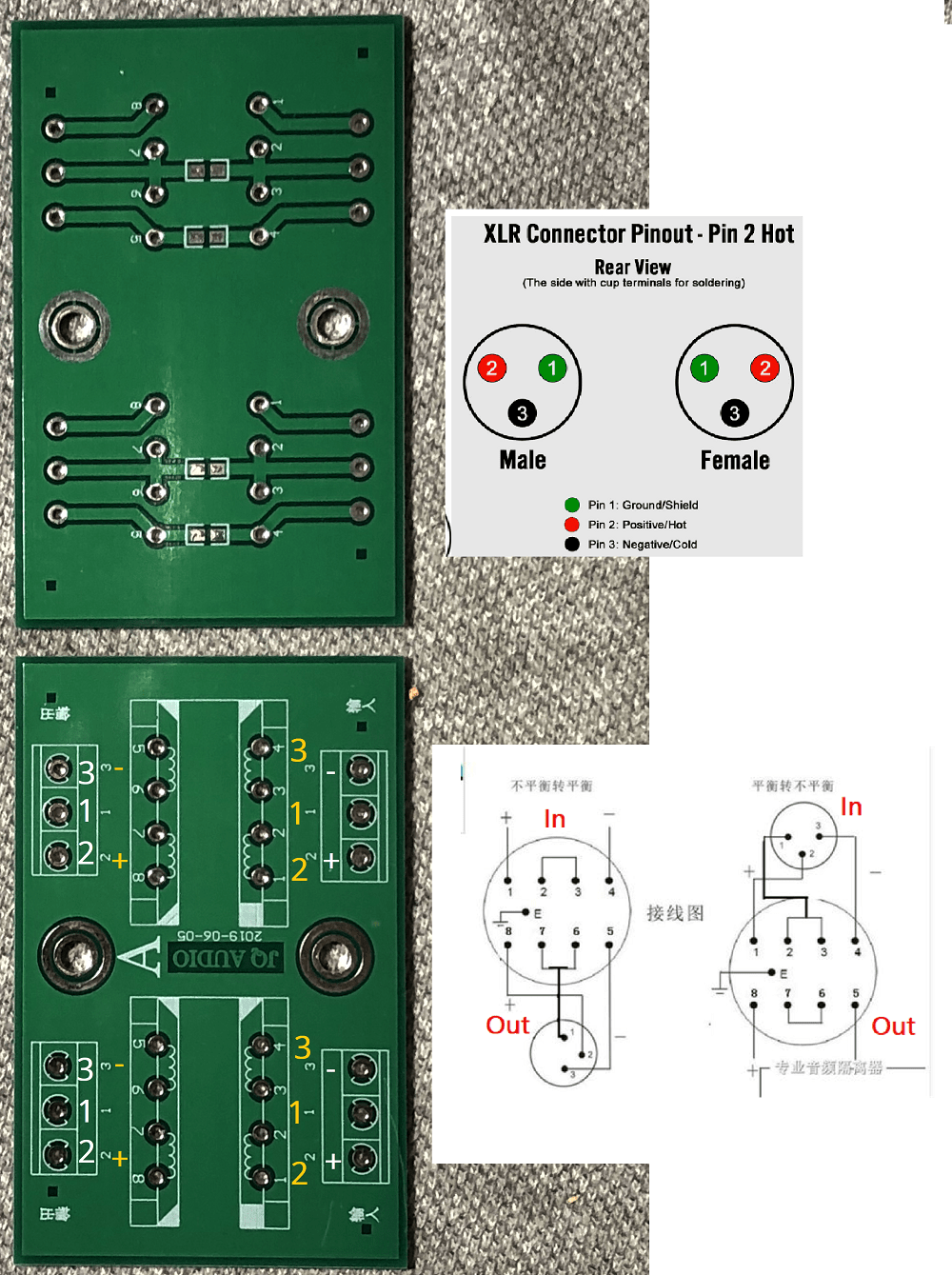

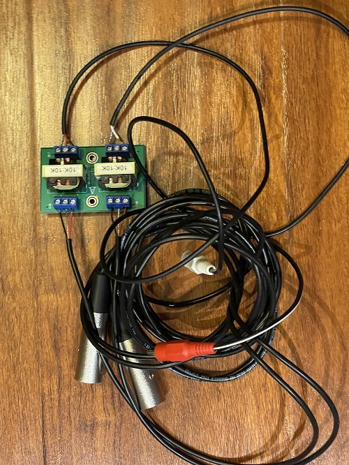

Here is 10K:10K audio transformer if you are using with SS amp. If not, you will hear hum. I believed I talked to someone, he said using 10K:10K but 600r:600r may be fine too.

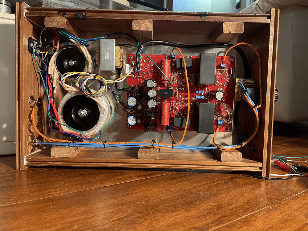

I put some isolation (electrical tape) between all the contact points for the spacers between the top metal plate and circuit board. Left channel is free of hum, all that remains is the slight hiss I hear with other gear.
Right channel dropped the higher frequency hum, and is now only 60hz. I didn’t use shielded wire between the selector/gain/volume. Going to replace that with shielded wire and ground that shield to the ground bus on the RCA’s. Seeing as how the hum is in the right channel, and the right gain is next to the transformers, I’m hoping that removes the 60hz issue.

I recently built a totally scratch, p-to-p Aikido with a Neurochrome regulator board and a regulated filaments. It's dead quiet in my system. I sent it to a friend who has a pair of amps that I built for him, the same as mine(!) assuming there would be no issue. It hummed like the dickens. Some sort of ground loop. He's not at all technical and I could not diagnose the problem over Facetime, so he sent it back. I'm using it was great pleasure now. Which is all to say that preamps are tricky... :-( Hoe you get it working to your satisfaction!

The preamp has been running well, except for the hum. I rewired the pots with shielded wire, but when I did it, I neglected to snip the left incoming signal wire, so there was no sound from left channel.
I let the amp drain with the music playing, took it out of circuit and removed the tubes. They were certainly warm, as they gab been on for a couple of minutes, but certainly not so hot I couldn’t hold them.
Fixed the wire I had missed, put the tubes back in and hooked it back up. Powered it up, left channel was fine.
Took a moment to call a friend I had promised to check in with, and after a minute or so, happened to look at the amp, and the rectifier was making quite a show. Shut the amp off immediately. There was no noise or other odd sounds coming from the speakers because of this, it gradually faded as normal.
I’ve gone through the amp, and there is no indication of any short, transformers are not shorted, as best I can tell from measuring resistance.
Is this just a coincidence? I’ve read that 6X5GT tubes are prone to shorting. Did I jar something then I pulled the warm tube?
