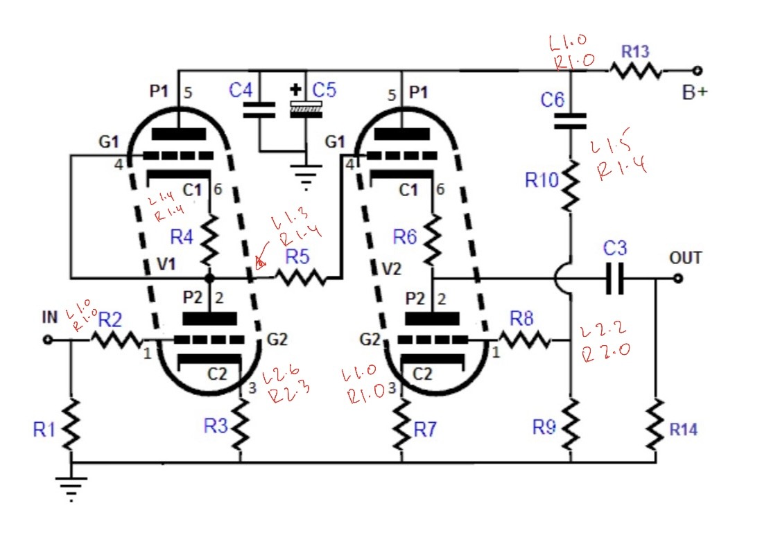

So both of these results above you have listed are from the amp output and you have given me AC values with the right channel much louder than the left channel. Max from the amplifier should really be at 1mV RMS AC or lower, especially with sensitive speakers. Your DC values look fine, not unsafe for your speakers although if there is a way to adjust your DC offset on your solid state amp, that can be done to dial down the DC offset closer to zero volts.

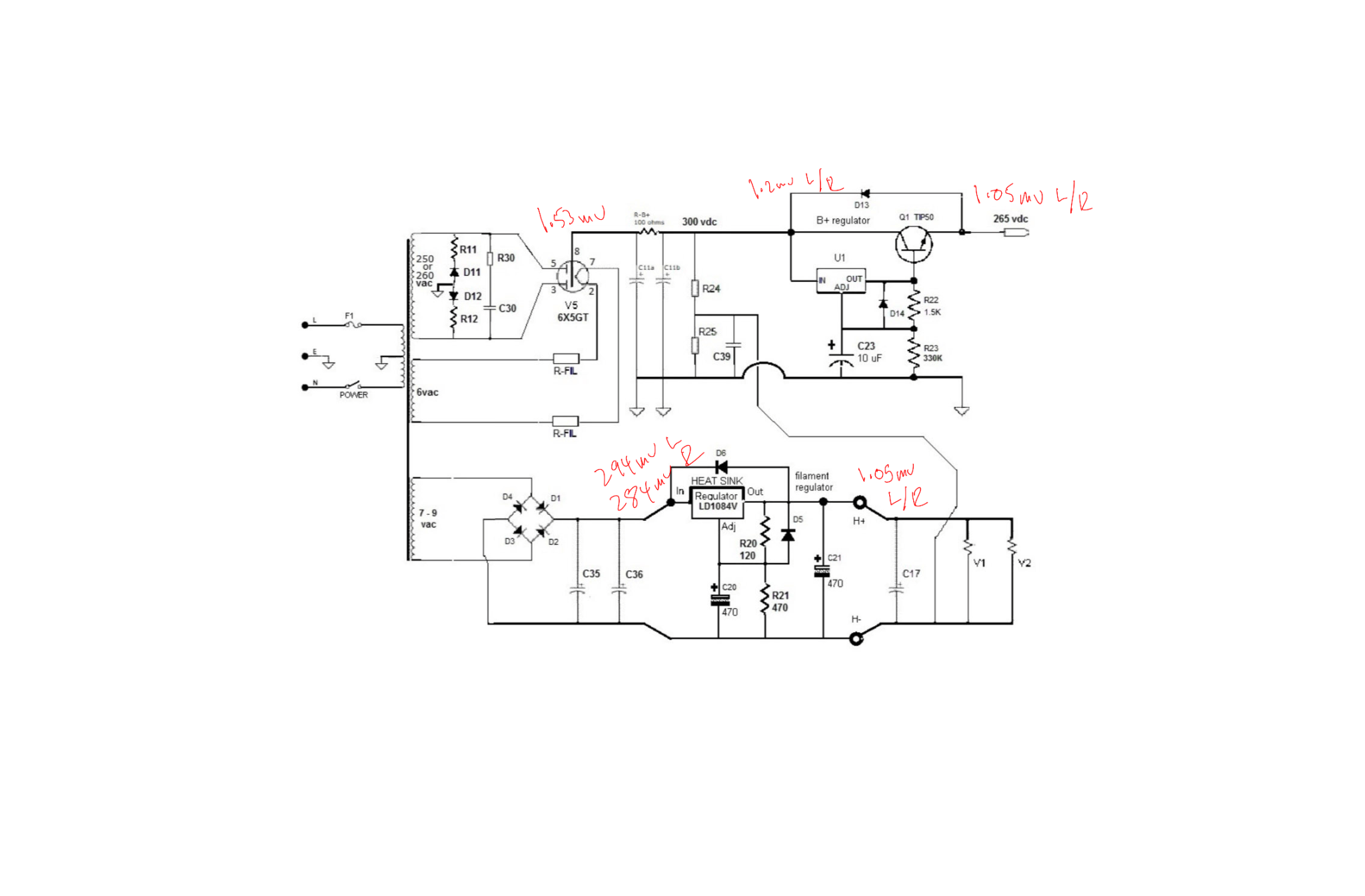

I want you to check what your AC RMS reading is on the output of your regulated B+ supply. We need to check if your regulator is operational or not or if there is AC hum arising from there. Look through the schematic and start tracing backwards while eliminating ancillaries in your circuit. For me, selector switches and volume controls are ancillaries but they are not a main part of the circuit, only the filament supply, B+ supply and amplification parts of the circuit are. So a systematic sleuthing will be required (which is why I requested shorting the inputs). I would start with the 1st capacitor right after rectification has occurred or basically C11a on your schematic you published on page 1 and then move forward. After the first CRC supply, AC rms values should decrease but may not be eliminated. Then the HV regulator comes. Is everything working there? Hard to say. Check AC RMS at the cathode of D13, then anode of D13, there should be a marked difference. If things look odd, we may need to resolder, recheck parts to make sure the proper ones were used, etc…a cold joint can make a major difference so get a loupe and start looking! A scope would be very useful here but we’ll try it with the Fluke 87!
I would do a similar study of your heater supply. Set your Fluke to DC and have your red lead connected to the junction of R25 and R25 and your black lead to ground. What is the value? This part of the circuit is part of AC hum reduction and to protect your main signal tubes. Also check what the actual heater voltage is themselves. You can just place both leads across each of the respective heaters on the tubes themselves or across H+/H-. Finally, switch your Fluke to AC and check what the AC value is for your 6X5GT heater since that is only supplied by your toroid directly (pins 2 and 7 on the 6X5 per your schematic).

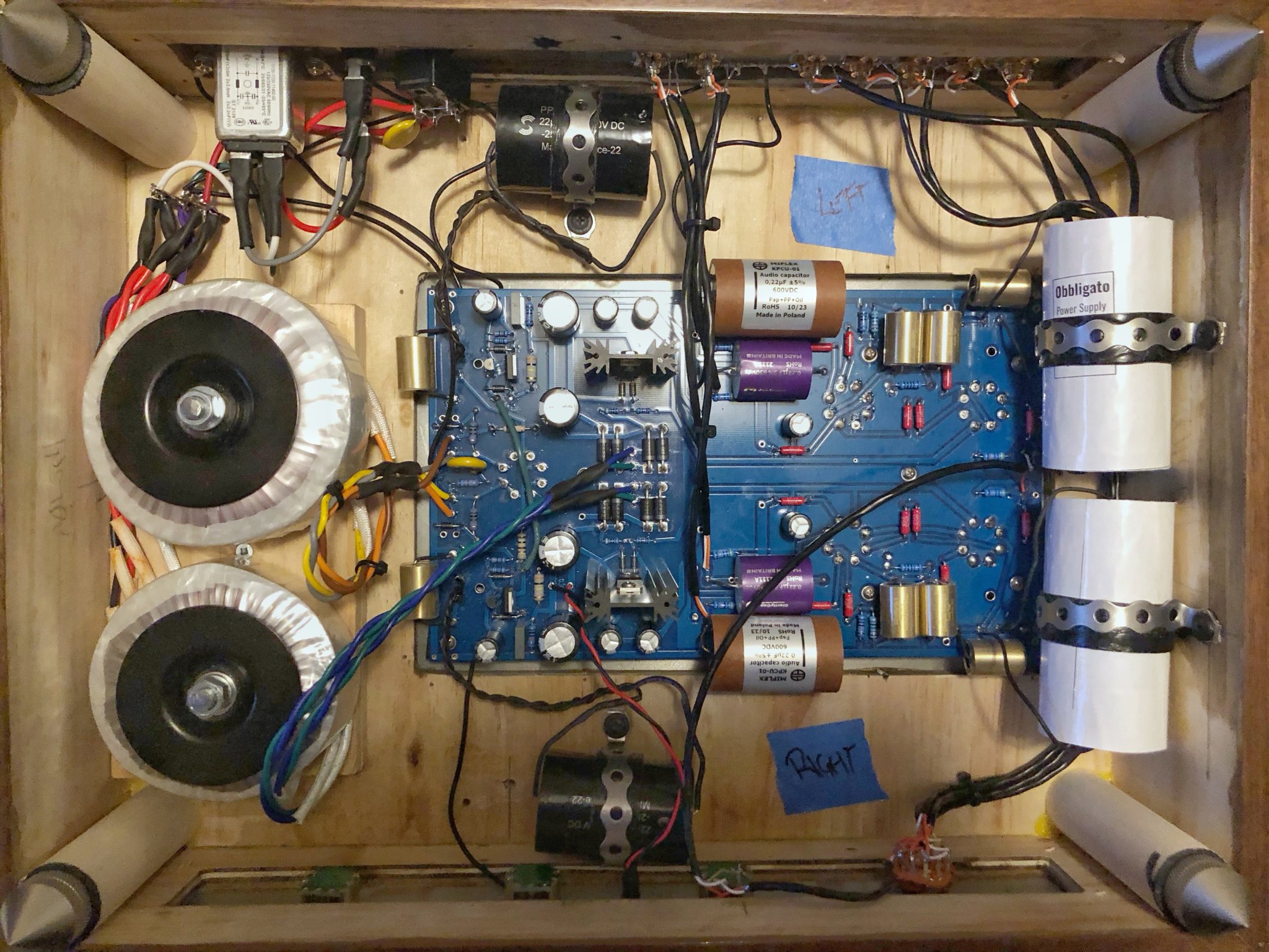

Please list your current values of C11a, C11b, C17, C35, C36, and C39. They can all affect AC hum. What are those wires coming from the mounting of your IEC terminal? Where do they go? And why? I’m looking to see a clear view of your chassis ground, and I don’t see one with all the wood. I do see that your main pcb is mounted to a piece of metal, hopefully aluminum? Electrically, your back panel and whatever the metal you have used to mount the main pcb need to be connected. This becomes very important once you introduce non metallic materials like wood into your circuit. The front panel will need to have this connection too, particularly the main VC hub/bushing…too bad there are so many VC’s on this design, perhaps for adding a ‘balance’ control.
I’ll be honest, I’ve looked at this pcb a few times, from a layout perspective and I’m not entirely enthused as grover has mentioned there are parts where a ground loop may occur. As such, one of the things I will mention if all else fails is to try a ground lift circuit. You can design one of these or just purchase it from Broskie. You would install it between the final ground from the main circuit (going to a star ground) and the chassis ground. From the chassis ground you really should have only one wire going to your IEC ground terminal. That’s it. On the 1st page, you have a drawing showing a purple wire going from the ground of the main pcb directly to the IEC ground terminal and that to me is what I would not do. I would connect it to where the purple wires from the Antek toroids attach but immediately before, place a ground lift. That way you are ‘lifting’ the main part of the circuit from the chassis ground.

One more thought…please make sure that your outputs are well isolated. There shouldn’t be any continuity (check in ohms), between your RCA hot and ground/tab. The RCA grounds can have continuity with each other. We need to ensure that your RCA’s are well isolated from the metal back panel. I think visual inspection looks good judging from the 1st page but ensure it also makes sense electrically.

look at the wire from selector out to input, this wire should be wired in parallel with the wires going to the selector it is going very close to your capacitor and other stuff. It is close also to the power on light wire

I’m going to twist the wires for the LED tighter.
The cap was in a different location before. Hum was there. I moved it away from the transformers hoping the noise would be reduced.
I reflowed R8Mine is unrelated power supply running B+ at 285-295vDC without hum. The hum I got was damaged R8 even thought it's still works. Replaced R8 then no more hum
Measured R8 on left and right, and they are both the same.
