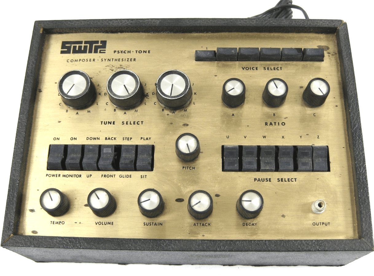

Back in 1975, a time before MIDI and the WWW existed, I built a SWTPC (of Tiger Amps fame) MC6800 computer and matching terminal kit, and had written enough assembly language code to get this large beast to beep out a simple tune through an 8 bit parallel port that I made into an R-2R DAC. This kind of stuff was the origin of what is now called "chiptune" music. The beast grew to take up most of a large workbench with expansion cards and outboard boxes, most of which I had designed as the technology became available.
By 1977 had condensed the music making essentials of the system into a single PC board powered with the new 2 MHz MC6809 chip. It was essentially a simple sequencer, crude analog drum box, and monophonic synthesizer on one board. There was a 16 key keypad for note entry and a 1/4 inch jack for playback through a guitar amp.

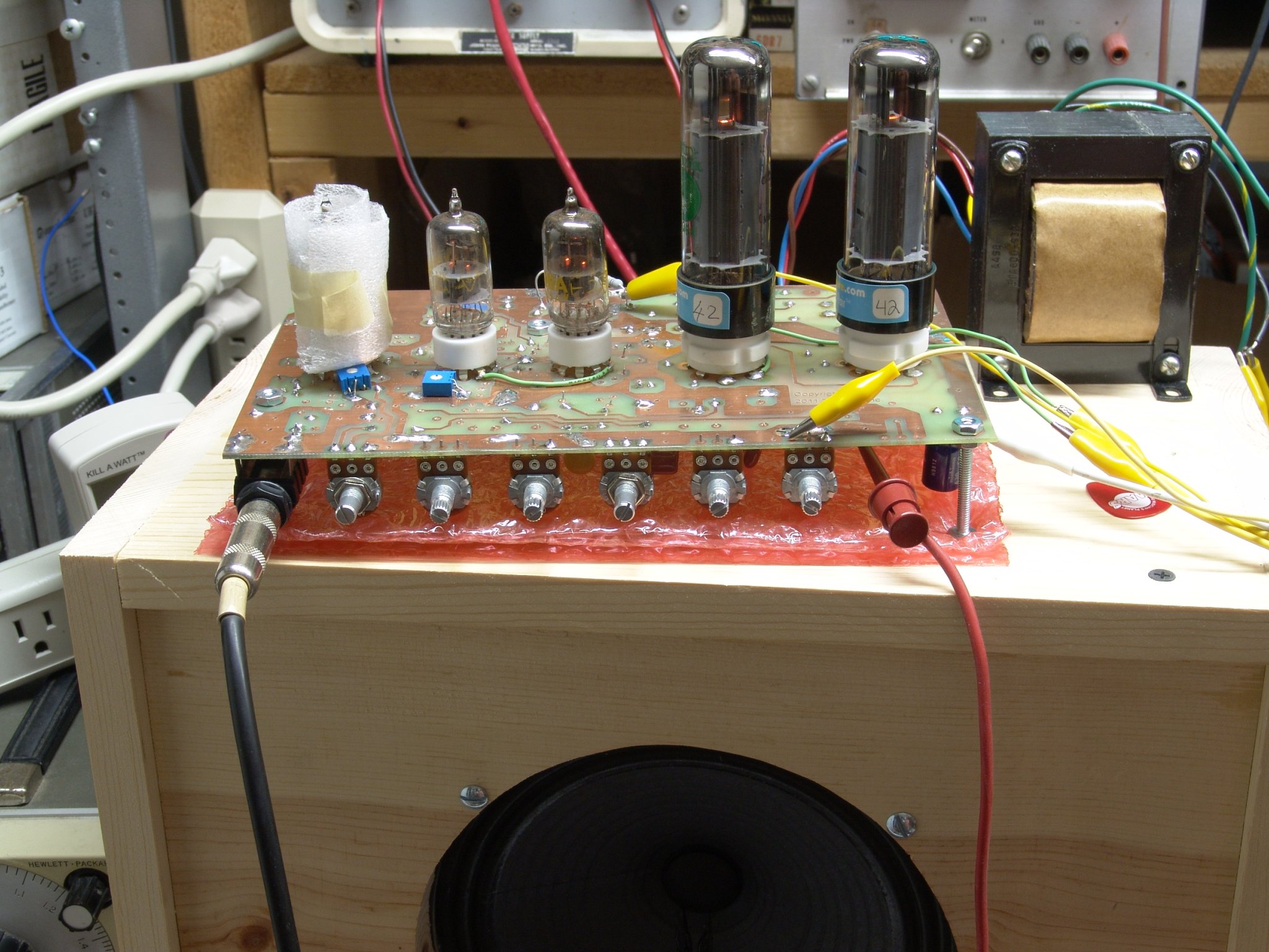

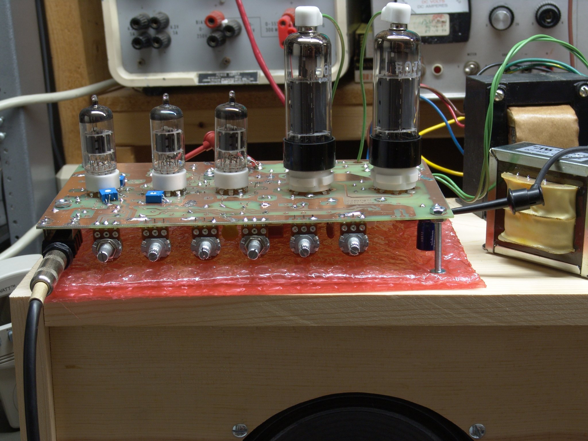

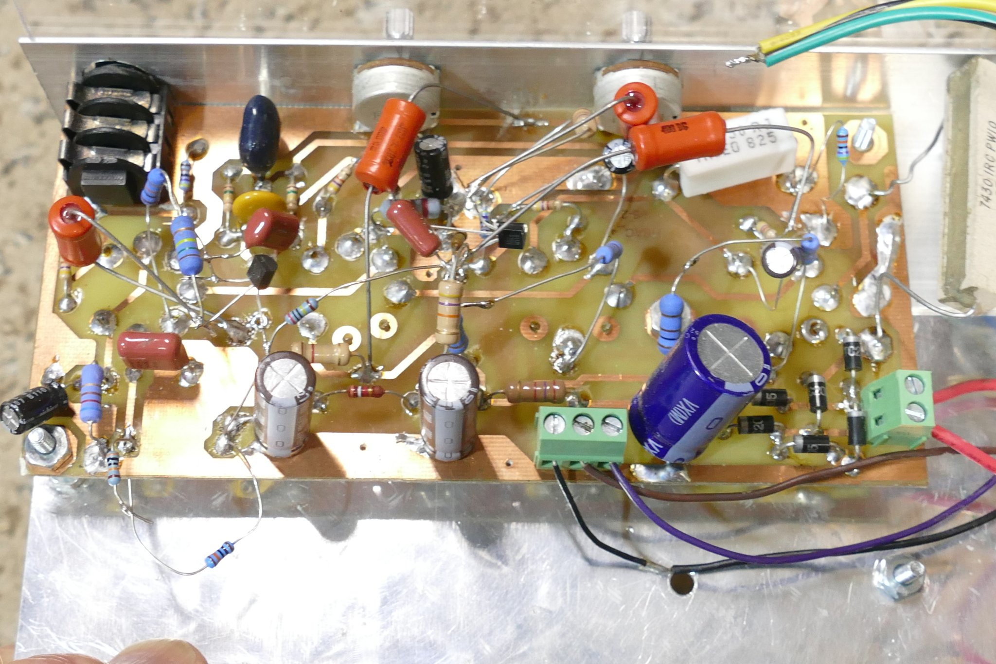

The amp head was built a long time ago for the HBAC challenge and has some issues. I coated the cabinet in the same "Tolex in a paint can" finish that I used on the speaker and will likely reuse it though possibly with a different front panel depending on what "guts" I wind up using.

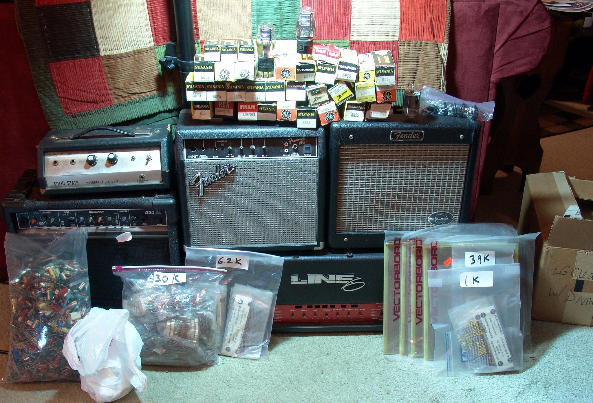

The first picture in post #1 of this thread shows what is left of three guitar amp designs I did for the Hundred Buck Amp Challenge, and a new one that was derived from one of those designs. The amp on the bottom contains the board seen in Tone Test, Post #36 which got stuffed into a cabinet in post #39. Note flying parts all over it. It tries to work but it is even more intermittent than my old MP-1.
On top of the large amp cabinet are two amps. the unhoused board / chassis on the left is the 4 tube ultra low $$ design that started as a 5 tube design on perf board, lost a tube and gained a PC board to become a working amp with "no semiconductors in the signal path" to fit the challenge rules. It worked OK, but didn't go to 11, in fact it seemed to stop at 9. After the challenge was over, I ripped it apart and stuck lots of flying parts all over it to create something that I still use today. The flying mess got committed to a PC board and it is seen in the black cabinet on the right in post #1.
On top of that cabinet is the nearly identical twin brother to the board in the larger cabinet on the bottom. It had a nearly identical schematic to the 5 tube amp but runs octal output tubes. In this case 50JY6's which have 150 mA series string heaters as opposed to the smaller brother's 9 pin UL84's. It never worked right, so it wound up neglected in the box of dead circuits. While digging through my collection of pictures, I found a picture of it sitting on top of the wood speaker box. The next picture reveals something that I forgot about. There are flying wires on the board that do seem to involve the heater wiring. Apparently, I ran some EL34's in this thing. Maybe, there is still something left to learn from this board, so it is now out of the dead projects box and I'm looking for the Eagle board and schematic files. There are no tubes in it, so I need to figure out what preamp tubes were in it when I took the EL34 picture.

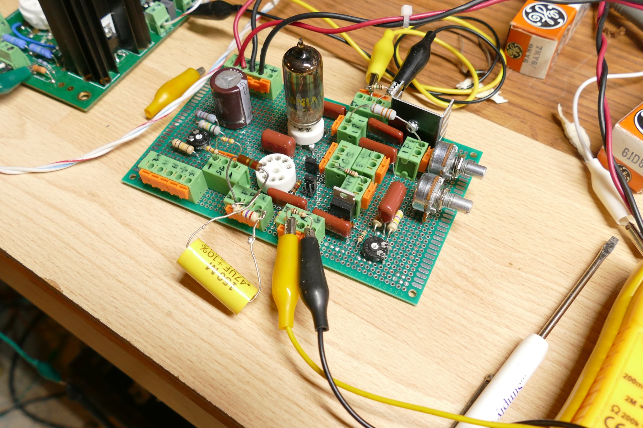

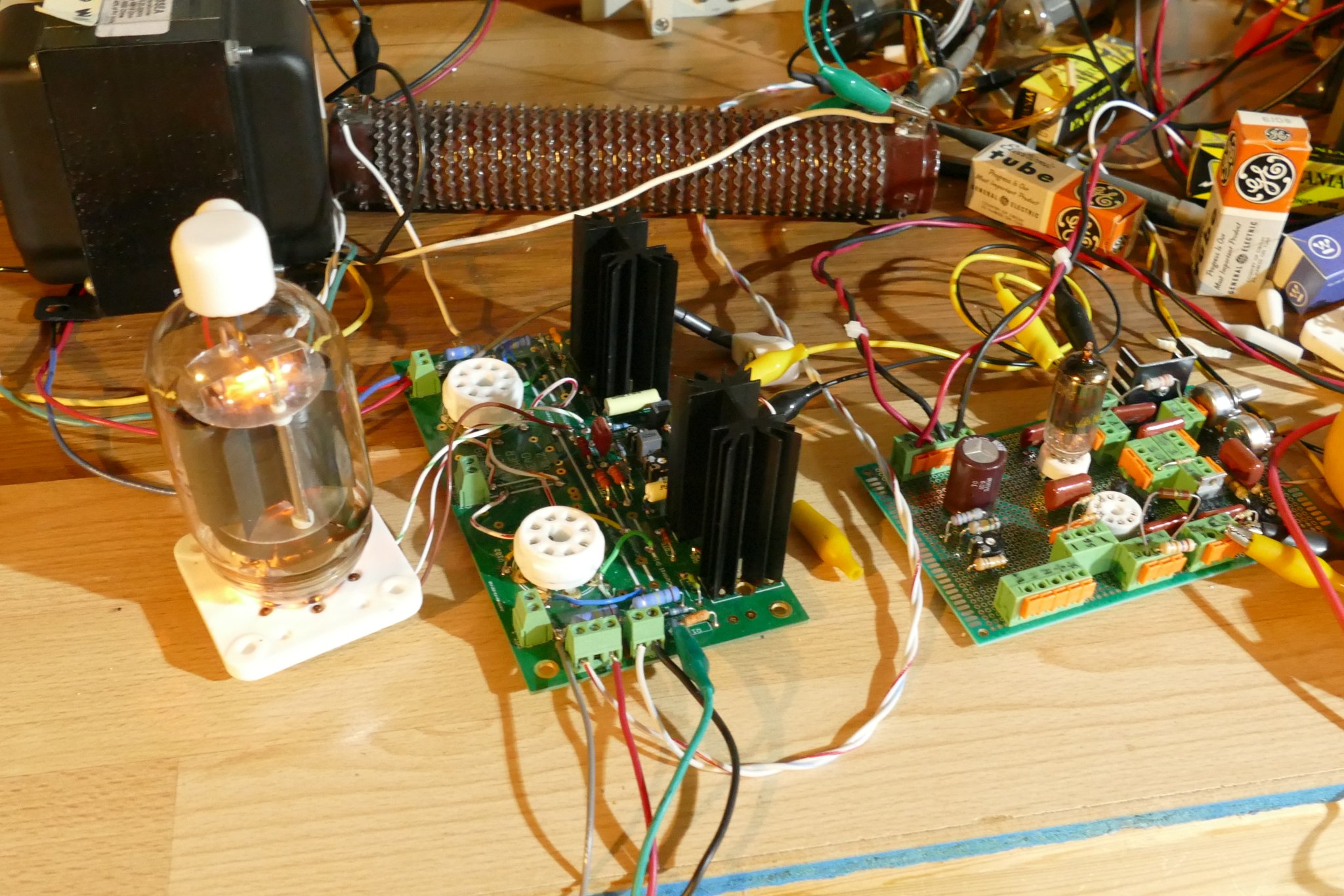

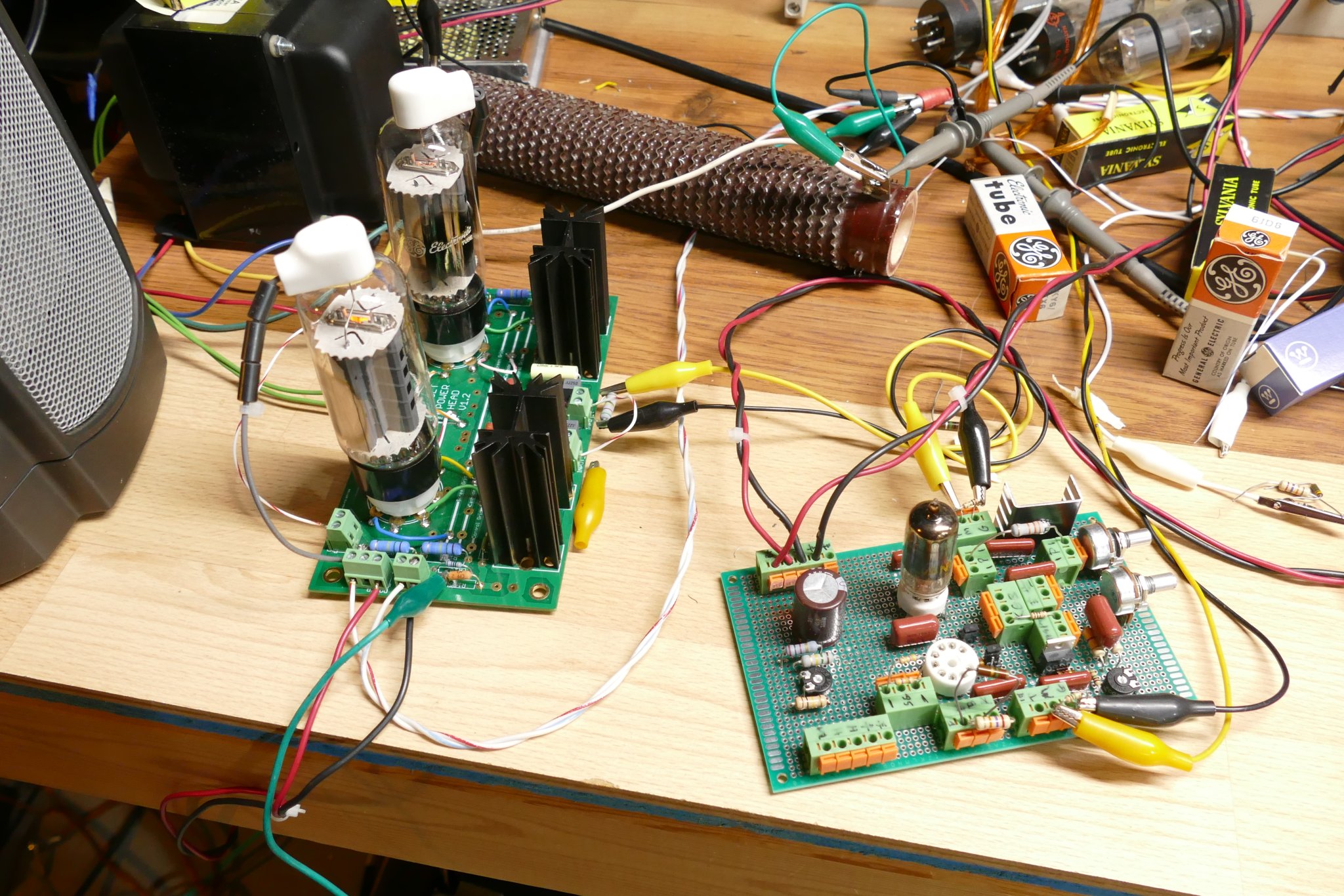

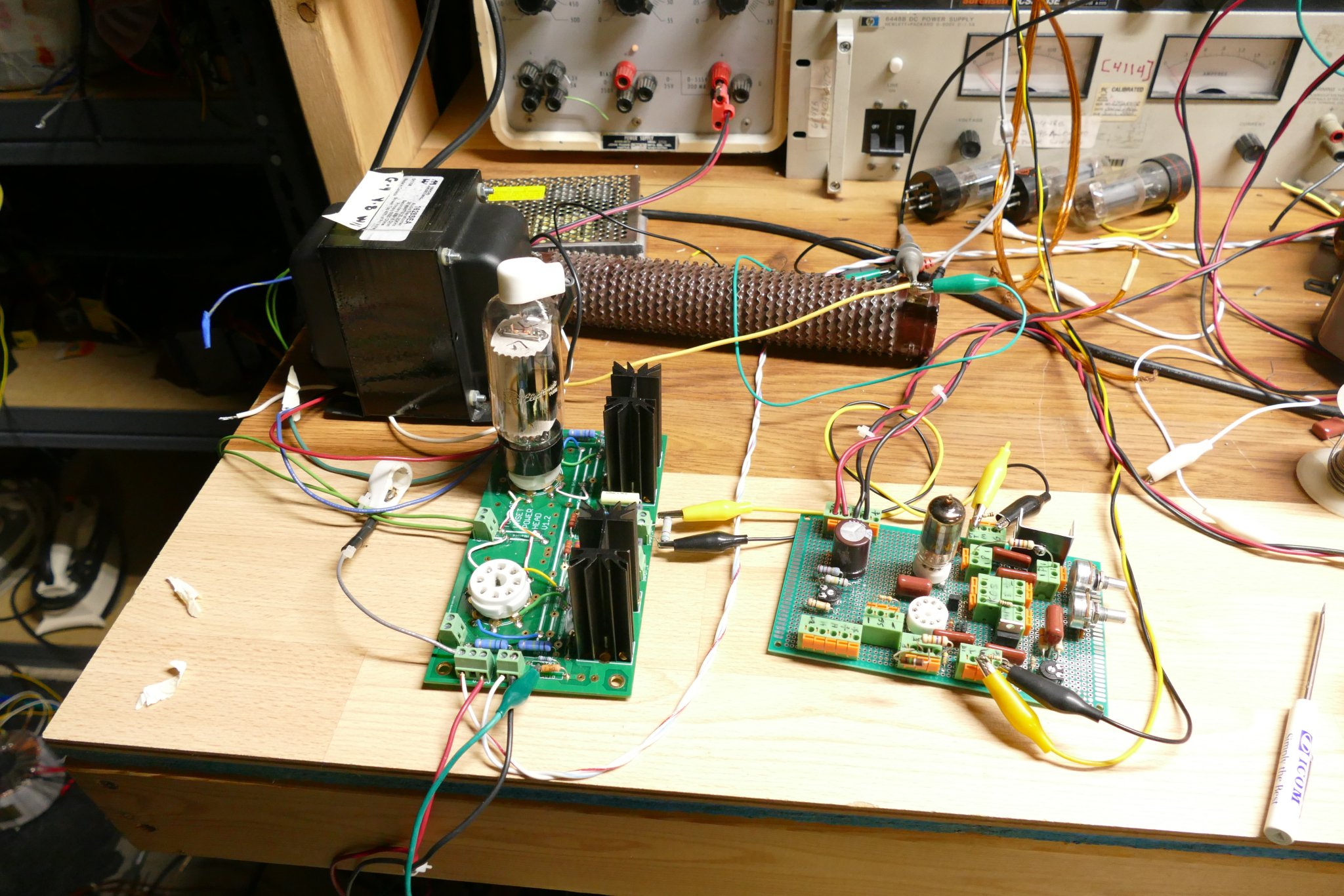

So what do you do when you have a shiny new driver stage and a really good output stage? You wire the two together. And if one output tube works good, two should be better, right? At this point I'm still thinking HiFi amp, so this is one channel of a SET that makes 35 watts at 1.22% THD. I got the brilliant idea to stuff in an even BIGGER tube, the 4D32. It made over 30 watts at 5% THD, but I couldn't find a happy operating point where it made under 1% THD at any power level. A few days of good outdoor weather left the bench dark.
Google decided to toss about three videos at me of guitar people showing off a new Fender Squier Strat made specifically for Amazon that sold for $120. All of the reviews were outstanding, too good to be true, but it looked nice, and my daughter had sold my only sunburst Strat 20 years ago, so I took the bait. It is the new not so shiny object on the right. The red one is dead again. It needs an electronics transplant as all the pots and switches are shot. The blue one is a no name Chinacaster that works pretty well, but the Amazon Strat is the best of the three!

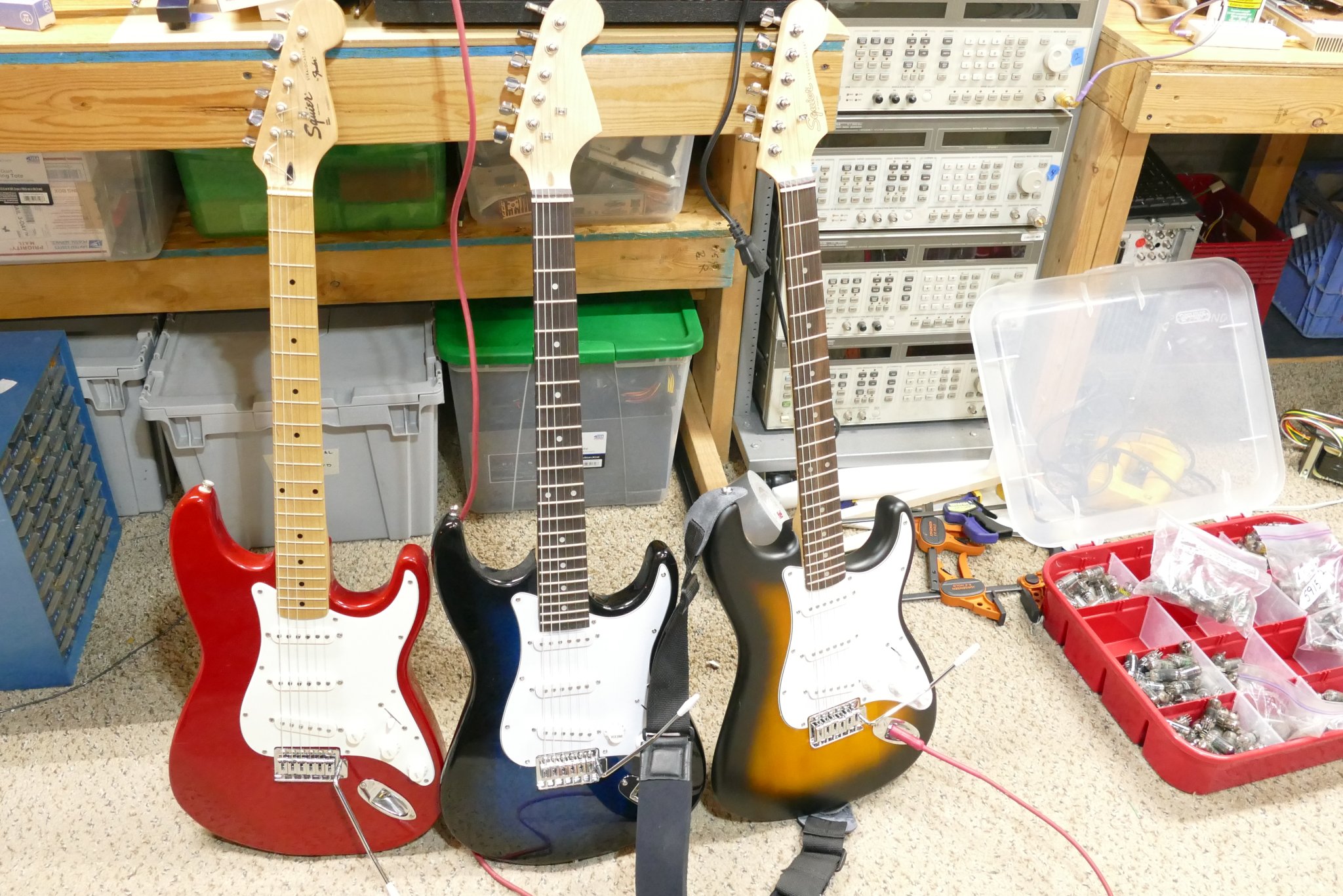

So I have a new guitar, a gain stage breadboard, an output stage PCB, and a recently built cabinet with 12 inch Eminence guitar speaker in it, what's next? Is it time to make a new Super Mega Turbo Champ? Obviously, they all must meet. Last night my wife, and the closest neighbor were not home, so all noise restrictions were lifted, it was time. To minimize the risk of burnt stuff I put the pricey 4D32 back in its box (for now) and installed one 26HU5. I connected a guitar cable to the input and the speaker to the output with clip leads and cut loose.
I played this thing until my fingers hurt, tweaked a little, then played some more. I even played a bass guitar through it. I came to the same conclusion that Will Smith did in Independence Day, "I got to get me one of these." In my case, I got to build me one of these.....just have to figure out how to make it a Super Mega Reverb Champ.

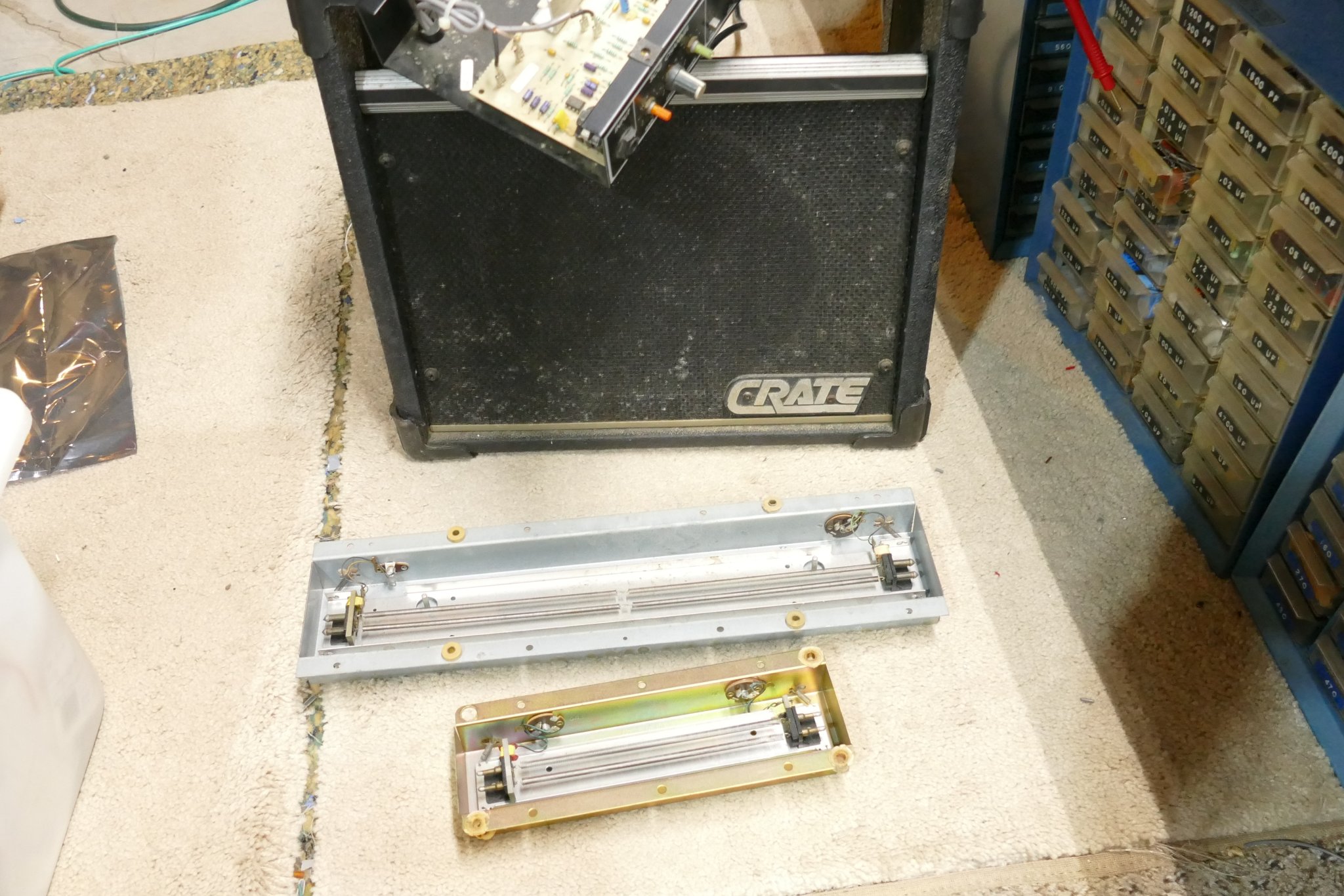

I have 3 or 4 reverb tanks robbed from dead guitar amps over the years. If one of them works, great. If not I'll spend the $30 for a new one.

I pulled this 9.5 inch long dual spring tank out of a dead and ugly Crate amp that is all chips, no transistors or tubes. I may reuse the case if I can get it clean. The big tank is a Gibbs unit and I have had it in a box for so long I can't remember where it came from, though I did pull a tank out of a fried Kustom K-200 many years ago. The small tank is an Accutronics 1BB2C1A unit which seems does generate lots of returns when Googled. Most seem to discuss other brands of cheap guitar amps.

"The Goodwill down the road had one of those; with a 10 or 12 in it, for $20."
I got mine along with the remains of several other dead and partially disassembled guitar amps at the Orlando Hamfest 12 years ago. It has a 10 inch speaker. I think I got them all for $20 at closing time. The picture shows the haul from the 3 day show. It does not show all the "stuff" I sold. I came out way ahead in $$$ and in cubic junk reduction volume.
