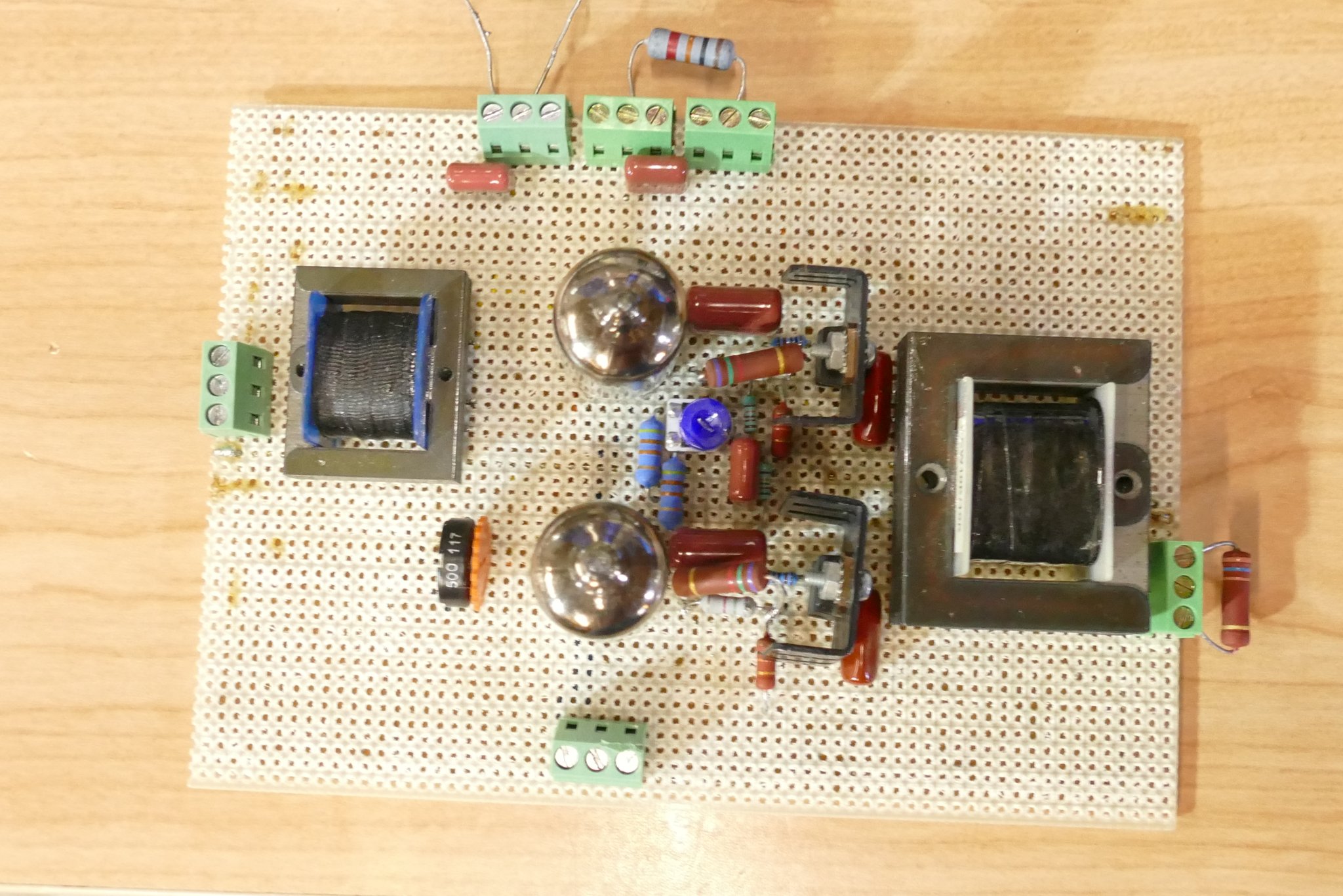

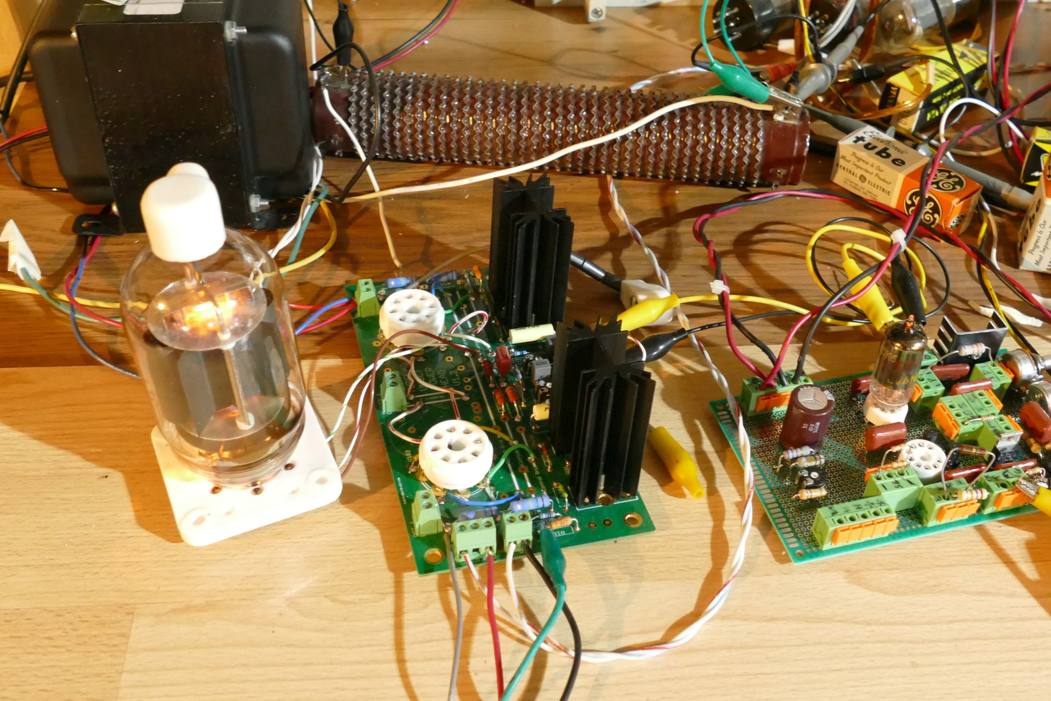

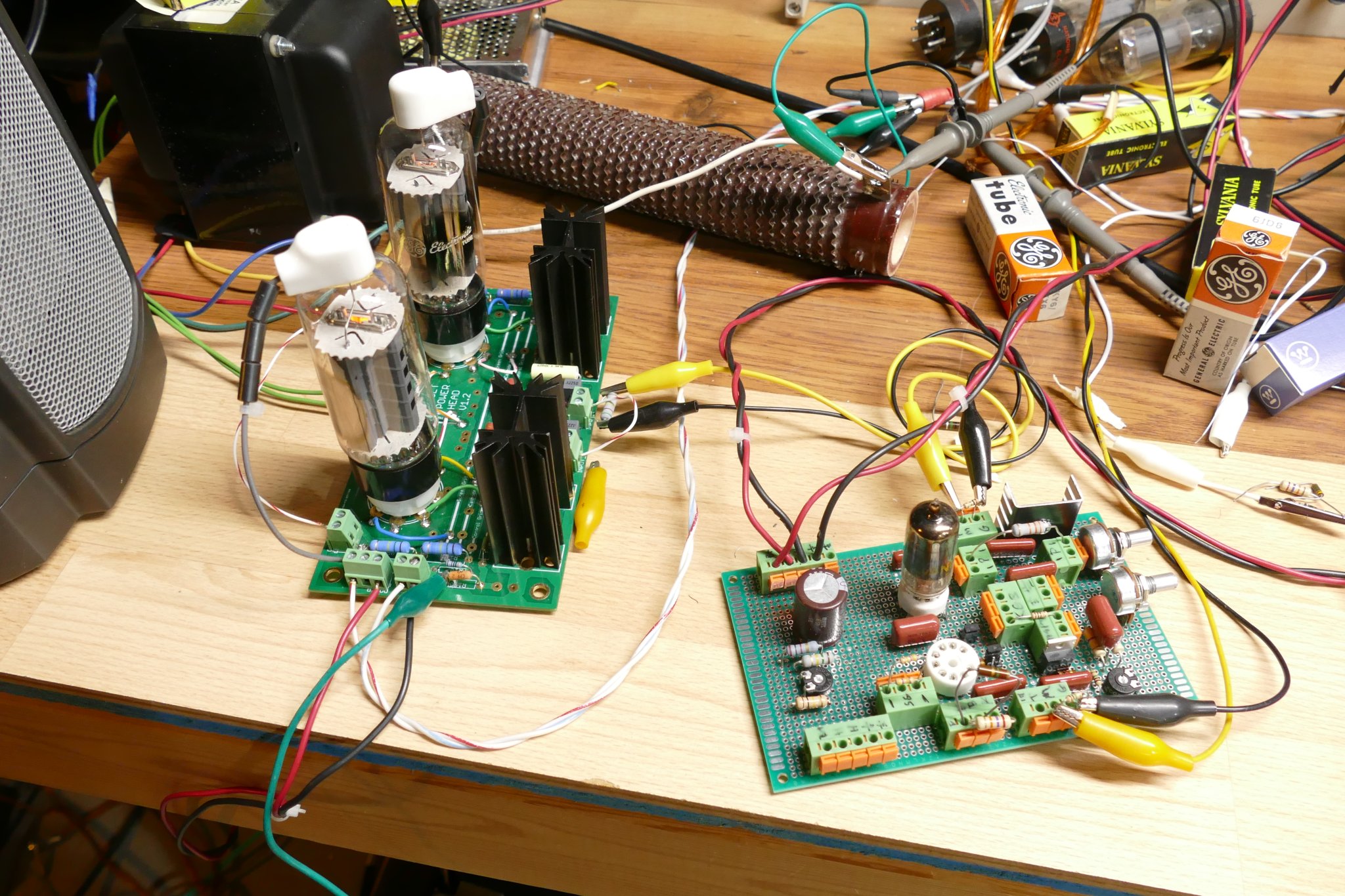

This little test amp delivers 35 watts of SE power with HiFi specs using two TV sweep tubes. It can also do 30 watts with a single 4D32 transmitting tube. The current drawback is the 11 pound Hammond 1628 SEA OPT. I don't need response down to 20 Hz so I'll try some alternatives when I get a chance.

I traced out the circuit of the VCA perf board proto that I built a few years ago. Here is a crude pencil and paper drawing. I will enter it into some sort of electronic format, wither my old version of Eagle, or LT Spice when I get time.
I'll try to fire it up in the next few days to see if it still works and try a few different tubes. This proto was wired for 6EJ7's which are sharp cutoff pentodes. If I remember correctly the control voltage range for about 70 dB of range was pretty small, maybe 5 volts. This is what I want for a music synth, but not necessarily for a compressor. The CV range can be expanded by using a remote cutoff tube like the 6EH7. The pentodes are triode wired, so lots of tubes should work by rewiring the socket.
A music synth or guitar amp doesn't frequency response out to 20 KHz, so I'm going to look for cheaper alternatives to the Edcor transformers.
