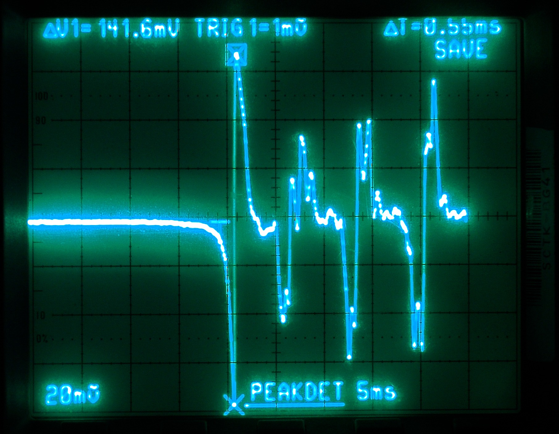

The guitar itself is a factor in how much output the pickup will have, and its construction is the first set of (fixed) tone shaping control that occurs in the amplification process. A solid body guitar made from a "dead" wood like poplar is assumed to be relatively neutral. The two poplar bodies that I made produced very little unamplified sound, being almost inaudible in a large high school woodshop classroom. Make that same guitar body out of yellow pine and it is quite audible with the same neck that I used on the poplar bodies. the large pine guitar was quite loud, and I could hear the maple / mahogony uke over it in an unamplified classroom jam session. This difference translates to slightly more output from the pickups and a longer sustain time. Make a hollow. or semi-hollow body guitar with that same hardware and it will be even louder with more sustain and have a different harmonic output due to resonances in the body itself.
Guitar pickups come in all sorts of configurations with varying output levels. The biggest difference is the cheaper single coil VS the bigger, more expensive hum-bucker with two coils wired out of phase electrically, and magnetically. In this manner the vibrating strings contributions to the two coils add, but stray 60 Hz fields cancel. In the early days of the Hundred Buck Amp Challenge, some forum members that had never built a guitar amp before asked about the electrical output from a typical guitar. I simply connected a scope across the input of an amp that I had on my bench and plugged in every guitar that I could get my hands on. The hottest guitar I had at the time was an old Guild with DiMarzio Hum Bucker pickups. With the switches and controls set for maximum output, and by running through a series of SINGLE NOTES from low to high and finding the loudest one I got an output of about 1.5 Volts peak to peak. This is well beyond what most people in the thread expected including me. Note the TEK scope has a non TEK probe on it so it does not recognize the 10X setting. The real vertical sensitivity is 200 mV / DIV. Some other guitars can't hit 1 volt even when playing 6 note chords as hard as possible. Single notes are in the 500 mV range with all controls set for max output and all three pickups on.
The "setup" of an electric guitar involves adjusting everything for best intonation and best playability for the player that will actually use the guitar. One of these adjustments is pickup height. The closer the pole pieces are to the strings, the louder and brighter the sound out of the amp will be. If the pickup height is too high the strings may touch the pickup in the hands of a heavy handed player, making an ugly POP sound. If the pickup is too low the sound will be quiet and dull in the hands of someone casually strumming some chords.
It has been said that half of all electric guitar players will simply set the controls on their guitar to max volume and wide open tone and expect the amp or FX boxes to do all the work, and that IS a valid strategy for someone who uses a pedal board and likes a loud distorted sound. I admit to being one of them most of the time. The little 4 tube amp I built for the HBAC taught me to use the volume knob on the guitar to set the level so that lightly plucked strings are clean, and harder picking increases the distortion without raising the volume much. The input stage in that amp is a high gain pentode with only 150 volts of B+.
A 1.5 volt peak to peak signal can push the typical opamp input stage in a cheap SS amp into its ugly distortion range, from which there is no return.

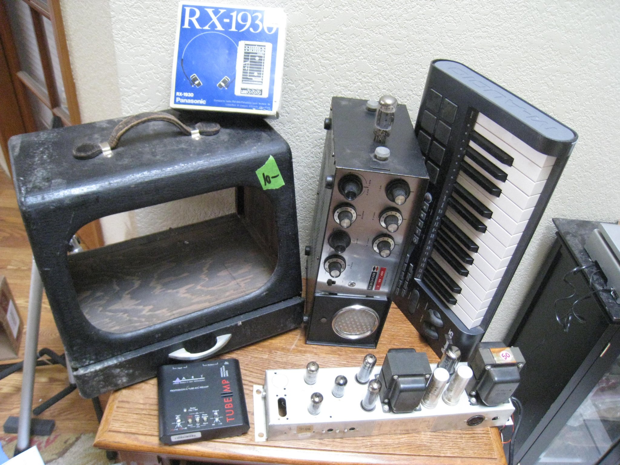

Got some stuff at the show. Very Lucky this year. I paid $30 and $40 for the tube amps, $10 for the short midi keyboard. Which caused the guy to give me the cab and mic pre box for free. I bought the Panasonic AM / FM cassette for $1, cause I recently read they're "in fashion". OK.
The Bogen one uses 7868s, which were both there. We'll see if I need to buy new ones, or punch out those sockets for octals. 3 microphone trannys in there too. The other one is a Thomas. Looked like 6BQ5s, but 6973s. If it's a concertina phase splitter, that box has 5 triodes upstream. Yum! Busted socket on one of the 6973s though...

The Bogen amp I got works and the output tubes dont red plate immediately. Looking to gut it and make it into something "different".
Sort of amusing, on the same terminal strip as the speaker impedance outputs are 3 terminals labeled "remote". Each has a 470k going to +250V, another 470k going to a 0.1 (or so) to ground, and another 470k to an input tube plate resistor. I guess grounding those terminals allows one to kill a channel in the mix with a switch...conducting ~0.5 mA. As long as it's not my finger! That circuit will be among the first to go.

Actually, the tubes are run cold. The 8 volt source is wired across pins 4 and 5 which is the 12.6 volt connection. Google up the schematic for the Soldano SLO 100 for a good example of gain stages chained with attenuators. It was also the first time I saw LDR's being used as switches.Yeah, I remember the ads for those devices in the 60s. I'm sure the guy next door with the side TV repair had them. Just thinking out of the box on this; interesting the ADA unit ran their tubes heaters hot like that - and dared to make a product, Something I see in that schematic (thanks!) are the attenuators between each stage, which is something I suppose one could do to make use of more stages, but without so much gain as they would otherwise provide. Another tube-sound-shaping scheme?

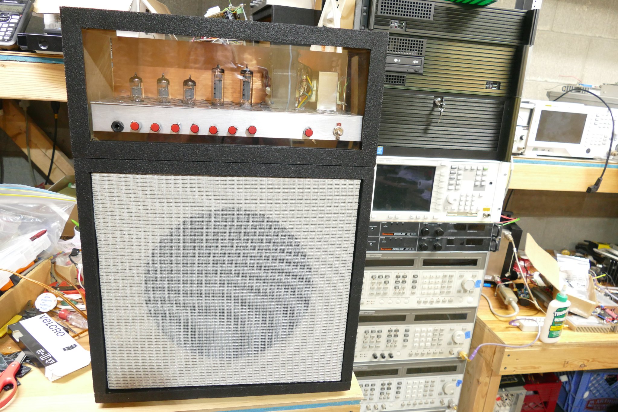

The window of opportunity for working outside with wood and power tools got slammed shut yesterday afternoon when a 4 X 4 foot sheet of thin Lauan plywood levitated off the picnic table that wants to kill me and was recovered about 1000 feet away. The cold front that brought the high winds also dropped the temperature below freezing this morning. One of two speaker cabinets was far enough along to be completed in the basement.
The amp head was built a long time ago for the HBAC challenge and has some issues. I coated the cabinet in the same "Tolex in a paint can" finish that I used on the speaker and will likely reuse it though possibly with a different front panel depending on what "guts" I wind up using.
Synthesizer circuits in the ultimate guitar amp......Yes, that's a given. The current plan is to use at least one hex pickup on the guitar, probably a stick on Roland or Graph Tech saddles in the bridge. That will feed six analog circuits to create six square, and possibly triangle (or something with similar harmonic content) waves using analog chips. A simple compartor with a floating trip point can be used to create a trigger for 12 ASDR envelope generators. Six for the VCA, and six more for the VCF. I would do most of this stuff in a microcontroller like a Teensy, because I have already done most of the work. I have two working "virtual analog" poly synths built using Teensy boards. Both were cleverly designed for 6 note polyphony. The VCFs may wind up being fully analog since only a Moog ladder filter sounds like a Moog ladder filter. A well known German company has already cloned the Model D in SMD, so I just cloned the clone.
