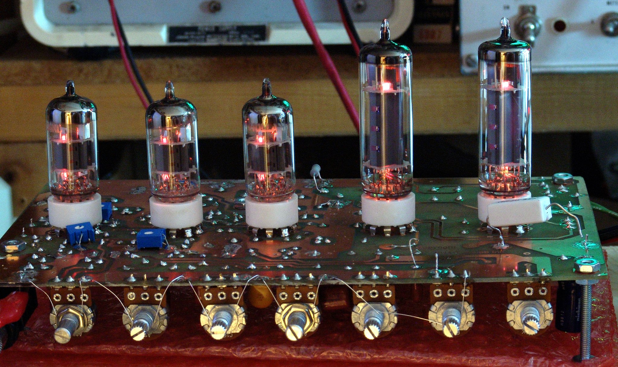

I wondered if the red-plating you experienced could have been caused by the specified 470k grid leak resistor values being too high for your specific tubes. According to the datasheet I checked it seems the EL86/PL84 should be OK with that. Just a thought.

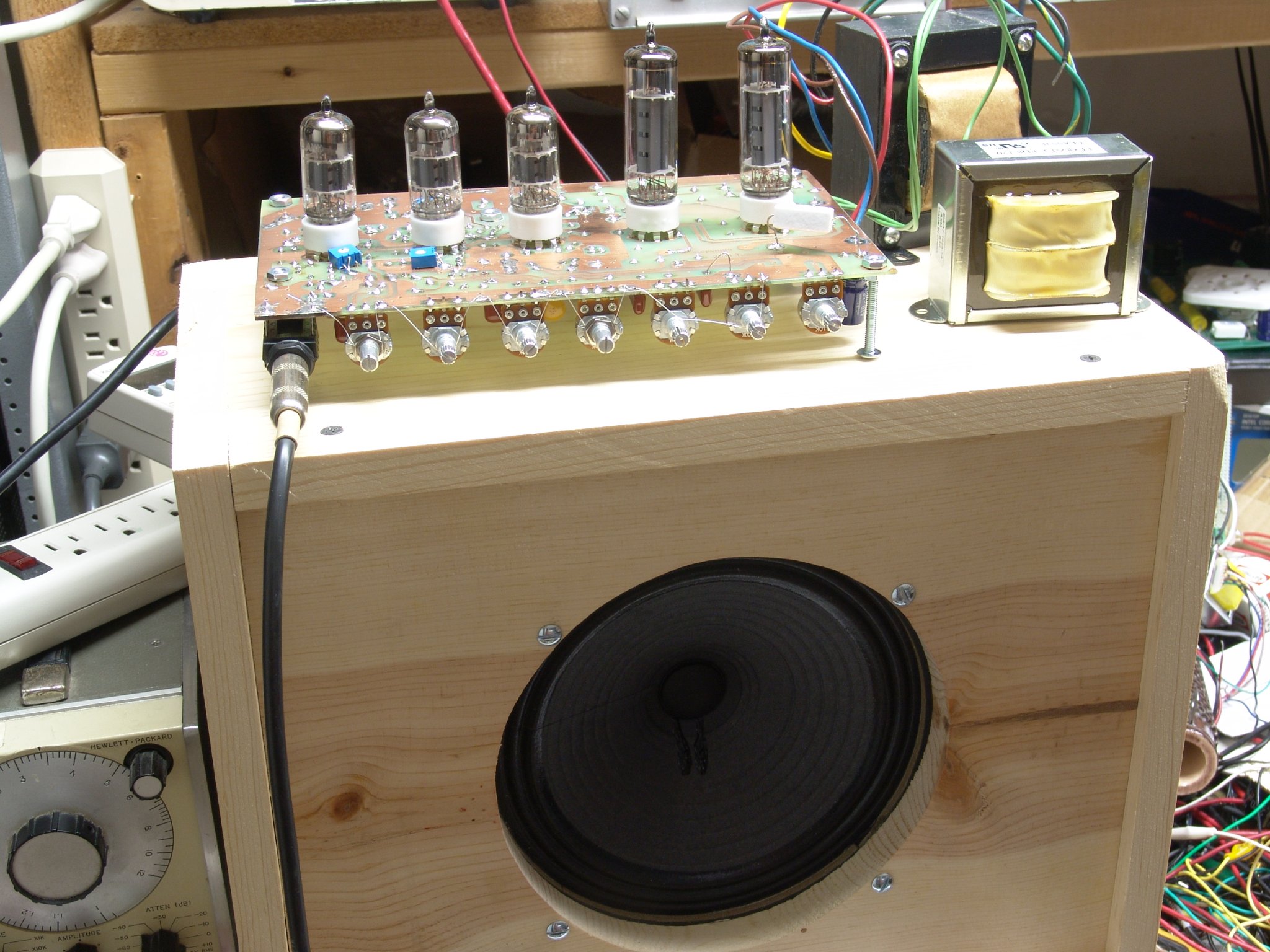

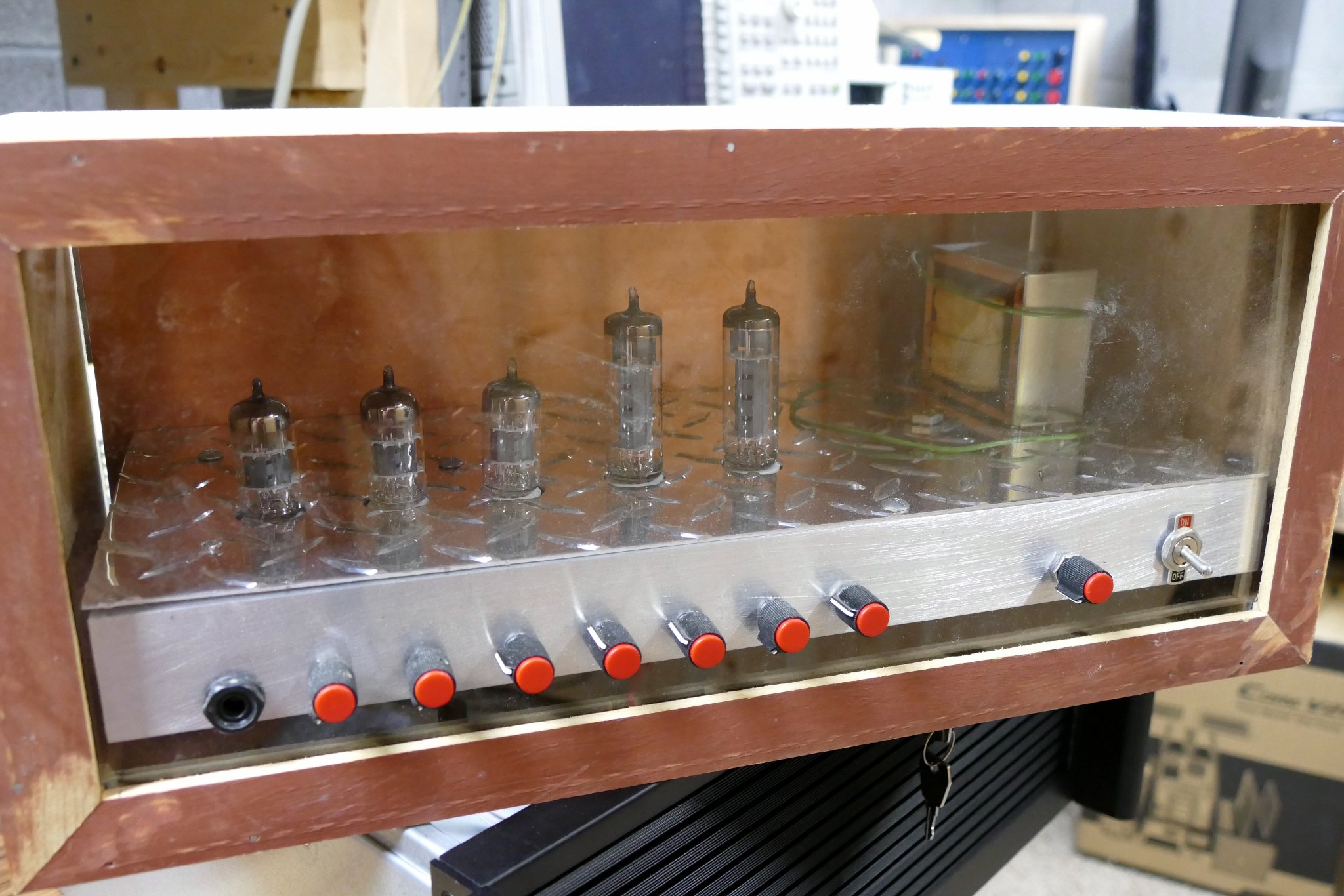

I made two working amps for that contest. One was a minimal cost 4 watt 4 tube push pull amp that consumed about USD $45 at the time (12 years ago). The other was an amp that used every penny of the $100 budget to ROCK the loudest and squeeze into budget. Again prices are a bit higher now. I still use the 4 watt amp whenever I play through an amp. The $100, 18 watt amp hasn't seen power since 2014.
The big amp did however use UL84's and UCC85's. The schematic is attached. The power supply used an 80 VA isolation transformer that produced about 120 to 125 volts. It is rectified by a full wave bridge to run the 100 mA series string tube heaters and output tube screens on about 165 volts. The same transformer also feeds a full wave voltage doubler to power the preamp and output tube plates. I used the same supply concept for an SPP board with a separate 6.3 volt transformer to run an SPP board with 6CW5 / EL86's in it. Both the guitar amp and the SPP board made about 20 watts when powered in this manner with a "real" 3300 ohm OPT. The guitar amp only made 18 watts when I used an Antek power toroid as the OPT to fit into the $100 budget. The UL84 is a 45 volt, 100 mA version of the 6CW5 / EL86. The UCC85 is a 26 volt 100 mA version of the 6AQ8 / ECC85.
In this case you run the whole SPP board from the voltage doubled 330 volts except for the tube screens which are connected to the external 165 volt supply.
The easiest way to do a 6CW5 SPP is to use a power transformer that produces about 330 to 340 volts of B+ and use an off board "regulator" made with a mosfet or vacuum tube follower and a zener or gas tube string to create a supply in the 150 to 190 volt range. All of the 6CW5 tubes that I used were GE's pulled from discarded HP audio oscillators. I used the power transformer from the oscillator to power those amps with a zener and mosfet screen supply. GE states a 200 volt maximum for the screen voltage. All of my 6CW5 amps have used cathode bias.

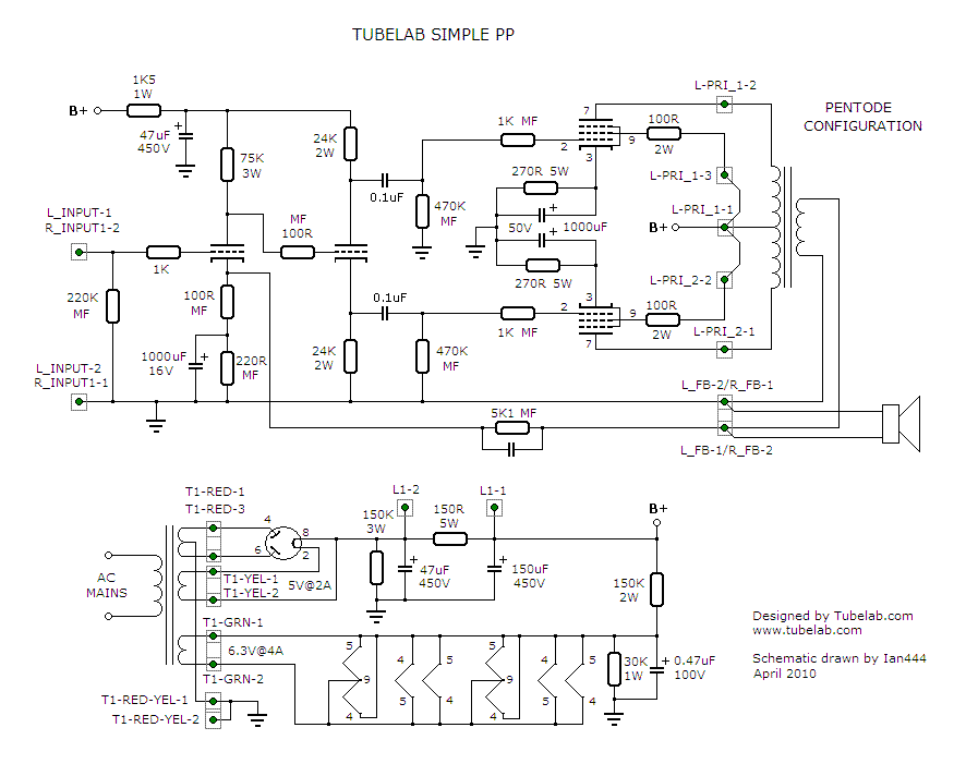

"Is there a schematic somewhere for the SPP?"
My original schematic was lost when multiple computers died due to a lightning strike about 15 years ago. Fortunately forum member Ian444 had redrawn it. His schematic is included.

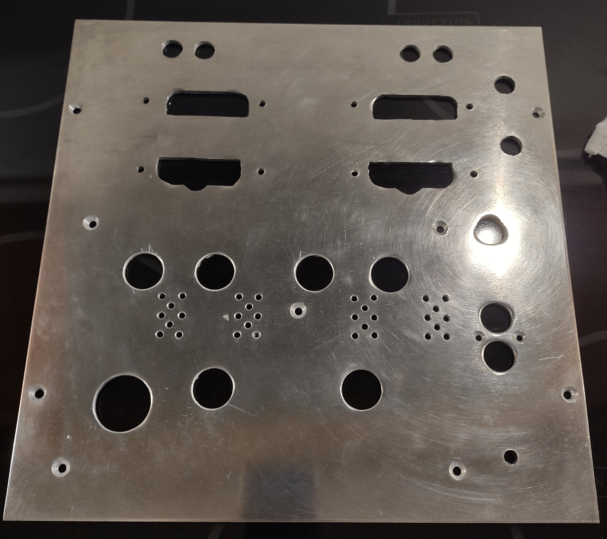

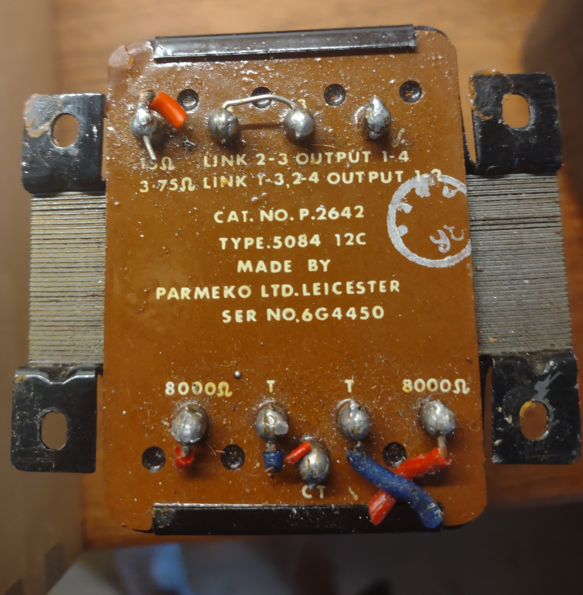

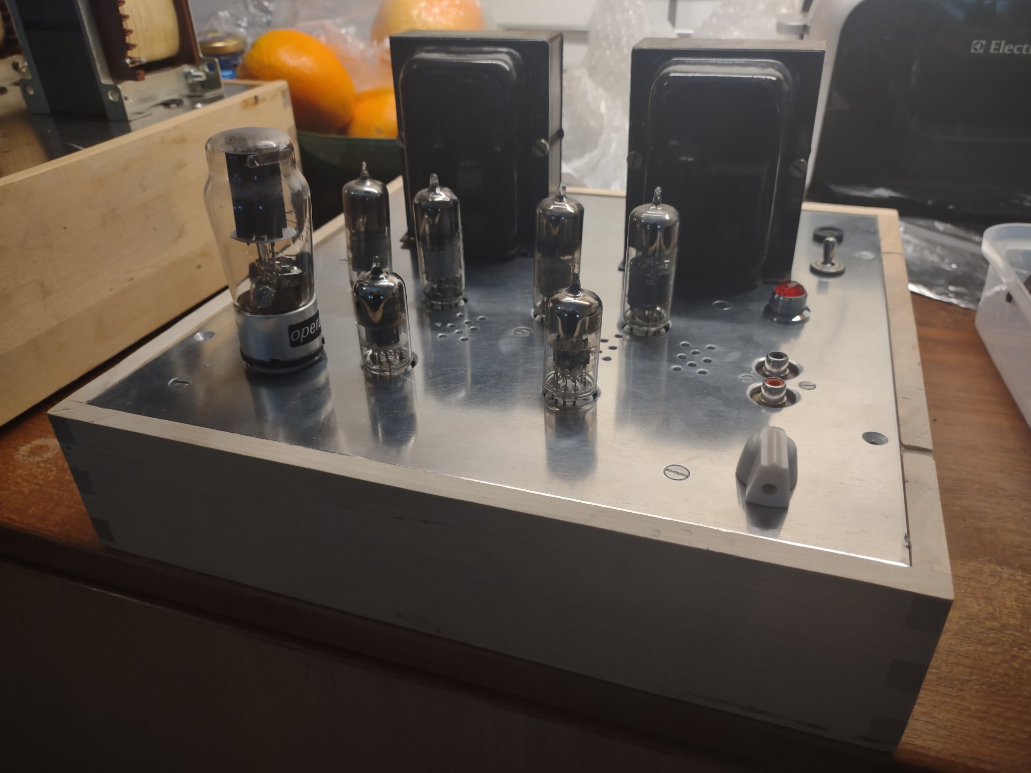

My Tubelab SPP is getting a makeover, and I am utilising some very nice Parmeko P.2642 transformers I stumbled across in an auction (part of a job lot of old transformers). They get a name check in a Wireless World article from 1956, which confirms the UL tap is 43%.
(Ignore the tubes in the picture since I have to do some excavation in my spare room to find the correct tubes and I just used any tubes on the table).
The bijou problemette is that the secondary can be wired for 4R or 16R, which will mean I need to change the feedback from the standard circuit. I shall probably use them as 4R.
The plinth is just an IKEA 12" cube cupboard which I sawed down the middle to liberate two bases. The aluminium is from a 28cm square in 3mm which is a pain to work with in my minimal kitchen tabletop workshop with a selection of drills, hole punches and files.
