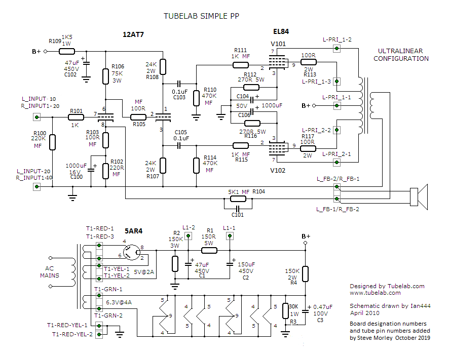

Hi @itsikhefez , Interesting, thanks!There are lots of posts asking about the gNFB feedback compensation cap.
I am building my third SPP, this time with Sowter OPTs (that seem to be of very high quality, BTW), and thought I'd share a FR graph of different cap values.
With this OPT, FR is pretty flat in the audio band, so I'm not even sure if a cap is necessary, but I experimented with 0pF-390pF.
With 0pF (no cap), the HF continues to rise and is likely truncated only due to my sound card sample rate?
With 390pF, the amp becomes unstable at max output power, so that is too high.
150-220pF seem to be the optimal capacitance, for this specific OPT.

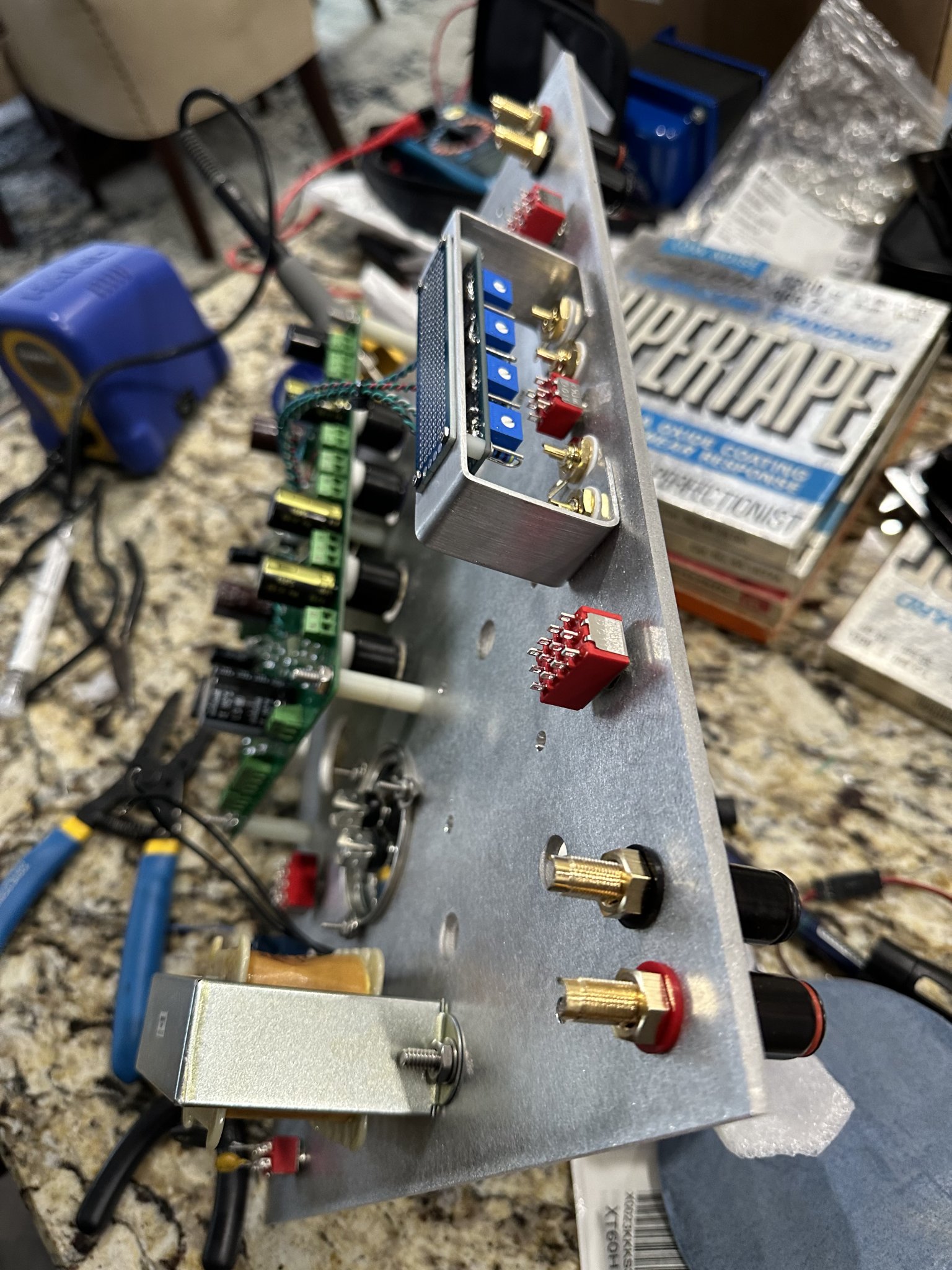

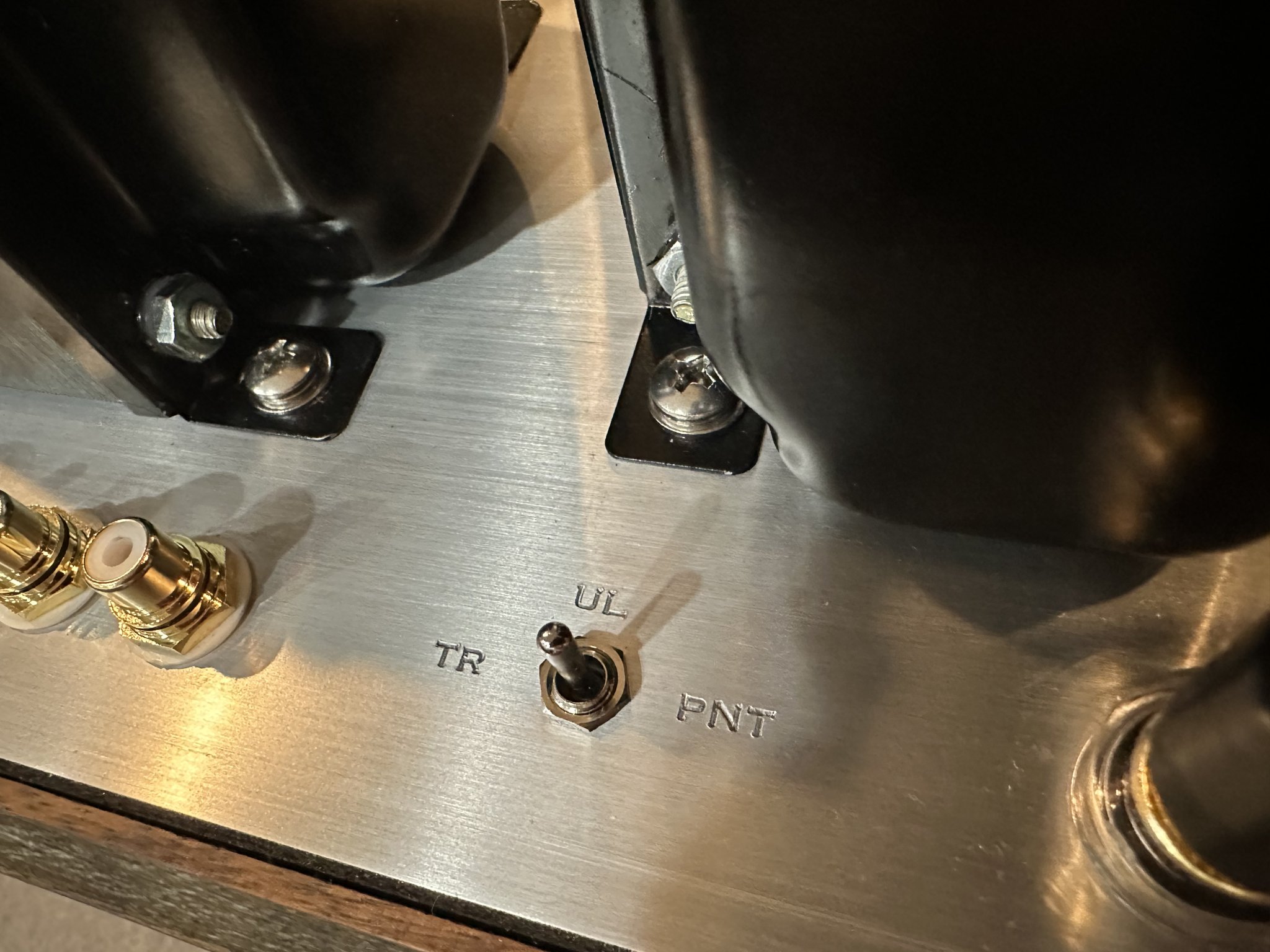

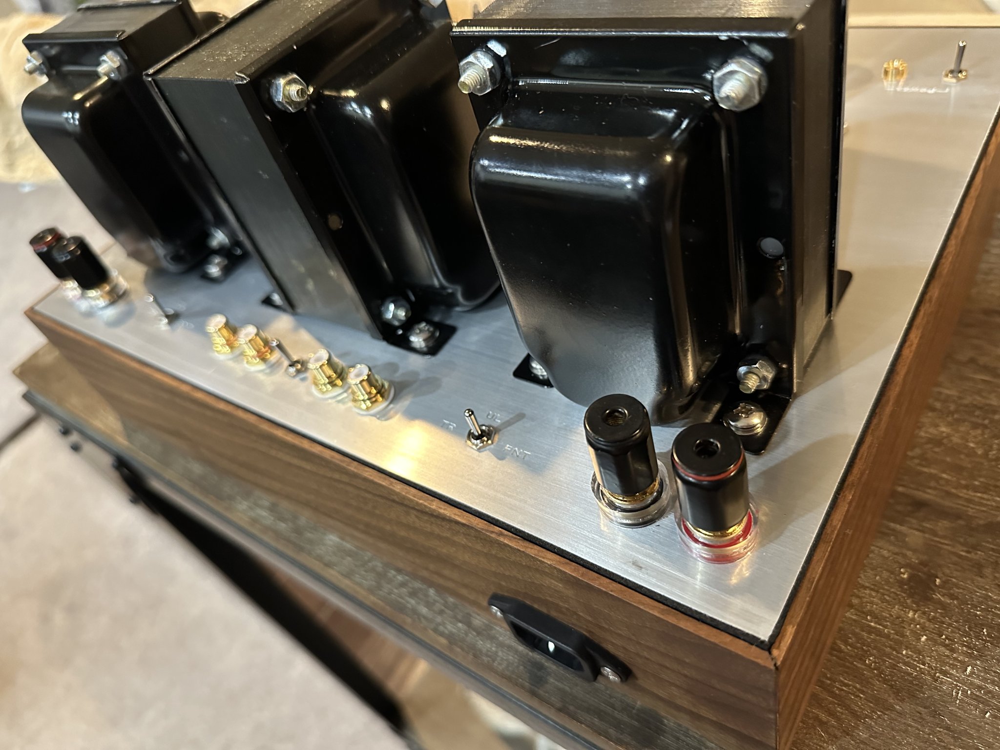

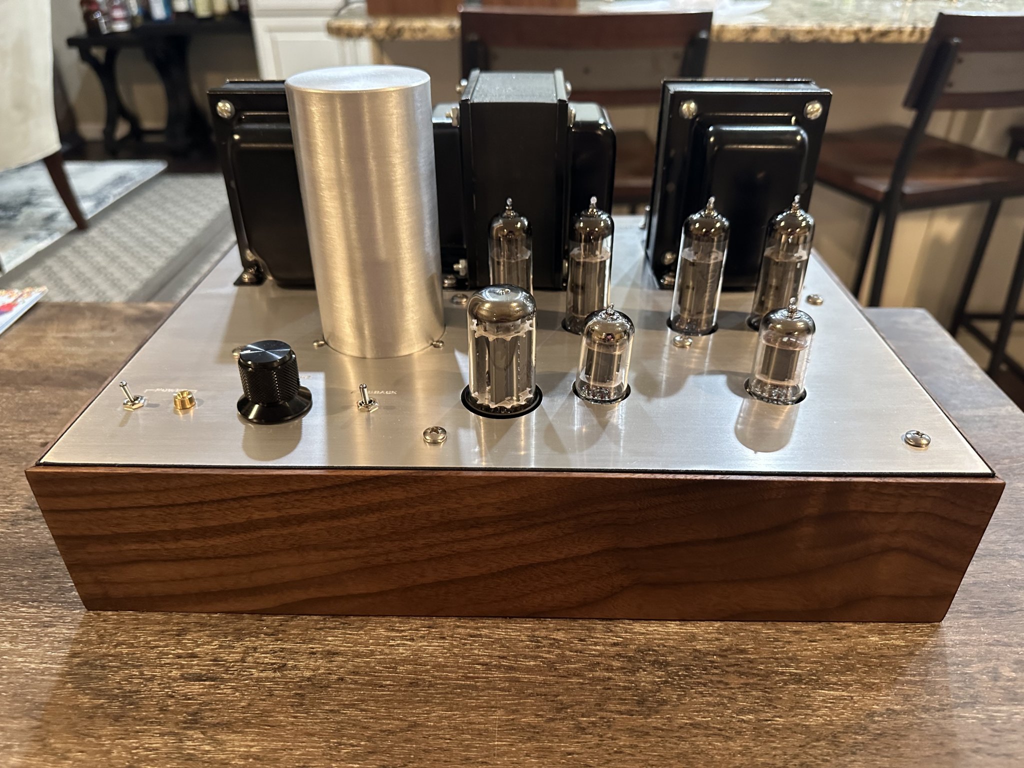

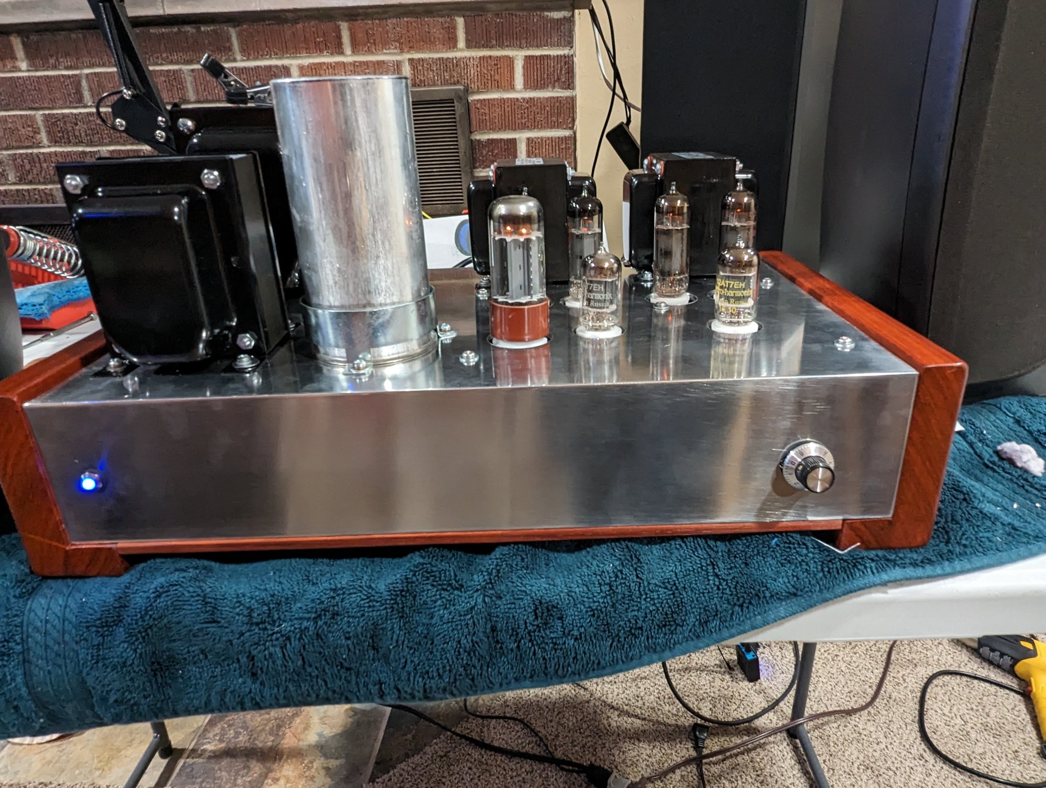

I posted this in another thread, but wanted to share my new completed Tubelab SPP here also, in case it’s helpful to anyone undertaking a similar build. Two switchable inputs, feedback on/off switch, and two mode switches (one for each channel) to choose triode, pentode or ultra linear. Special thanks to Steve (Wall of Sound) for his great article! I also used a bias adjustment mod. Works perfectly!

Listening to one of my SPP amps as this is typed, with a Pass B-1 buffer. May be the best amps I own. Thanks George.

@Tubelab_com As you say, it seems the guy has redone the layout using the schematic where he credits Tubelab.com next to his somewhat similar PCB layout....
I can't comment on Ukraine wrt copyright and it seems he is using the Tubelab name as an identifier rather than claiming the PCB to actually be a Tubelab_com product. As for China, we all they typically they have no regard for copyright and will copy anything and everything!
A fine line, but maybe a homage to your work? How would you rate his PCB design?
The schematic he is using was lifted from my web page. It was drawn by forum member Ian444 (noted on the schematic itself) after a stupid computer trick ate all of my original SPP files. I used it with his permission.

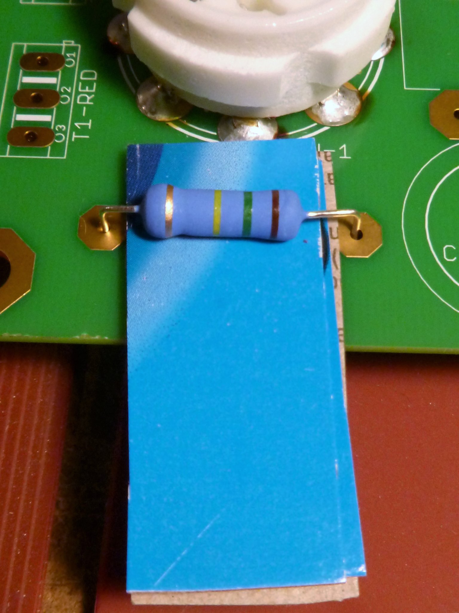

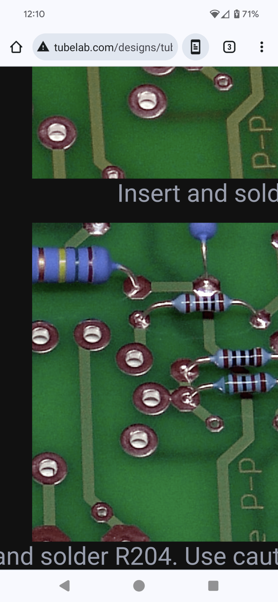

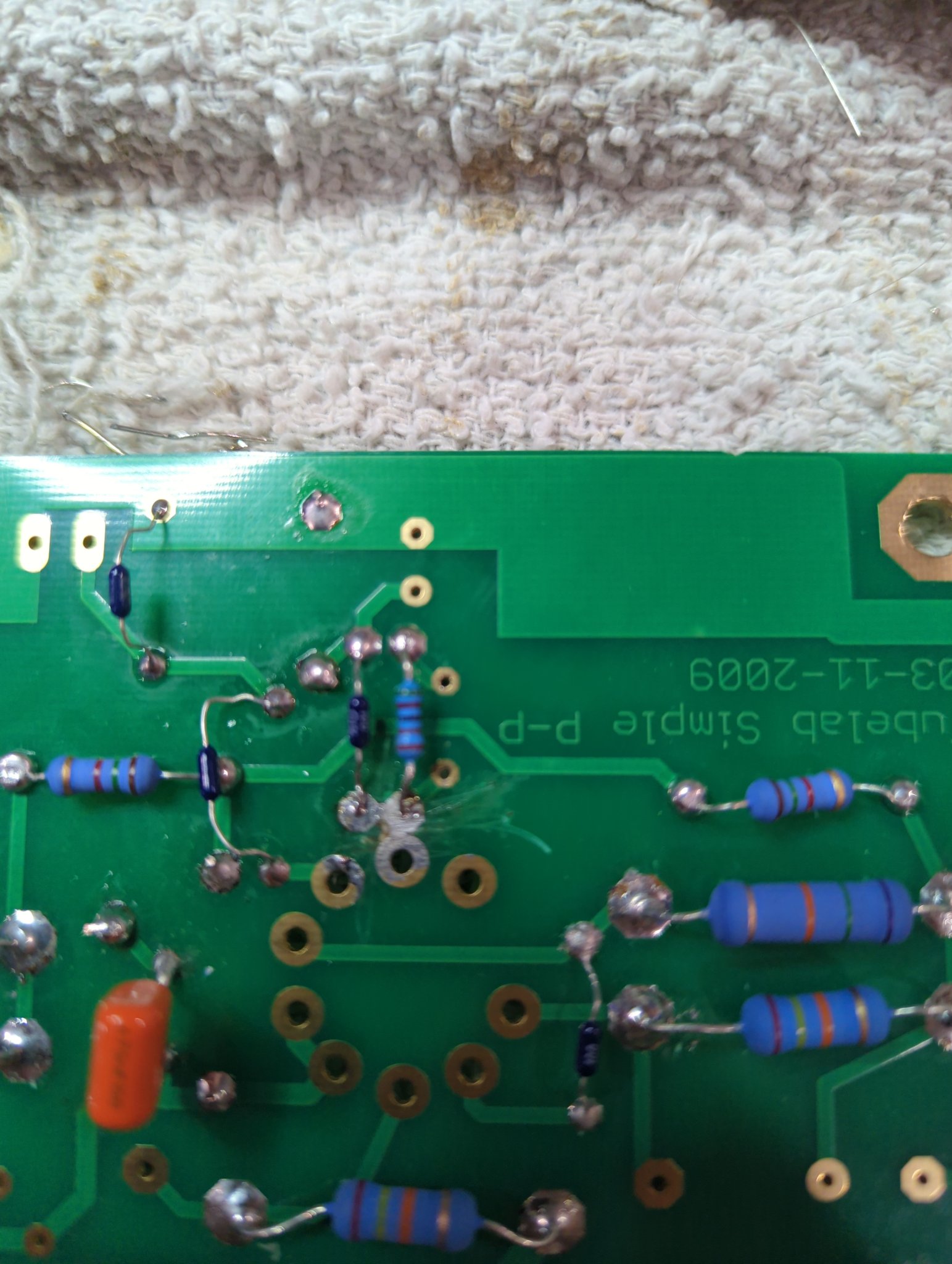

I like to solder resistors spaced off of the board a little bit. I use 2 or 3 layers of cereal box cardboard or similar to space the resistor. After soldering, I slide them out, see pic. Also, wherever possible, I solder components on both sides of the board. This is especially important with tube sockets as they undergo more stress and strain.
Thanks Steve! Yeah I tried that method for a bit and a few of them got a little wonky. Appreciate the reply. Looks like I can move forward now.

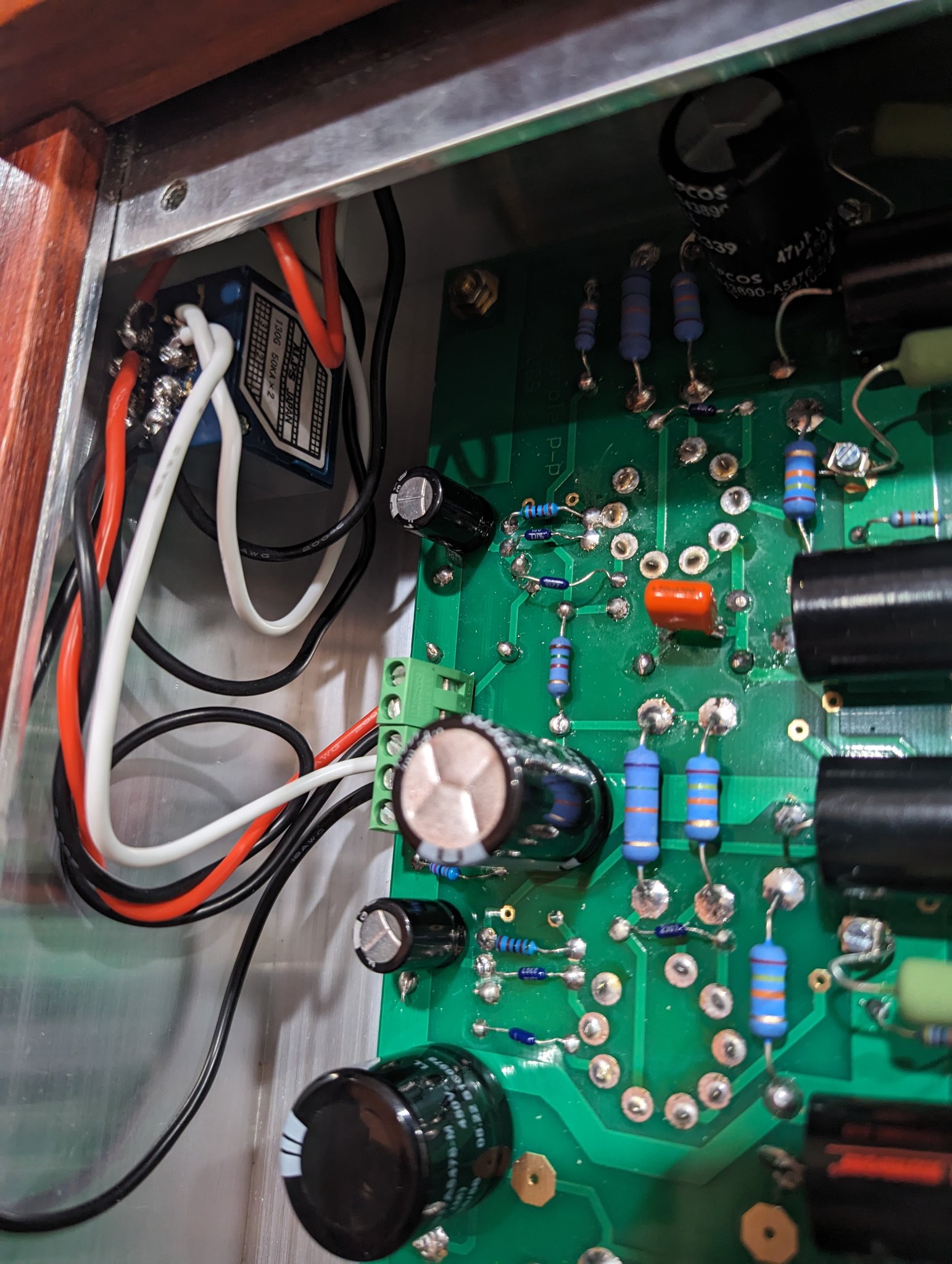

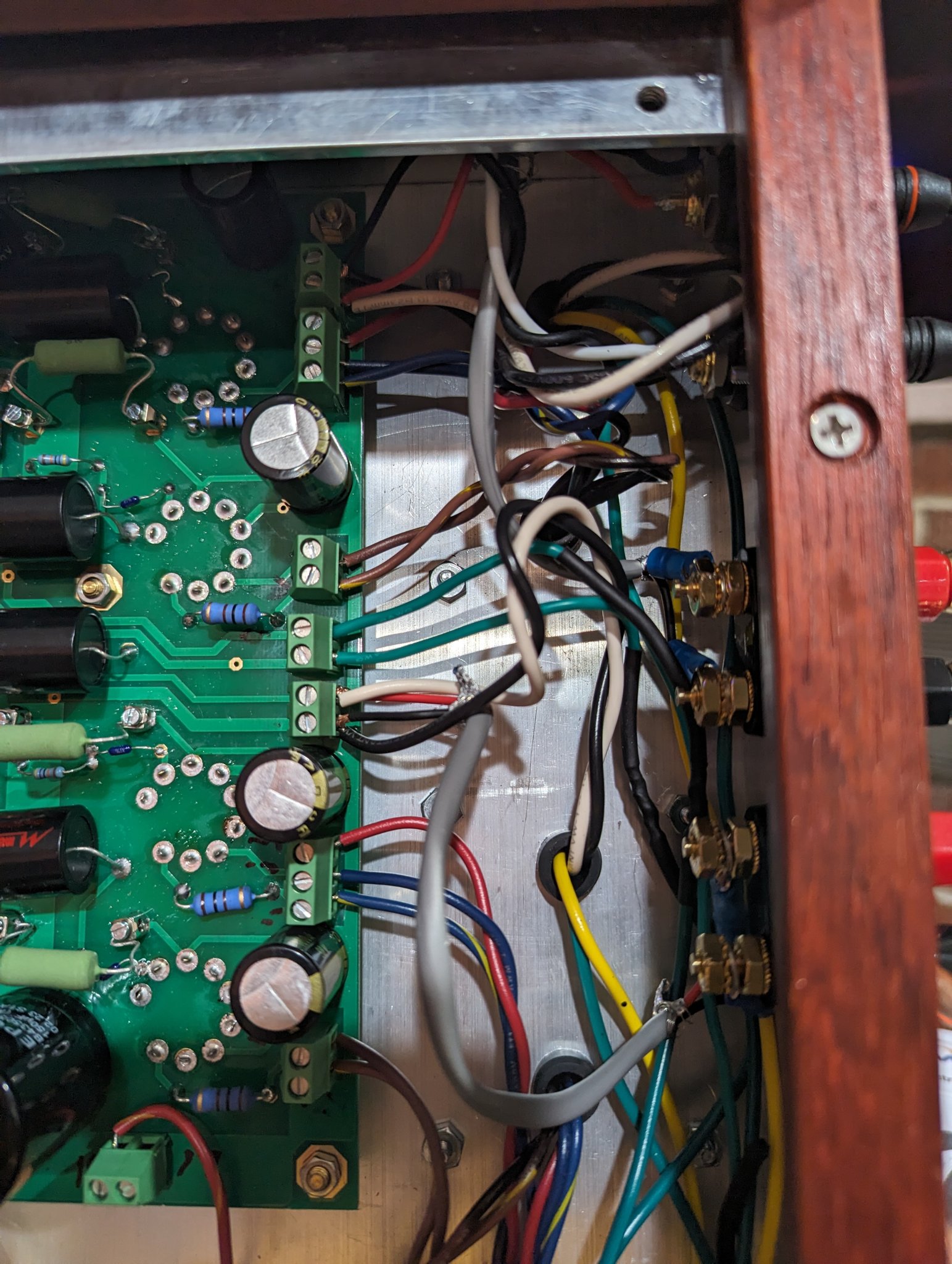

Just finished up my SPP build turned out very nice. Only problem is no sound from the left side, right side sound is fine, no hum good volume. I Tried to verify the left side connections. Any help on where to start would be appreciated. I know I still need to tidy up some of the wiring.
Main Transformer is Hammond 272JX
Output Trans Hammond 1650FA
Choke Hammond 193L
CJ
Choke Hammond 193L
CJ
It looks like that fat white wire from the volume pot to the input connector is in the wrong hole. It should be in the one on the bottom in the picture.
